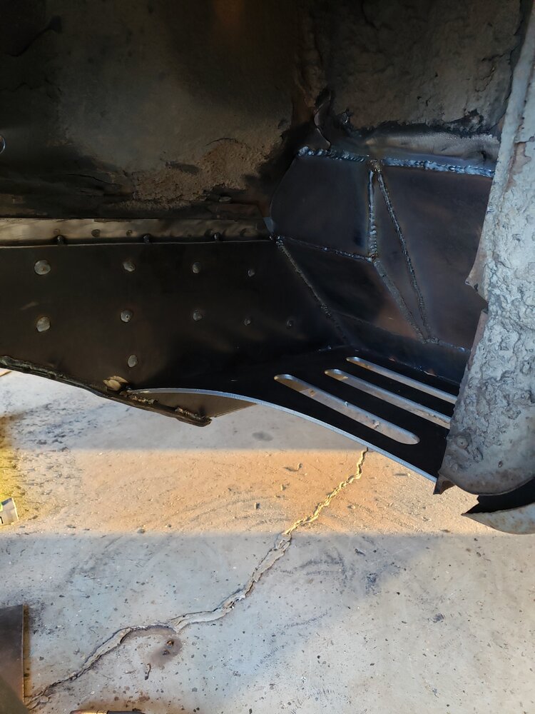

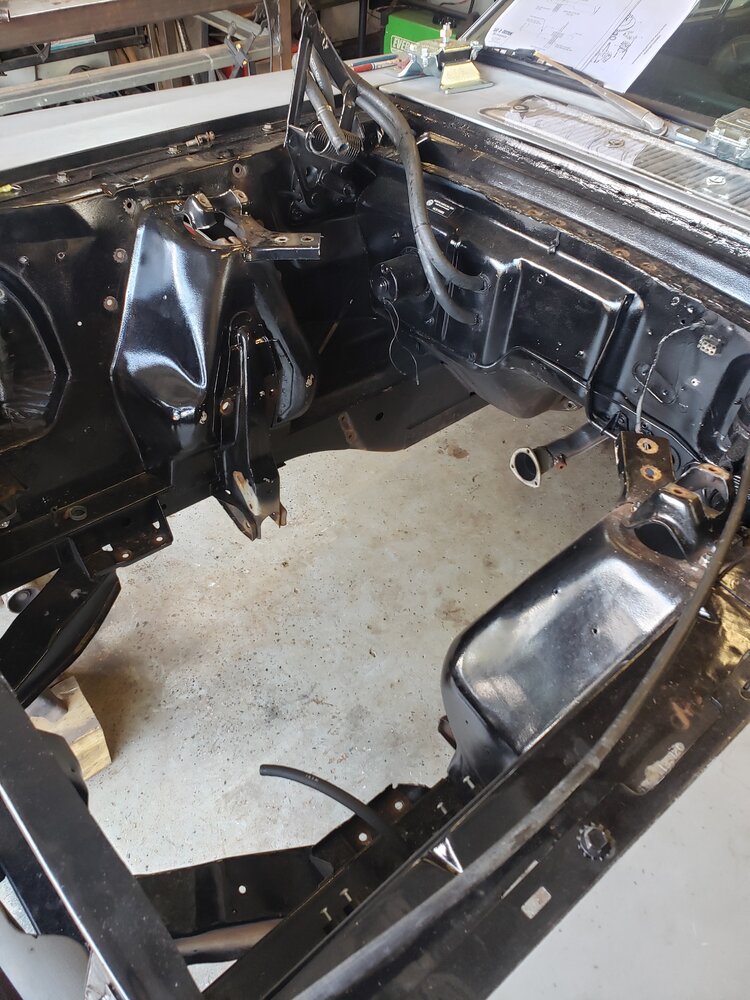

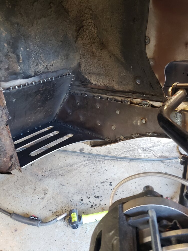

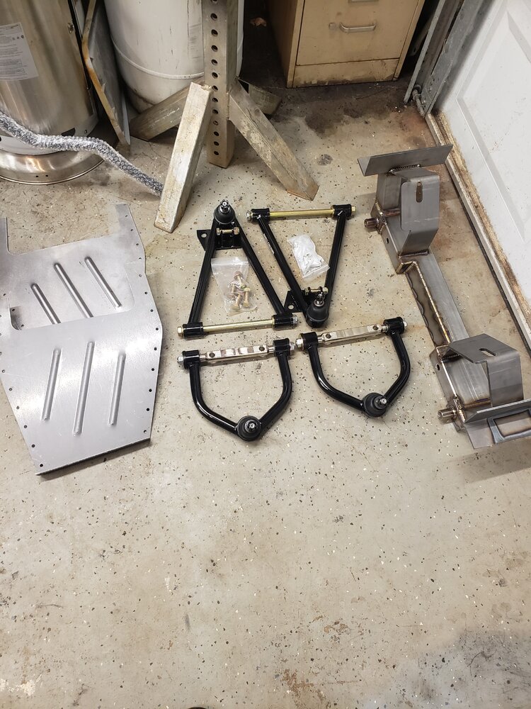

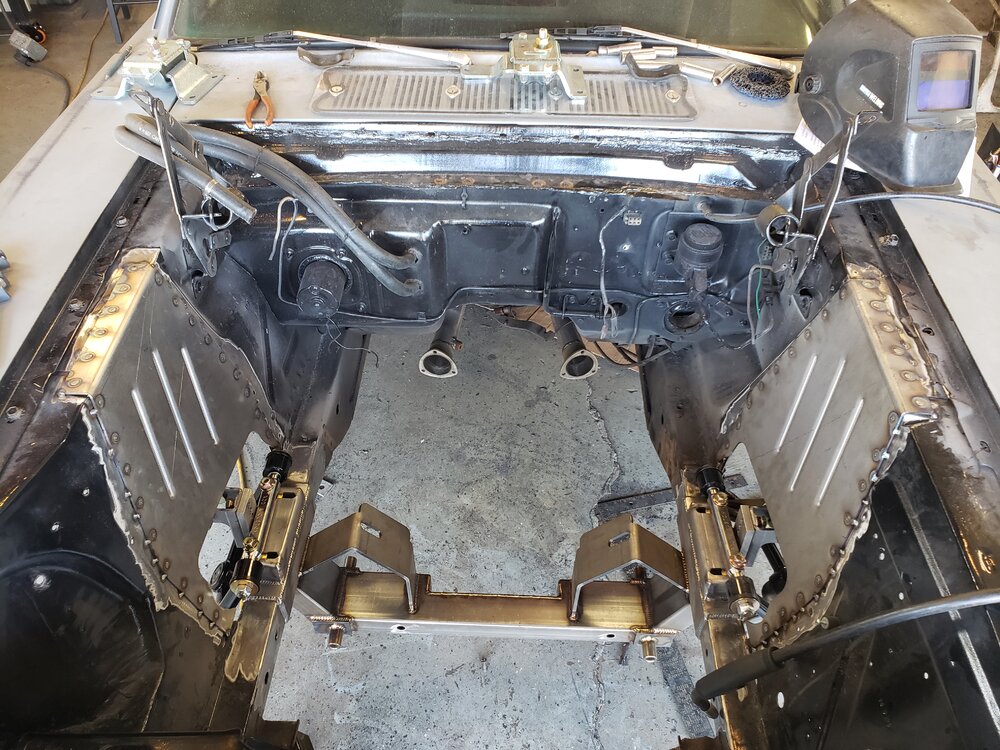

This is a very cool job, I'm loving the change of pace from off-road to street rod!

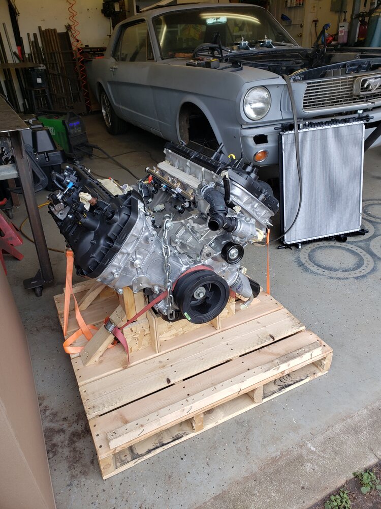

Basically a new Coyote with single turbo, shooting for 750-800hp according to customer.

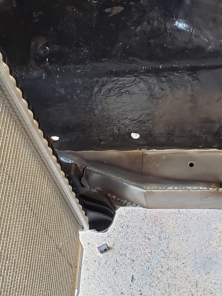

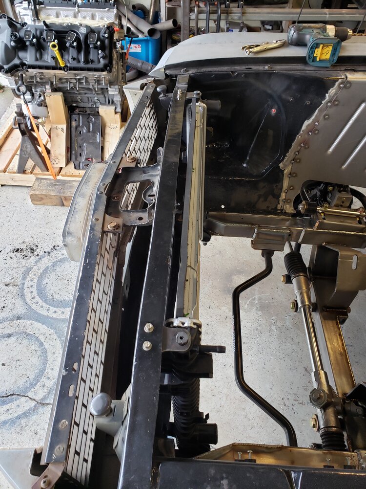

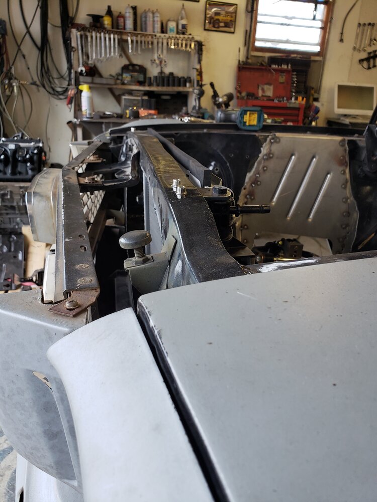

Using a factory 2020 radiator, just finished getting it in. All frame work and torque boxes in front are done, next will be tying in front to rear unibody rails, rear boxes, rear 4link, new trans tunnel etc..Will try to keep updates here.

Just FYI - make sure the customer (or you) installs one of the GOOD 1 piece export braces. The top of the shock towers will fold in if not.
These things are shockingly flimsy upfront.
And the fact that he has a cowl vent cover is a dead giveaway there is hidden rust in the cowl support. (Extremely common in gen 1s)

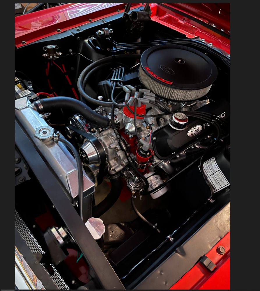

This is my engine bay and yes its damn tight
So tight that I cant close the hood with a spin on air filter topper. That button head bolt has 1/8" clearance.
Thats the Z2 Boss 363.
I'm 28 15/16 from oil pan to air filter top.
Any taller and you have to drop motor mount - which @marty79 has well covered above and looks really good. But with the Z2 7.5 qt oil pan it would be a speed bump casualty.
Expand on this please, thank you. I'm new to hot rod stuff
If you pulled the engine there should have been two short arms that went from the top of the shock towers back to the cowl pinch seam. All US non cobras got these style braces.
Now look at the pic I posted of my engine bay. Do you see the solid one piece export brace that triangulated the two shock tower caps and ties to the cowl area? These were originally used only on export mustangs that saw more forces during shipment and race prepped vehicles.
These are critical in this application due to the increased weight and torque of the motor. You won’t have shock tower caps but there are other torsion style “strut arms” that will keep the towers spread.

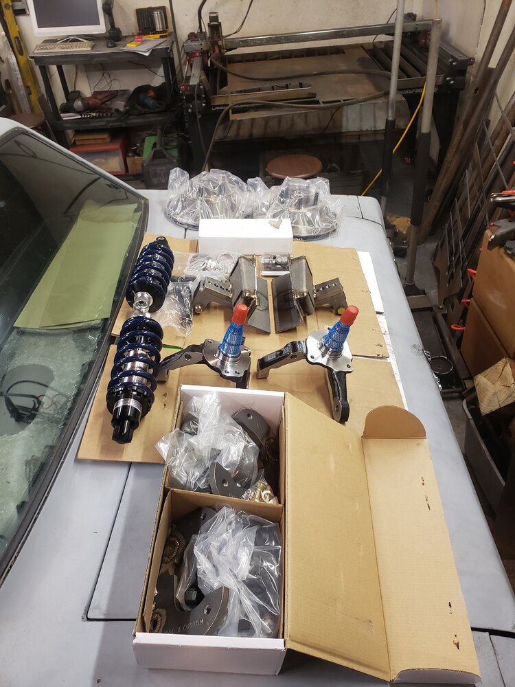

How he going to install or need an export brace with a shock tower delete and coilovers?
Also, everything needs a turbo. I'd have put an ls in it, but glad this one is staying ford, the coyotes sound great with a decent exhaust
You gotta push the upper inner fenders out or they will “come together - right now “ like the beetles.
Monte Carlo bar and triangulate off that or whatever

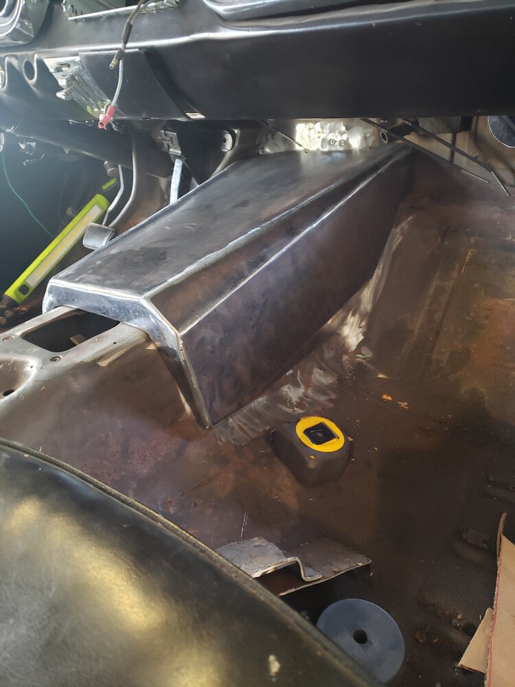

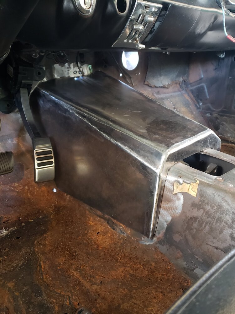

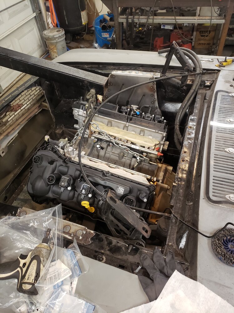

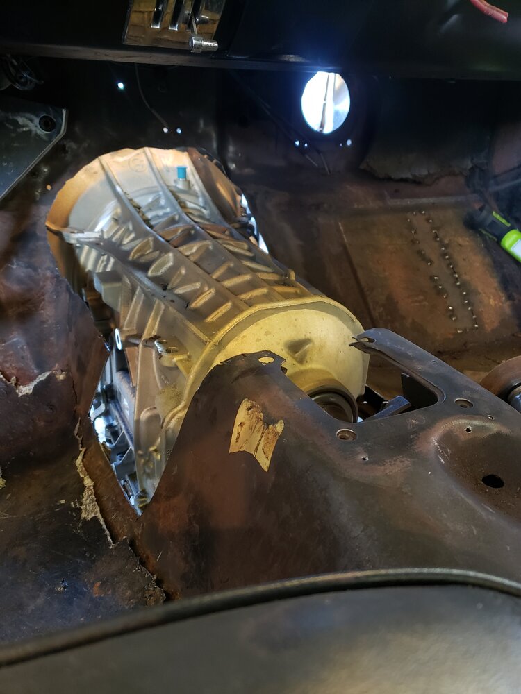

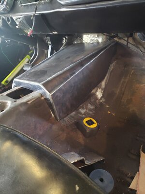

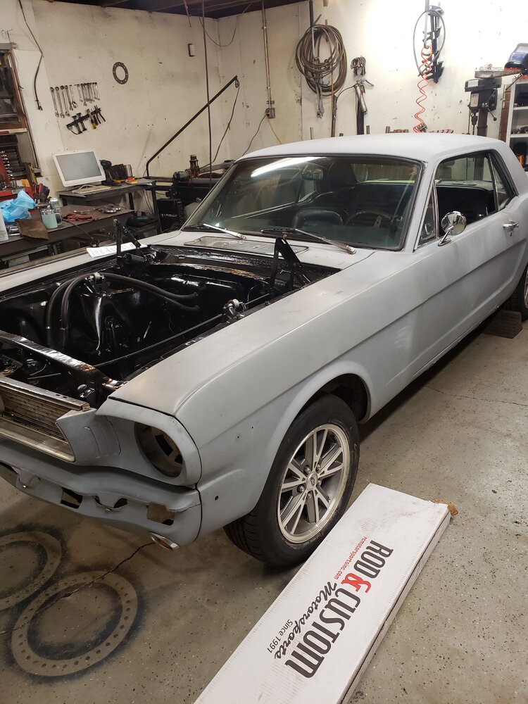

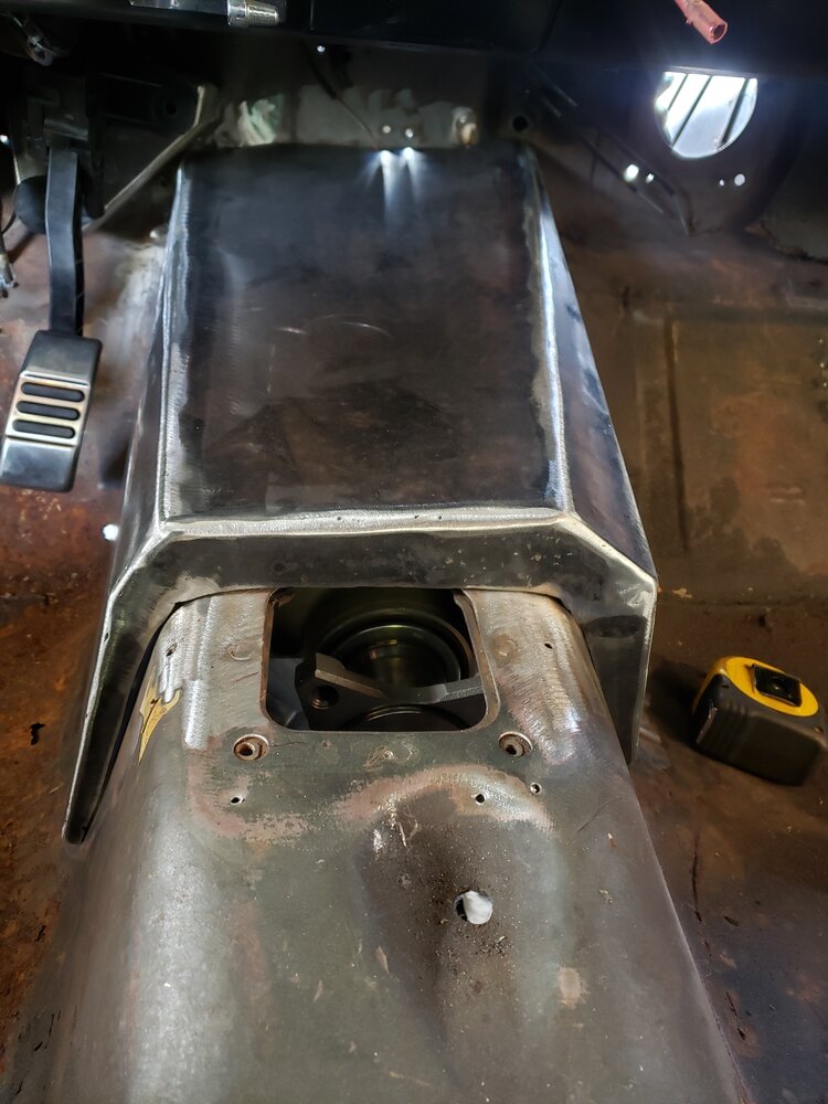

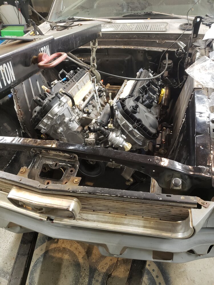

Motor is sitting in..now making a new trans tunnel and crossmember..will keep updating. (I really wish he hadn't bought the frame crossmember with mounts...screw that crap. Me, him and another friend fought this beast for almost 3hrs cause freaking stupid tight fit on the builders mounts/brackets/ oil pan frame notching. Otherwise nice kit but dam that install lol)
Well here's the first part of all of this. There will be more added once he decides on stereo/switches and I'm waiting for the 2020 mustang center console and shifter to show up so I can incorporate that into this..but he loves this so far.

FYI the trans tunnels on those unibody cars are the skeletal system that ties everything together. Make sure you have good contact and tie ins to your new tunnel. Ive seen some gnarly twist with very minimal tunnel notching.
Looks good, sir!
Would the sub frame connectors coupled with an x brace (like the Mike Maier kit) fix that?
