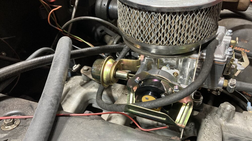

Driving home from work today and had some errands to run in a part of town with a lot of stop lights. About halfway home it started idling like crap.
I’m thinking I either have a vacuum leak or fuel boiling, but I doubt it’s a fuel issue.
After dinner I cranked it up and it was still idling bad, I turned one of the idle screws out and the idle got better, so I’m thinking vacuum. I’m going to dig in more tomorrow morning. Uugghh
No chance its related to the timing you said you adjusted? Dizzy hold down bolt loose?
Thought about that and messed with it this morning. It was tight down but I fiddled with the timing again anyway.
I did the ol spray around the carb with starting fluid to check for any vacuum leaks and didn’t find any. I also sprayed around the intake where it mounts to the head. Nothing
Checked the vacuum lines going to the distributor and and the pcv line, all good.
Removed and blew through the fuel filter and it was good.
I checked my idle screws, they were both at 2.5 turns. I turned them out to 3.25 and it’s idling better.
I took the top off the 2150 and ran it to see if I could see anything. All looked good.
I’m just not sure why it all of a sudden wants more fuel at idle. To me that sounds like a vacuum leak. But I can’t find anything.

Well, drove it into downtown for lunch, 6 miles round trip. It seemed to run great. I don't know why all of a sudden I needed to mess with the idle mixture screws and idle speed screw but it's running just a decent as normal.

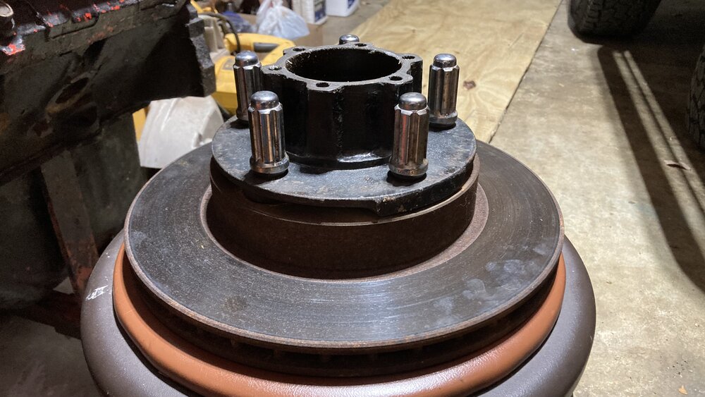

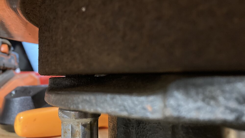

Been excited to convert my hubs to the older, stronger, six bolt style since I had the parts all fall in my lap.
Got the old Warn hubs and everything cleaned up, went to put my rotors on the six bolt hubs and found out that the conversion doesn’t work with drum brake hub assemblies 🤦‍♂️
Shelved until I buy new hubs from quadratec.

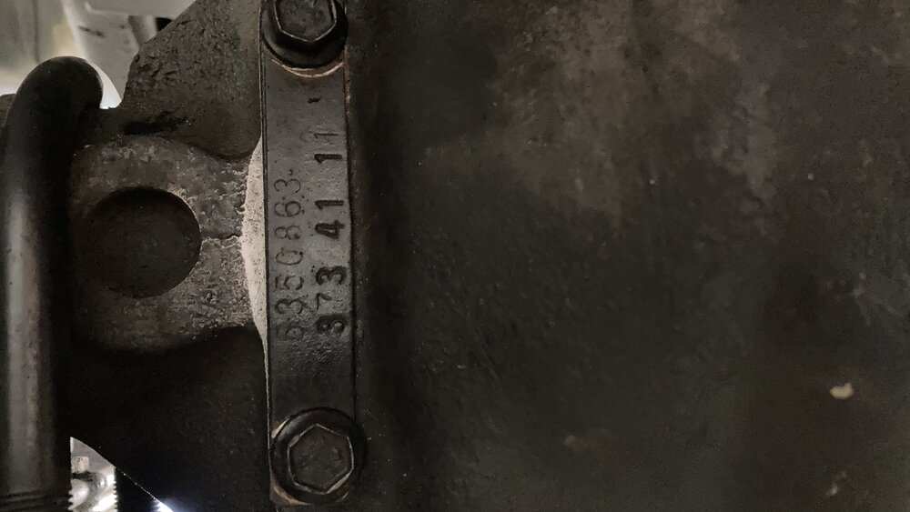

All fine and dandy until I started getting parts together when a local guy up here (goes by JimsChopShop on instagram and other forums) pointed out that my engine is an early 360 and finding parts that work might be hard. So far, I've gathered that my engine is a 72 - 73 model year, and I think any "ordinary" 360 flywheel will work, but I might need to find an early 360 water pump to make everything else work. Or, I think I can swap in a later crank and make "normal" 360 parts work.

What I've learned is that I can swap any late 360 flywheel and harmonic balancer (four bolt) on it to convert the engine to the "normal" '74 - '92 model year 360 accessories. I just have to get the engine balanced, which it sounds like is almost standard practice with these things anyway.
I now also have a line on a complete '77 360 that I can pull all the accessories, timing cover, water pump, pullies, harmonic balancer, and flywheel off of. So hopefully back on track.

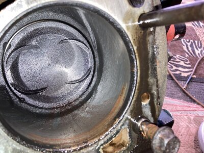

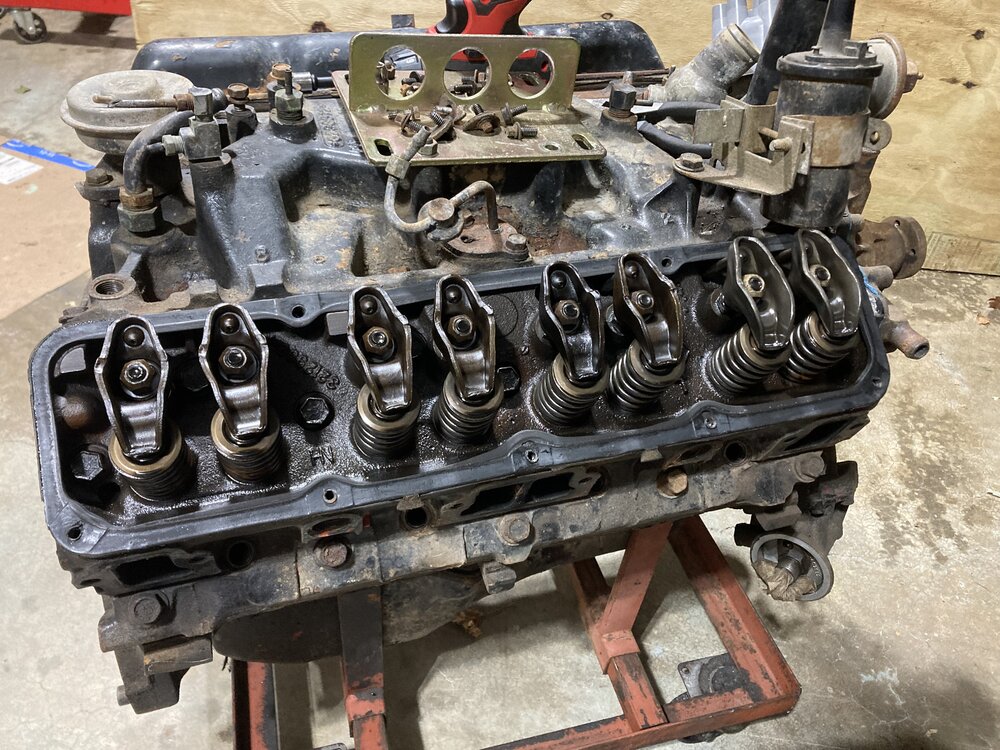

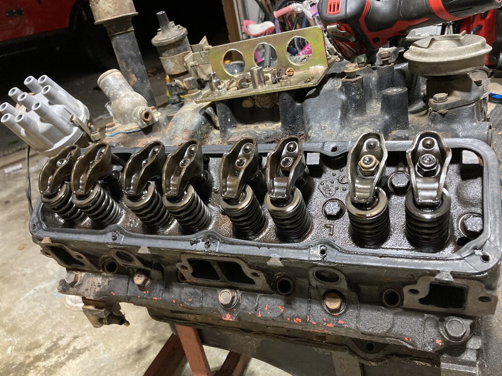

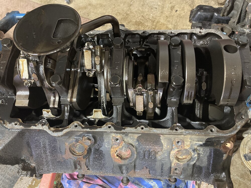

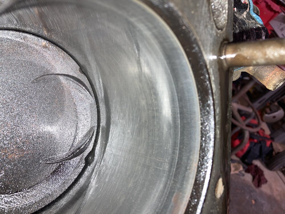

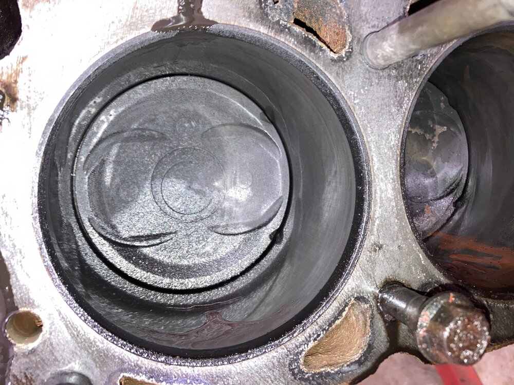

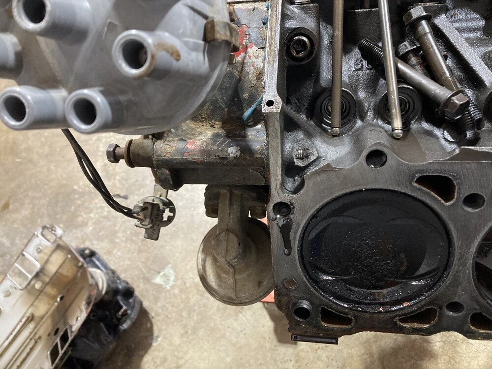

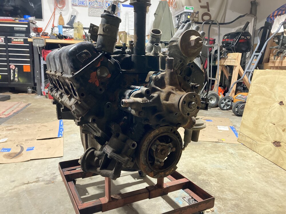

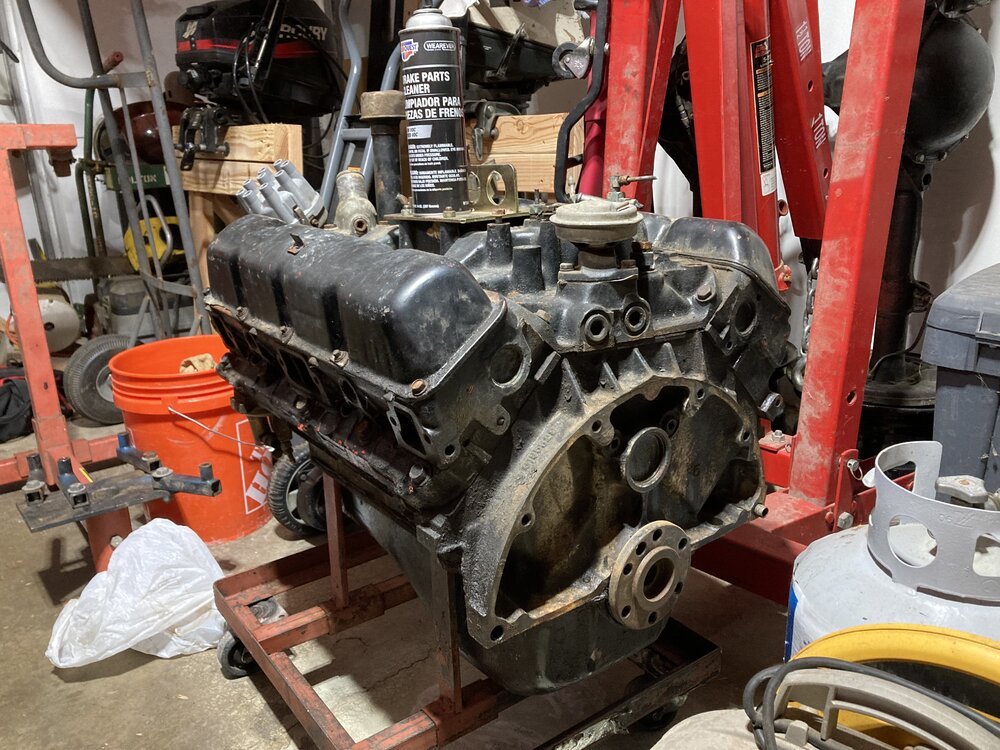

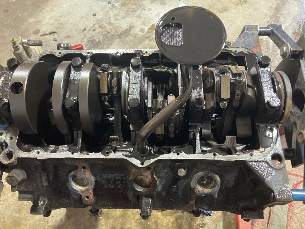

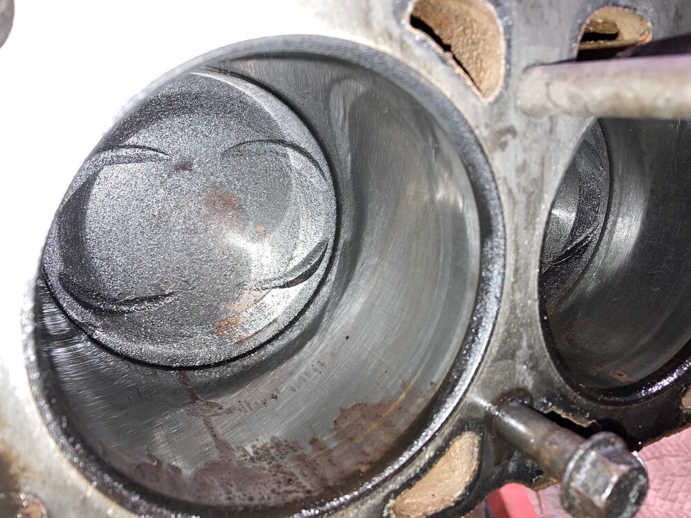

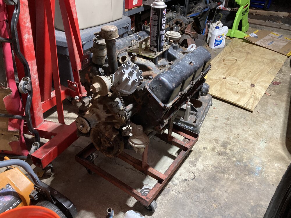

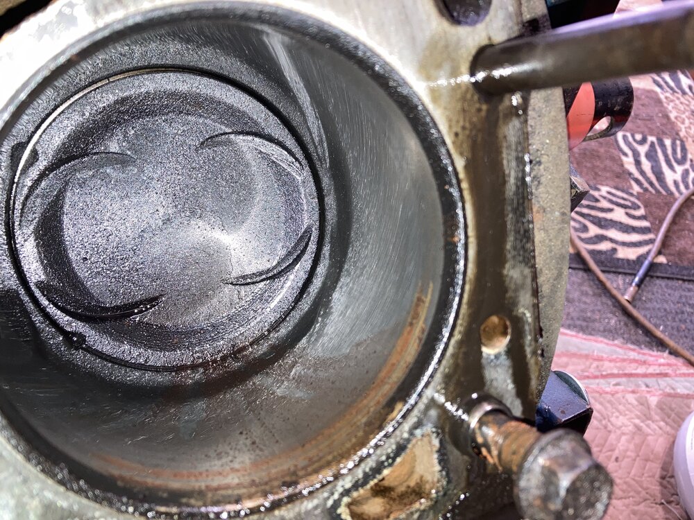

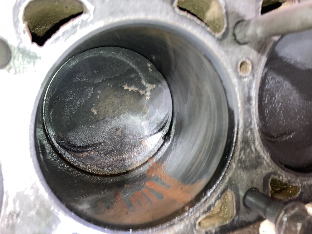

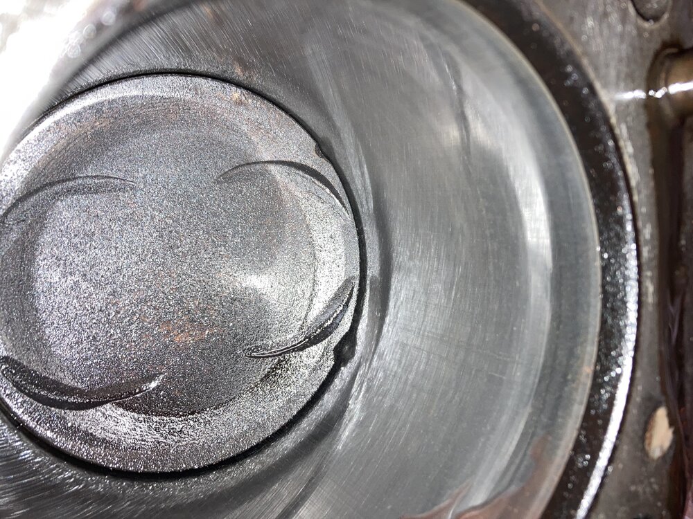

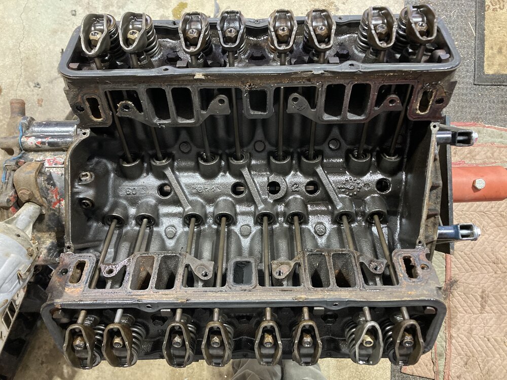

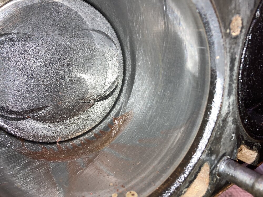

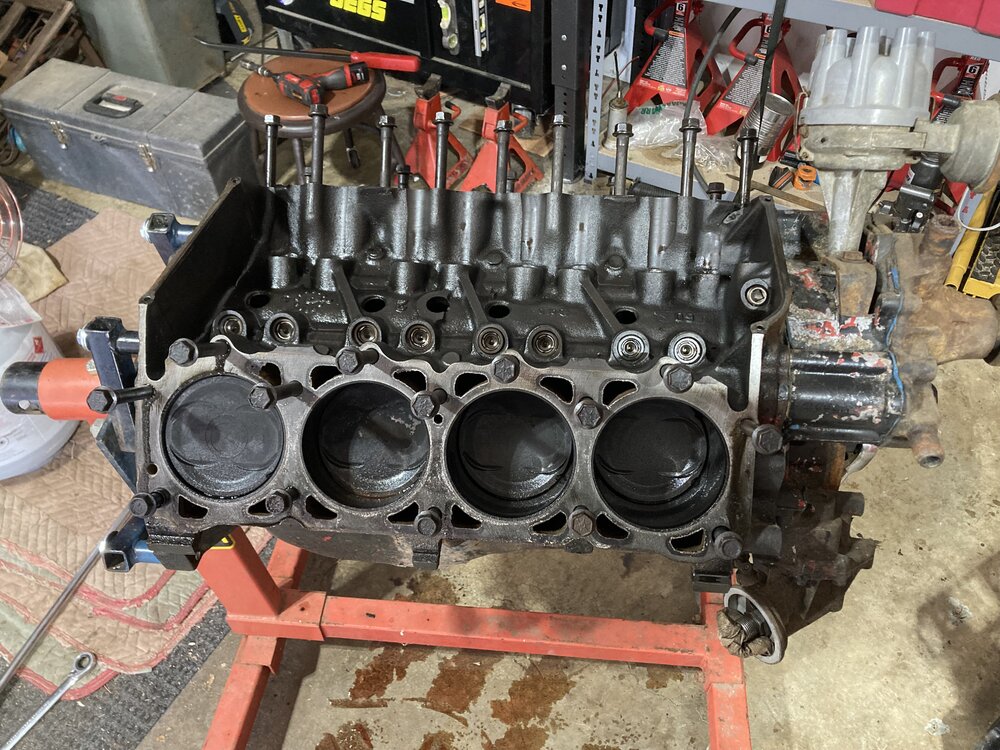

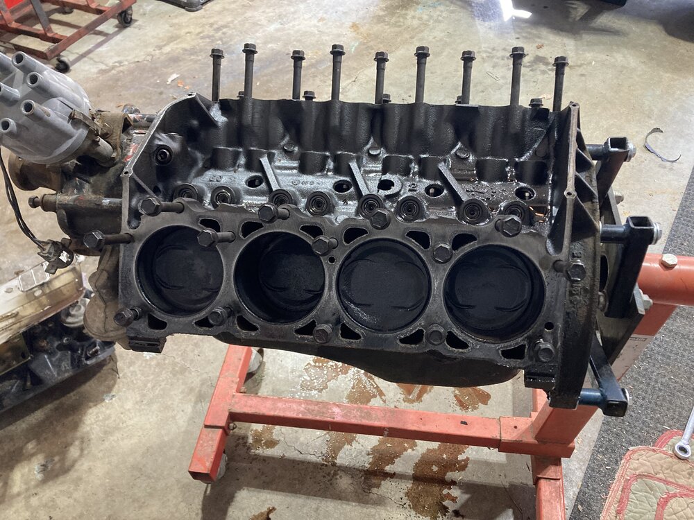

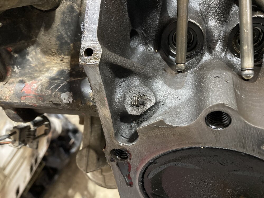

Started tearing into the 360. I'd really like to have this in the Jeep in 2023. My plan, until proven otherwise, is to do this as economically as possible while also throwing a cam and Edelbrock ProFlo 4 at it. I could shelve the EFI if I'm pushing my budget, but I'm really hoping it doesn't come to that. In all honesty I was really hoping to only do top end work, but I figure I'd be shooting myself in the foot if I didn't check bearings and what not while it's on the stand. That being said I do know that I have to go to the machine shop to get the rotating assembly balanced, so I'm debating how far down the machine work rabbit hole I want to go.
Apparently I suck at taking pictures of cylinder walls.
Called a machine shop yesterday, the one I want to use doesn’t have any availability until March.
I’m getting cold feet and thinking about having them assemble the entire short block… I really don’t want to burn a bunch of money because my dumbass didn’t measure a caliper correctly or something like that.
Didn't realize I haven't updated this thread. I dropped the engine off at a machine shop on January 17th. He said it would be about a month before he would be able to get to my engine, at which point he will start measuring and let me know if the block is good, once I get that call then I will start ordering parts. I'm going to have them turn around a long block plus installing and degreeing the cam, and go through the heads.

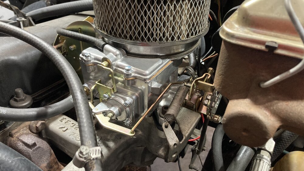

But first, I had to deal with how poorly the Jeep was running. I had checked timing, vacuum, fuel pump, all that and was pretty sure my 8 year old ebay carburetor was the culprit. I couldn't tune out a stumble around 2k RPM, but the real issue was that it would randomly go lean and wouldn't want to run. I'm assuming something is stuck in the idle circuit because I could idle it up past 1k and my AFR would balance back out.
For $60 and some time I could rebuild it, or for $80 I could take a gamble on a chinese amazon carb. So that's what I did.
At first blush (and two weeks of daily driving), I'm very impressed with the carb. I just had to swap over my throttle linkage parts, and adjust low and high speed idle and it cranked right up, idled, and drove better than it has in a few years.
Now that I've put some miles on it I've been fiddling with the choke as it's really rich at startup, but fine tuning should be expected.

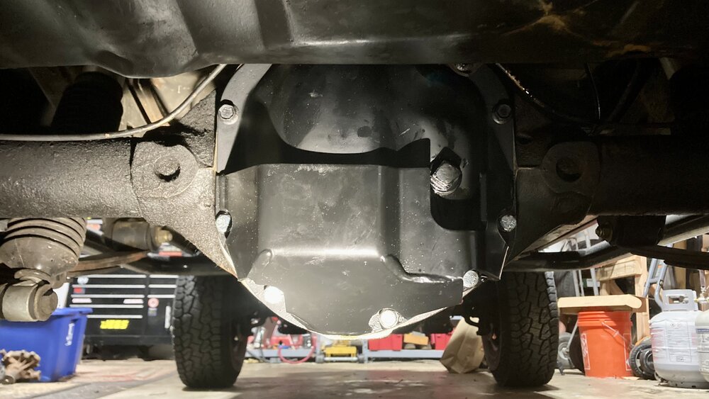

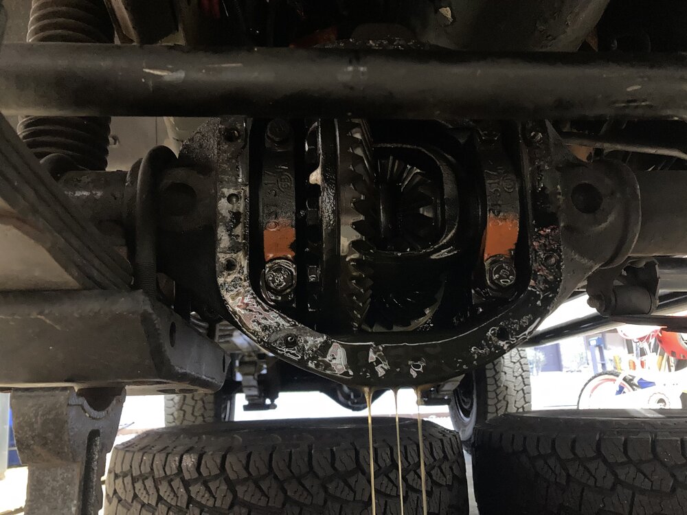

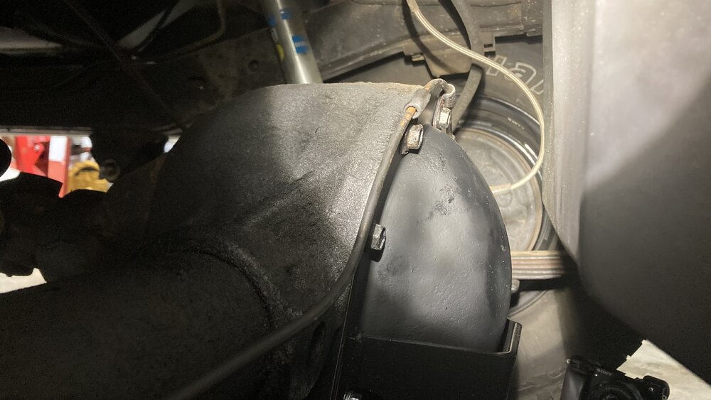

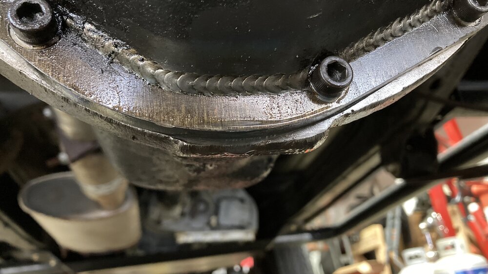

Next on the list was to get rid of this damn drip from the rear end. I have never been able to get this Barnes diff cover to seal. I'm sure it's because I didn't use enough RTV, but I tried RTV twice and a Lube Locker and it still dripped, plus it was really close to my gas tank.
Thankfully I'm a pack rat and still had the OE diff cover sitting around. I cleaned it up and bought a Rugged Ridge diff guard to keep things protected.

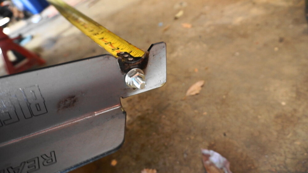

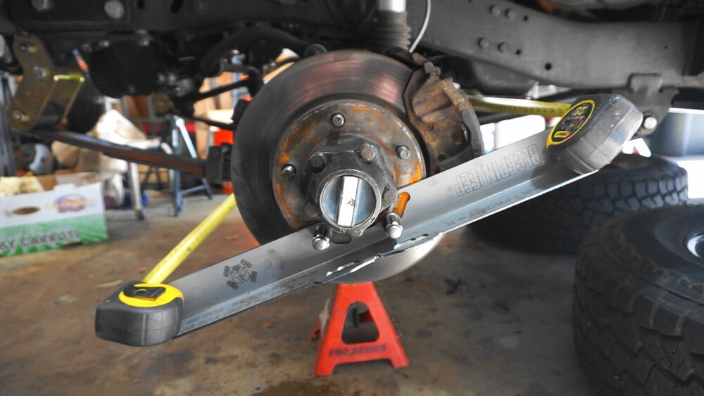

Up front, I was going to take it to my preferred shop up here to check my alignment and all that, but I figured for the price of an alignment I could buy a set of those alignment plates and just do it myself.
I picked up a set of BleepinJeep plates from amazon for $80(?). I had to set each plate at 20 degrees to clear the leaf springs in the front and the driveshaft on the back. I also used some bolts, washers, and nuts to secure each tape measure on the dead side of the plate.
My baseline measurement showed me at 1/2" toed out, which was surprising. I fiddled with it until I got to the prescribed 1/16 toed in.. but now that I'm looking at it I wonder if I should have accounted for the 20 degree angle and gone for more 🤔
