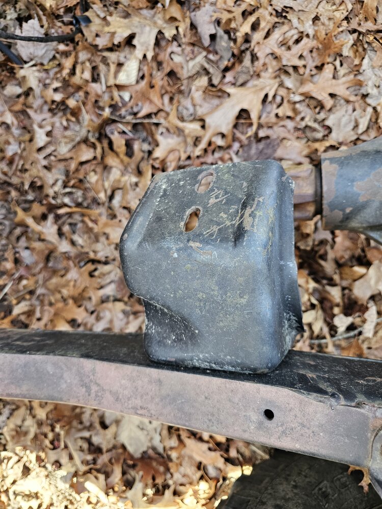

Should have several here, despite being on Commando frames...
ohhhh let me know if you do.Should have several here, despite being on Commando frames...

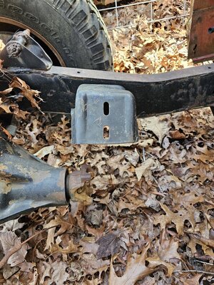

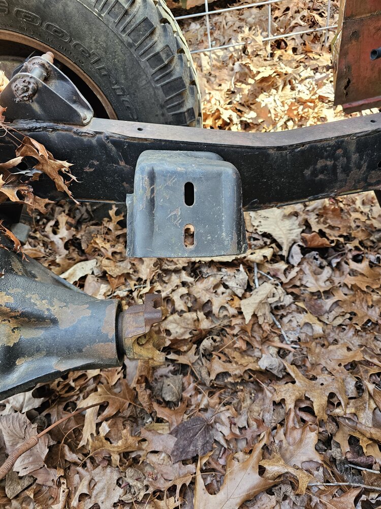

Dern. I'll see what @Caver Dave scrounges up before I go hunting elsewhere. Do you have a contact for Michael Joyce? I don't have fb.Yes, You have the wrong one. That is off a J truck. You need one with the slots offset and it will go in like butter. Omix sells them new but they are proud of them. $140. I don’t have anymore currently or I’d gladly send you one. I’d bet Michael Joyce has some. He sells parts on all the Facebook groups. Near Lexington NC. Some pics of my passenger side below
View attachment 434980View attachment 434981View attachment 434982
PM sentDern. I'll see what @Caver Dave scrounges up before I go hunting elsewhere. Do you have a contact for Michael Joyce? I don't have fb.
I feel like if I'm going to end up having to buy a repop I'd rather spend a little more and get the MORE mounts
Received. Thank you!PM sent
I thought you were looking for CJ AMC V8 frame side brackets?That looks like the style I have now :/

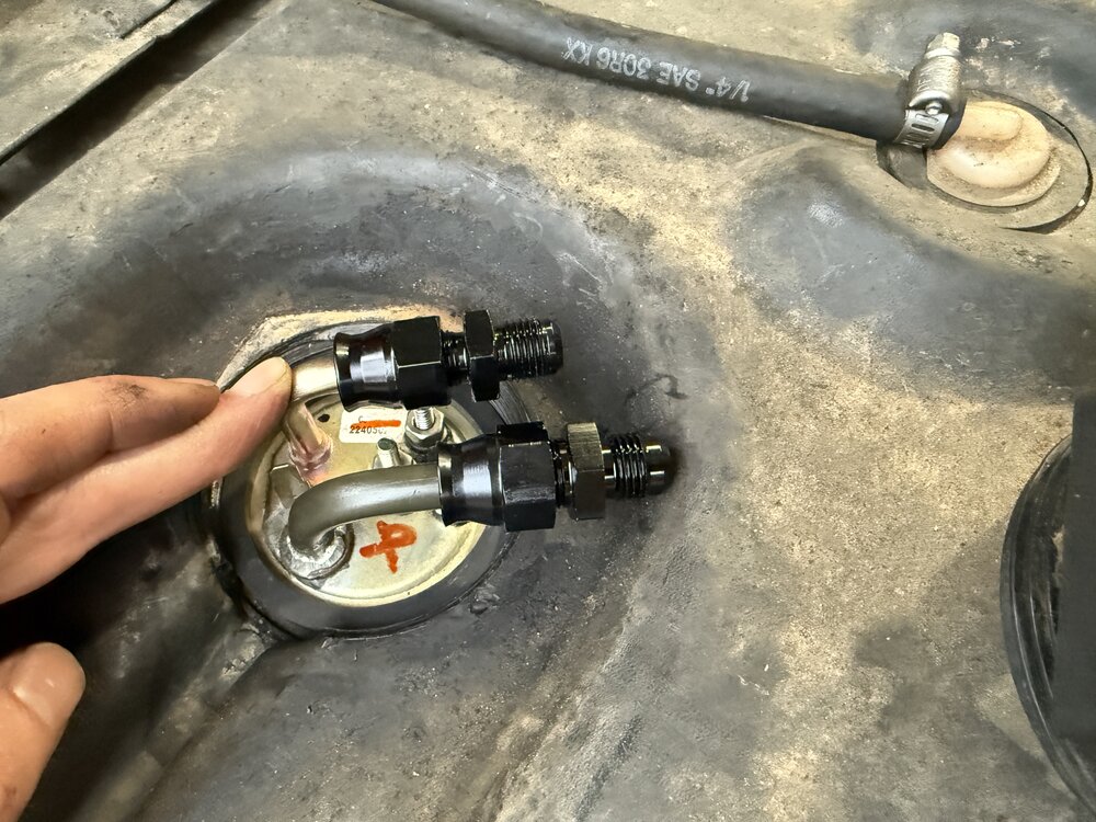

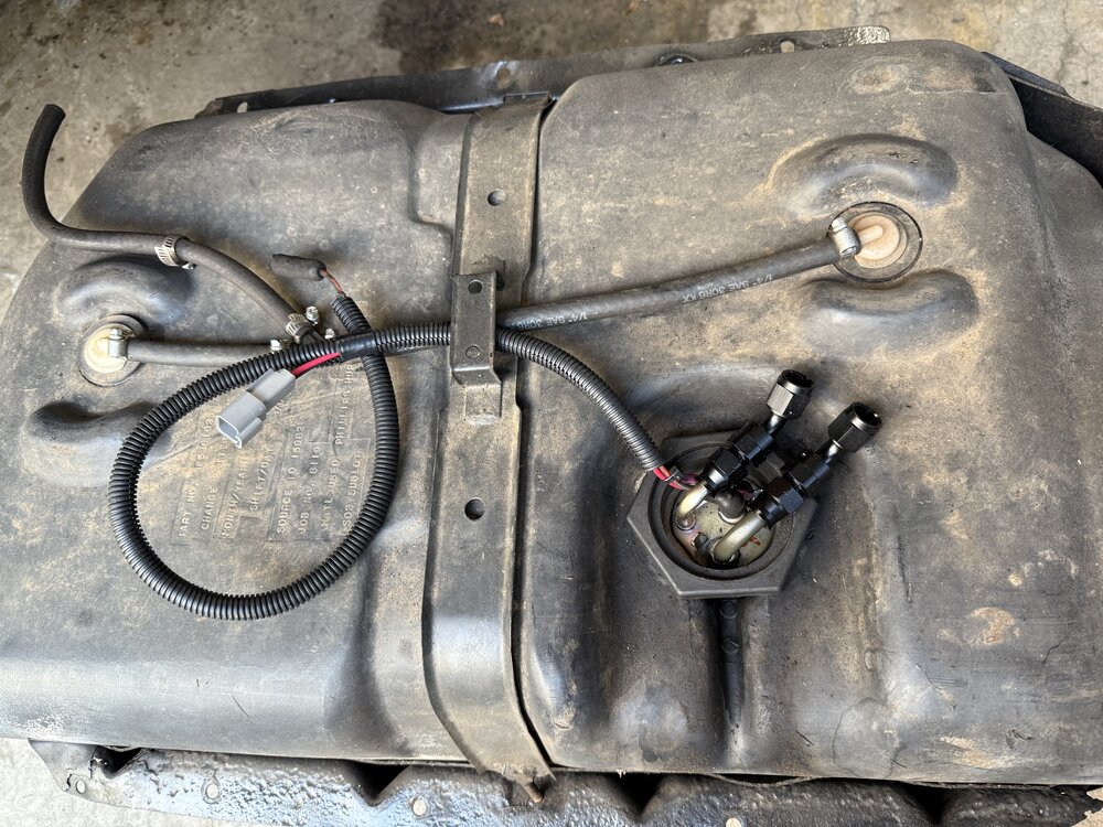

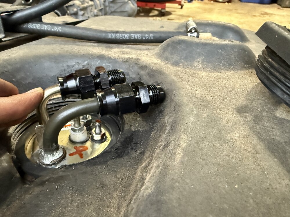

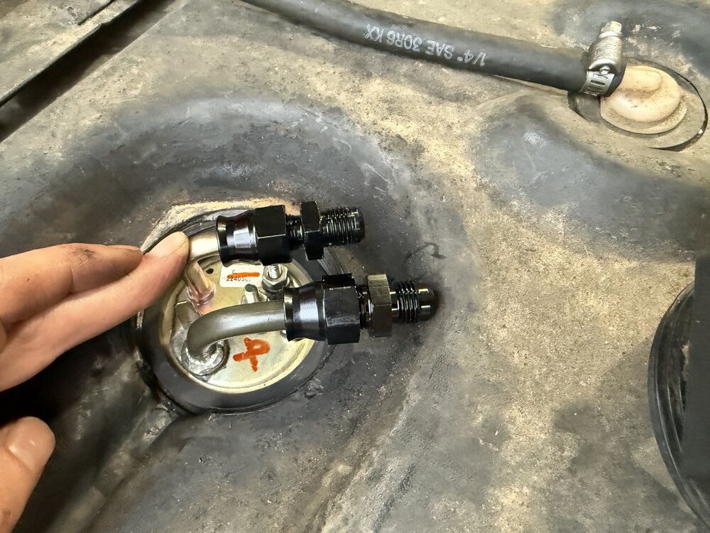

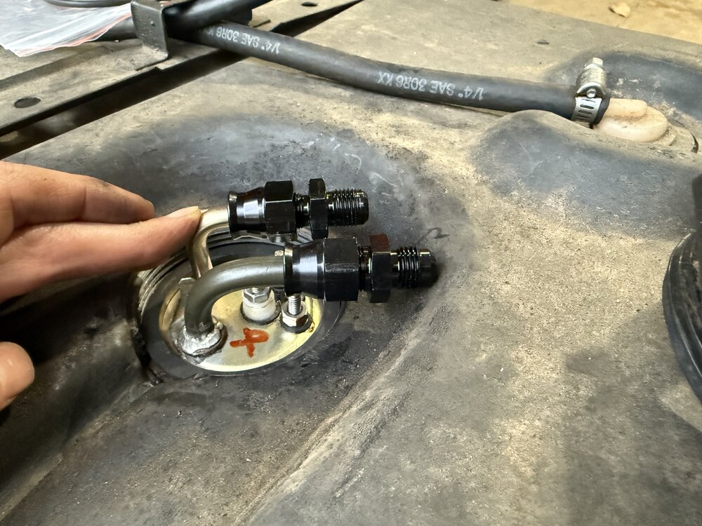

Tighten it another 3/8 of a turn?Also ran into my first hiccup; the -6 fitting off my new 3/8 line crashes in to the tank.
Gotta figure that out
View attachment 435825View attachment 435826View attachment 435827
Gotta get another fitting on there thoughTighten it another 3/8 of a turn?
I mean the whole assembly. Looks like it threads in to the tank.Gotta get another fitting on there though![]()
ohh I see what you're saying. The sending unit actually sits flat on the tank and is tabbed into place.I mean the whole assembly. Looks like it threads in to the tank.
I was assuming I'd have to cut the fitting off anyway depending on the state of the ferrule. I'll see if I can bend the tube someYou wont be able to get the fitting back on if you cut the existing tube. Can you use a tubing bender to bend the tubes up some? Or change the tabs on the flange to rotate the sending unit towards the recess in the tank?
