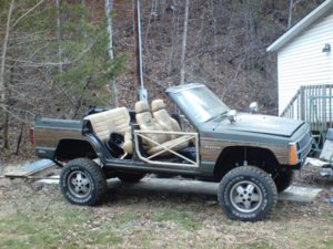

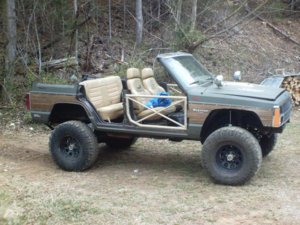

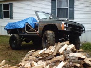

this is my piece that will not see a trail untill i cage it
A cage would really make it safer but it looks so COOL right now I'd hate to see you put one on!
Indeed. But if he were to try and drive a trail like that, the jeep would probably fold right the hell in half. Damn unibodies. :flipoff2:
(would be humorous as hell though)
probably gonna do an inner cage basicly same concept as a cj gonna weld uo some rock sliders and tie into them thru the floor board so it still gonna look pretty cool but be safer
33s

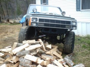

just playing around on wood pile before bigdaddyjk came and picked it up today to start on cage HAMMER DOWN

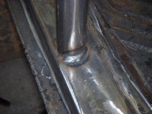

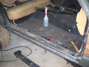

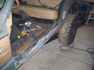

Here are a few pics of the cage that scoutdawg and i are putting in bulldog98's Cherokee. These first couple of pics are of the top side of the rocker panel we welded in 1/8in metal to strengthen it up.

Ahahahaha no more "B-pillar" either huh well I guess it was only half there to begin with

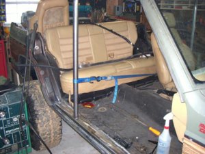

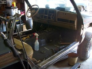

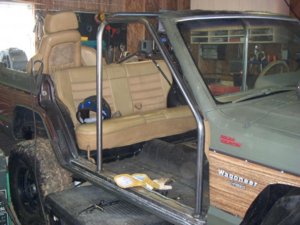

Here are some pics of the first hoop where the middle piller used to be. The jeep was already cut up by the previous owner had cut the entire top off why i don't know but we are getting it trail ready!

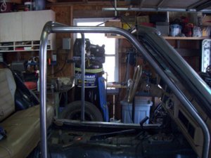

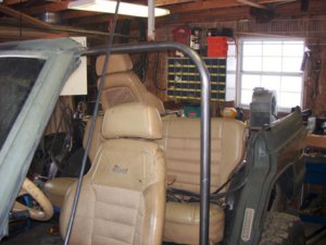

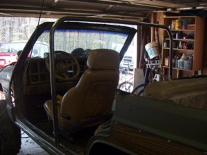

This is our passenger side entrance hoop, so far we have ended up with some good lines with the bends. Scoutdawg, jermey1977, and i went in together and bought a bender to put at the shop well i say shop but it's scoutdawg's garage he lets us treat it like its our own thanks man!! We have less than $650 in the hole bender that's bender with air over hydraulic ram works great!
