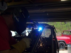

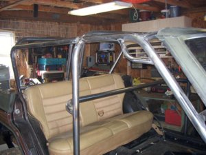

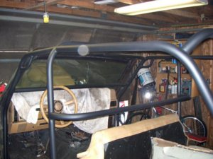

87 chopped xj
M
Thats all folks! for know

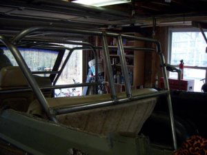

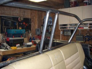

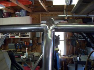

it already has alot of re-enforcement to the top of the rocker panel we added 1/8 plate to that to weld the cage to. And of course we will re-enforce the "fake frame" and add some gussets. And plenty more we will keep you posted!

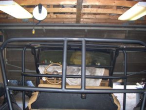

here is a pic of the c-pillar tube, and we have also installed another tube along the line of the top side of the back seat. Also we welded in two bars between the c-pillar and the lower c-pillar so that we can make a spare tire carrier. So not quiet done but i will post more pics. Thanks

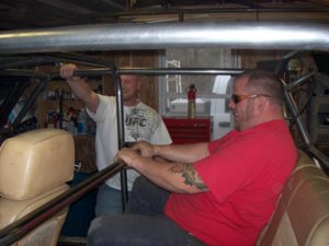

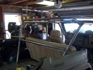

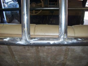

Check out scoutdawg and bulldog98 f___in around as usual ha ha ha. Just checking out the back seat to see if the tube are in good placement. Looks good to me !

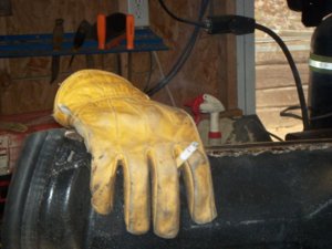

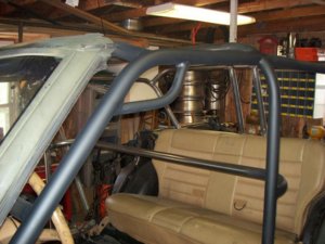

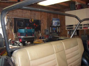

This is the start of the spare tire mount, we will add some plate to it and build out off of the plate probably use some wheel studs to mount the wheel.
Cage

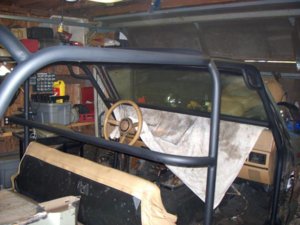

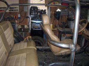

Well here are the finishing pics got all the welds ground down and looking good then threw some paint on that bare metal. The cage is pretty much done, and hopefully i will get some pics tomorrow of the cage when i get the jeep out side. And now we will see whats going on with the front bumper. We will keep u posted!
Chris
