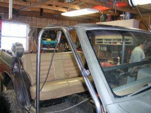

87 chopped xj

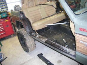

Ahahahaha no more "B-pillar" either huh well I guess it was only half there to begin with

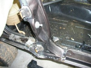

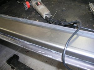

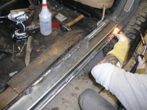

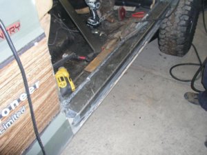

Your right there wasn't one to begin with and that B-pillar is a add on piece to the top of that rocker panel from the factory we just drilled out the spot welds and it came right off. So why not just take it off and make it more sturdy and have a good place to start the new B-pillar.
More
And another view.

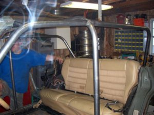

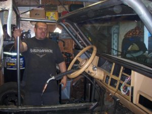

More

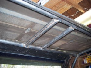

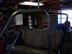

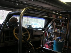

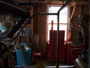

Here are some pics of the top truss and i made triple sure that it was not going to be a skull buster. We also added a truss at the top line of the dash more security but most of all an Oh shit handle. Ha Ha

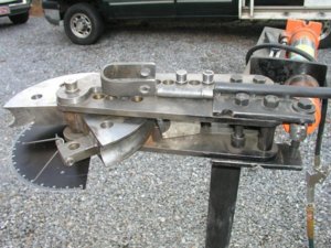

i think thats gonna look sick nasty, what bender is that? or did you piece it together, i need one real bad
This bender is built locally by a guy that has been making them for a while, less than $500 for the bender and if you want different dies i think those are $250 but he really does a good job. If you want i could get you his # just let me know. And thanks we should be finishing up on the cage by the weekend i will post more pics.

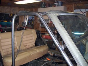

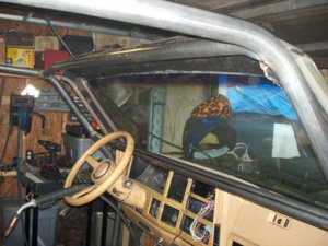

Pics

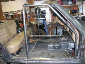

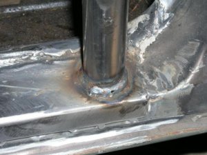

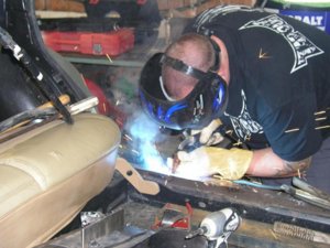

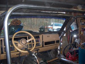

Here are a few more pics to add as we added the center posts and the rear pillars we still have a few things to add and will post more pics as we finish up.
