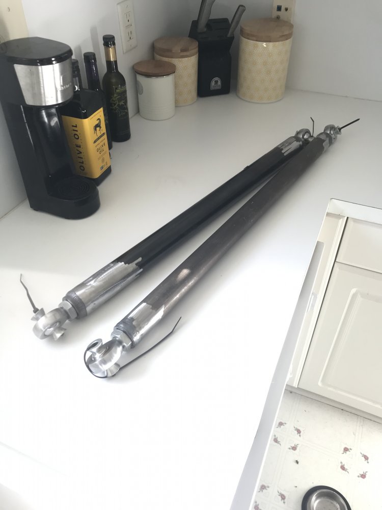

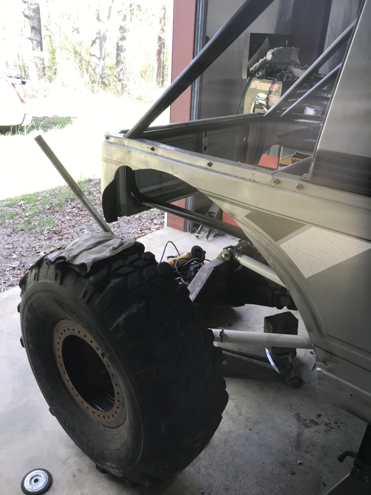

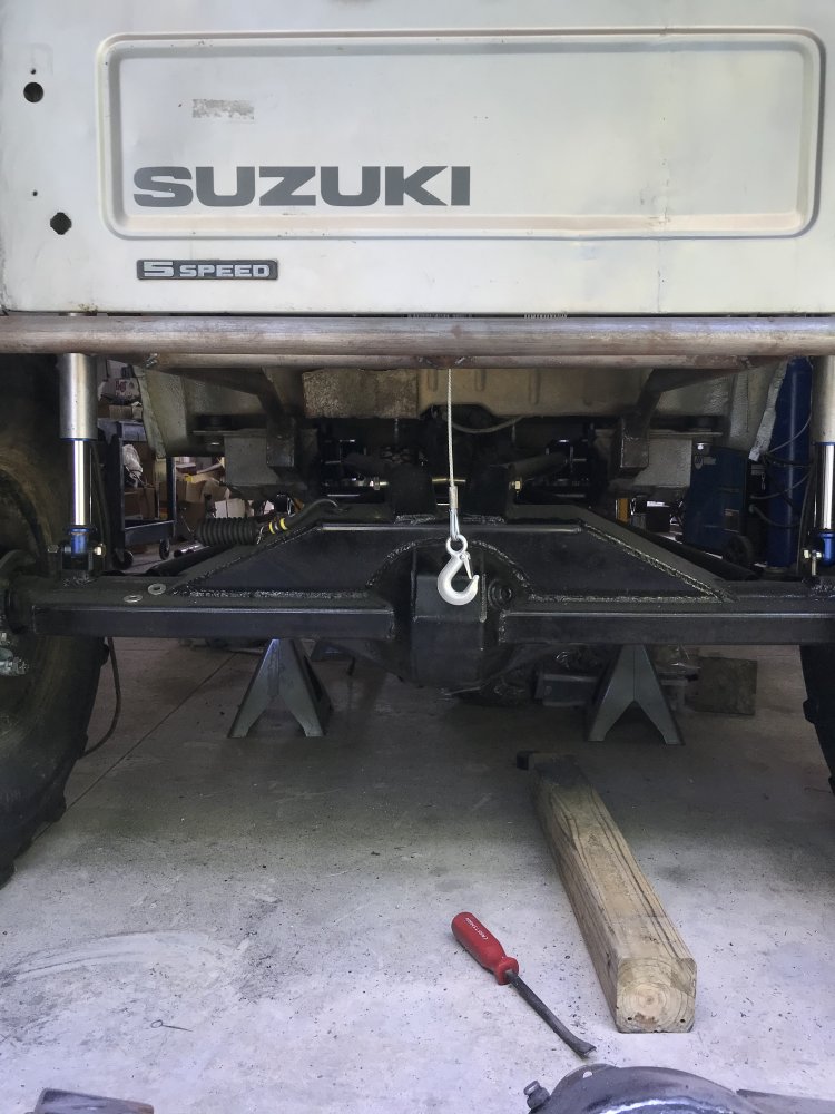

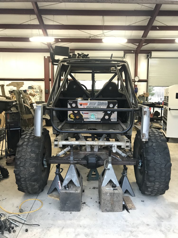

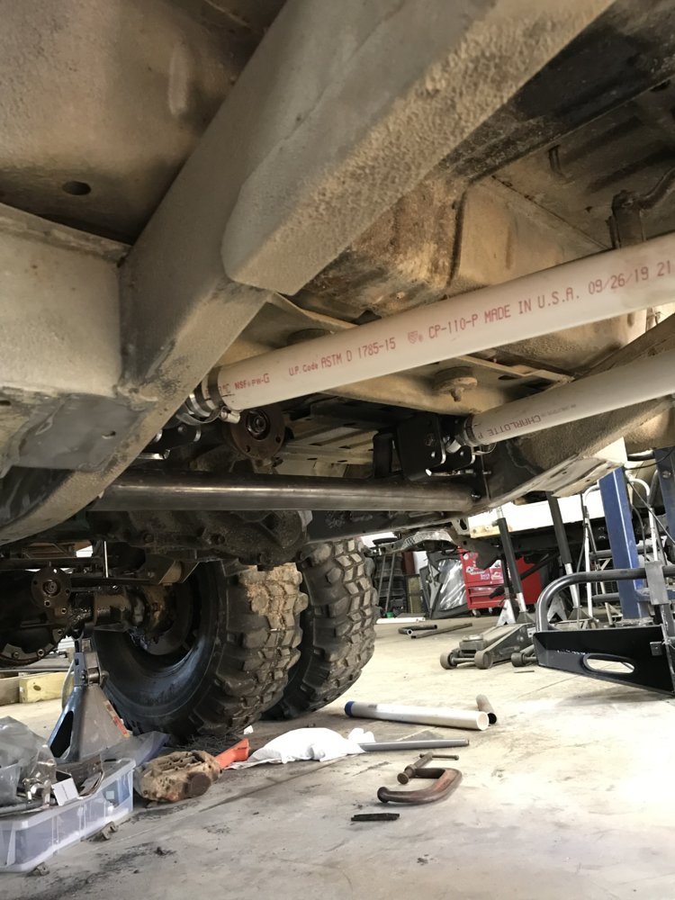

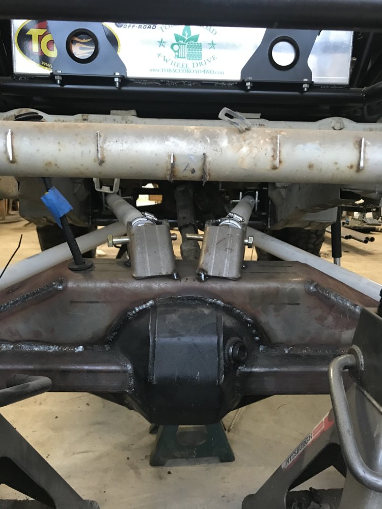

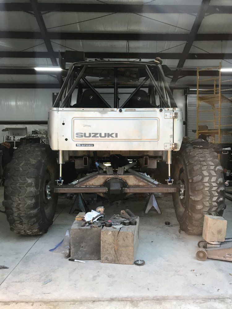

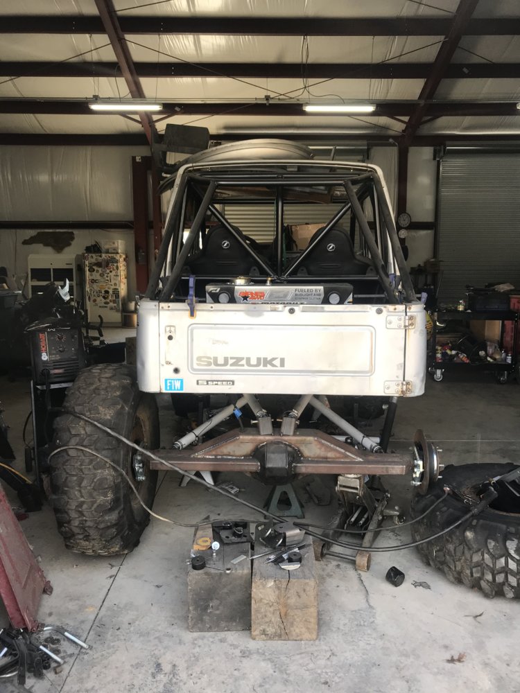

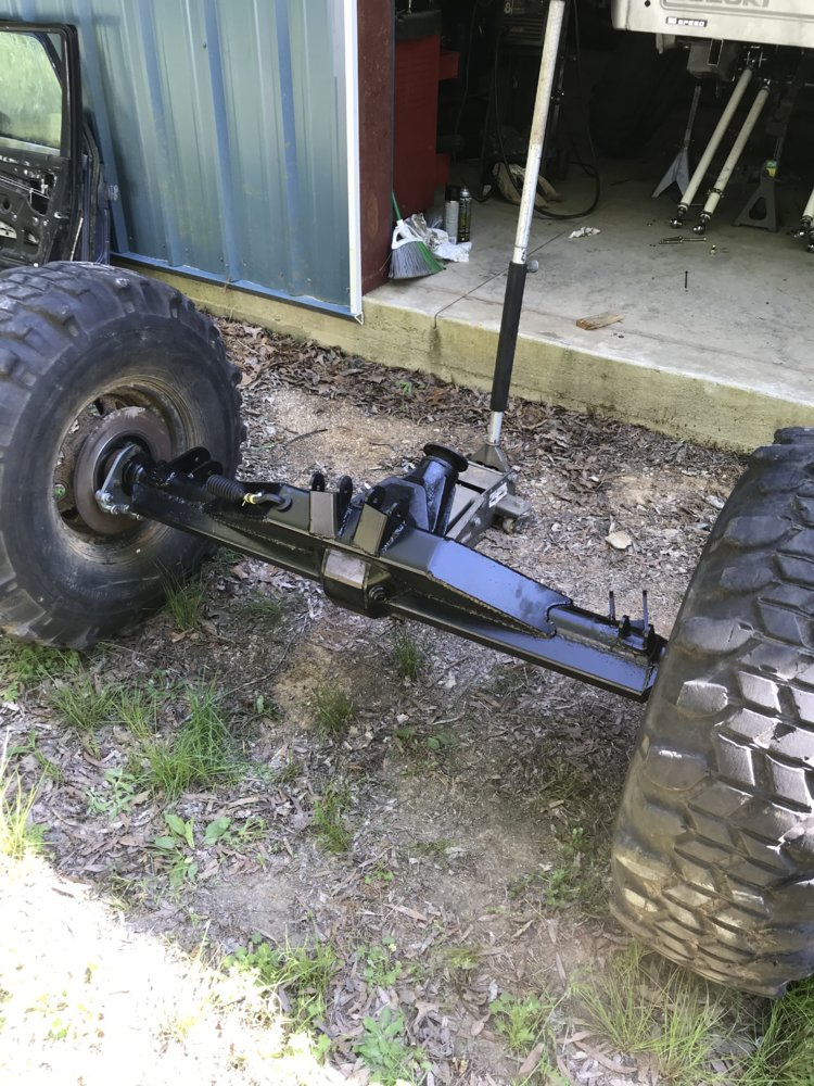

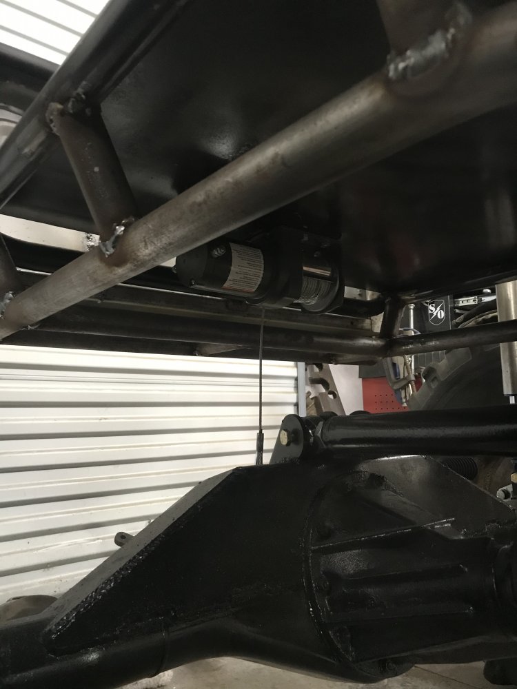

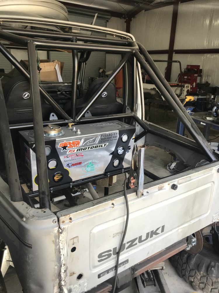

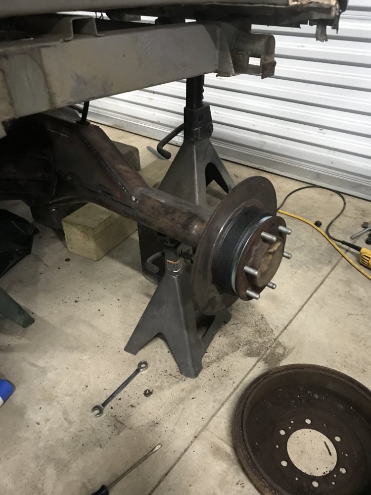

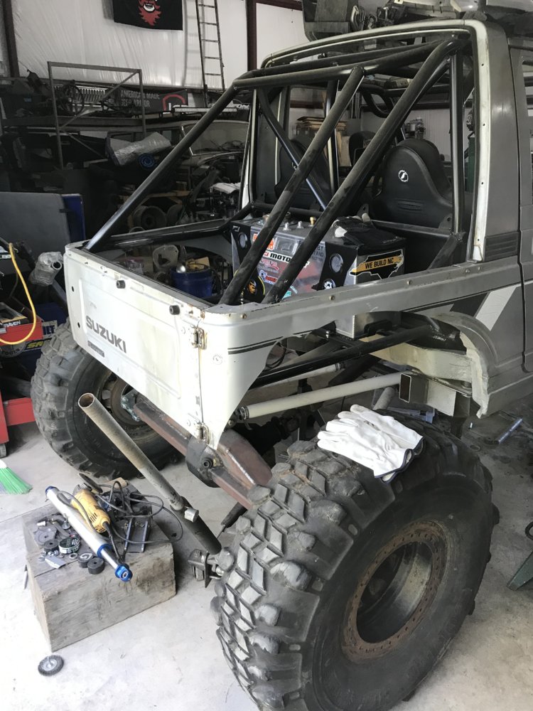

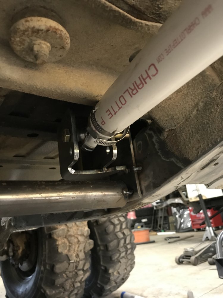

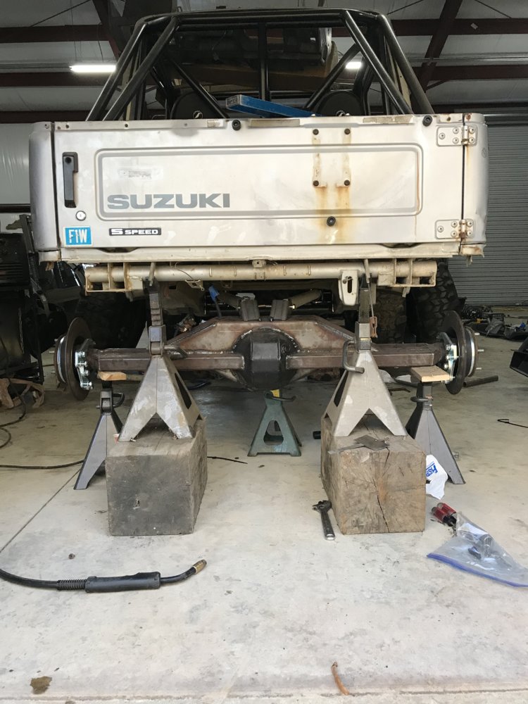

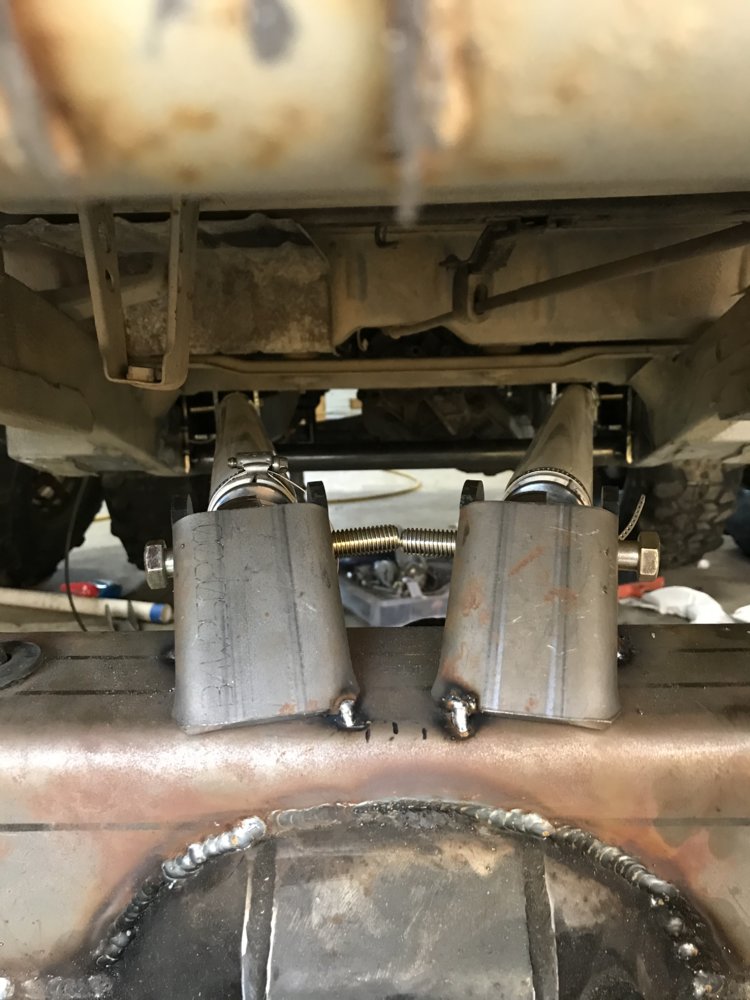

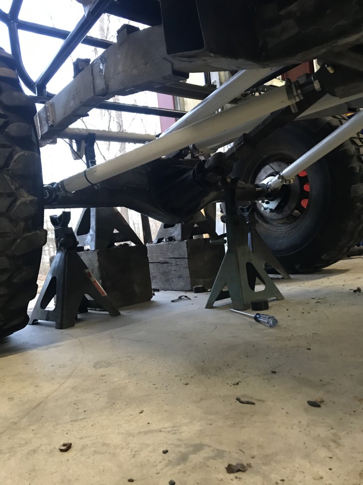

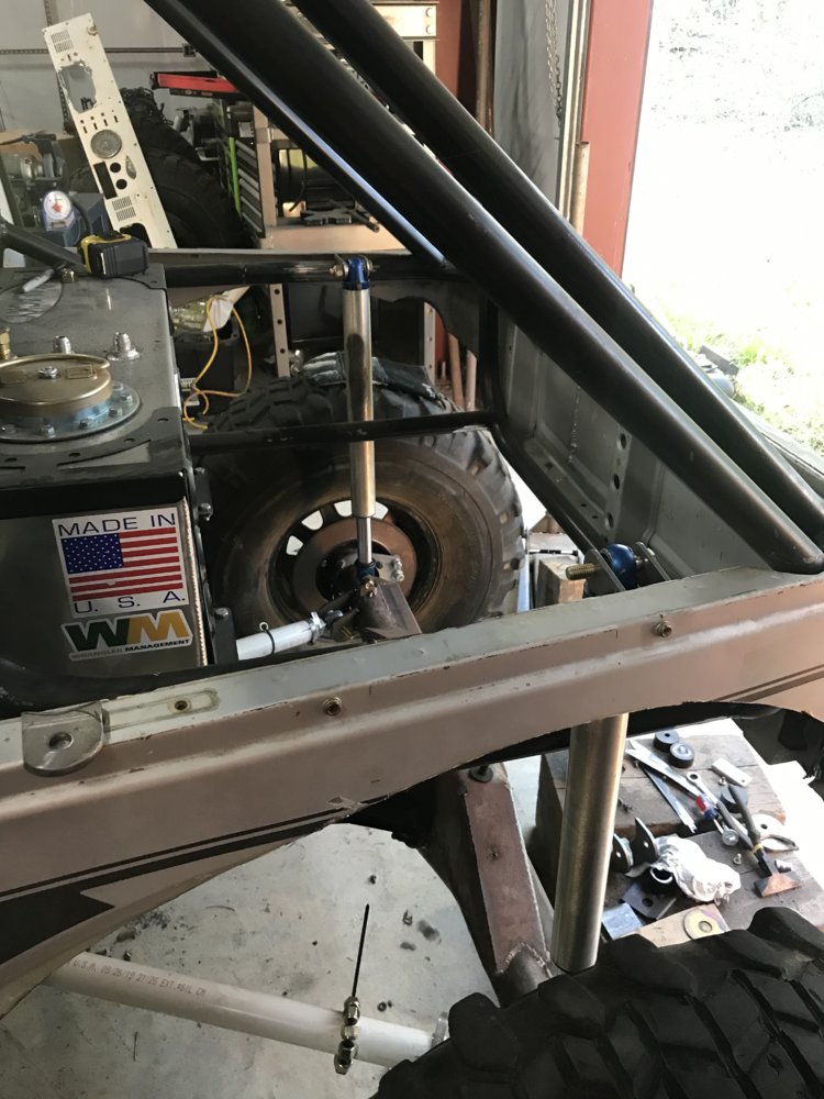

Yesterday’s progress. The link kit is a Barnes4x4 triangulated upper with a parallel lower. I decided to triangulate both. The bar across the frame rails is 1.75” .188 wall and it will clear the driveshaft. I left enough space in case I run a doubler in the future.

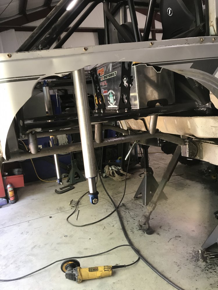

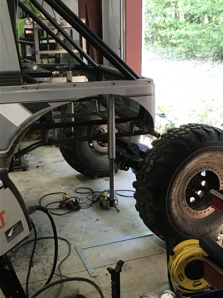

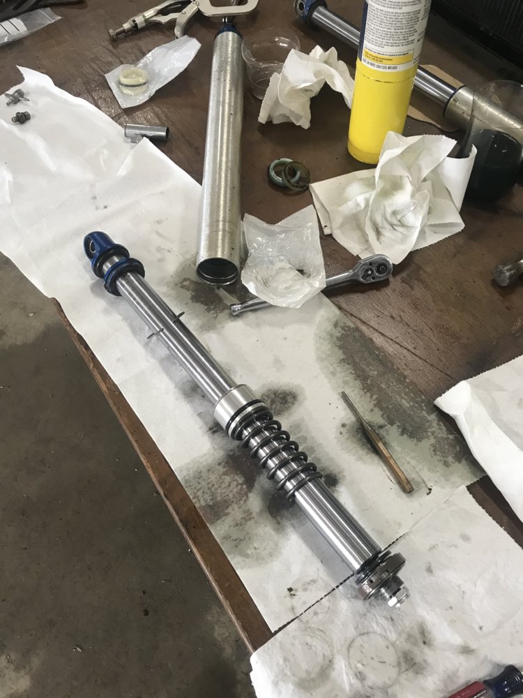

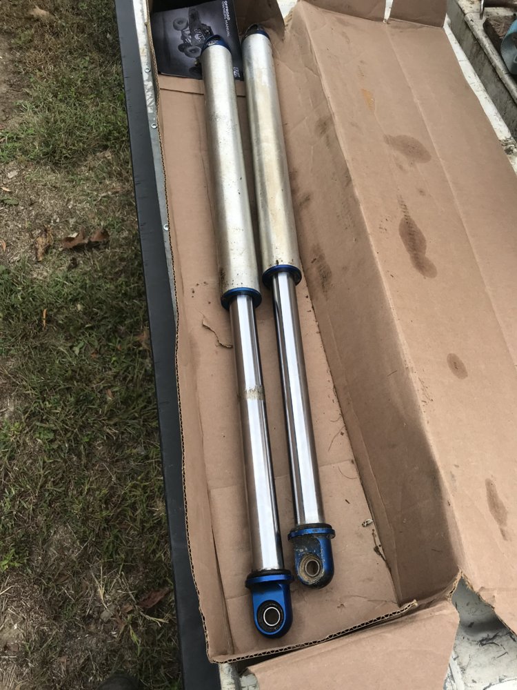

You do any re-valving in the air shocks or just do a refresh?
Air shocks finally. Hopefully this weekend I will get some more tube bracing installed in the rear, pull axle and links out for final welding, paint.

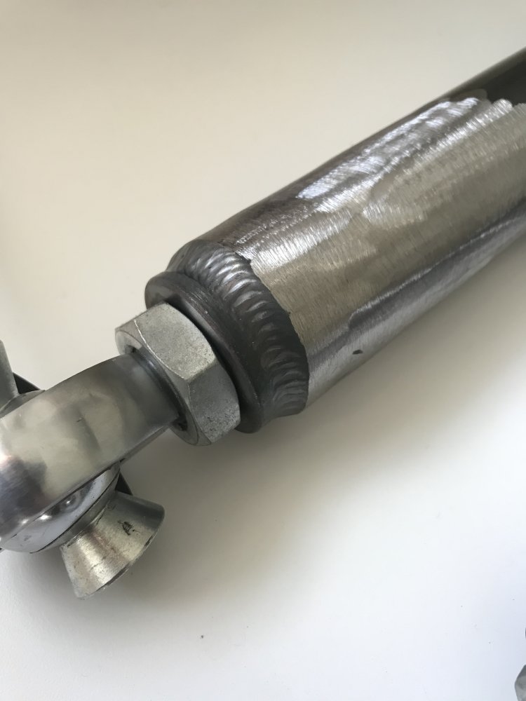

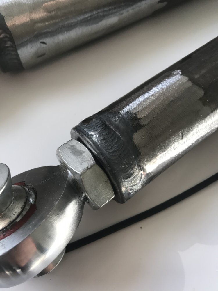

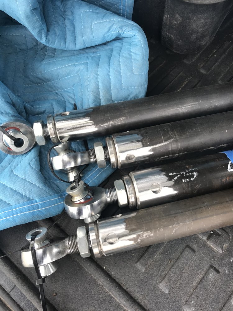

Adam did a fantastic job on the welds. The Heim joints spin with ease.

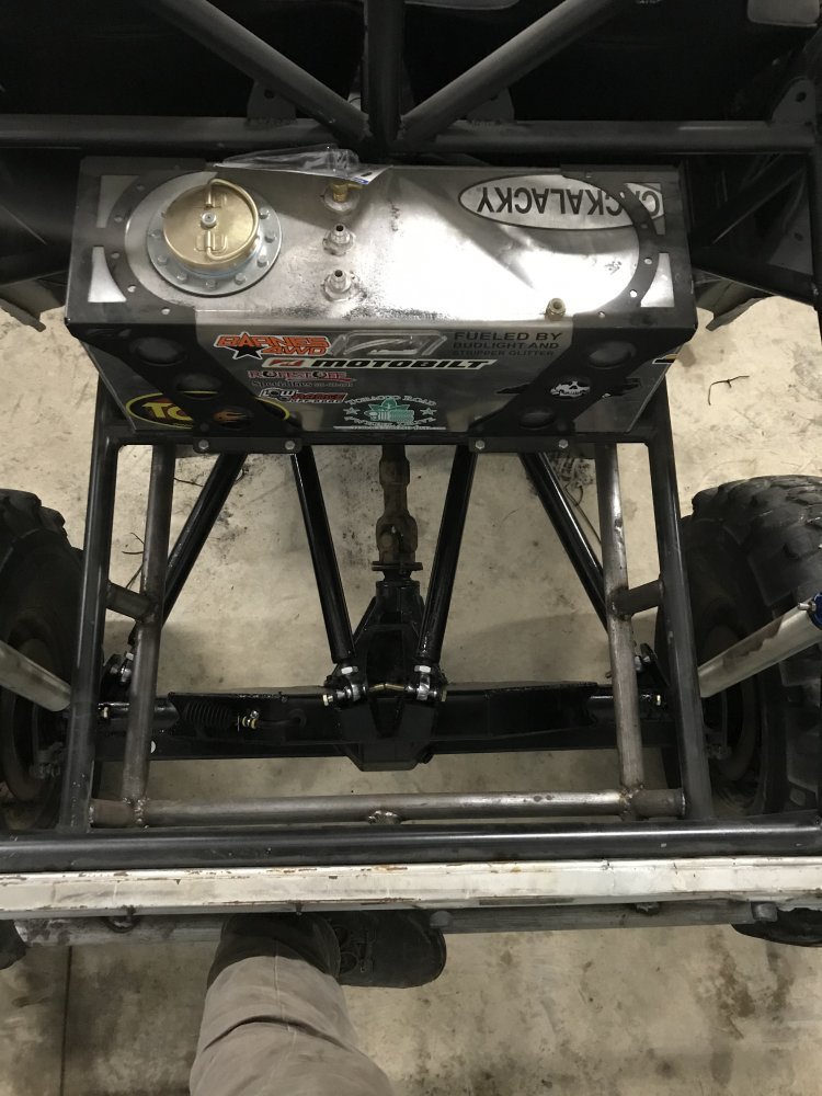

Talked to Barnes4x4 today ready to order the front kit and their equipment is all down for maintenance...two week minimum wait time to even place an order. Disappointing but it’s a part of it.

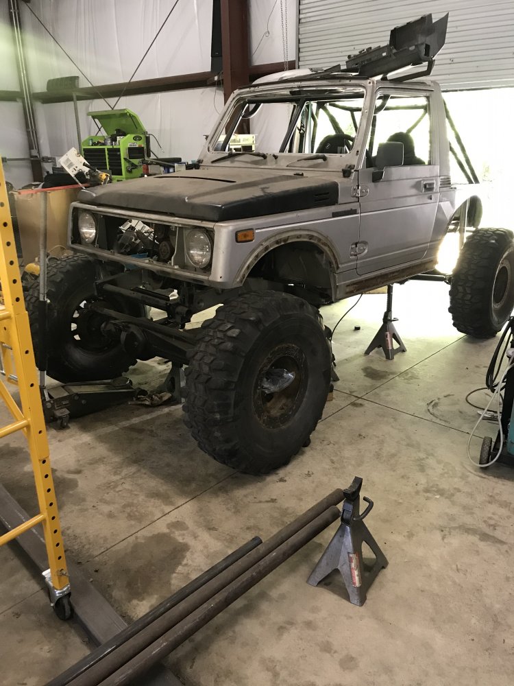

Not much progress lately. Work has kept me busy and I have been doing a lot of side jobs. But I lucked out for sure. I waited for over a month to order my front link kit from Barnes. I checked 3 times a day on their website for it to say that it was in stock haha. The morning of July 4th, I pulled up the site and it was finally on stock. I received it last week with the DOM. Just need to get going on it.
My front air shocks should be in next Friday too.
