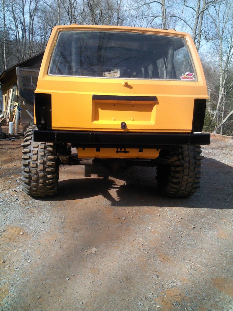

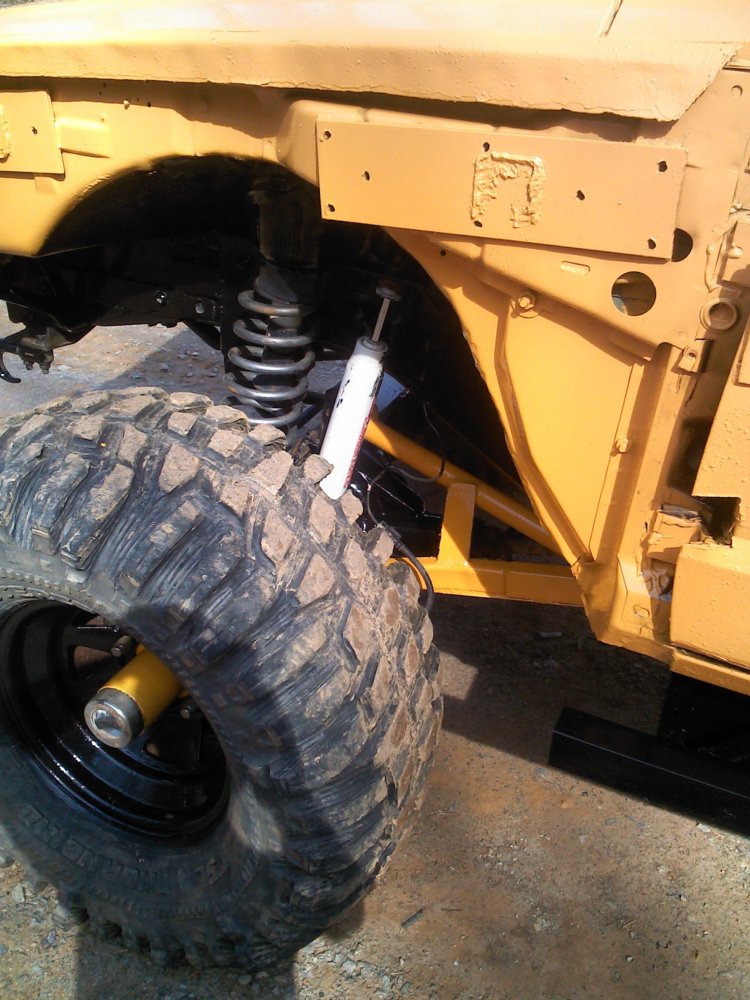

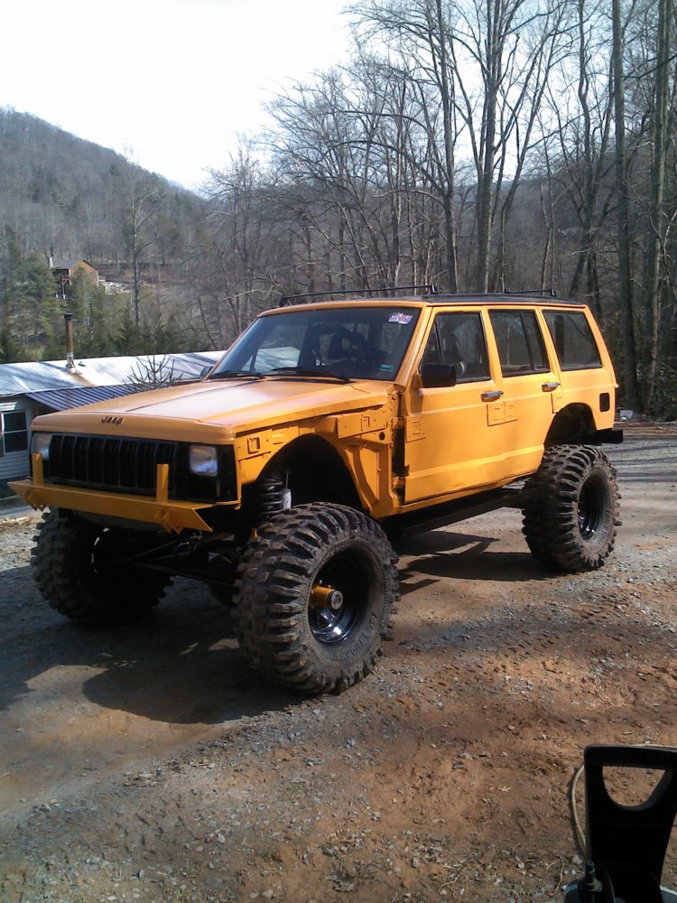

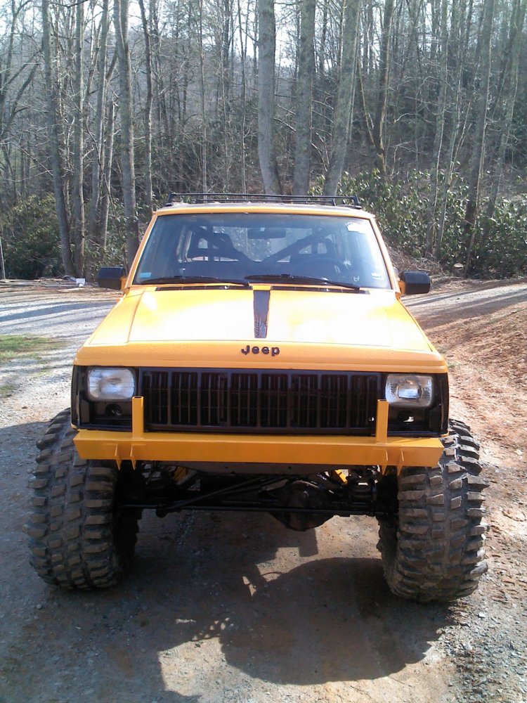

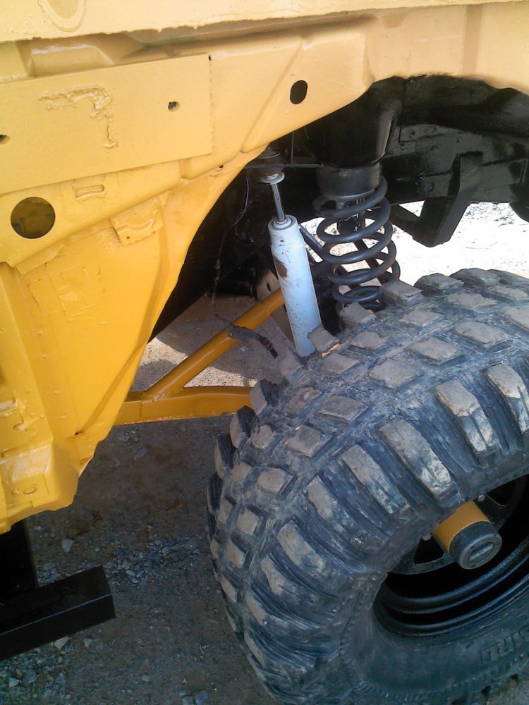

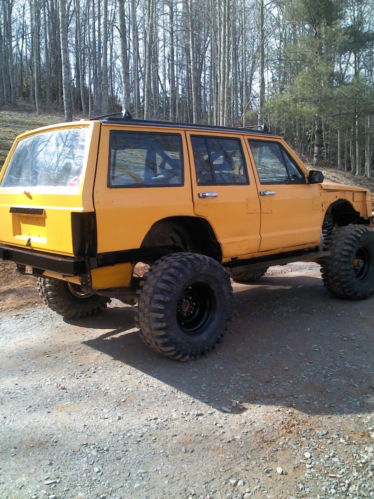

Well the Jeep got a "Makeover" lol and ready for this year's season.....remember it's a toy so i just rolled & brushed it on no taping just a quick cut in and roll. Figure with new bigger axles and gearing it needed a new face. I like it much better!!
I have to admit, i was really amazed how some good paint (especially thick oil based brushed/rolled on) made such a difference on stuff like the front bumper and control arms....i really like how the front bumper looks now and my control arms look halfway descent painted...for me anyways.
and yeah i should've cut that one plate even...got in a hurry to get it done and out of the way.
