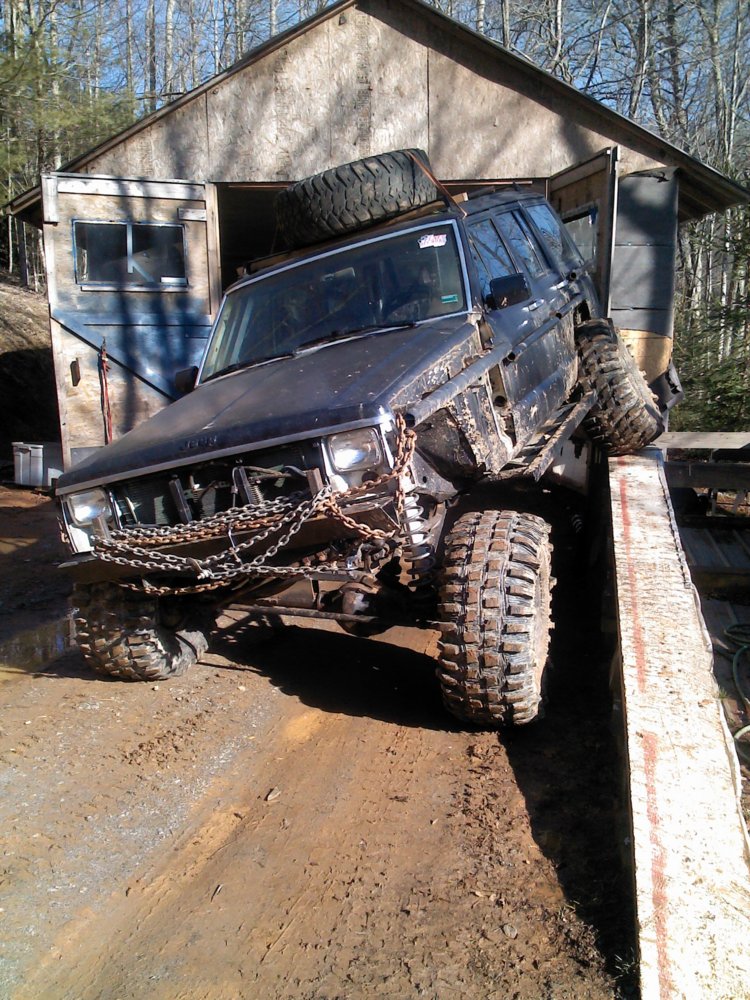

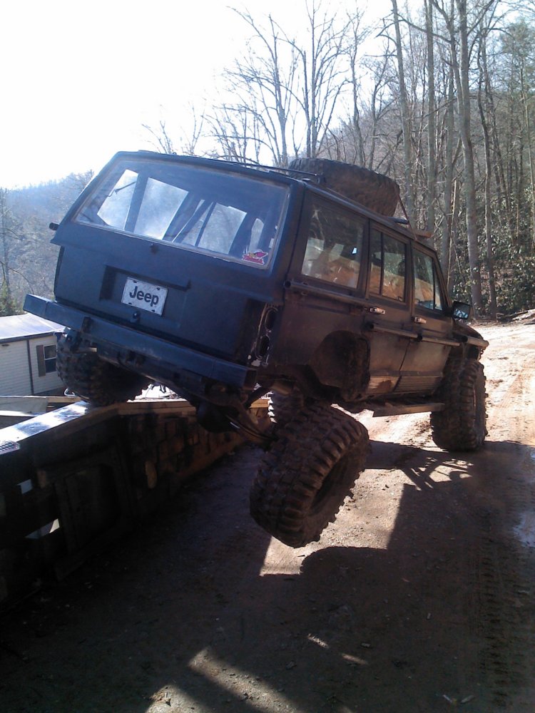

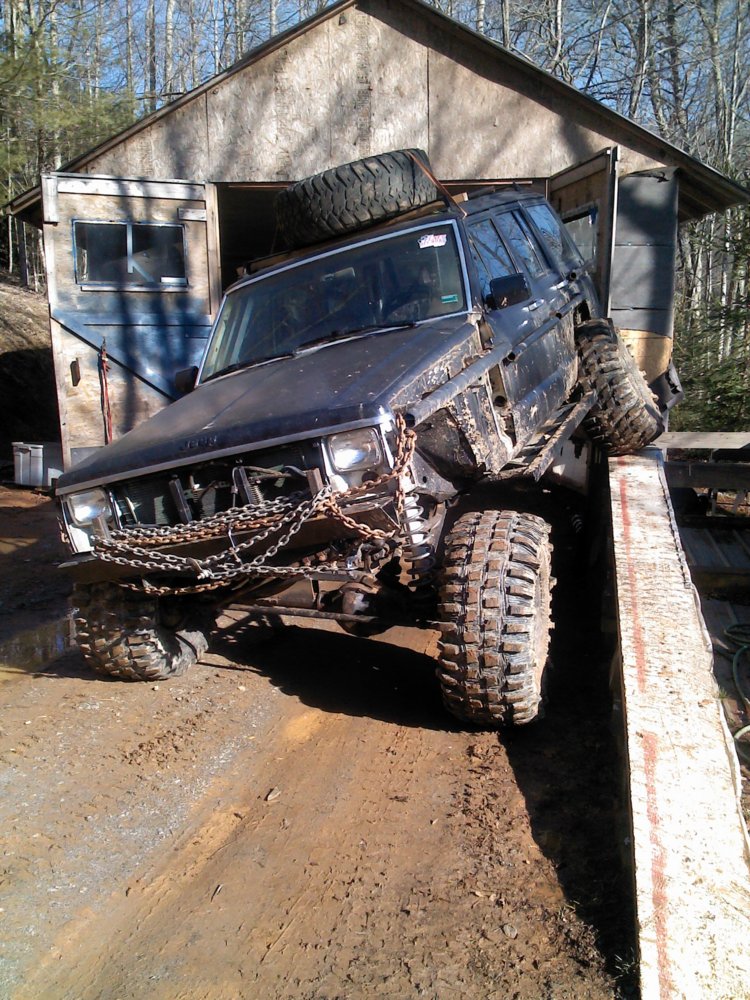

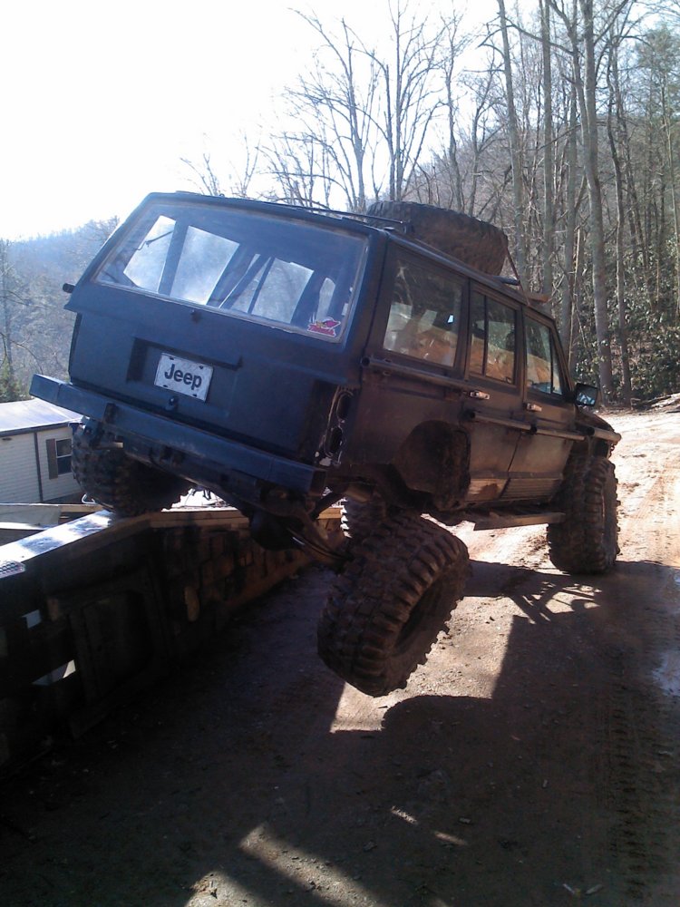

Installed a full Chevy leaf pack using the main leaf off the XJ and netted me right at 7"lift with ok flex i guess...need to redo my shackles I think but nice to have a good strong arch back in my rear leafs....front track bar is limiting some but still ok for the setup...it wasn't that bad unstable for tire off the ground a foot or so lol
is the shackle what needs to be extended or move the shackle box forward and down to get more droop without adding more lift??? little help on that rear to get more flex or is that the best it will get with thicker chevy leafs

What size are those thornturds?
I like to cut groove strips in my main leafs for waaay improved flex.

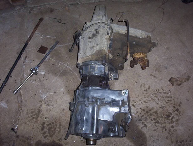

oh yeah, having to put hold on doubler since my rear driveshaft would only be rougly 12" long and the front well....really long.
probably dumb question but that is too short for rear right? even with double-carden joint on one end? figured it was so i cancelled even attempting to go further with it after i took measurements with both under it. bummer. gonna have to rethink the whole twin case setup unless i stretch the wheelbase all the way back

Your "flex" picture of the jeep with the passenger rear tire a foot off the ground shows nothing.
I've done one and it was with the proper kit and put together by a professional...now I was wanting to do it without the 600 kit but don't have the drivetrain length for that setup..
this is what I'm wanting to do
but wheelbase isn't gonna work unless I extend it which is not in my build plans anytime soon..
and the picture i just thought it was cool wasn't trying to prove anything.

To get more droop out of chevy springs you need the main leaf. Only real benefit of them is the length..
