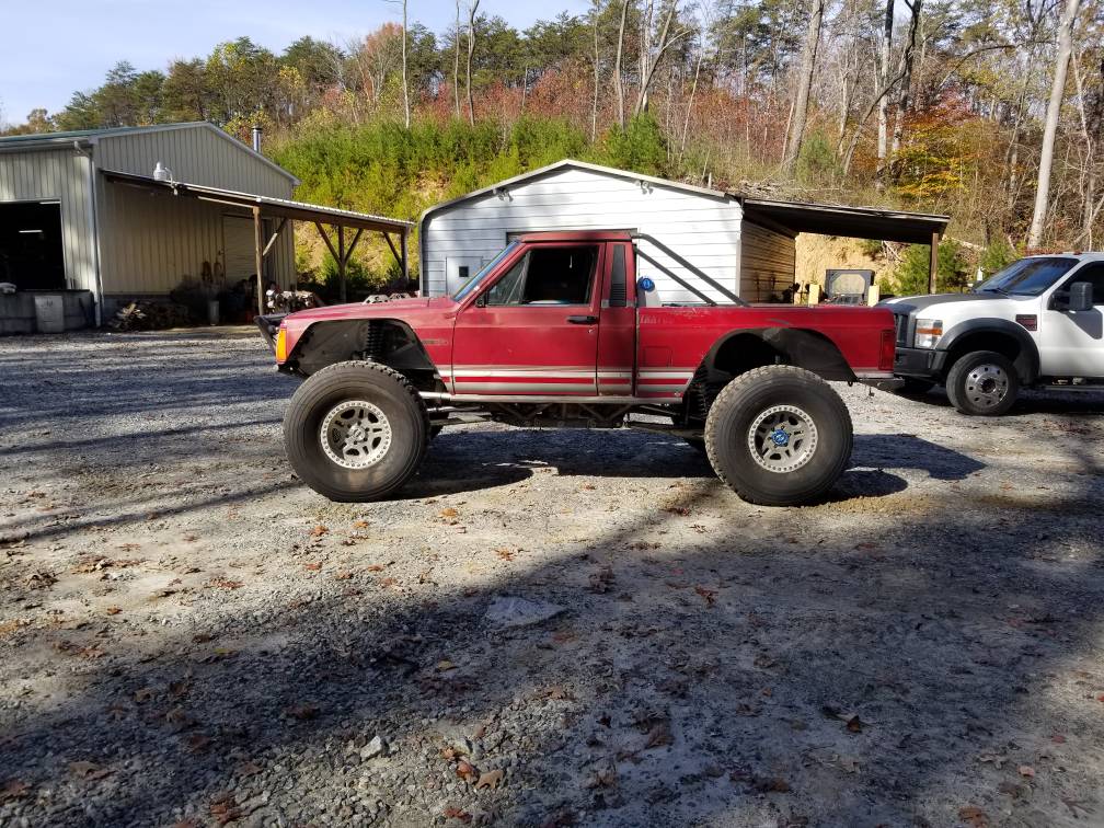

So did this War Chief see some dirt???

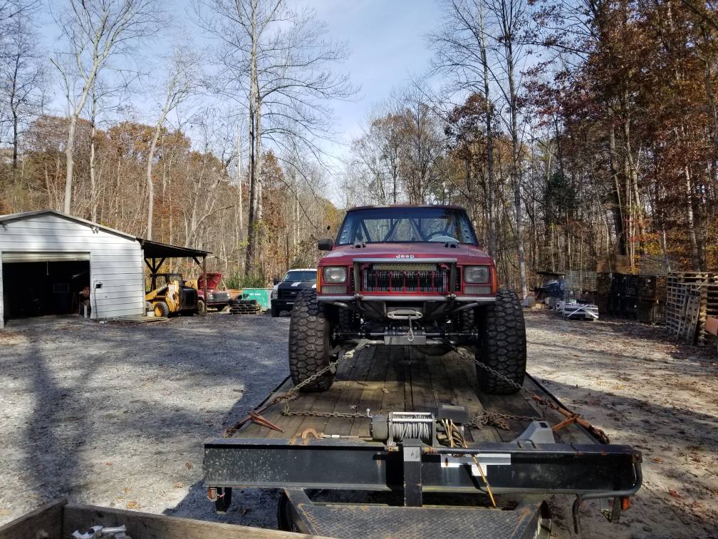

I passed you on 109 just before you got to the Outpost. I had to get pops back he was jonesing to see his wife in the hospital and his 78 year old ass was tired from being on the trails since 9:30
You have no idea how hard it was not to turn around and follow you back just to see this thing in person, but his love for his wife and my desire to get him there back to Winston before dark to see her was a little bit greater.
But it was a pleasure just seeing it on the trailer

Got it running, and tightened up enough to drag it down to the veterans ride. Only half the floor pans, slight water leak, rear locker not functioning correctly, all shifters still needing some adjustment, and couple wiring tid bits.... but enough to come down and pay respects to our veterans, and visit with many old friends and new around the campfire for a few hours. No trail riding, just cruising the parking lot.

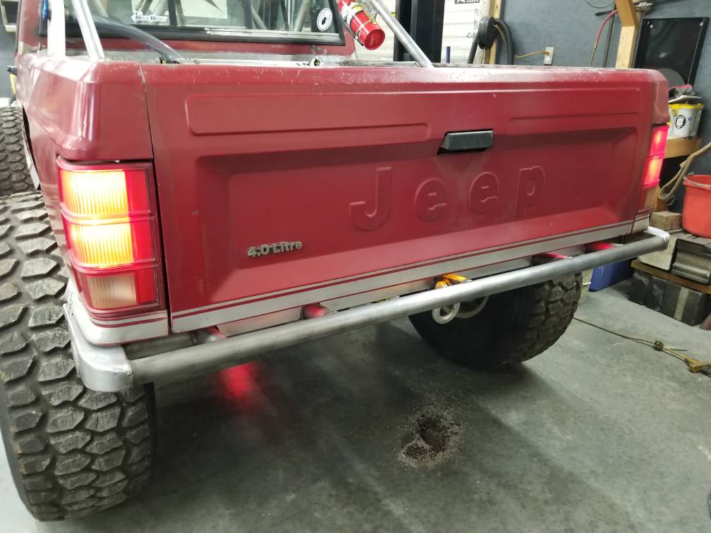

-couple wiring tid bits; rear stock taillights, front turn signal led mod, wire heater fan

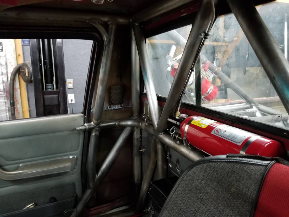

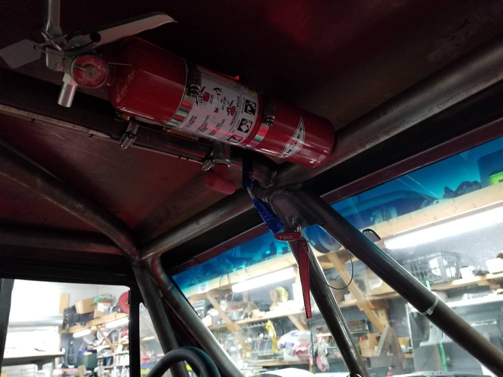

-plumbed and installed the fire bottle suppression and interior extinguisher

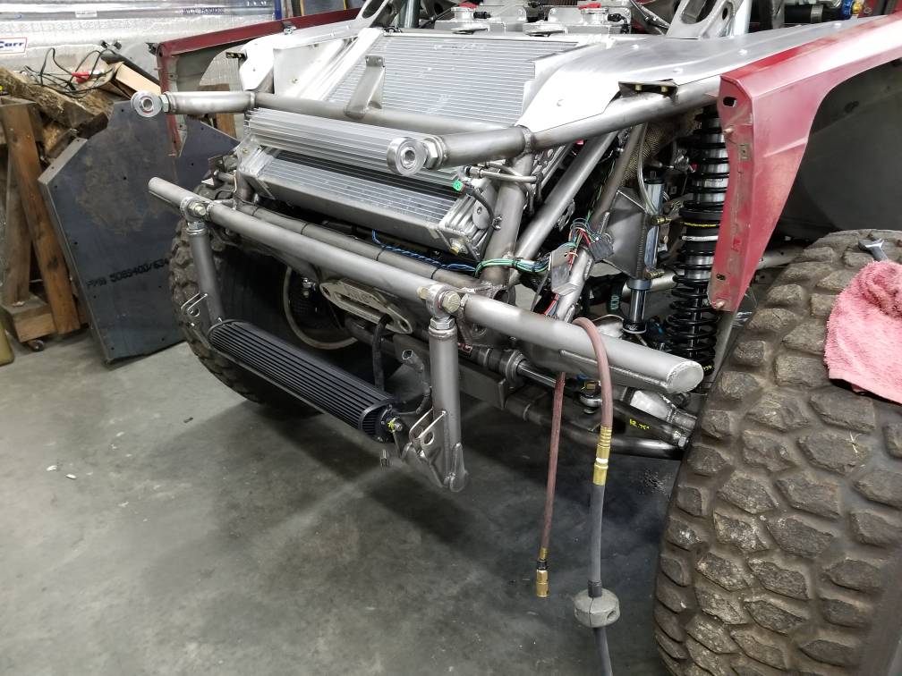

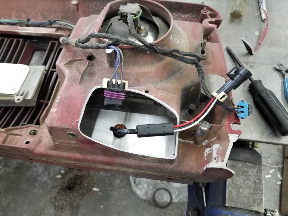

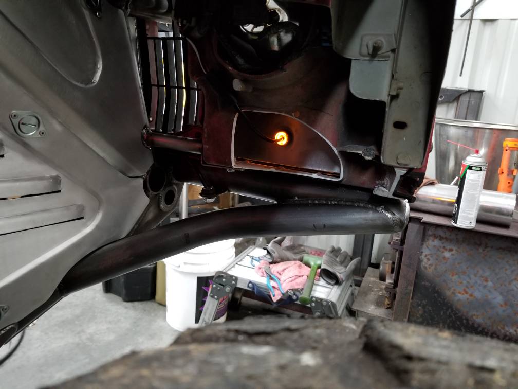

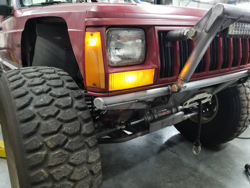

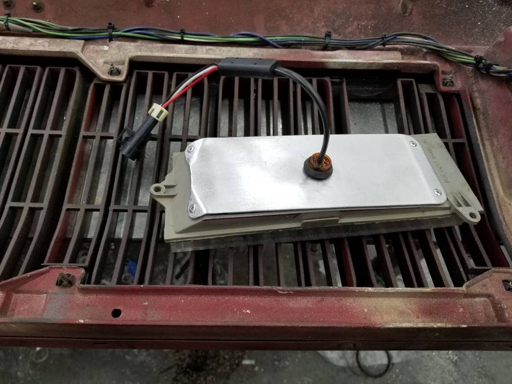

It only takes me about 7-8 minutes to tear the front clip down to this degree, with nothing but a 1/4" impact driver and a couple torx bits. Had to tighten the steering cooler fitting and finish trimming the header panel for tire clearance, and led mod the front marker lights.

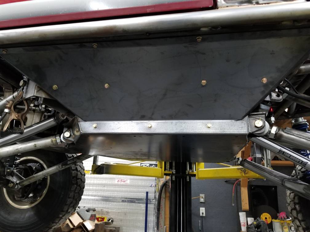

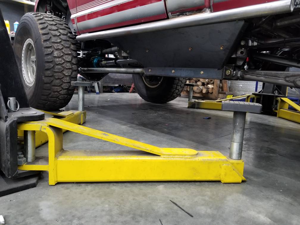

Skid plates on
All stock lights now functional

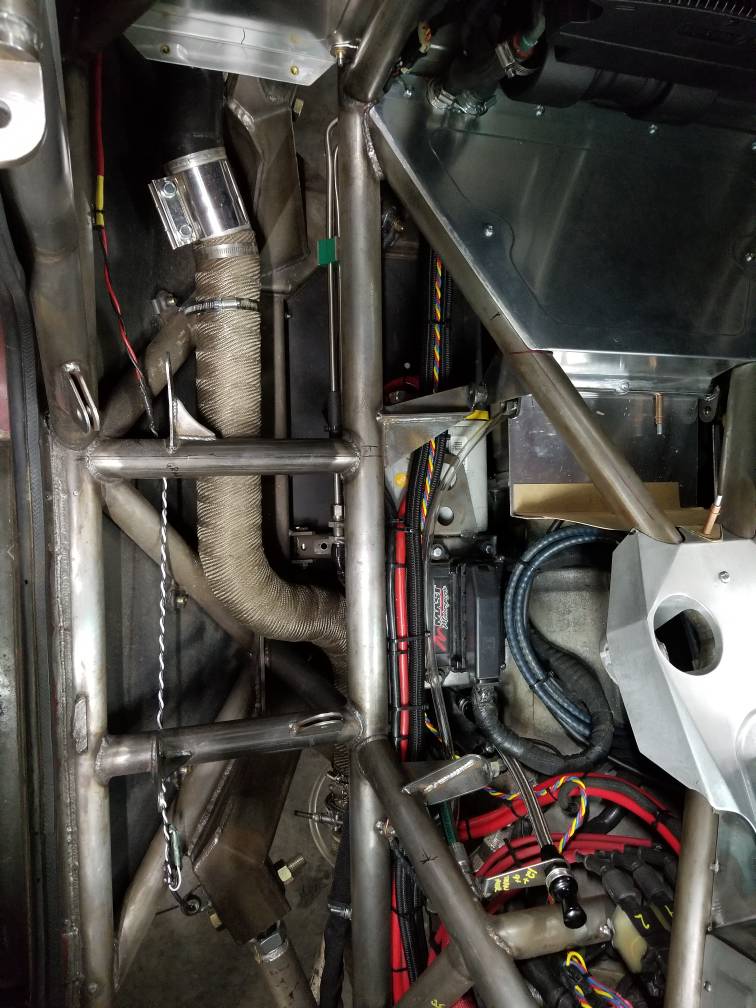

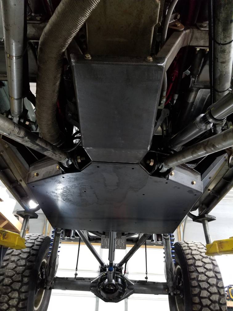

.... inside shot of skids on...

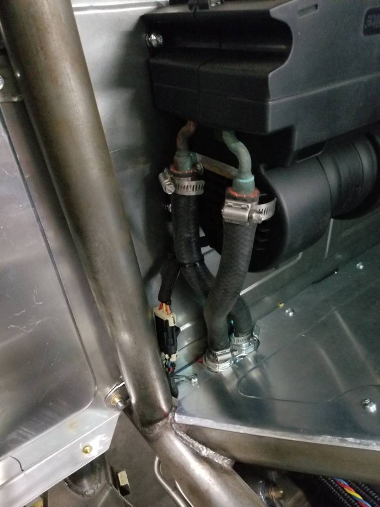

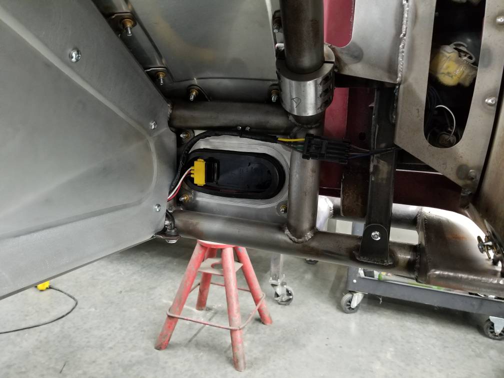

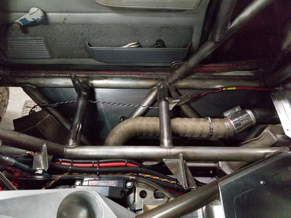

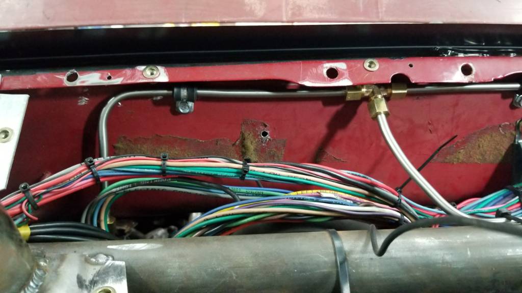

Taillight and heater wiring
Fire Bottle installed, jets are over each cylinder bank, to spray over headers

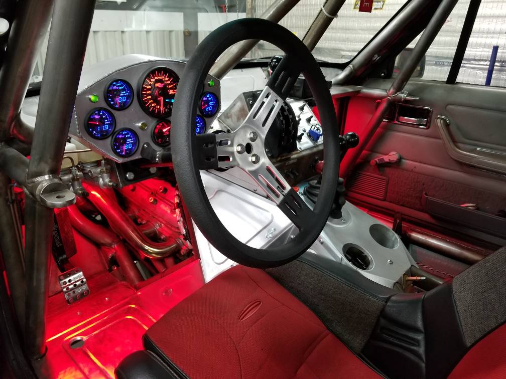

Interior lighting

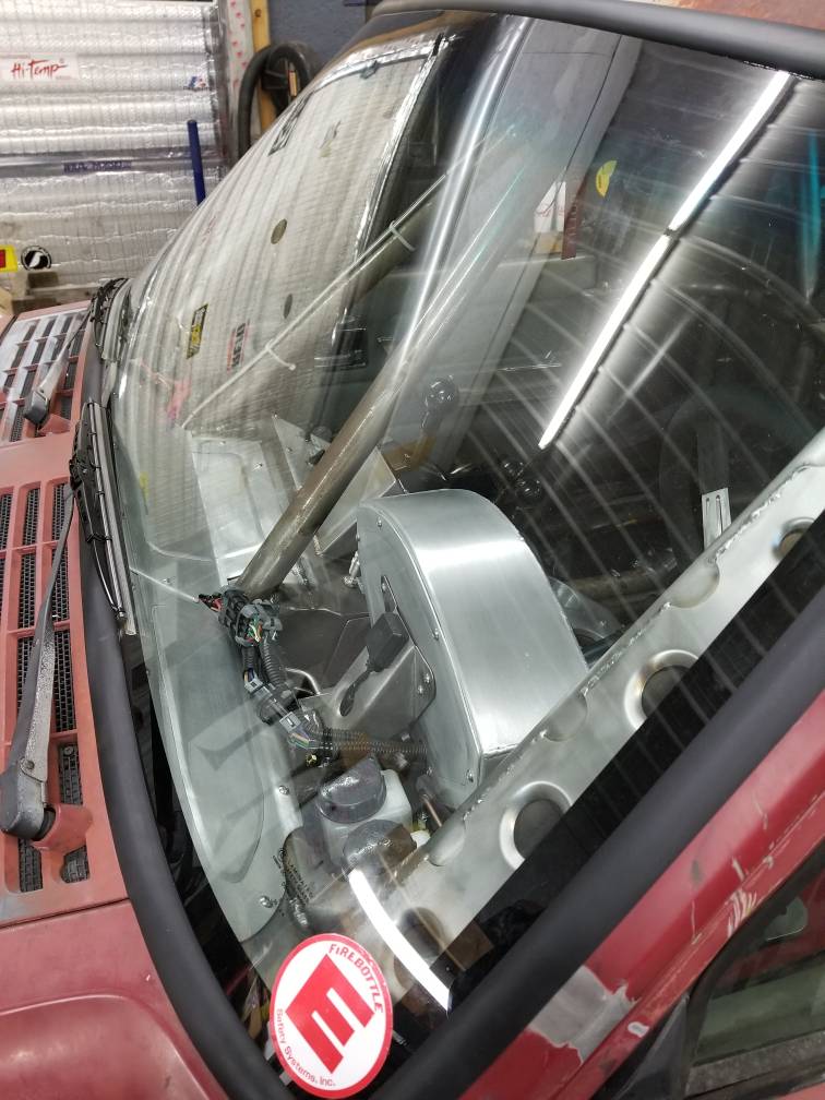

Windshield in...
