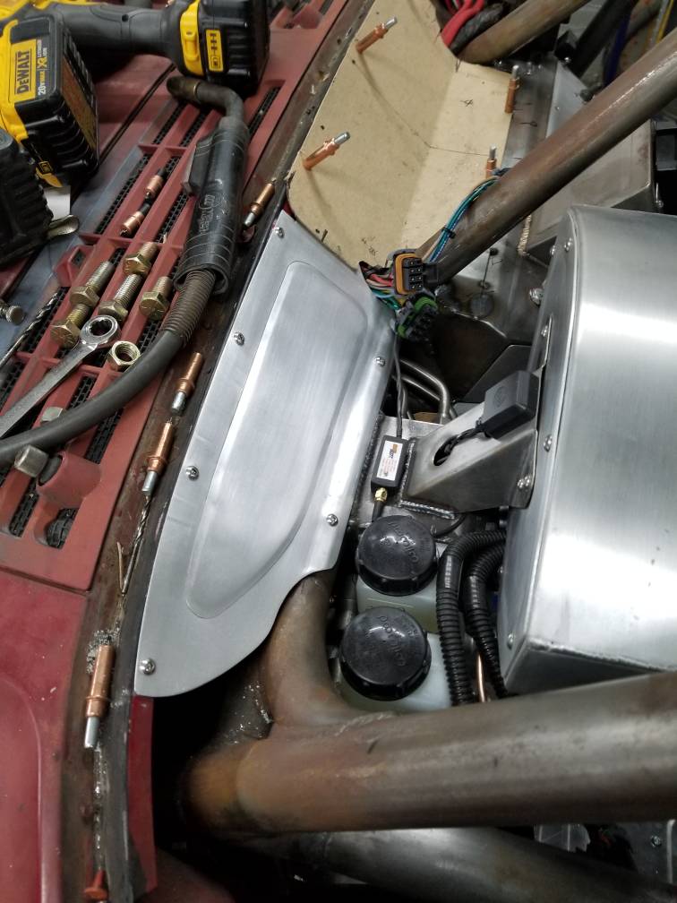

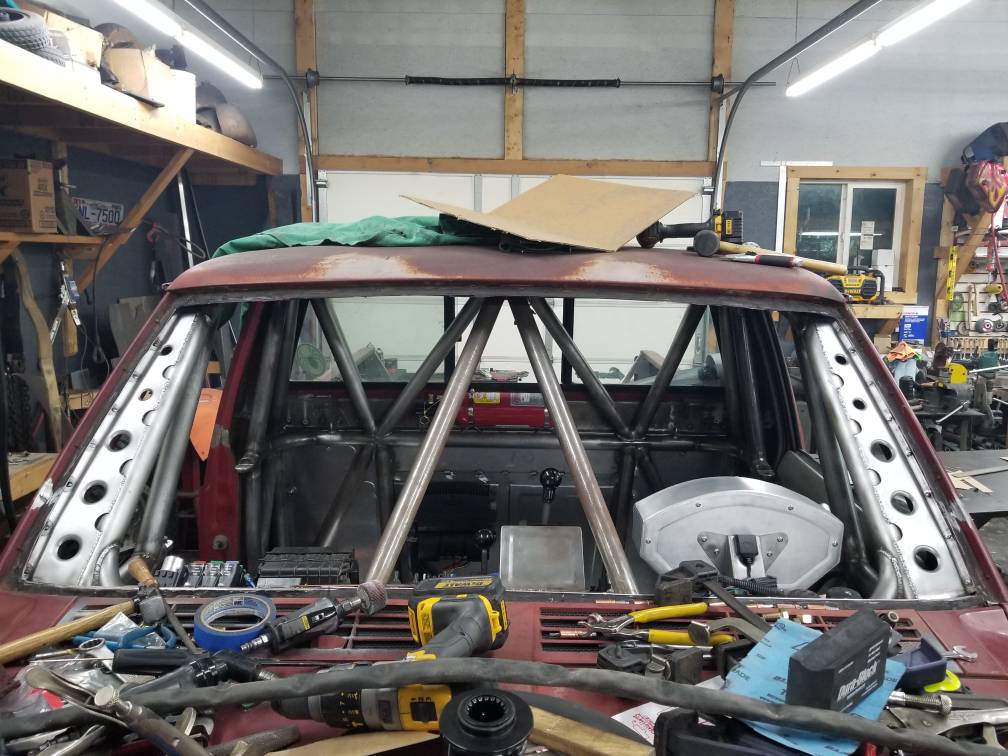

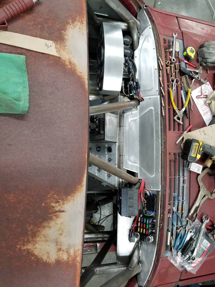

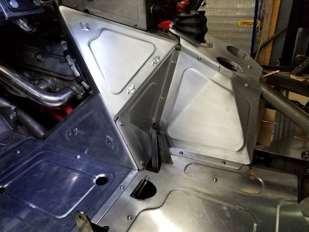

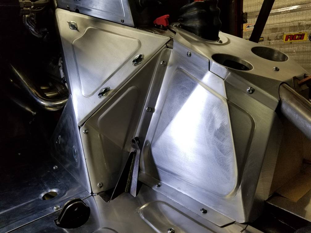

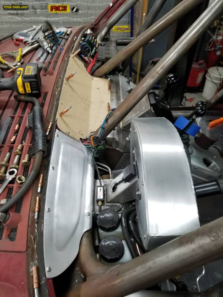

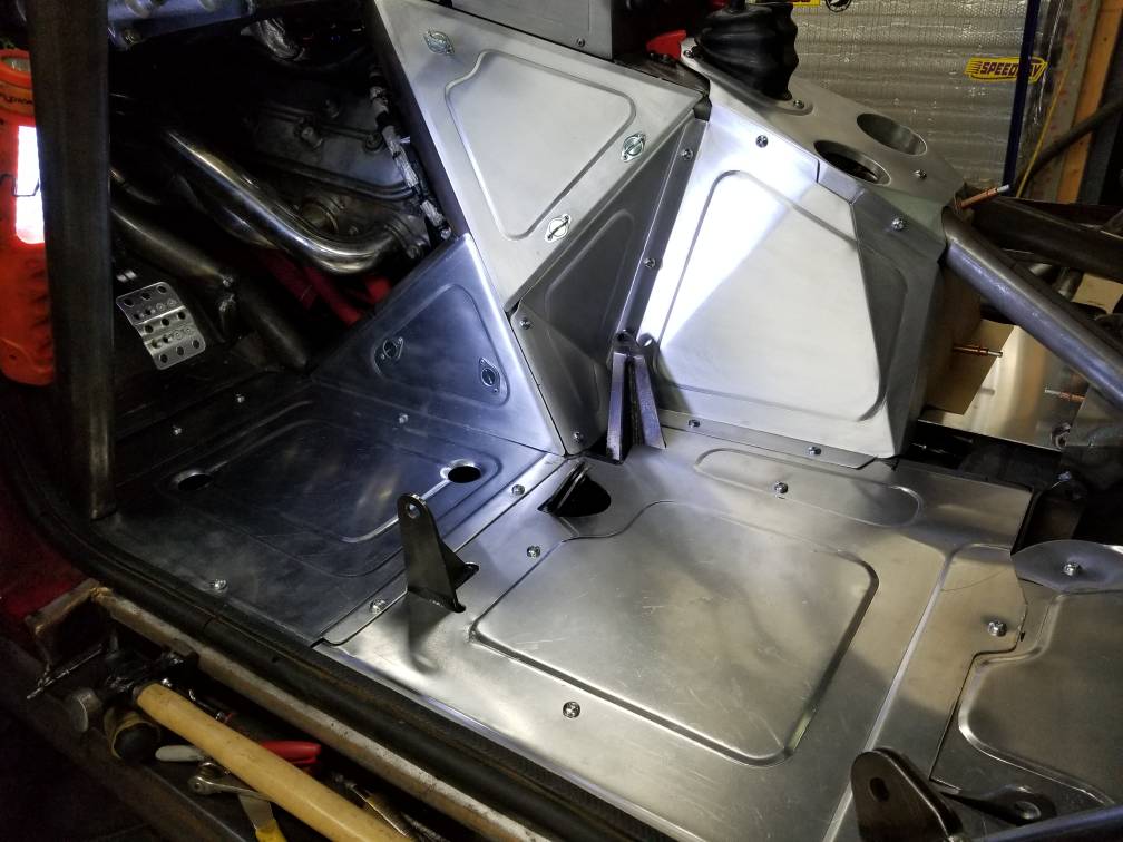

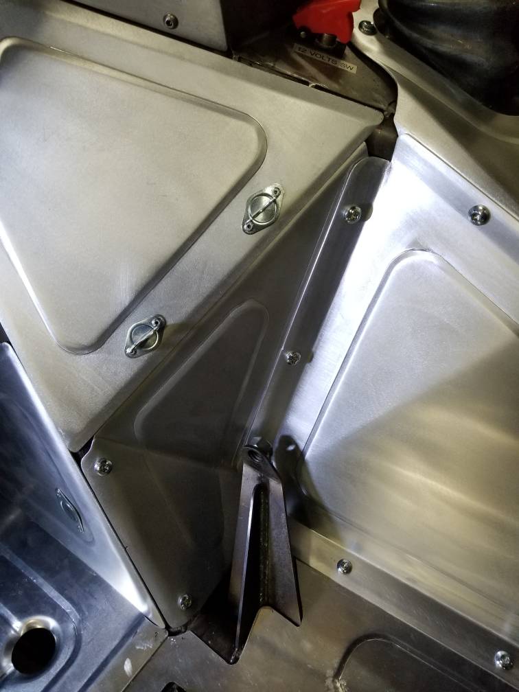

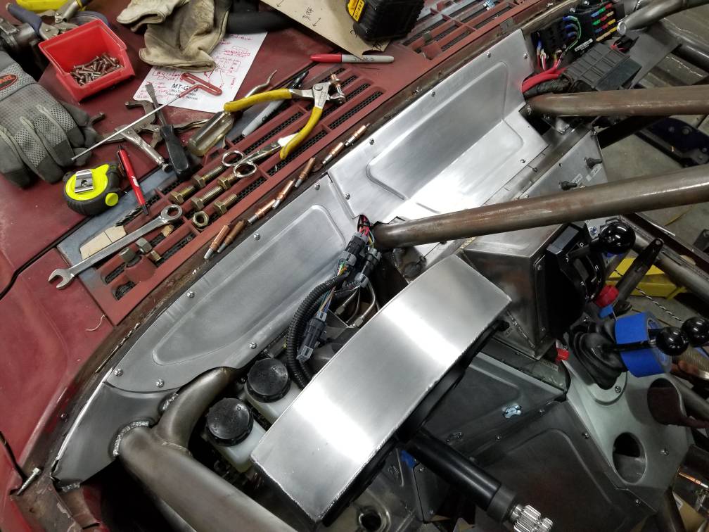

Bringing this back from earlier....That's a WHOLE lot of fasteners and panels covering raw metal. I know at THIS point in most complicated builds it gets fully blown apart for powedercote/paint. I mean...NOT doing so saves you a LOT of work right now...but do you think it may cause more headache later to NOT powdercote/paint the chassis now?
Not criticizing...attempting to learn and broaden my learning (
@Tacoma747 already gave me a crash course in Cleko's
Surely. Everything has a price.
But I'm cool with it, for now.
There are some proven products out now that I'll be testing.
I've always used Gibb's protectant on all surfaces and it works great, just needs frequent application. Immediately paintable and weld through. I will use this (as an overt coat) no matter what coating I use below.
Sharkhide is another bare metal sealer that has been successful. Dries clear. Weld through.
Mavcoat is yet another, and happens to be the official metal protectant of Ultra 4. (But has a waxy texture). Weld through.
I'm starting with Mr. Fix 9h ceramic coating on the aluminum, body, and testing on bare steel. So far so good. There's a couple TT teams coating an entire vehicle in this (or comparable product like Ceramic Pro).
I won't use wd-40, (works great for fighting corrosion), but it is a nightmare to paint over, should I do so later.
I'll have loads of down time after the build is 'over'- (like that will ever happen...).
... and I have 3 boys that are always bored....
