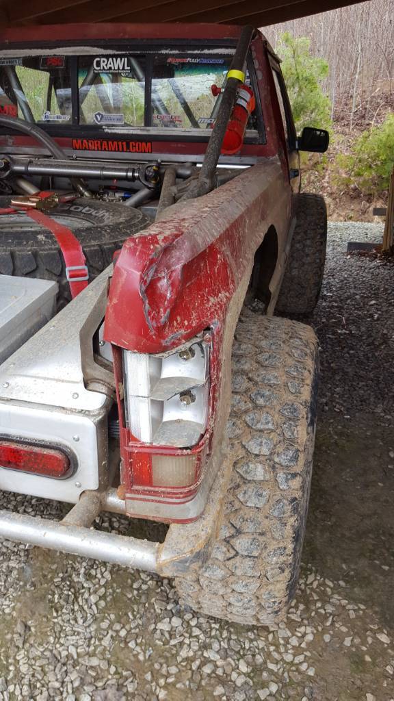

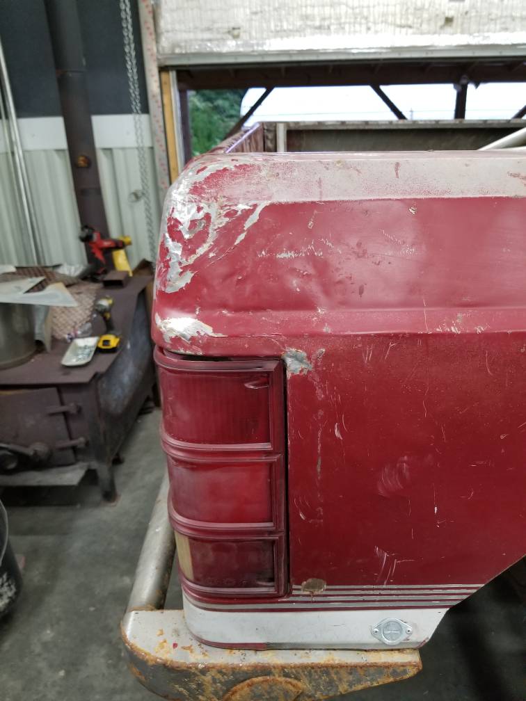

Nut and bolt, service and grease, minor body work, taillight, make a couple new lower front links, scotchbrite and oil down the chassis, then load her up behind her new chauffeur...

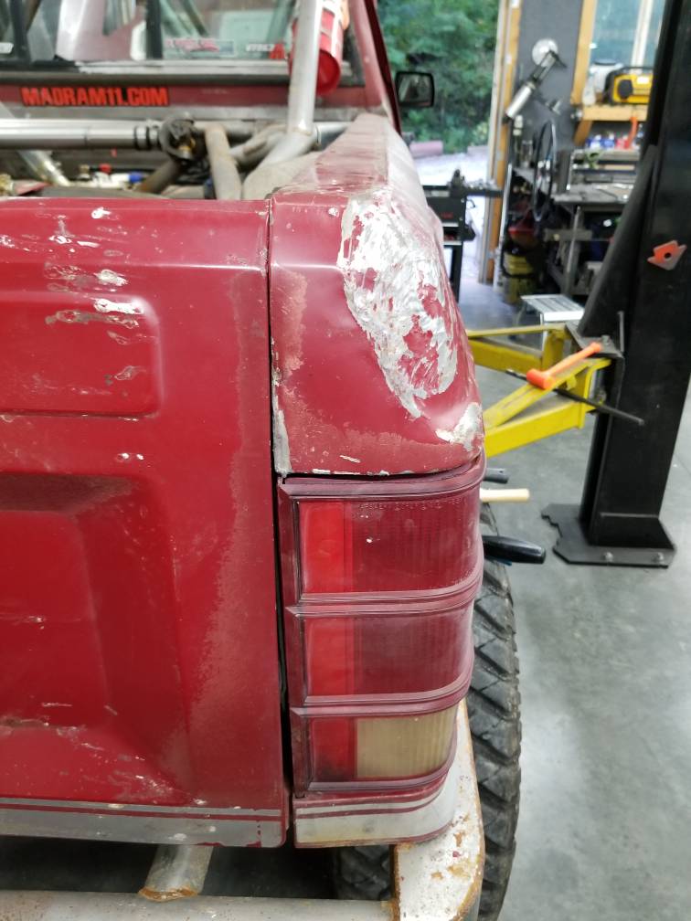

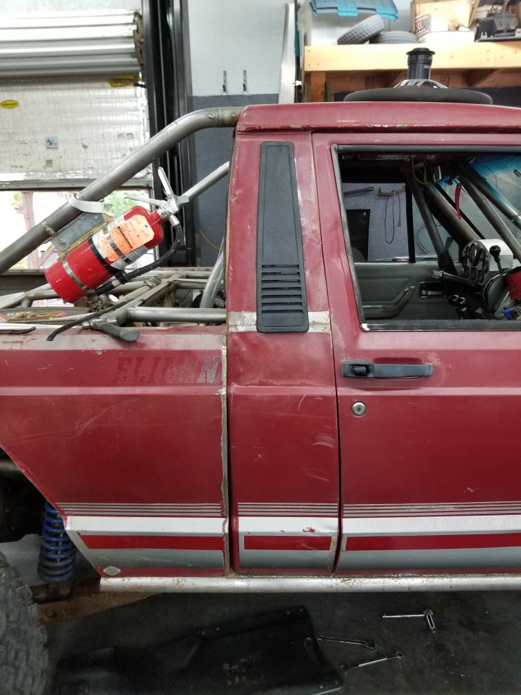

Before...
After...

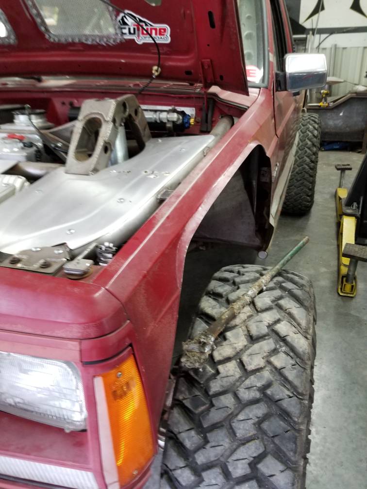

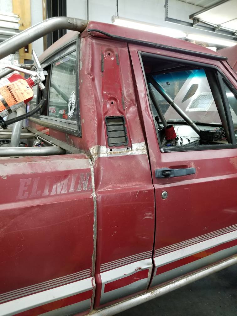

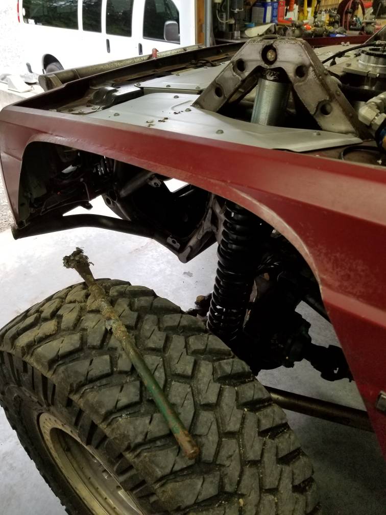

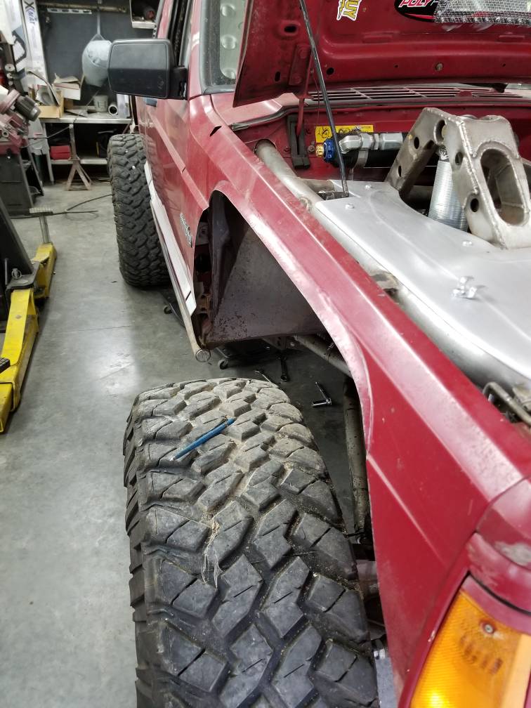

Did a little hammer and dolly work to flare the fender ...
Fix this tomorrow...

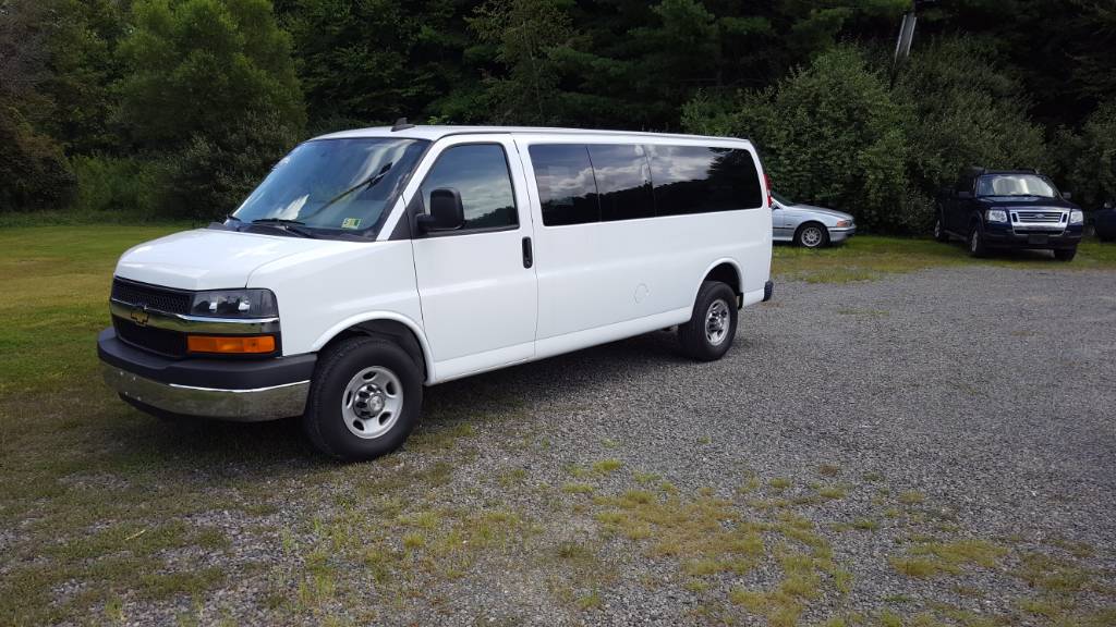

2016 3500 12 passenger Chevy Express, 35k miles. 6.0, 6l80, baby 14 bolt, 12 feet of cargo/sleeping area with seats removed. Installed a class 4 hitch, brake controller, tinted the windows, and have some Cutler Fab lettering on it before pulling out.

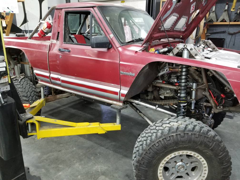

Would you mind sharing your technique on the fender flaring? I'd love to do that to my front fenders where they've been cut.

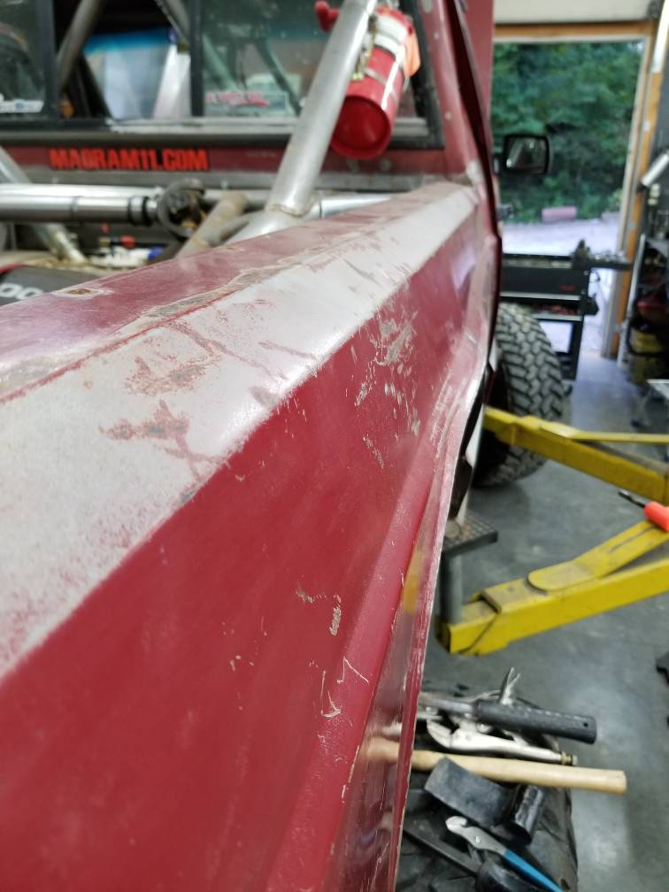

Pretty simple, took about 10 minutes per fender- given its not paint ready, but woods ready...
I drew a line in silver pencil to my liking.

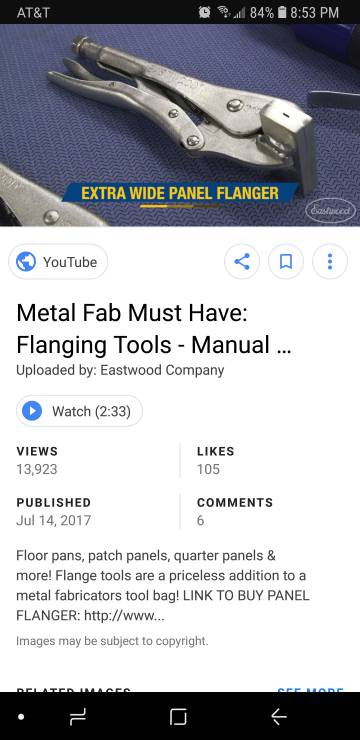

I used these flanging pliers, but I didn't go go past the flange steps. Lightly prying up until light deformation was acquired- then I used a dolly and hammer to stretch the edge back into shape. I used the narrow to get it roughed in then the wide ones to get uniformity - until you get to the corners.
Finish the edge with a file to square up its profile.
Cutler
Take your time doing it, it's easy to go too far, and make more work for yourself to make it right, and harder to go backwards. Take small steps.
Got the Manche's new chauffer ready for travel today.
12'x5'4" of space for activities. Two 32x80 cots with roomy storage underneath.
Frankly, as quick and easy as this was, I don't think I'll do any interior modifications or permanent fixtures for future off road trips. The storage afforded under the cots takes care of my needs, and the bench seats slide out in about 5 minutes. Now if I was going alone, I wouldn't remove the seats at all, or if there are more than 2 people, we would just bunk down in the floor on some padding.

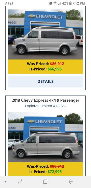

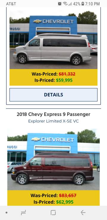

Do they make an hi-rise top for that? Cutting and grafting one in would be trick to get standing room (or close to standing room)
I'm sure there are conversion outfitters that do so, but then you're bargain $20k (sub 40k miles) van jumps into the 50's. We all know any ton pickup is way overpriced these days, regardless of the engine and/ or mileage.

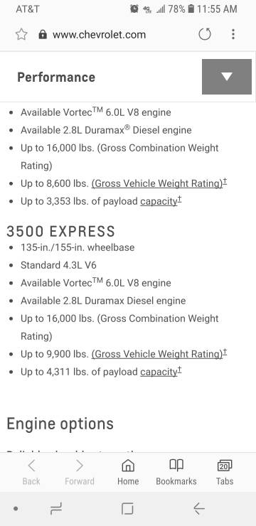

Are you required to have. A weighted tag for a van like a truck or is it like a 2500 suburban where you can tow 10k with a regular tag?
Not sure, frankly didn't ask. I had it tagged for 16k.
