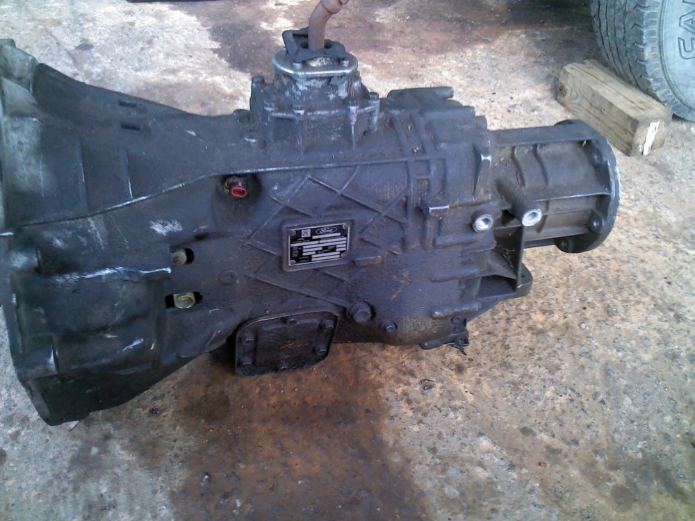

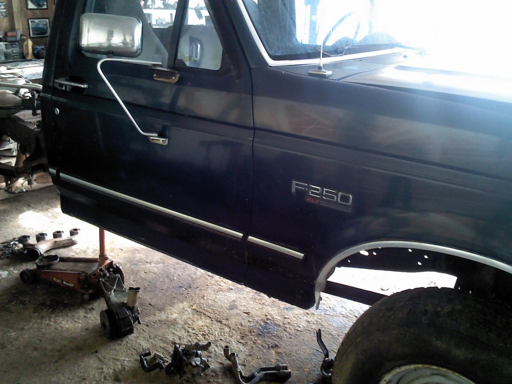

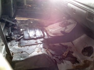

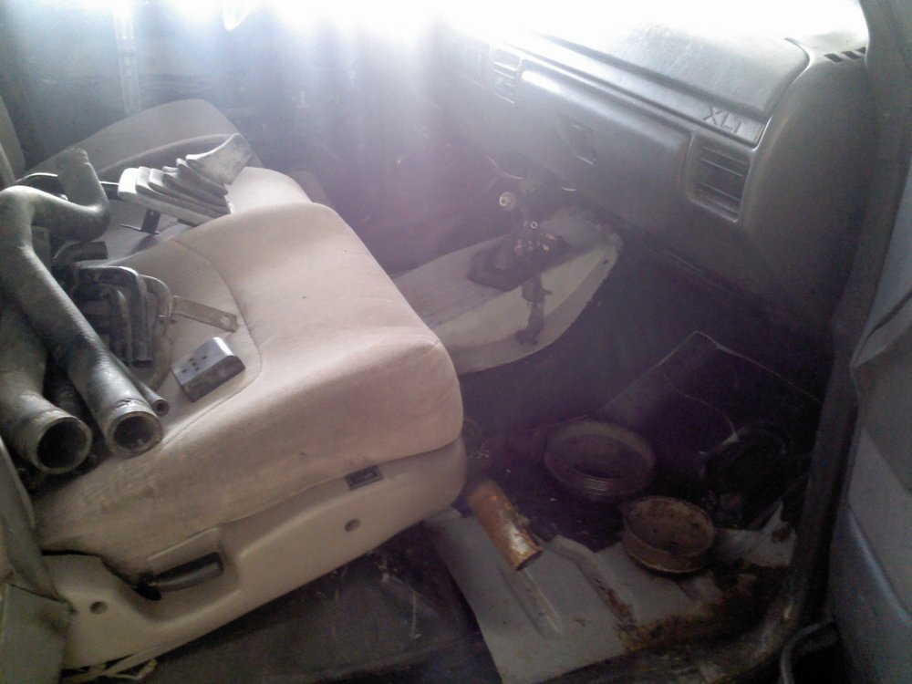

93 F-250 5.8L ZF5speed Trans 4x4 single cab dual tanks body and frame is amazing condition so i decided to take it, try and bring it back to life after 2yrs roughly sitting as it is. i'm nervous as no bolts were left, half the parts are missing, the bed is....somewhere lol, interior is gutted, sooooo yeah i'm pretty anxious taking on such a project that i have NO CLUE about but here i go....best part is how clean the cab and frame is for 95% of it so that's a huge plus. lots of pictures so here's how it came to me LOL...(i first thought HEEEELLLLP!!lol lol)

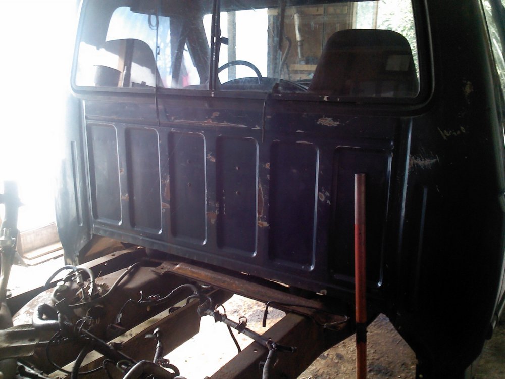

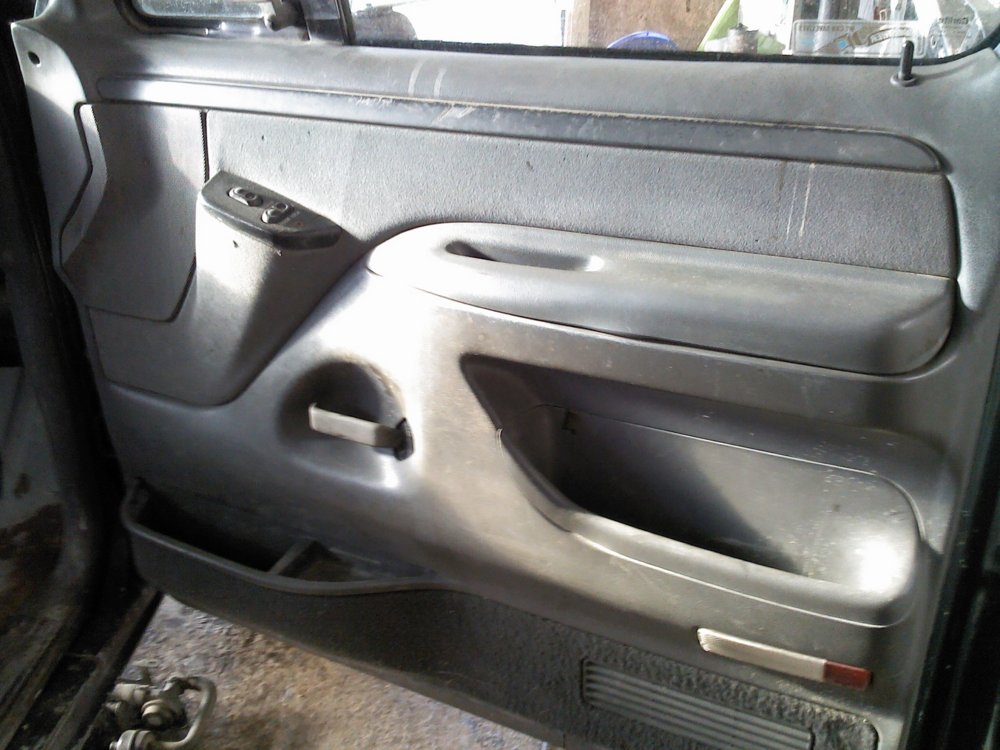

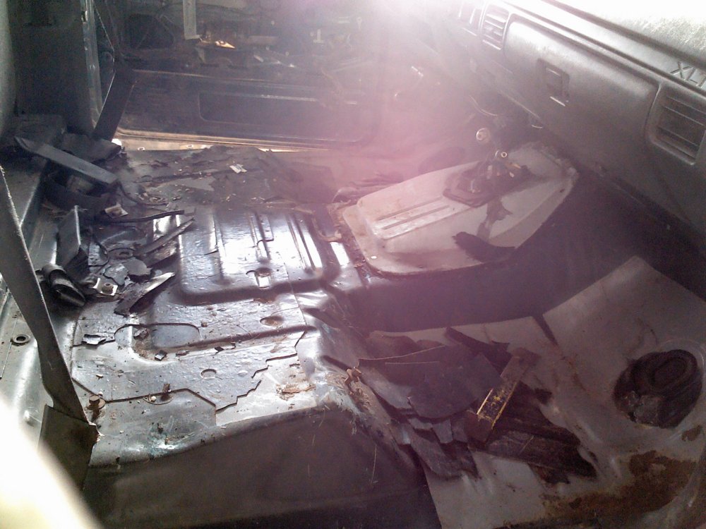

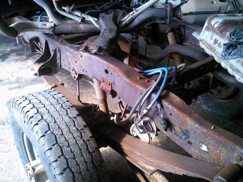

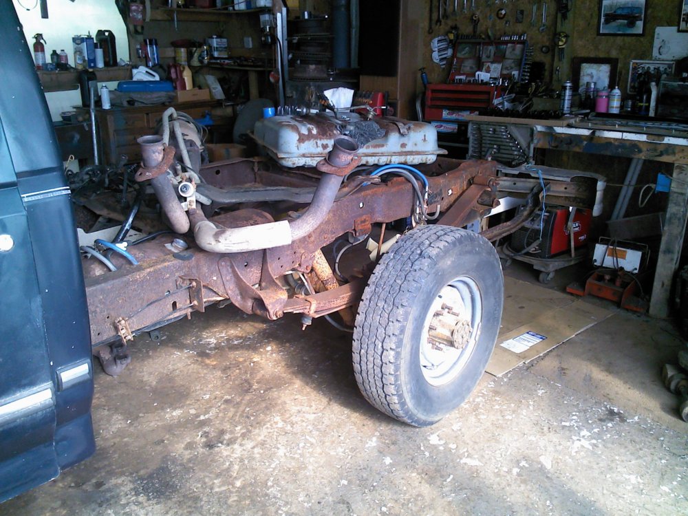

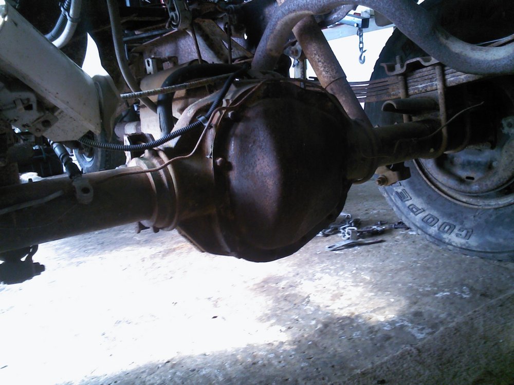

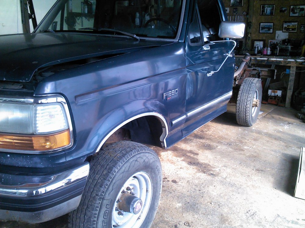

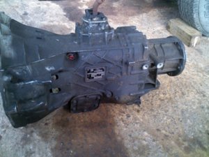

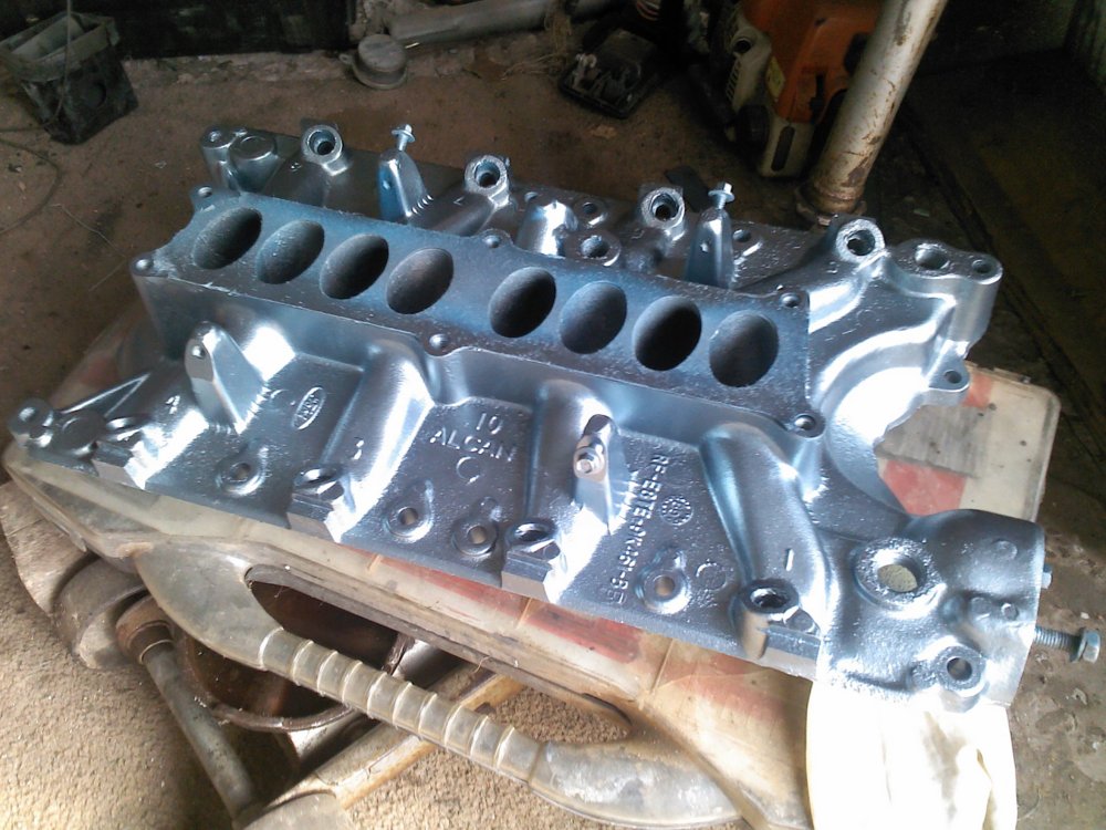

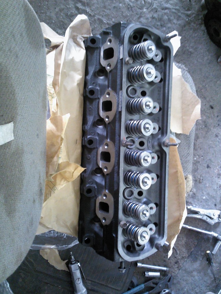

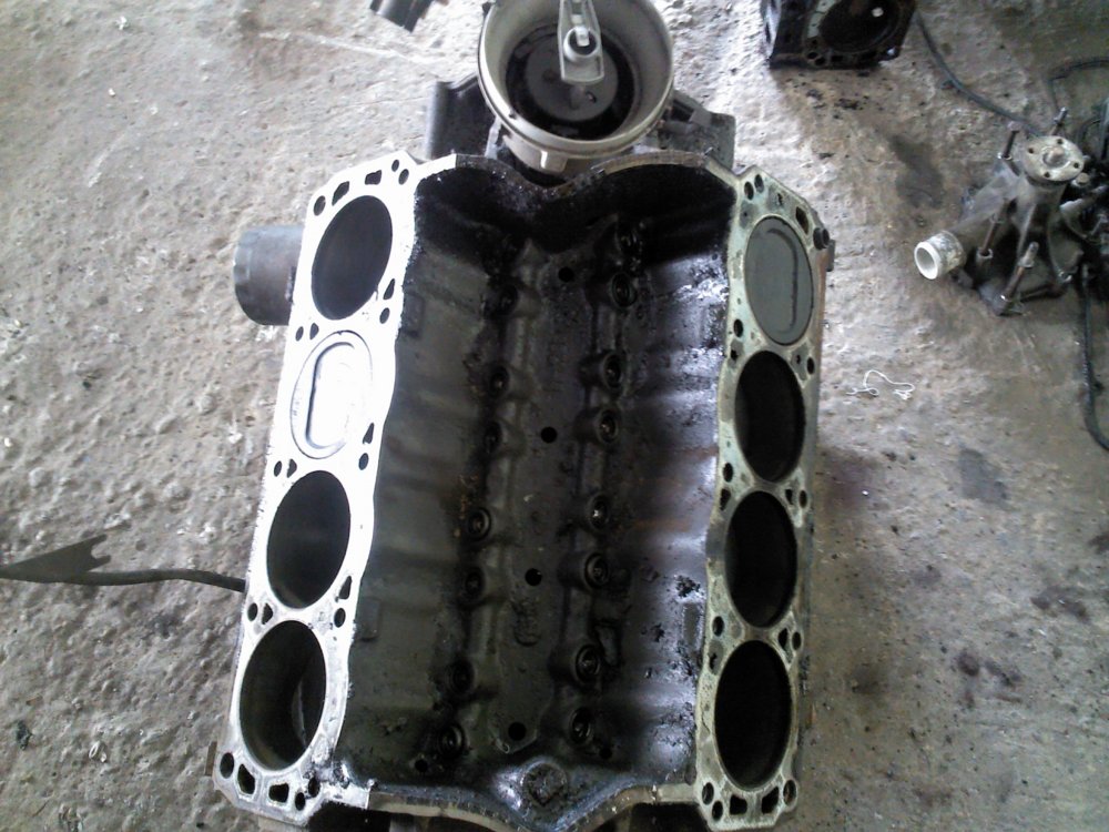

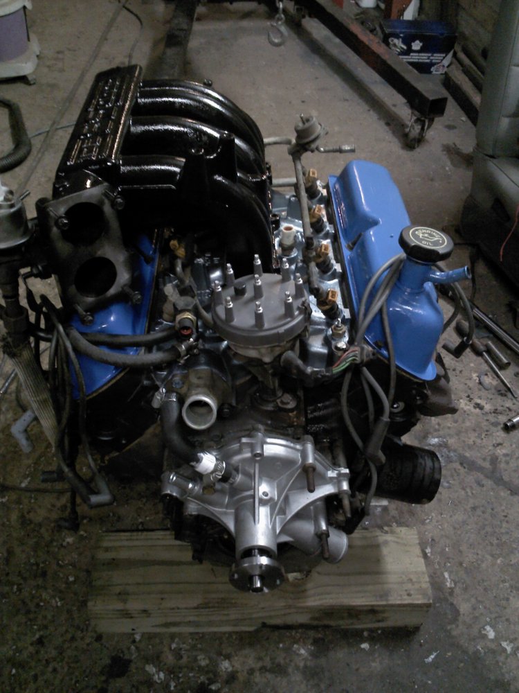

ok so far i got All New: heads, intake, water pump, thermostat, radiator, Clutch, slave cylinder/throw out bearing, starter, battery, front calipers and pads, Rear Tank Fuel Pump, Oil, Coolant, Paint (jet black), Harmonic Balancer, Rear Main Seal, Complete Engine Gasket Set, hoses, bolts (all bolts missing lol). Used: Transfer case on the way, door panels i hope to find soon, carpet/rug, so here's my "progress" so far....coming along i guess. The customer/now friend threw in these awesome rims with 33s 16.5x8.5 aluminum...they are gonna look nice when truck is done!!

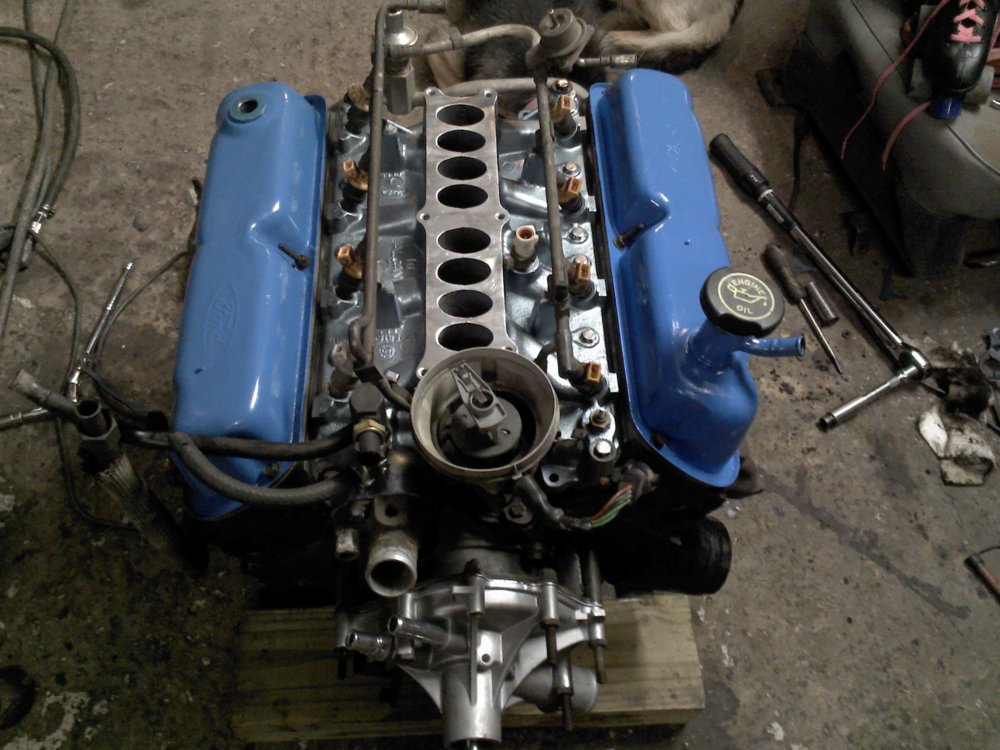

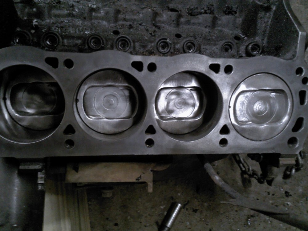

hey also, any advise on how t adjust the clutch would be great...i bled the new slave cylinder just like i would brakes but the pedal just doesn't quite feel right?? or I'm just not familiar enough with a big truck clutch like this and maybe it's normal, idk...the clutch pedal has total about 8-9" travel...the first 2-3" of push on it it's free/slack then the last 6-8" to the floor it's firm and clutch feels like it's disengaging all the way...
would i know if it was disengaging all the way or not..does this pedal sound normal for this zf5 trans with new clutch and hardware? thank u
If you are idling in N, push clutch in, shift into gear.
If it shifts easily, and the truck doesn't try to move a little bit, then it's disengaging all the way.
Should have some free play when pressing clutch before it starts disengaging.
Also should have some slight pedal travel off floor when releasing, before clutch starts engaging as well.
Bleeding is just like brakes,
Depress pedal
Open bleeder screw, finish pushing pedal to floor, hold pedal down
Close bleeder screw
Release pedal
Check to make sure clutch MC fluid level doesn't drop too far, and repeat until you get good pedal.
Also sometimes tap on MC with something small to get trapped air bubbles to free up and rise to surface.
Pumping only breaks the air bubbles into smaller ones making them harder to remove.
