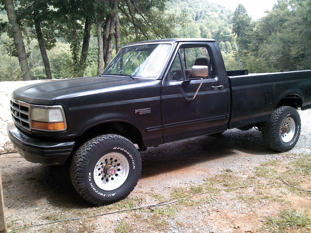

well so here's the truck for the most part its done...drove around the block several times tested out 4x4....pretty powerful truck for being gas motor for me anyways...way more power than the 99ford 150 i sold. it pulls through the gears really good, shifts smooth, and sounds descent (I think someone who knows timing better than me would be able to set the timing better...to me in gear pulls good but just revving it up doesn't sound right as far as power band???maybe I'm too long into it and just imagining things lol). so here's the pretty much finished product...not the best but it works for me. the bed i got was in rough shape as you can see the dents but can't beat "free"
