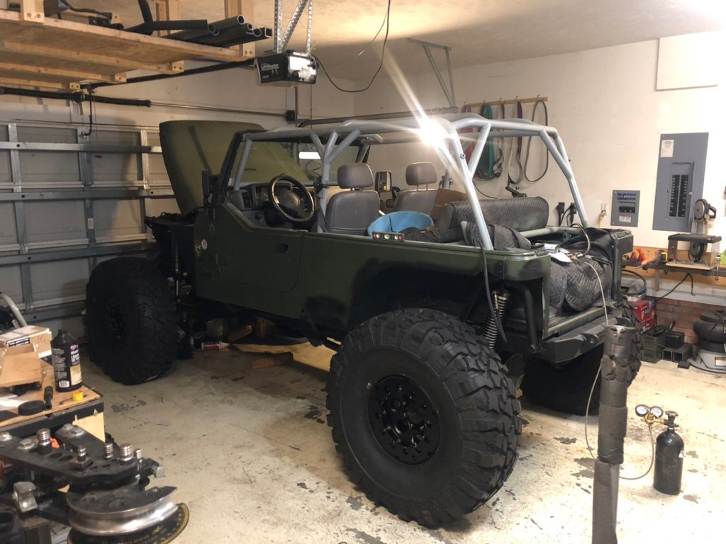

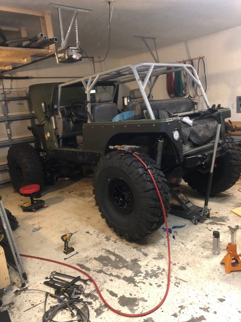

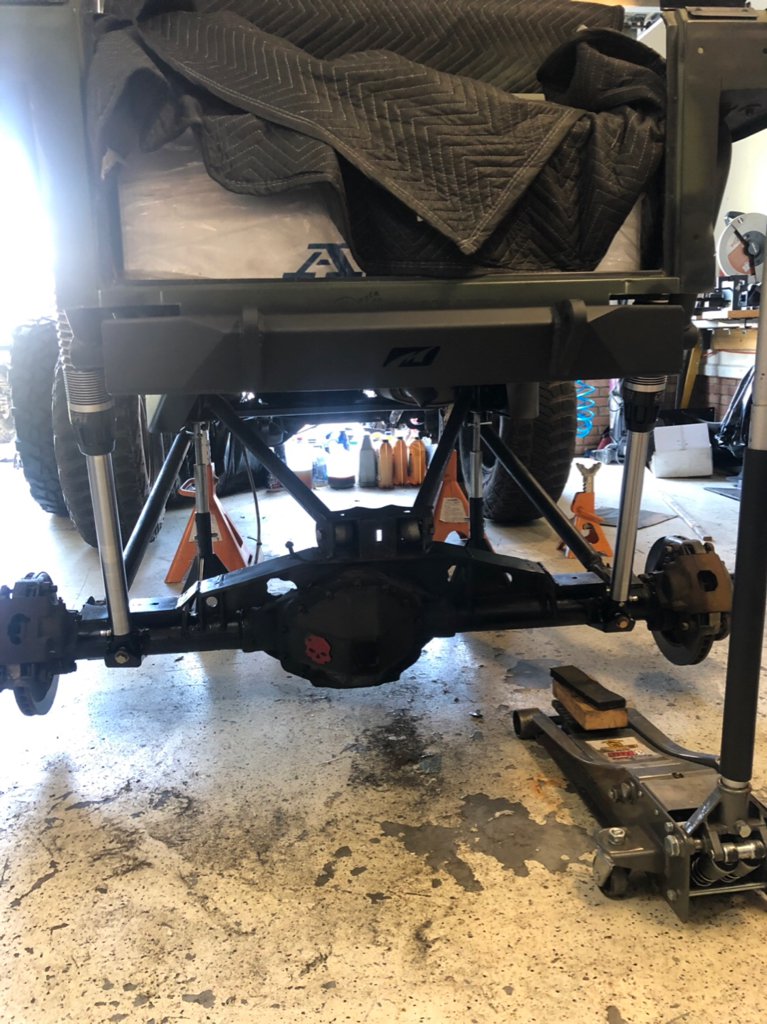

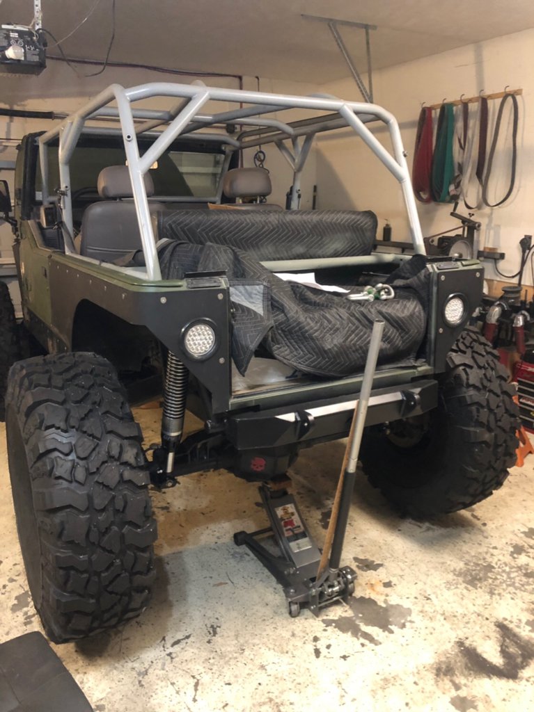

Charging the struts. First time it’s been under its own weight in awhile. So excited this thing is almost done so my back can recover.
Still need to put the rocker/corner guards on, tail lights, strap the fuel cell down and tighten up a few things then that’s it!

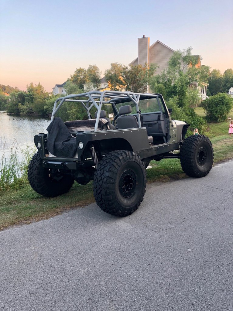

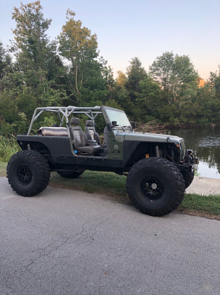

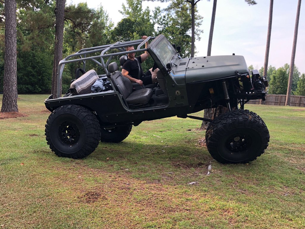

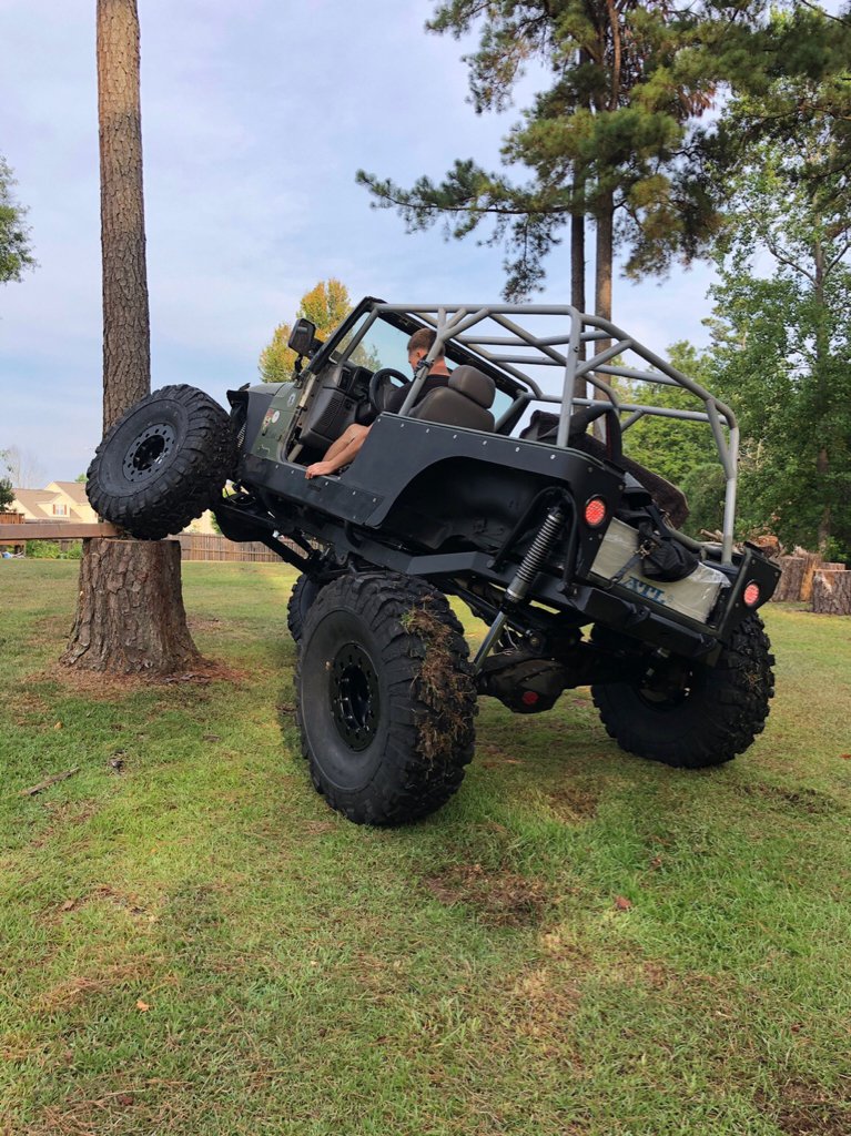

Driving around today. Struts need some breaking in but everything seems to be working well.
Real excited this thing is almost done after 2 1/2 years. Still have to mount the fuel cell and tailgate but otherwise she’s good!!
Sent from my iPhone using Tapatalk Pro
Thanks dude. I’m happy it’s finished. 2 1/2 years and several times I just wanted to sell the whole thing.

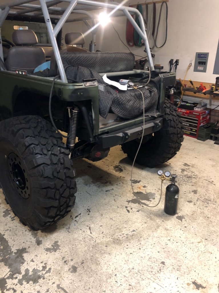

What did your final WB end up being? Maybe I missed it but what length ORI’s? Getting towards the end of my build similar to yours. YJ Unlimited stretch like Chris 116.5” WB and 14” front 16” rear ORI’s.
It’s almost exactly 116.5”. That was my measurement but had to spin the links a couple threads to get the axle straight so maybe a 1/4” more or less. 14” ORI’s up front and 16” in the rear.
In hindsight I should have mounted the rear struts a little higher. I’m only single triangulated so the links hit the 1/2” plate welded under the frame rail for the stretch. If I was double triangulated I could have easily mounted another 1” or more higher. Right now I’m only showing 4” of shaft at ride height in the rear which I’m told is okay with the new ORI’s but would like a little more so I could drop the ride height about an inch.
Have a shit ton of droop tho!!!
