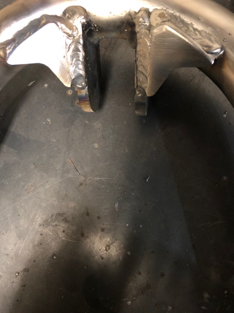

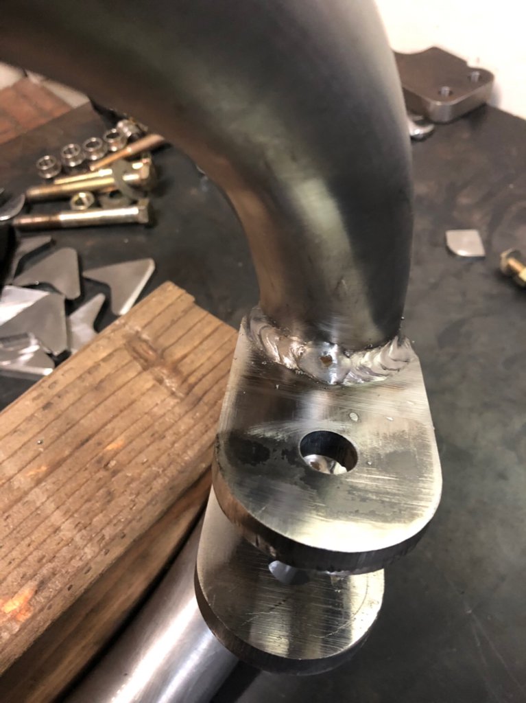

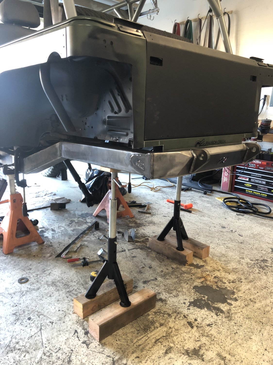

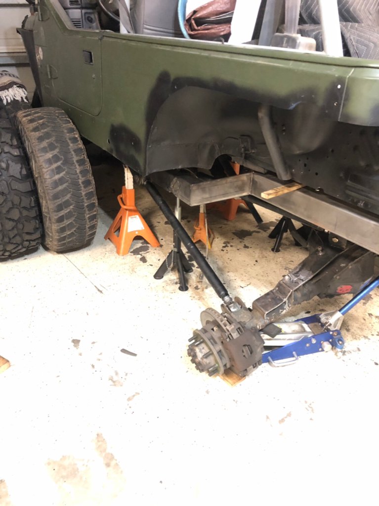

Made all of the rear links. BTW steel is fuggin expensive.

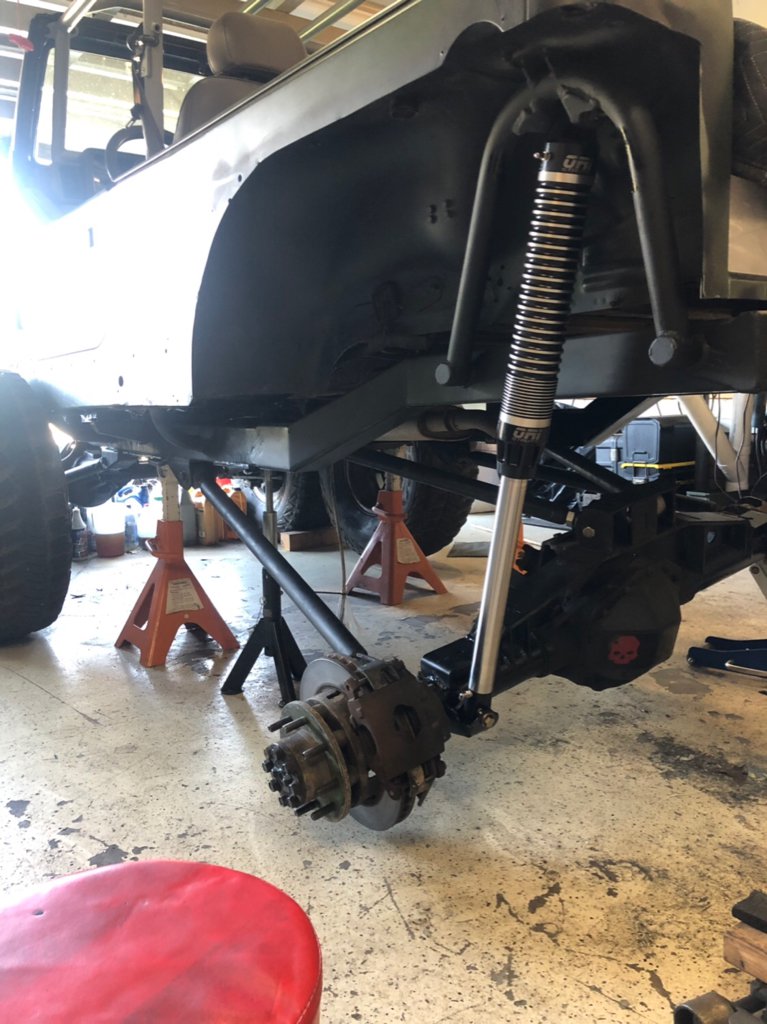

Cleaned up the rear axle and zipped all of the coil mounts and junk off.

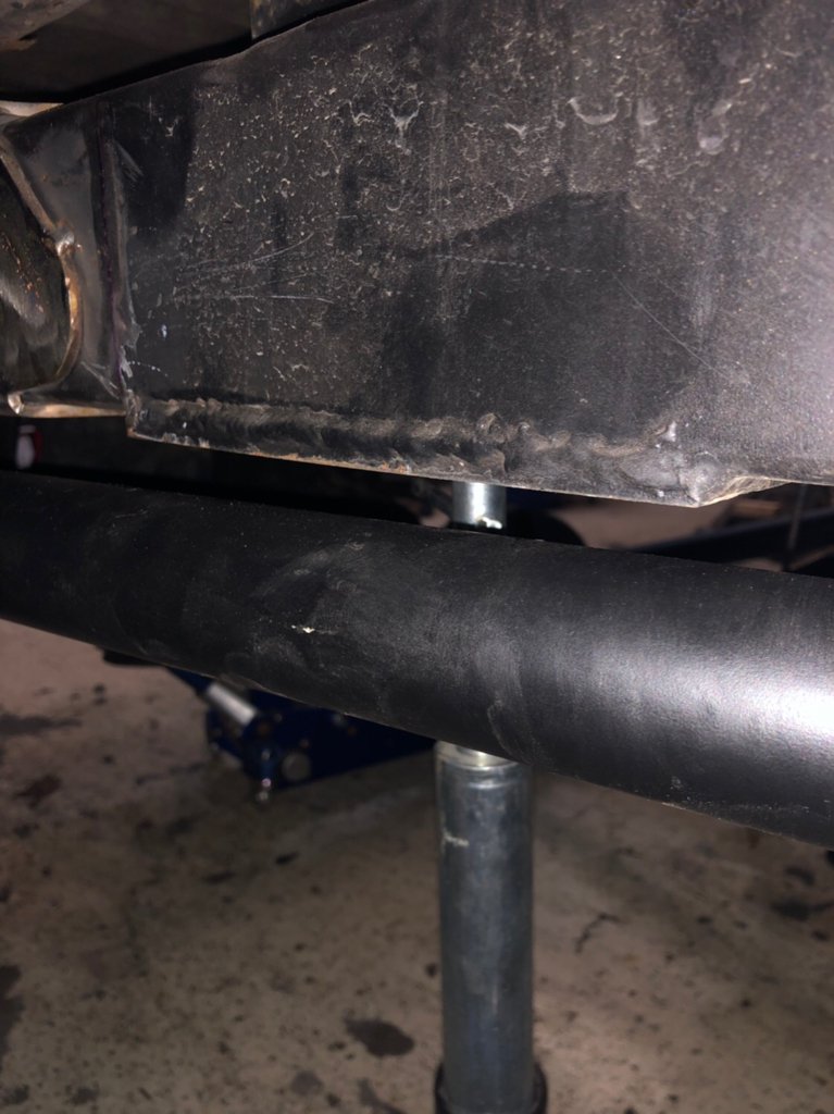

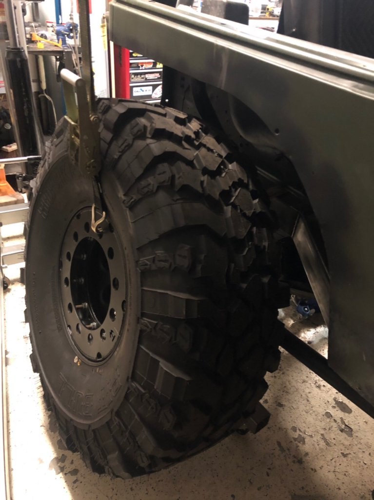

Sitting at about 117” WB rn which is where it will probably stay. First thing to contact is the lower links to the upper link frame bracket on the up swing.
Could mess with it and maybe get another inch but I’m fine with it. Have about 4-1/2” up travel and 11ish down on the struts.

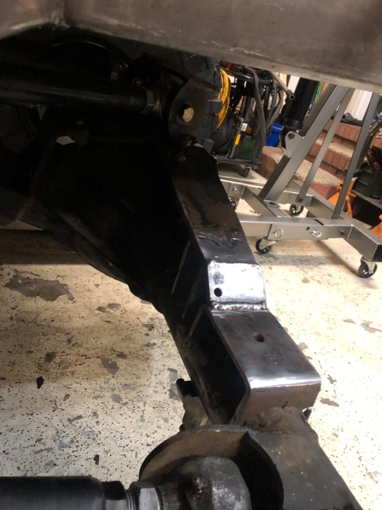

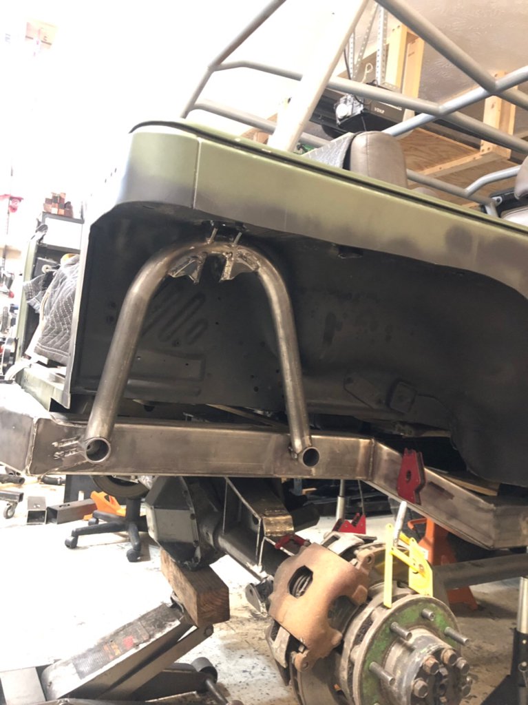

Here is where the axle ends up maxing out the strut.
Need to cut the support tube and rework the frame mount to get a couple more inches here

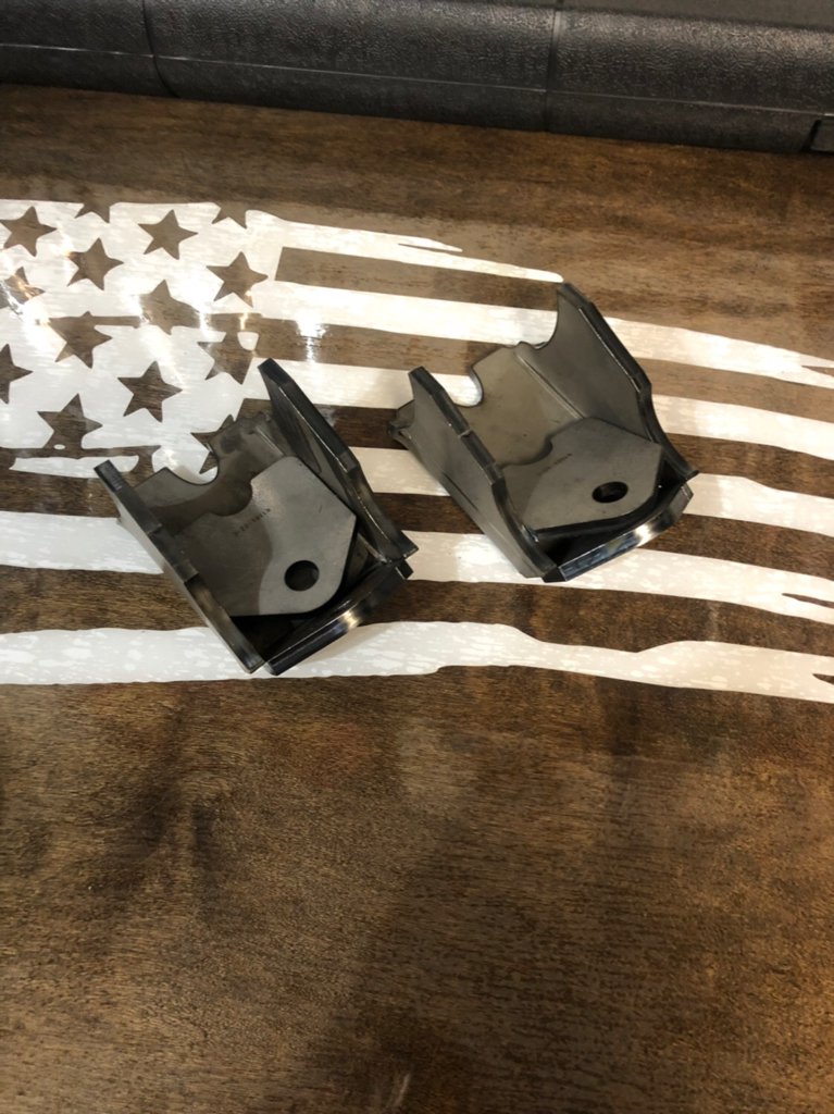

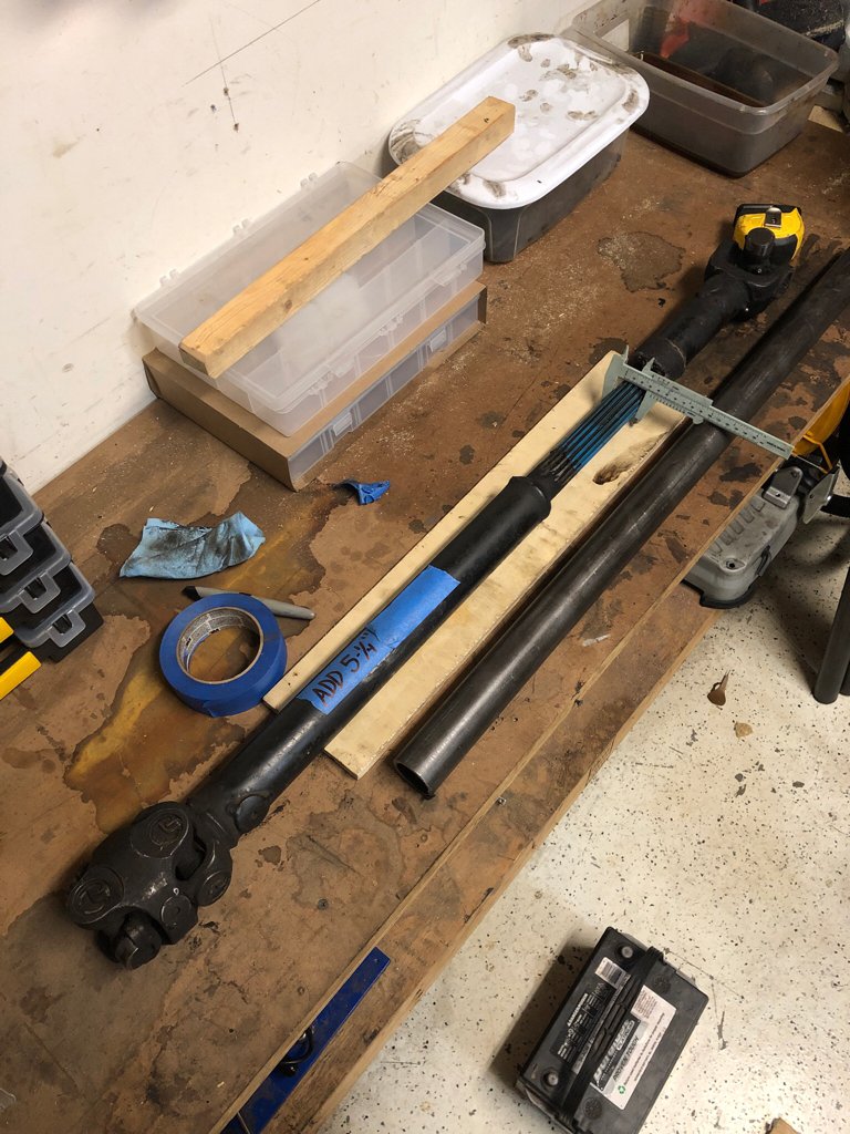

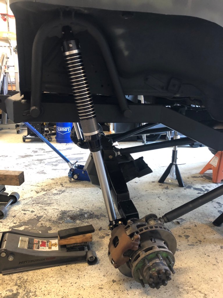

Also got these bad boys from ruff stuff for the lower strut mounts.

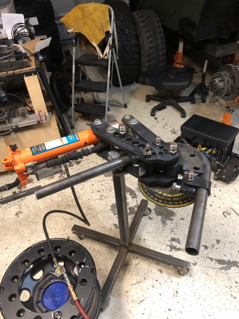

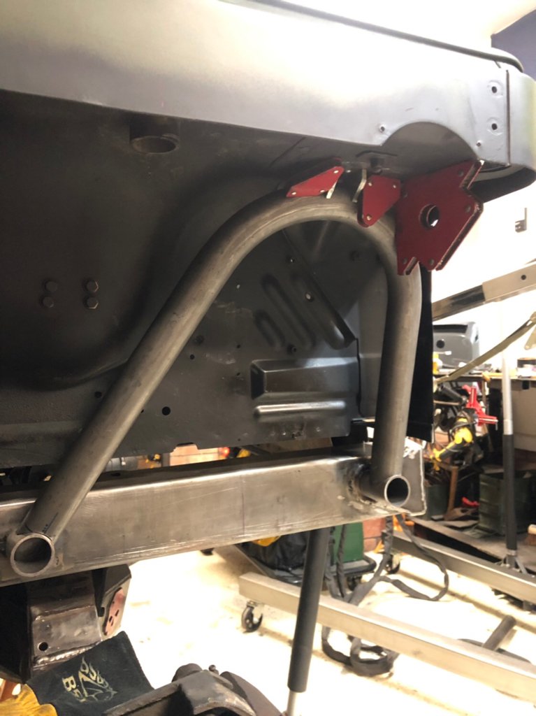

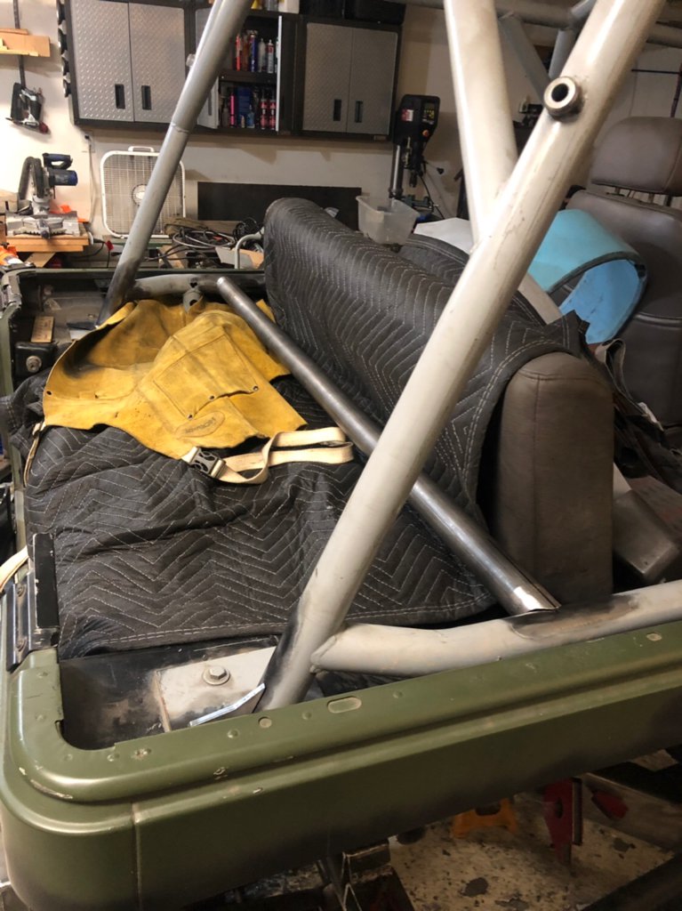

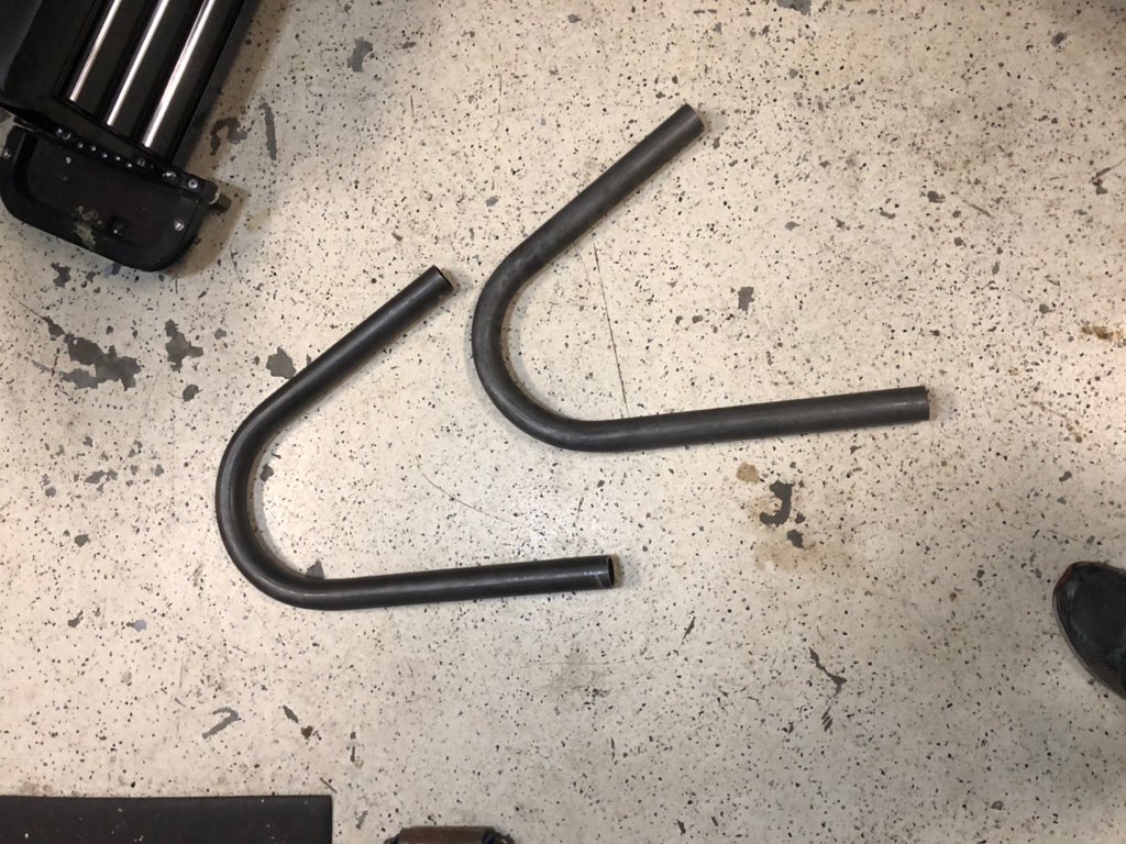

Gotta run to GulfStream tomorrow for some 1-3/4 to bend up the shock hoops. Got all week off so shooting to be done by the weekend.
