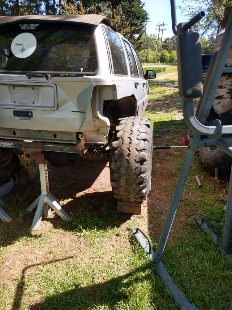

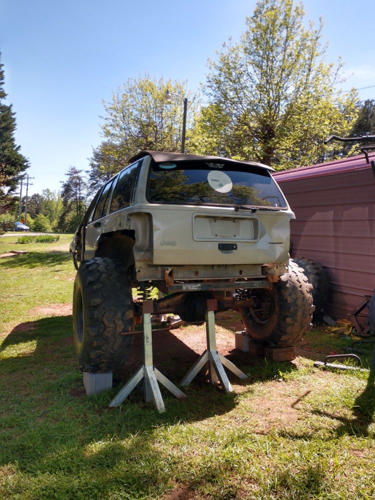

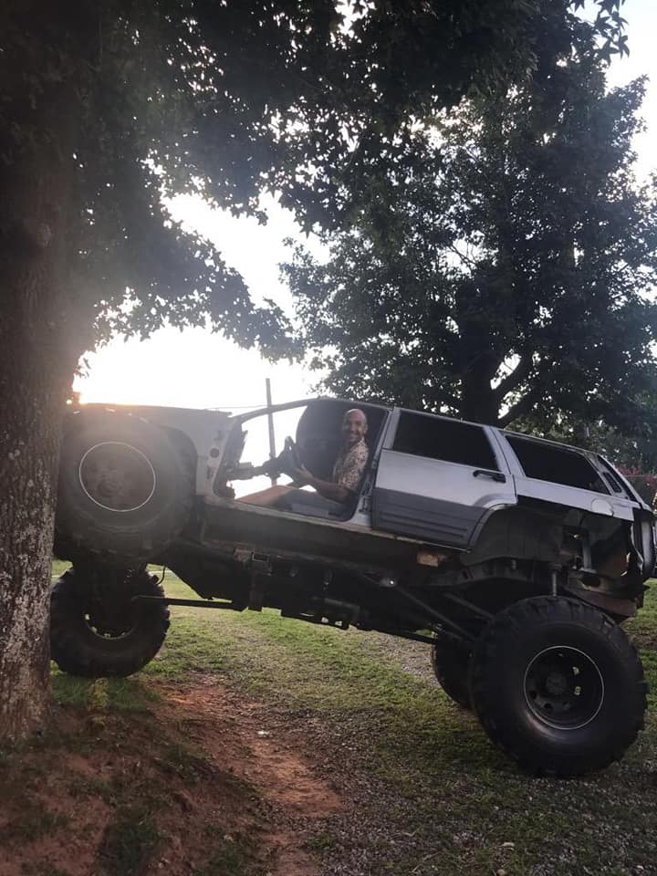

97 ZJ on Superduty axles, 39.5, 4 link, normal fuller stuff
Nothing like the feeling when rear sitting on it's own weight whew...
Ended up with 37.5 lowers, 32" uppers on 3" lift. I cycled the rear and wow, pretty awesome so far. Gonna need some long travel shocks for sure
View attachment 291583 View attachment 291584

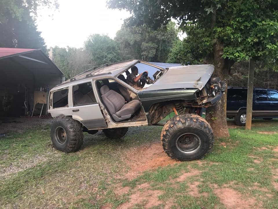

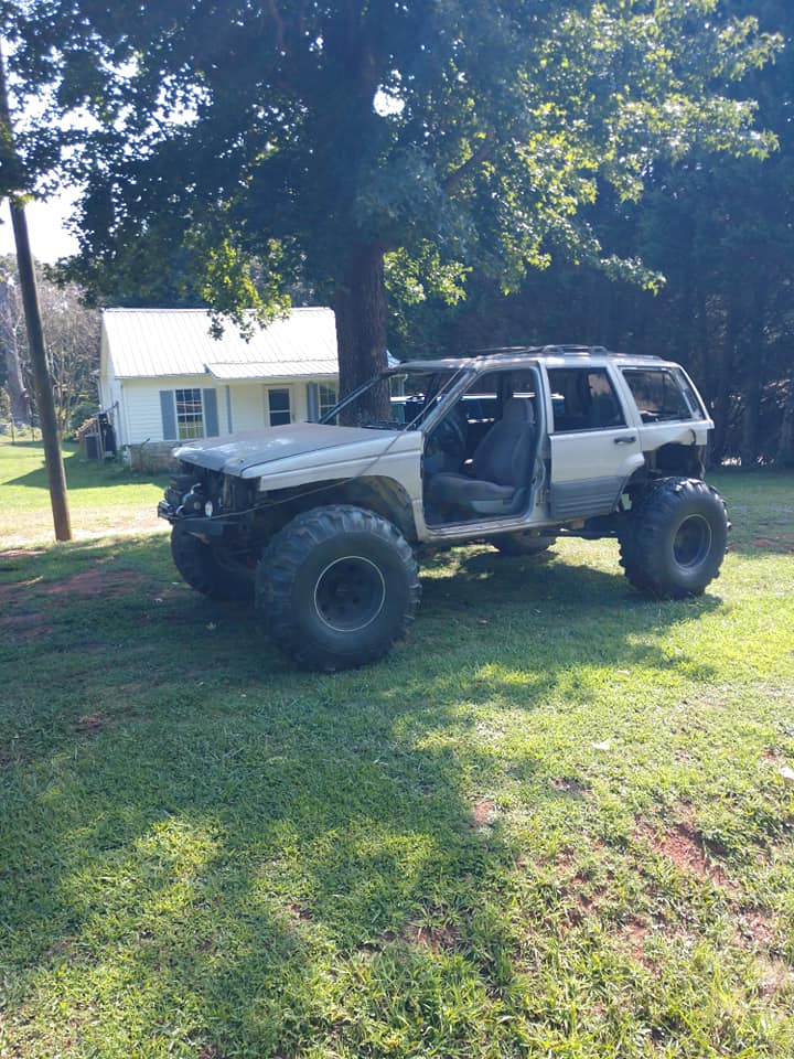

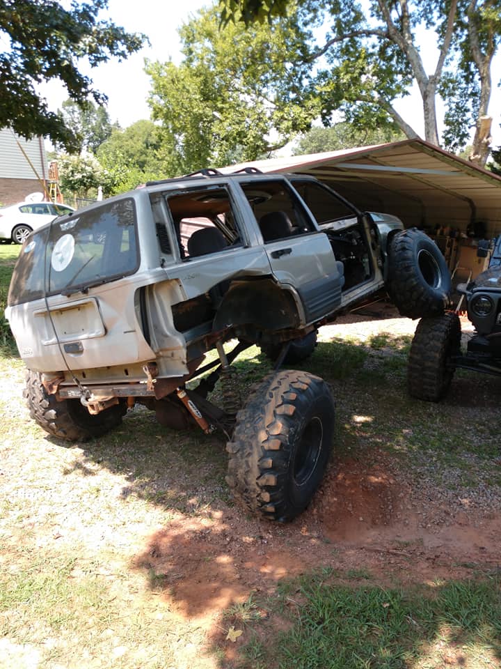

I guess it's worth posting now that's it's finished minus the cage. Still gotta paint, build a dash, lights but it's wheelable.
$1600 so far, 3" lift, 39.5s, 119" wheelbase. Not too shabby of flex.

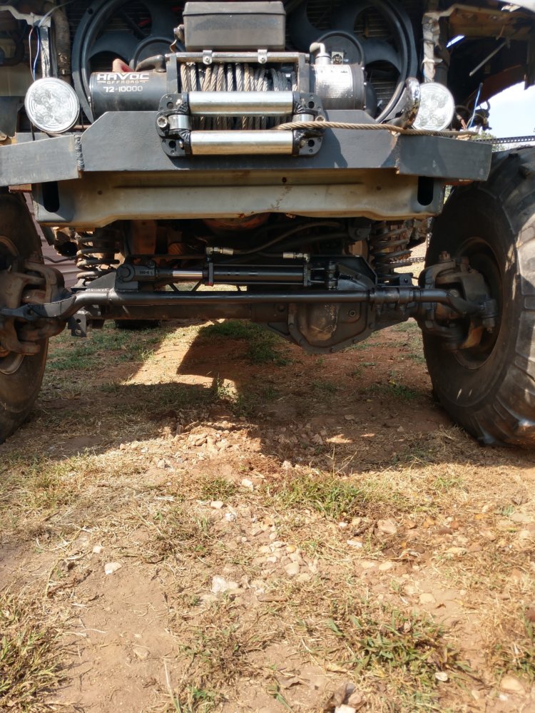

Got full hydraulic steering and for first time, my steering don't look too janky lol can't wait for test run Saturday
Yes that's a factory tie rod cut and turned up for higher clearance. Gussets added on both sides front and back
