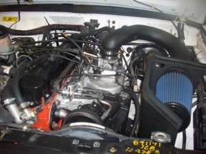

I am not one for build threads. I am usually too busy to stop and take pics. With that here is a few pics of something I have been working on for a while.

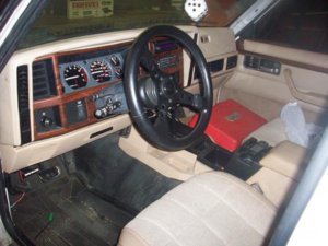

We started doing the interior mods right away and converted it to buckets and a concole, power windos, locks, and mirrors, an overhead console. Added a bunch of woodgrain and bingo we had a king ranch MJ.

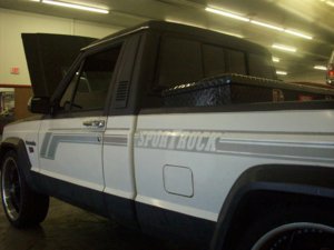

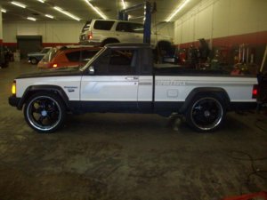

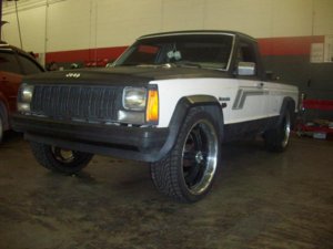

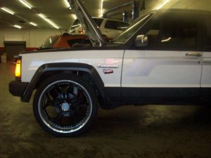

We added the 20's and slammed it also gave it a two tone flat black and white paint job and BAM the "Lo-Manche" was alive.
Later we swapped the 20's for a set of 22's and the "Bro-Manche" was here

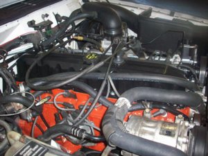

SOOOOO......I found a smoking deal on a slightly used 4.7 stroker and I searched for a wasted 94 XJ 2wd auto as a donor.
Project "Go-Manche" started to take shape!
So here are the pics of what we ended up with. specs to follow.
It sounds absolutley nasty
specs are:
1989 comanche bought from "thecarman" Richard. Its my understanding this was his dads trucks and it sat a while. The 3 inches of mold on the paint was a dead giveaway.
I then scored a used 4.7 stroker with super low miles from *****. it was sitting in his shed waiting for a project to go in to.
I scavenged for a clean parts truck to canibalize and ended up with a blown motor 2wd auto XJ for a song.
I wanted a good driving DD for work duty and parts hauling that would bring the mail and get 20-25 MPG or better. I am going to start driving it tomorrow so we will see long term report on the fuel economy.
The motor is a 94 block decked .10 and bored .060 over
A 94 7120 head with new valves and some mild porting
speed pro H825CP pistons with a 15cc dish
comp cams #68-231-4 206/214 cam
pacesetter header with 2 2" collectors
2000 XJ intake
62MM throttle body and spacer
ADJ hesco fuel pressure regulater
24lb ford mutang cobra injectors
AFE cold air intake
Im running a used AW4 trans and of course 2WD for speed/economy DD use
Currently it has a 4.10 geared d35 but i am getting a 8.8 with 3.55 gears and a posi from Chase at ECGS next week.
I also have in the works a plan to add F-1 paddle shifters using the tech info from AW4-shifting.com
We line-x'd the bed and added a killer stereo and alarm/remote start/ keyless is coming soon.
When i did the interior conversion i scored a zero mile cluster with full gauges of ebay. It was a leftover OEM part new in the box. Saweeeet! new build...no miles!
we have driven the truck about 20 miles to date so far and first impression is its quick but grossly over geared. I am not getting the put-you-back-in-your-seat acceration I was hoping for but it will ball the hell out of a 22" tire easily by gently pressing the go pedal at anything under 25 mph.
There is still plenty to do but Im anxious to start driving it and fine tuning the AFR numbers to maximize my power.

so engine is in and all working?
yup, after lots of little bugs to work out. everything I used was secondhand and untested in an effort to keep it cheap.

I would like to see the build sheet for the stroker.
What changes have you made to the cooling system keep that beast cool?

no build sheet for the hard parts in the stroker past what i already posted, just the add ons to make it work in my application. It has a new 3 core radiator, high flow thermostat and neck from Hesco as well as a high flow FLowkooler water pump.

22" tires are too expensive to burn any more than i already have during "testing"! come by the shop you can see it any time, i will be hopefully driving it everyday.

that was my original plan or a 3.8 supercharged buick but the stroker came along and it kept with the ratrod-ish all Jeep theme of the truck. its got all the best jeep had to offer through the years in the drivetrain.
next step should be a facelift.:huggy:
i didn't want the newer front end on it. I want t to be more of a beater old school kinda thing. its complete with scratches and dings and original decals on the side.
