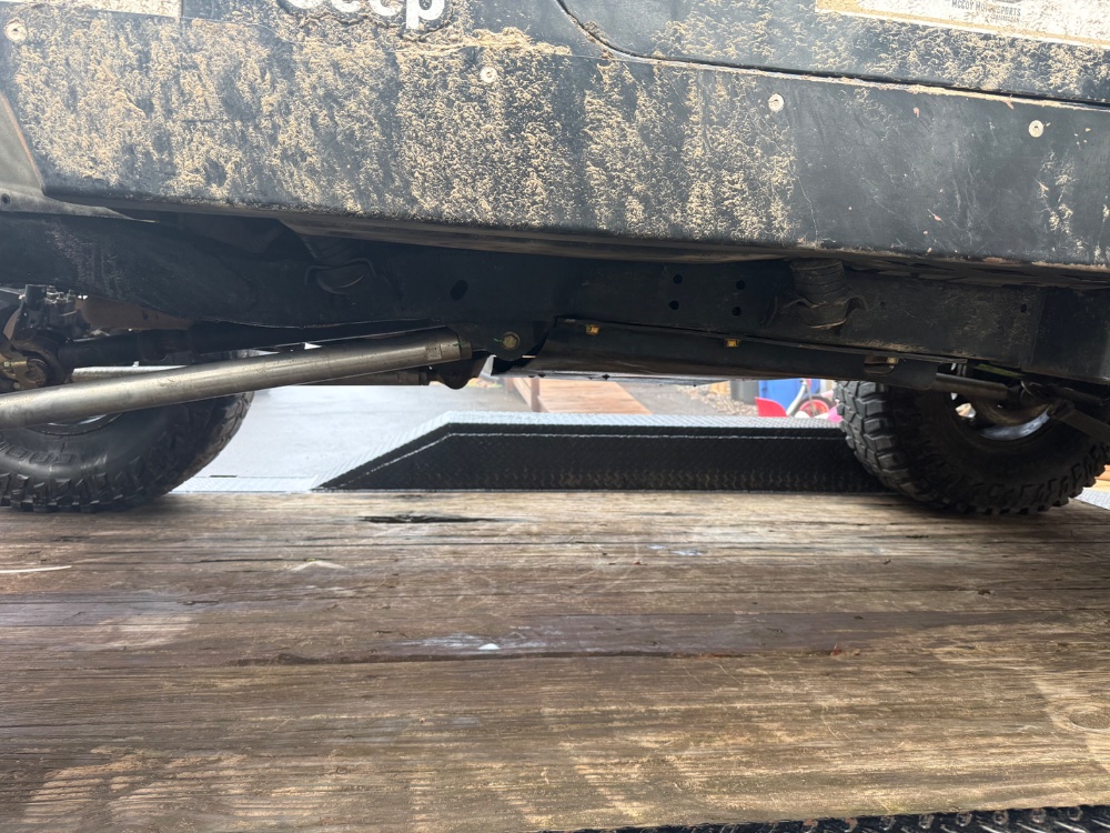

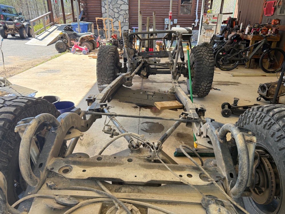

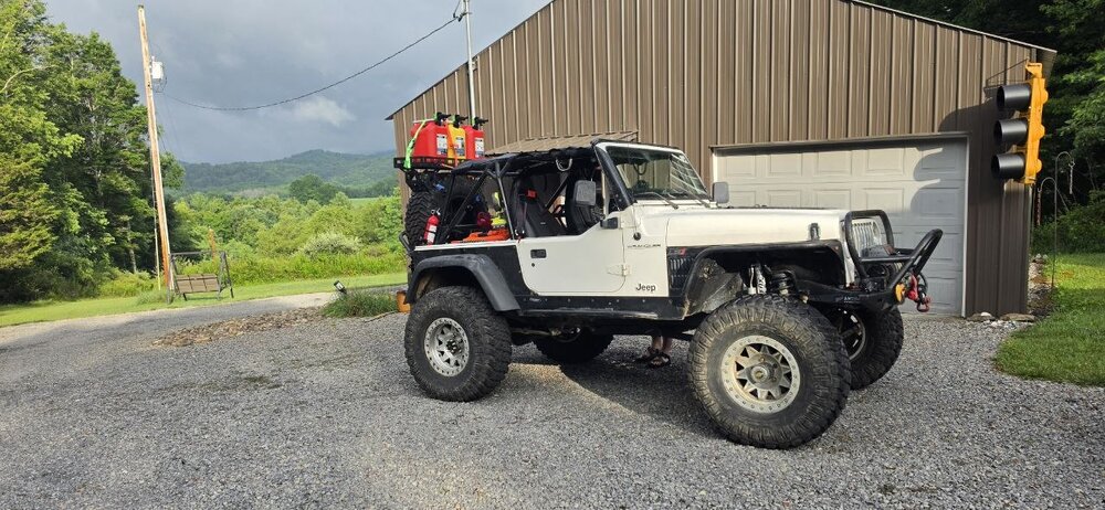

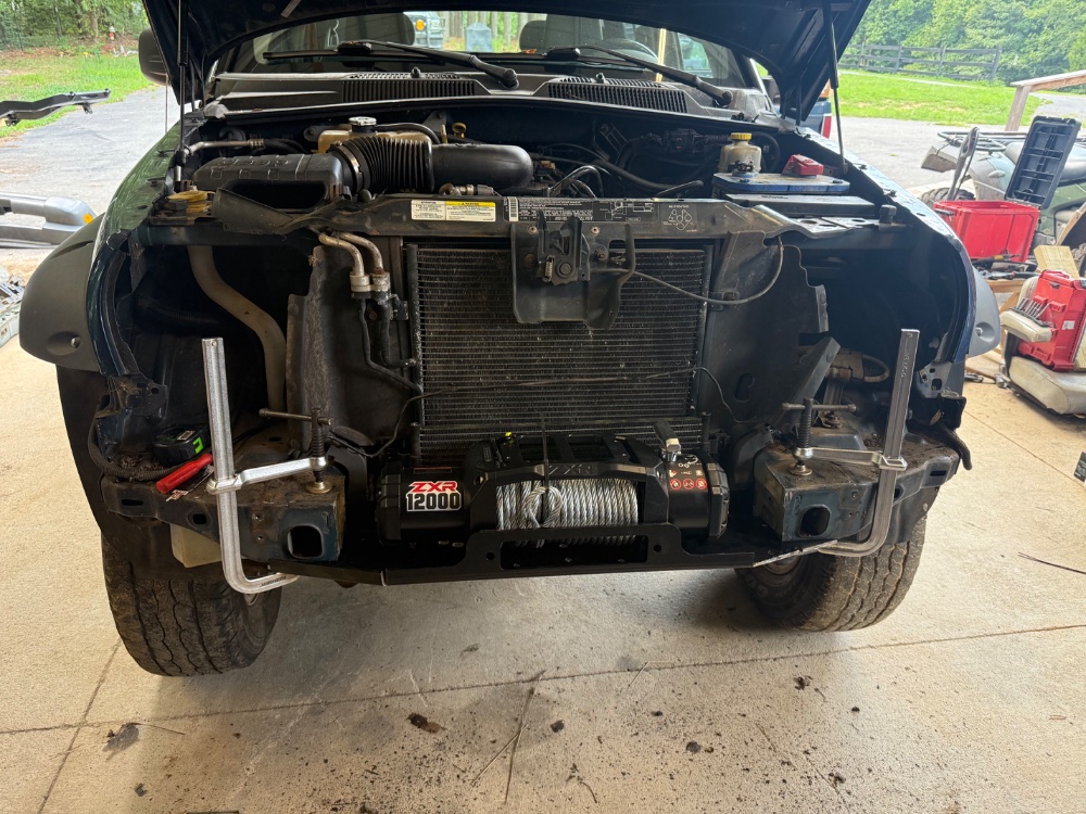

That’s what’s twisted and broken on the front of it right now. It may end up getting replaced with a fresh one before it’s all back together. Most of the damage is on the driver side frame rail right in front of the transmission skid. Link mount shoved the rail up, in, and back.
I know throttle down kustoms will sell you just the rails in thicker tubing or a whole frame for that matter

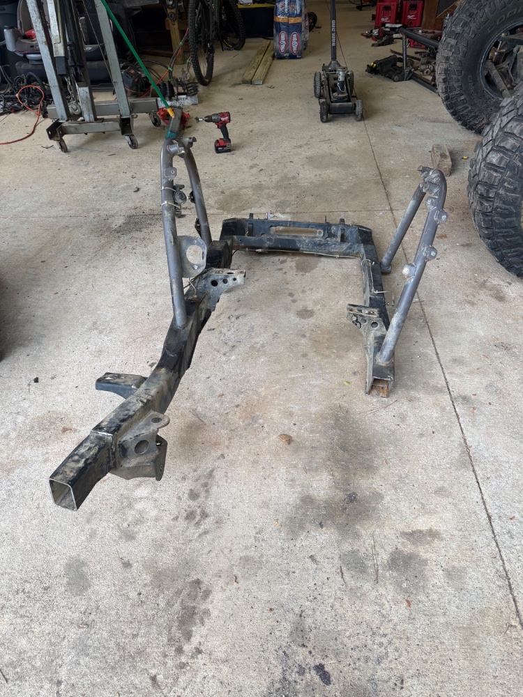

I looked into them but they’re pretty proud of their stuff and I’d have to ship it from Montana. A buddy of mine found me a good tj frame that’s cut off a little in front of where you cut for the Motobilt stuff. I’m planning on cutting the driver rail out where it’s already spliced into the LJ back half and either cutting the rail out of the Motobilt one or just replacing the Motobilt stuff altogether. I’m pretty happy with how the front stuff all worked out so it’ll likely get copied over to the new front kit if I end up going that route.
Without going into too much detail, there’s some damage on the Motobilt stuff that really shouldn’t have happened with the way the jeep hit. I’ve talked to them about it and they’re going to take care of me so I’m not going to put it out there for the interwebs to run with. It probably saved the passenger rail from getting messed up with what happened and isn’t a major fix to deal with.

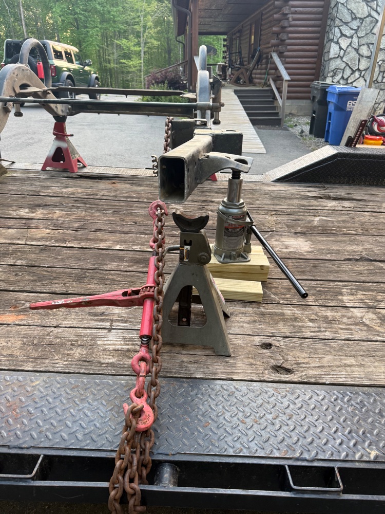

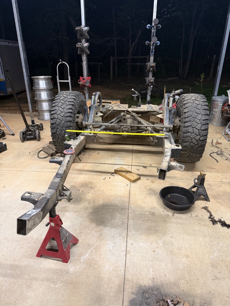

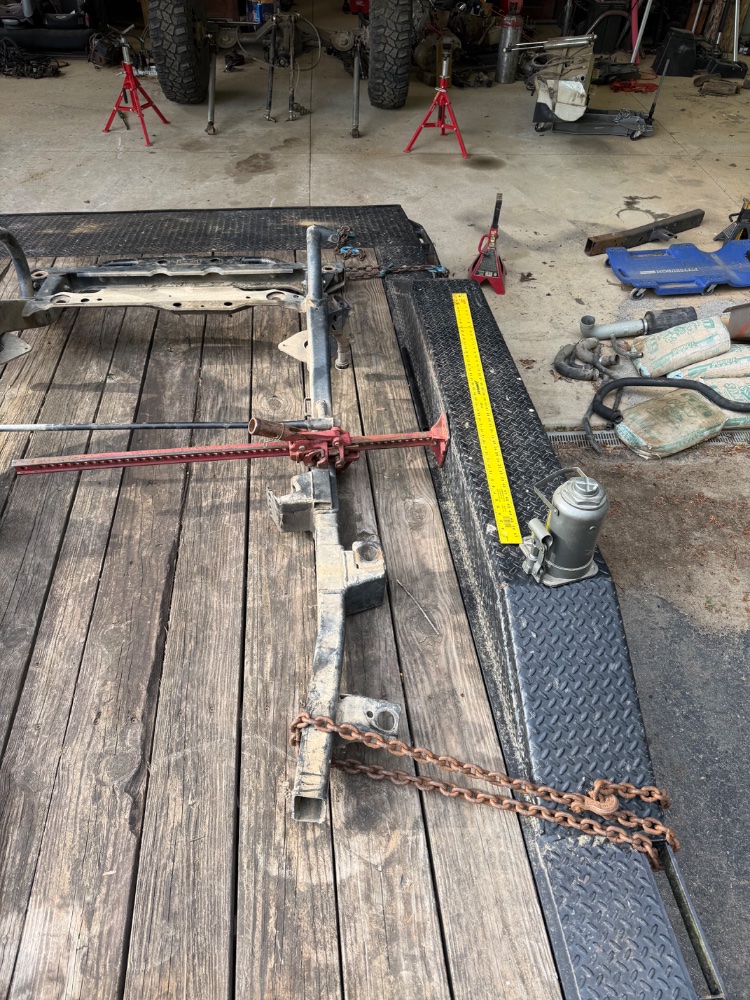

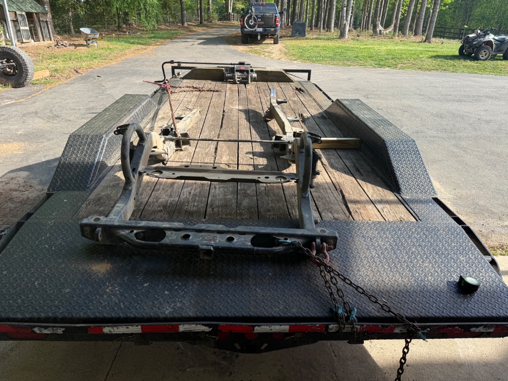

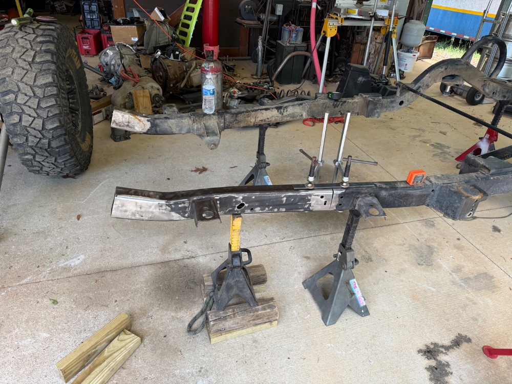

I’ve got it just about torn all the way down to fix the frame now. Driver side frame rail was bent about every way it could be. Passenger side seems to be good though. I’m going to strip it to a bare frame and use my trailer deck as a frame machine to get the rear squared up the rest of the way and then start rebuilding. It sprung back pretty close once I cut the driver side in half so it shouldn’t take too much to get right.
There’s a brand new Motobilt front half kit sitting here to go on it. Motobilt went WAY above and beyond on fixing the issue I had. The plan is to pretty much copy the steering/suspension over to the new rails.

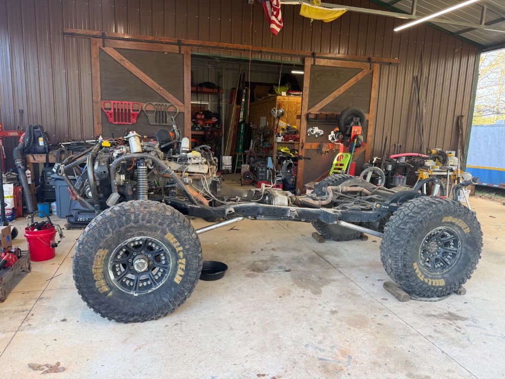

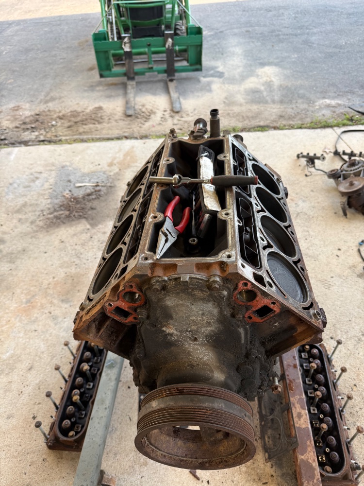

The LQ4 is stripped down to a short block and waiting on me to buy heads and a cam. I’m leaning towards 799 heads and a BTR Truck Norris cam.

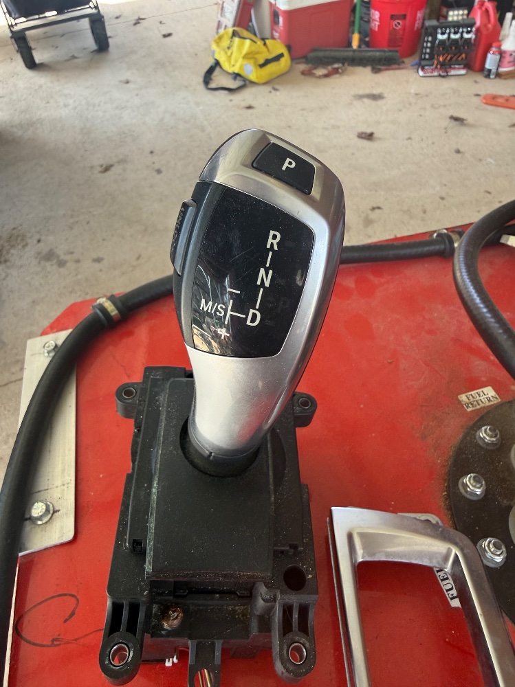

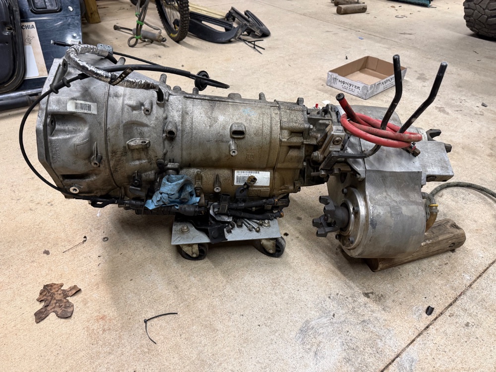

Maxxecu Mini to control the 8HP70 is here too. I need to rent the flash tool and program the internal tcu for it. 5-series BMW shifter is here for it too. And then figuring out the wiring for it all.

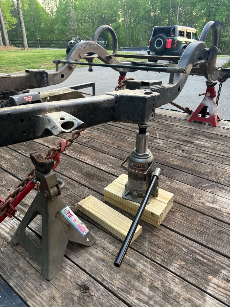

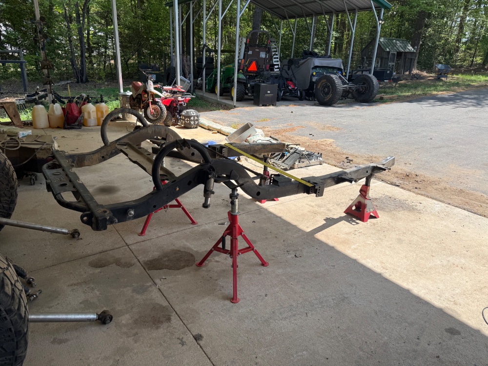

Got it stripped all the way down and on my “frame machine”. I managed to get it pretty well straightened out without too much trouble. There’s still a little bit of a roll in the driver rail that I’m not 100% sure where it’s twisted at. I think it’s right at the upwards bend in the rear. It was bent to the side there too but my old hi-lift took care of that pretty easily.
Grabbing a set of heads for the LQ4 tomorrow. I’ll order the cam and all the gaskets/bolts I need soon.

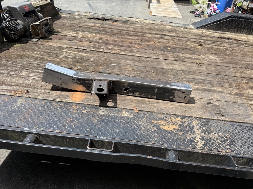

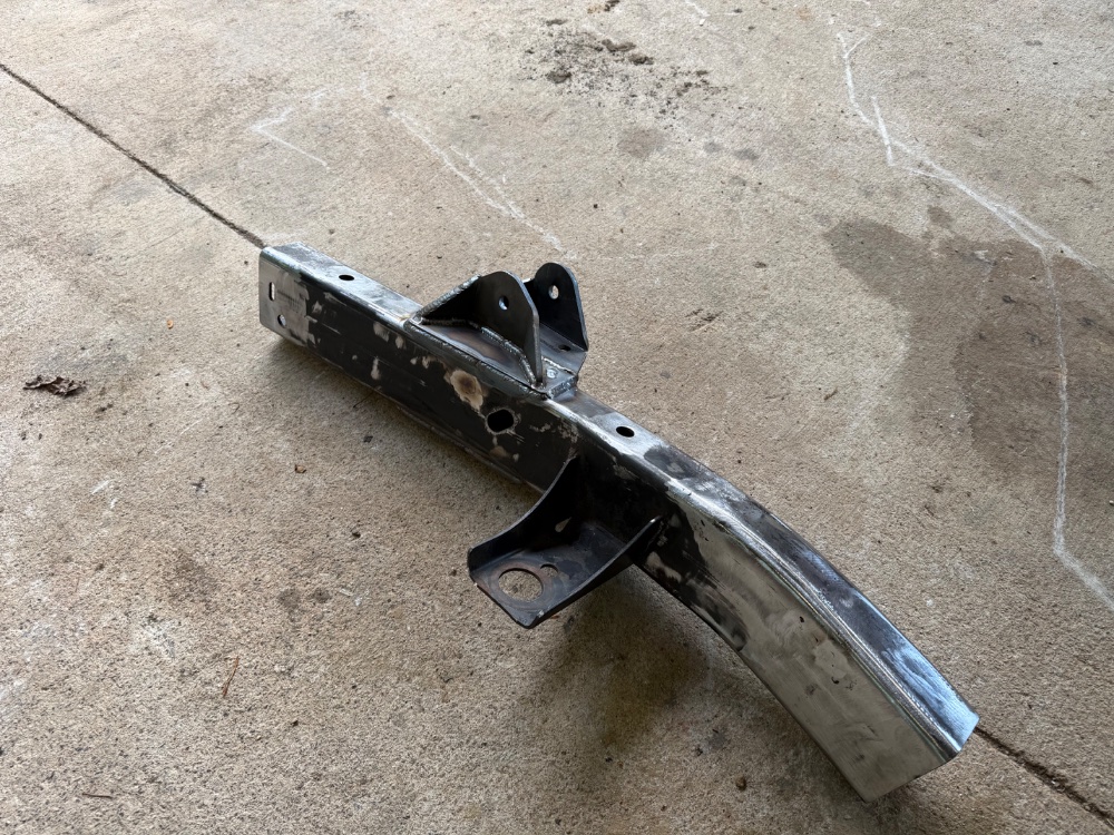

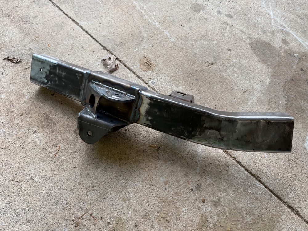

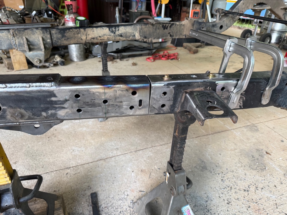

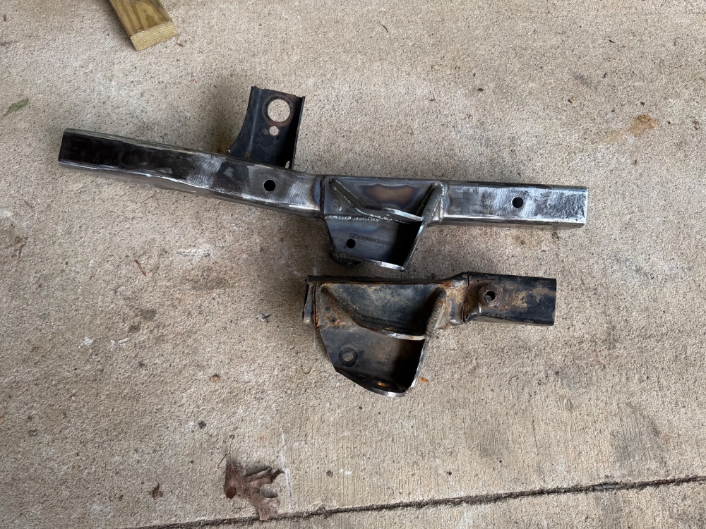

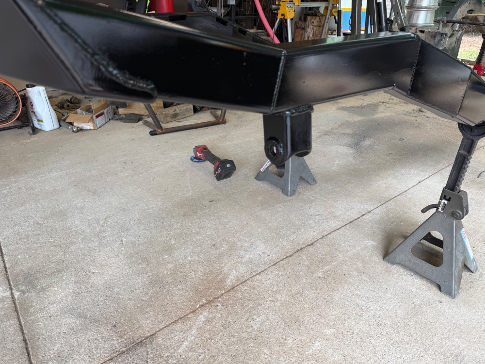

Slowly making progress on getting it back right. I ended up having to buy a new set of Genright 3 link brackets since the driver side one was twisted/bent about every way it could be. Kind of nice getting to weld it on the rail on the bench instead of under a jeep. Splice in the frame is getting 3/16” plate plug welded inside it through all the holes I drilled. Drilling/tapping a few spots in each inner plate so I can pull them hard against the inside of the rails with a bolt to weld them.

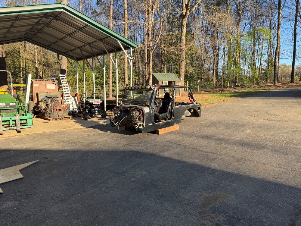

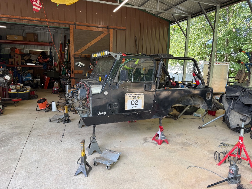

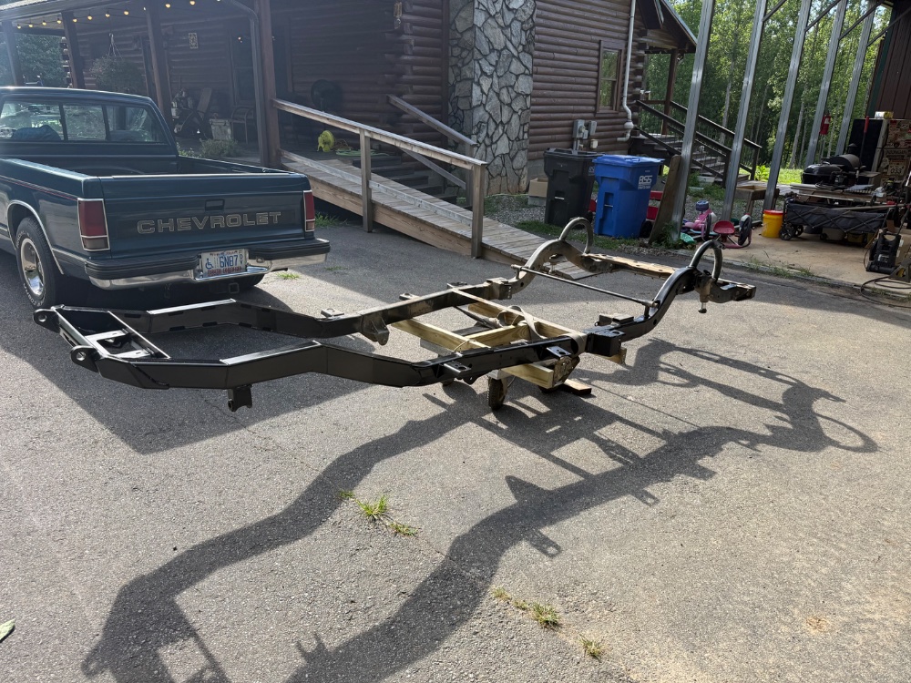

Finally did something on this junk today after not touching it for a couple months. Got the frame side track bar bracket cut off the bent up front half and weldered on to the new one. Then painted all the bare metal and got the body rolled back into the barn. I’m gonna try to slide the frame under it and lift it all up together to get the axles back under it. Then get the LS in place and build mounts.

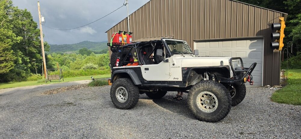

So a couple friends of mine just ran that 1000mile rally that went front WV to KY, they DNF'd with 33miles to go in a v8 tj (fuel pump). I have a feeling I'm going to get roped into one of these rallys in the near future, matter of fact they invited me but I was re plumbing my house and didn't have the time or $$, any tips? I know I need to shorten up my air bumps and get some better shocks, my 2010 era 7100s may be on their last legs lol.
