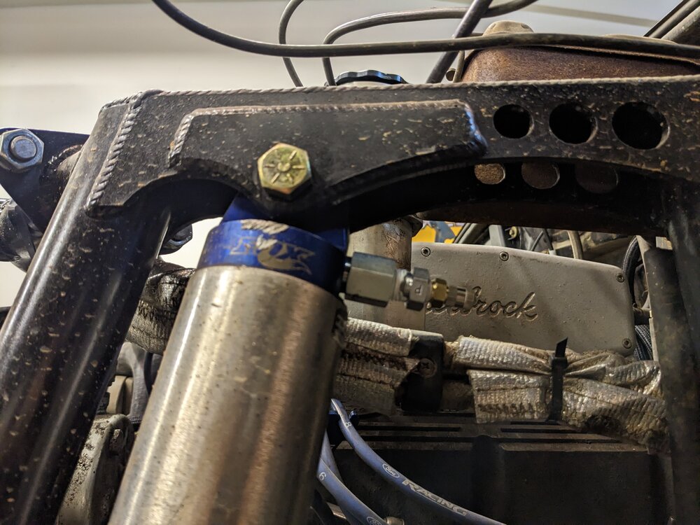

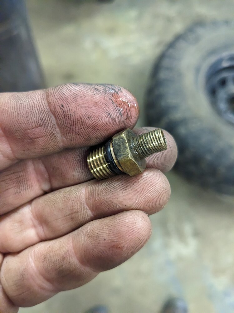

So, one of my Fox air shock shrader (Schroeder, whatever) valves is bent and won't take nitrogen.
Fox, Poly Performance, etc has them available. But...does anyone know if a more common application for them? Something where I can call up a random local supply house and grab one?
I am going to call my local hose shop in the am.
It's 1/4 or 5/16 NPT on one end and a typical air valve on the other.
Gracias amigos.

Looks like 1/8"NPT, but maybe 1/4. 1/8NPT measures a hair over 3/8" (.405"), and 1/4NPT is a little over 1/2" (.540")diameter. Just measure the diameter. McMaster will almost certainly have what you need. And it typically ships from ATL and arrives next day.
5/16 ORB
What he said but it's probably 7/16-20 #4 sae orb. I've got a lot of plugs and orb to jic but not Schrader. I googled it this weekend and only thing close I could find was for bike shocks.

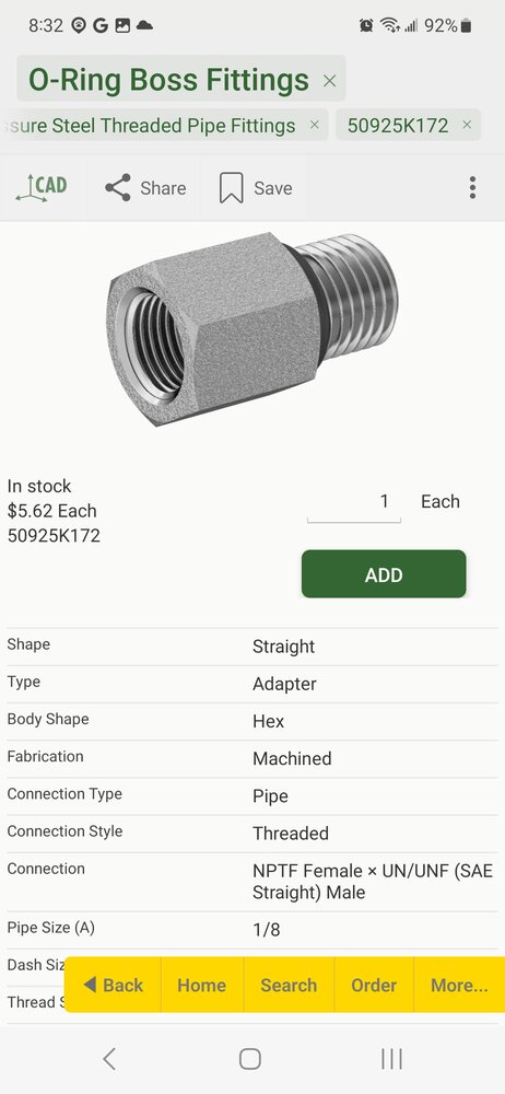

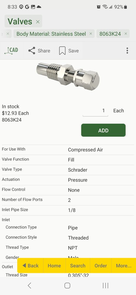

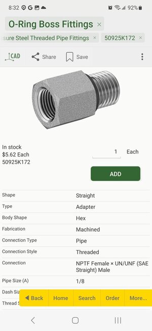

You could put these two together if you had to.
You're correct. I just checked it with a caliper and thread gauge. 7/16 x 20.

I'm digging on McMaster-Carr like you texted. I'm not seeing them in a one piece design.
Send me a part number and I'll put food into you in a non-romantic manner.
I dug around on there and couldn't find anything that matched either. A little disappointing, as they have darn near everything.

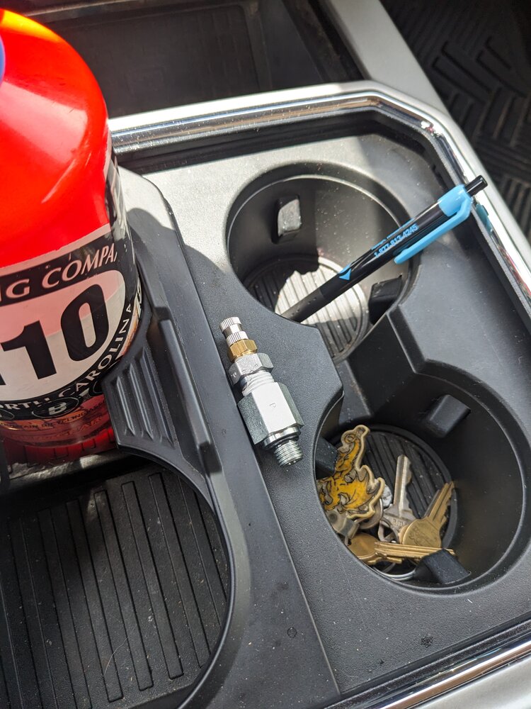

Can you show a pic of both ends please?
I would call that a Tank Valve. Buy them all the time for our pressurized air jacket tanks. FNPT > MNPT > NPT is the keywords we utilize frequently in that area. The oring is what throws me for a loop tho
It's an ORB fitting, not NPT.
Straight treads.
