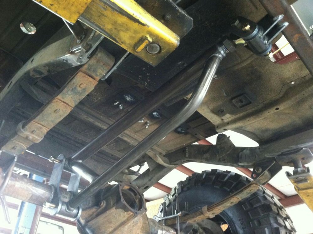

It's got a traction bar. But it's not ideal for lots of up and down wheel travel. I'm not sure if thats what did it or not cause I haven't been able to talk to snappy yet.
Here's what he has now.
This type of bar forces the axle to wrap as it goes up and down through the cycle. With the shorter shocks he's running and stock YJ springs we assumed this would work fine. If it is causing the problem we may have to rebuild it to something more like an old school toyota front anti wrap bar where there's a fixed tower on top of the axle with a link bar from it forward or back to a crossmember with pivots at both ends. That type will allow for full wheel travel without fighting the axles natural movement. I guess we'll see soon. GOOD LUCK TOMORROW SNAPPY!. no pressure but you better win!

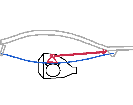

Is this what you are refering to?
Yep but with a taller tower and a little different angle on the link so it works with the springs better. This will still force the springs to wrap through the cycle but it's a bit easier to match the axles natural movement.
Actually. Looking at your drawing you may have meant using one of those on each side mounted to the ubolt plate. I actually meant for it to be toward the center of the axle like what he's got now and only one of them.

How long is the bar you have now? The longer you can make the bar the less it will rotate the axle through the range of travel. The setup snappy has now is probably the most effective IMO and the other ways is a bit less effective but works better with a rig that lands hard in the rear.
