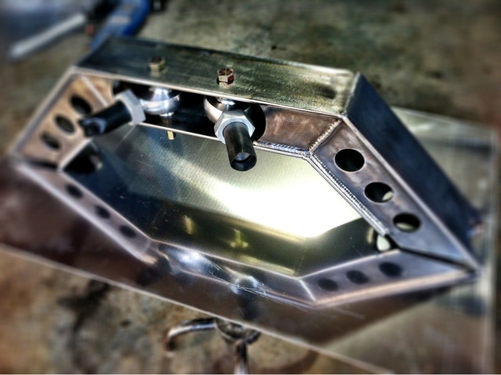

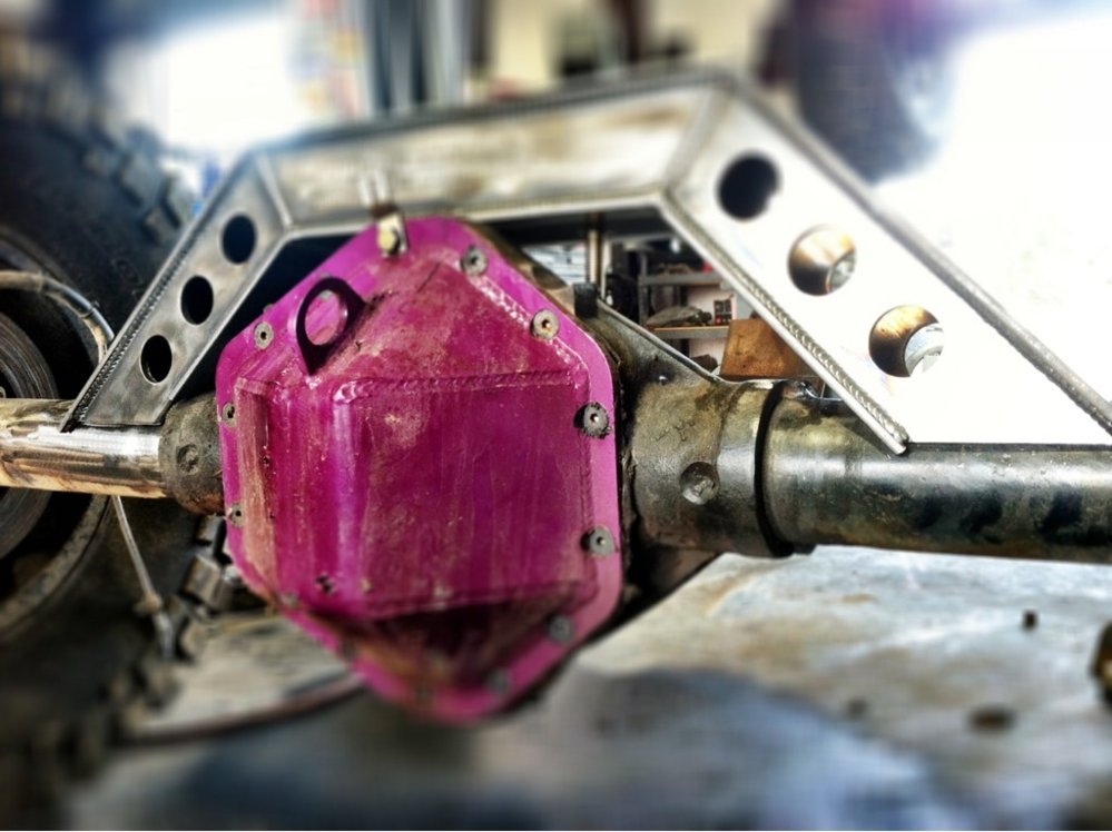

Looking good, its nice to see joints getting side loaded the proper way.
Thanks man. I figured we'd try it out since we're using 1.25 heims on this one. Johnny joints just don't quite have the misalignment in a std. bracket to do it this way.
You da man Marshall!
Thankya Thankya.
Sure, I can call and explain it in full if you'd like but I don't want Snappy's thread to get derailed.
On a go fast vehicle, mounting the joints like that will help control the lateral load better and allow the joints to live longer. While the load is handled mostly by a push/pull on the joints there is pressure from side to side. I've seen Johnny joints blow snap rings out cause they cant handle the side load going fast, and I've had to replace Ballistic joints with Rod ends due to it flaring the forging and spanner nut out slightly. I've been down this road with a couple go fast vehicles and I feel this mounting tends to work the best if the joint can handle the misalignment.....my opinion based off my experience. That's the short and simple explanation, there is more behind it.
Do you run the upper control arm bolts this way at the frame as well?
PS. I am not saying one is better than the other just asking our your opinion
