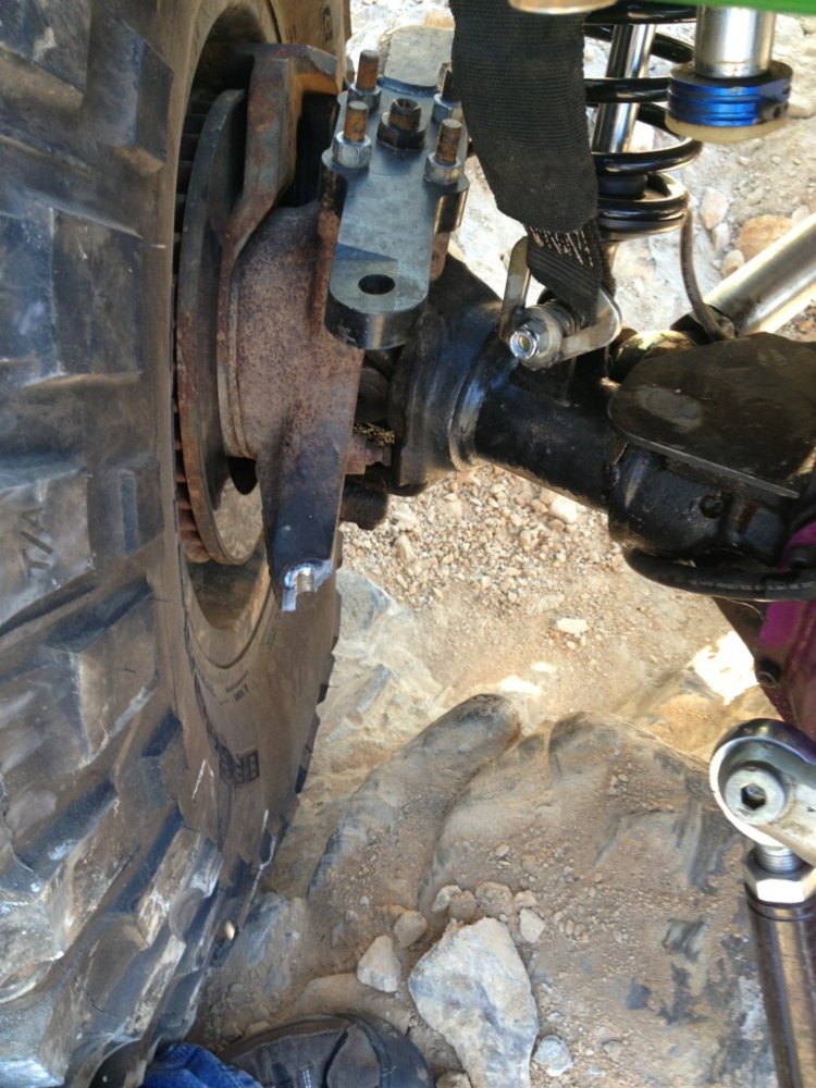

Well guess i didnt see you guys because i has to deal with this after we got the springs on the shocks... Guess time for a set of reid racing outers.
Give a shout tomorrow, I'll hook u up with some Solid knuckles.
Dammit to hell bro.
And i know what it's like not to catch a winning scenario.
Even with the solids I would connect it to your highsteer arm. Be hard pressed to break it then. Have not been able to touch mine after doing it.
