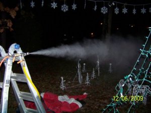

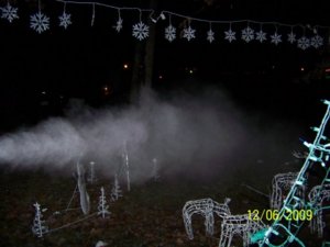

Last year I was thinking how fun it would be to live somewhere that there was snow on the ground all Winter.That obviously wasn't what Mother Nature had in mind so I set out to do it myself.There are simple plans online on how to make a snow making machine at home and for less than $40 in parts from Lowes or Home Depot,you can do it your self.Assuming you have a Air compressor which I imagine 90% of people on this site do.What they don't tell you is that you need a One Way Valve,I cooked 2 air compressors before I figured that out.I had my entire front yard covered by the end of January and my house became the spot that all the Neighborhood Kids hung out.If anyone is interested I will post the plans or PM them to you.Here are a few Pics.

I used larger pipe because it was cheaper.I also added a second ball valve to better control the mix,you can see it in the pictures.Obviously it's Air in on one side and water on the other.Adding a pressure washer will increase the pressure and produce more snow.Also getting pressure washer tips instead of drilling the pipe cap will help vulcanize the water a lot more.The biggest thing you want to avoid is having any water that isn't a fine mist coming out of the valve.

What you need is 27 degrees wet bulb.Which can actually be accomplished at as high as 34 degrees.It's a temperature derived from the humidity level as well as actual air temp.I have also made snow with the wet bulb as high as 31 by pointing the nozzle straight up in the air to give it maximum time to descent.There are simple charts for it or on the main page of this site there is a spot to put in your zip code and it will tell you what the wet bulb is.The site is

I used a 2 horse 8 gallon $99 air compressor from Harbor Freight.I think a 3 horse would be better,the 2 horse ran almost non stop.The one way valve is to keep water from backing up into the compressor if it shuts off,so it goes on the air line.I used to let it run most of the night and shut it off when I went into work in the morning.It would put down a line about 8 feet wide 15-20 long and make about 3-4 inches deep of snow a night.Although I figured out too that if you pointed the nozzle almost straight up,you would get a huge round area of snow.By the end of January last year I bet there were place in my yard that were 3 feet deep.
