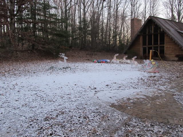

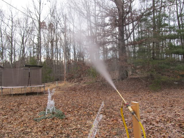

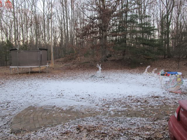

I just have the one nozzle and it's actually not a nozzle it's just a pipe cap with the 2 7/64 holes drilled in it.I am not sure what to do with the air hose freezing up,I am gonna play with it more today.Where did you get your no return valve willness?I can't find one that will do what I want it to do.Anyways here are some pics from the coverage last night.I think I ran it about 2 hours or so.You can see how fast you could cover your yard with a thin layer of snow and keep adding to it.You can also see in the pics how the wind really blew it around last night.I will post more pics maybe this weekend or next week when I have covered more of the yard.

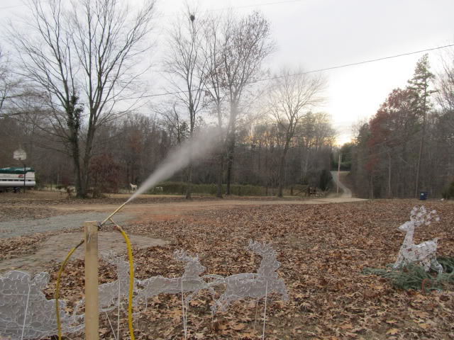

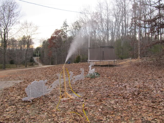

Second attempt and the snow is blowing.
These pics are about 1 hour old and the snow is definitely starting accumulate.
