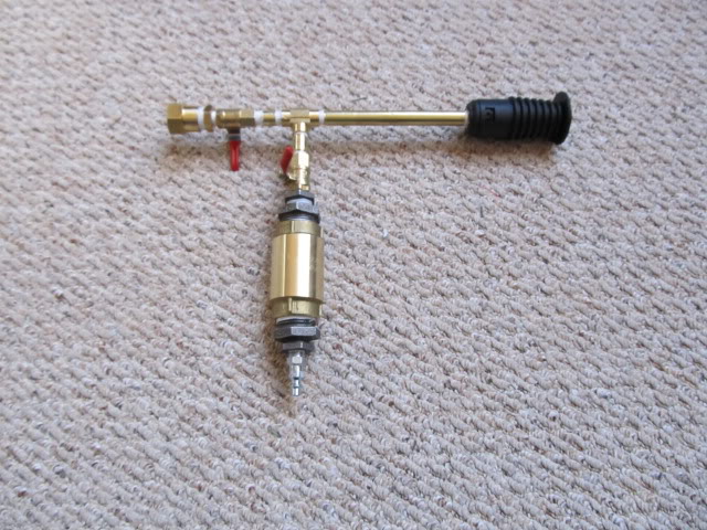

Decided to give this a go. I've been meaning to do this for a while, but tthe snow yesterday made me realize that the time is now. I went to Lowe's with my list and got busy. I ended up having to use brass since they didn't have any of the stuff I needed in steel. I went with the 2 valve idea. I was disappointed to find the smallest check valve they had was 1". This drove the cost up a little bit. I had to adapt the 1" valve back down to 1/4". No real big deal. In the outdoor power equipment department, I found a replacement pressure washer tip that has the twist thingy to adjust from a straight to fan spray for $14. It was a NPT 1/4" thread so it works perfect. Pics of the assembly.

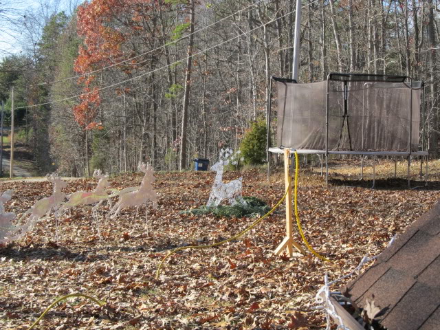

The stand I threw together.
What I want to try and bury with snow.

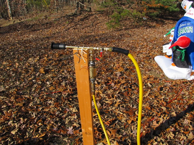

Well I Fought an Iced Up Hose and a new sprayer Nozzle but the Snow machine is out there running.It's only been 15 and I already have a larger patch of White On the Ground!!!It's hard to tell a little from the crappy cell phone pics,but if you look to the left of the big tree you can see the mister.If you look to the right you can see how white the water already is as it falls to the ground.

Oh for the guys making them at home.The Pressure washer type tip I got didn't work worth a crap.I spent 25 minutes trying to get the mist dialed in.I went back to a regular cap with two 7/64 holes drilled in it and had the consistency I wanted almost instantly.
