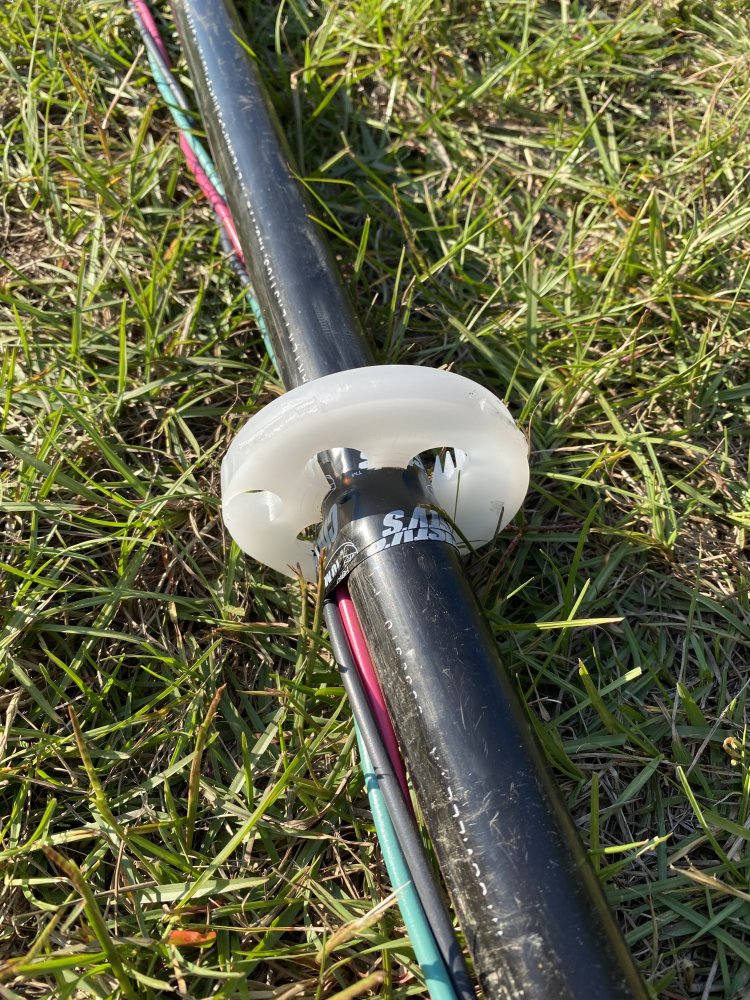

Yes. Fix them now if there are any and add the little plastic "standoff/pipe centering" things and a good torque arrestor.

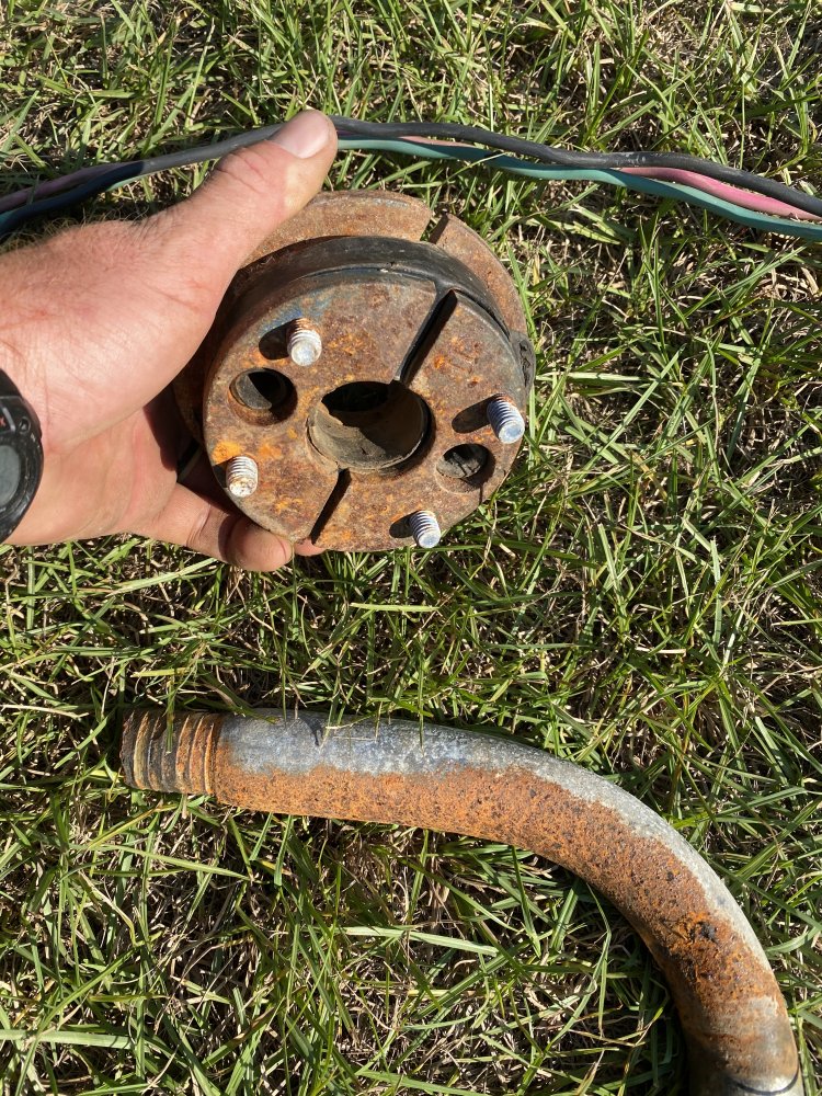

You can do it with four people pretty easily. Two people hand over hand pulling it out of the pipe. One on a-frame ladder to help the break over and one walking it out. As others said don’t loosen the top four cover plate bolts too much, they are just two plates sandwiching a piece of rubber. You’ll know when you have gone too far bc you will hear the bottom plate falling down the well. If it’s pvc get ready to repair it multiple times. It’s always fun to have cold wet hands in the winter.

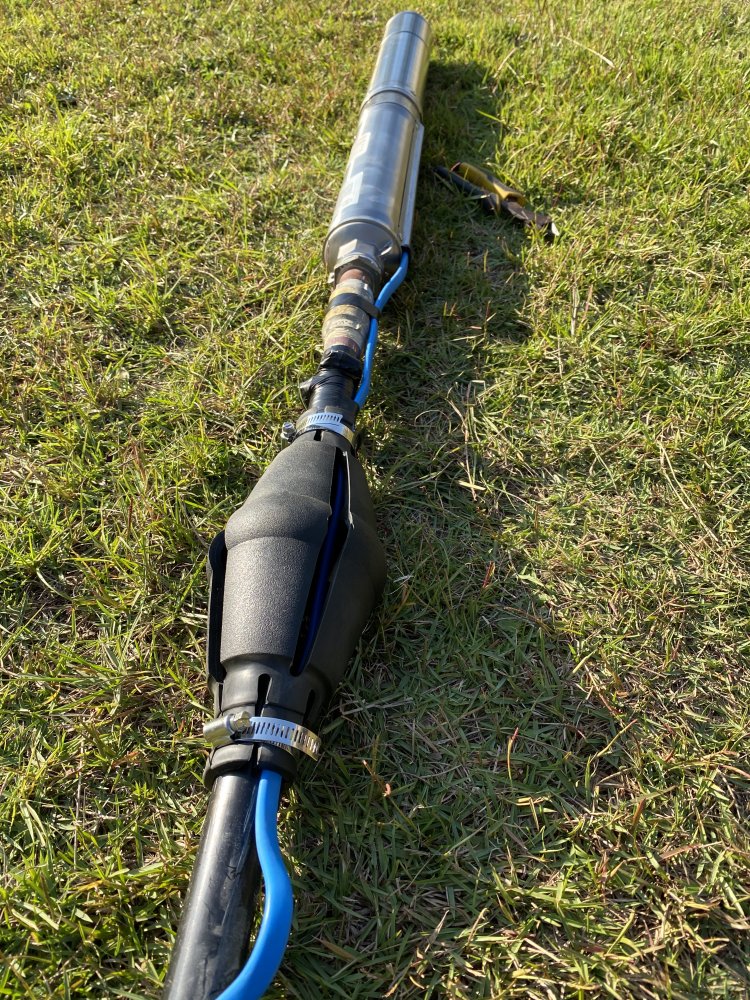

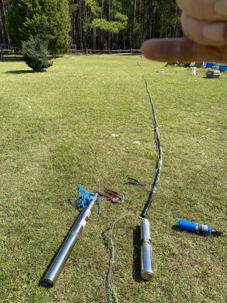

Here are some when I did mine late summer. I pulled it on my own but it’s only 93’ from cap to pump so not horrible. My cap had a threaded lower plate some of the videos I watched had captive nuts either way do not let that plate fall!
They are really not that hard to pull. All you really need is a roller built somehow (which I really need to do). The places around here charge 650 bucks to pull a well pump, it takes about 20 mins (or less) with 2 people do it once you have done it before.
