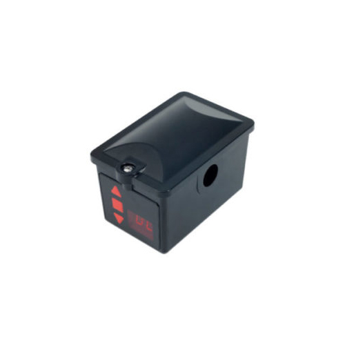

I recently replaced my electro-mechanical (standard) switch with an Amtrol Guardian CP digital pressure switch. I have had three or four standard switches fail since I bought my house in 2007, the newer ones suck and drift or start sticking. This last one started drifting again (high cutout went low) and I was tired of tweaking it, plus having a digital readout instead of an analog gauge is super nice. Expensive but hopefully the last control I buy for this house.

Guardian CP® - Amtrol
Digital Control The Guardian CP is a versatile digital control that protects submersible and jet pumps against rapid cycling, low water and improper wiring. Its pre-programmed 40/60 setting can be adjusted to a 10 PSIG differential to provide consistent, city-like water pressure. Easy to install...
