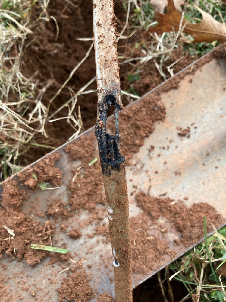

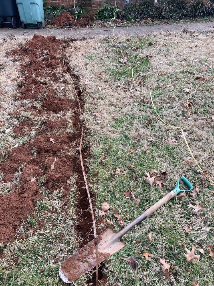

Welp, not so lucky. I appears there is a cut in the wire somewhere between the breaker box and pump house. Still shorting out with no draw on it. Get to start digging in the morning. At least it will be cold and windy :cool:
Short term run new wire above ground in conduit then dig and drop.

On a side note, I ran a temporary line to the pump this morning. 3 hrs and all still good. Off to Lowe’s to get some larger wire. The only real bitch, besides the area below the panel is the only area not in the basemen, is where I have to go under the sidewalk to the back porch. Stay tooned!

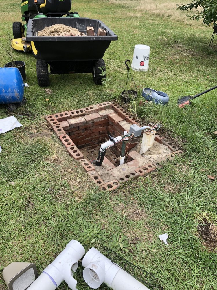

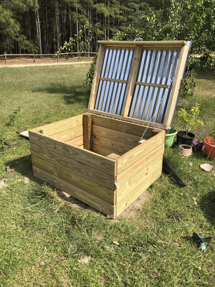

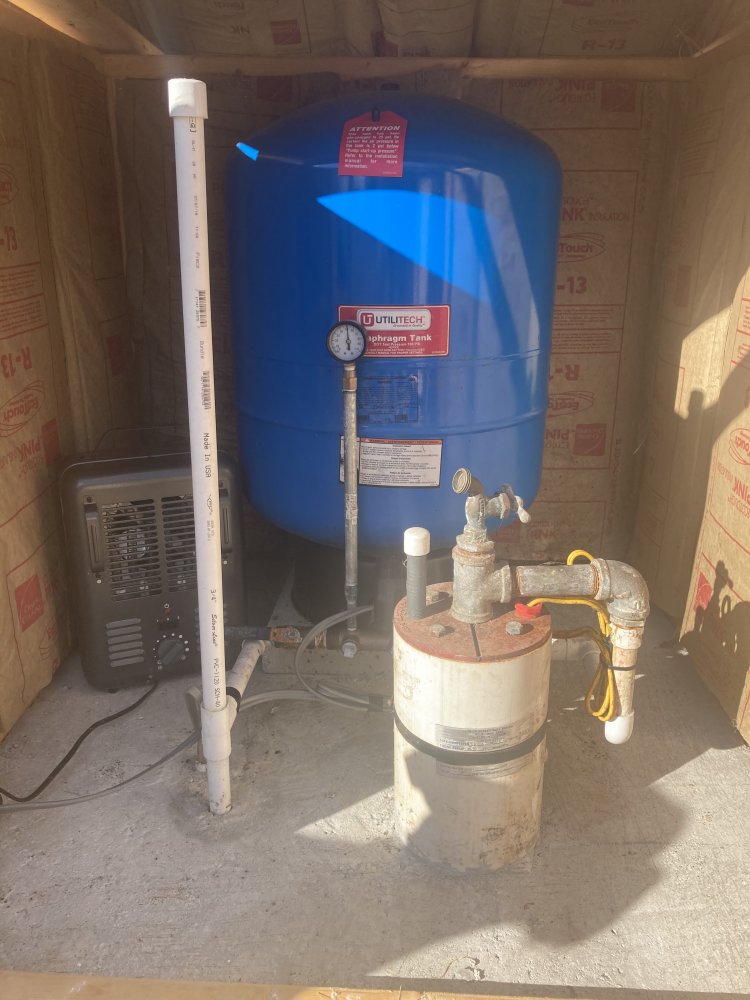

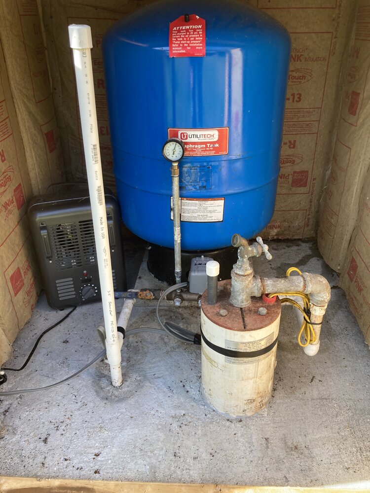

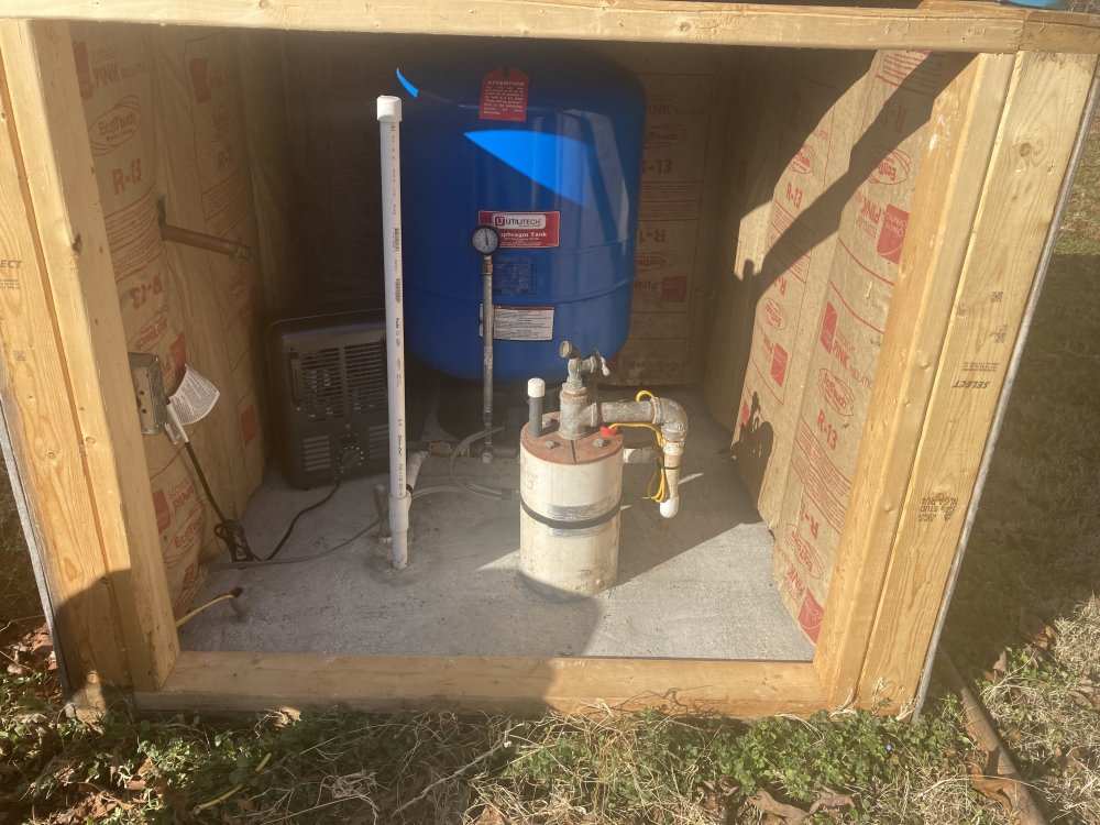

That’s why I bumped mine down to 50. It also helps to get water in the 1” line out to the barn and the second pressure tank I have out there (25 gallon horizontal) my big tank in the pump house is vertical but my well house is dug into the ground about 24”View attachment 336001View attachment 336002
I would love to know the first guys thought process behind putting half his pumphouse below grade in a dry stacked brick box.
Yeah I’m not sure. When we first moved here it was a concrete cylinder type surround with a concrete lid that was sunk in the ground about 4 inches. The top of the casing is only about 6 inches above grade. The first pressure tank exploded because it was buried by an idiot (before we purchased) it filled the whole cylinder thing with water. I dug it all out, lined it with brick and built the wood pump house that’s there now. All of the plumbing just worked easier that way and at the time I was in a hurry to get water back flowing to the house. Probably not the best design but it has never had water down in the hole ever since I “redesigned” it.

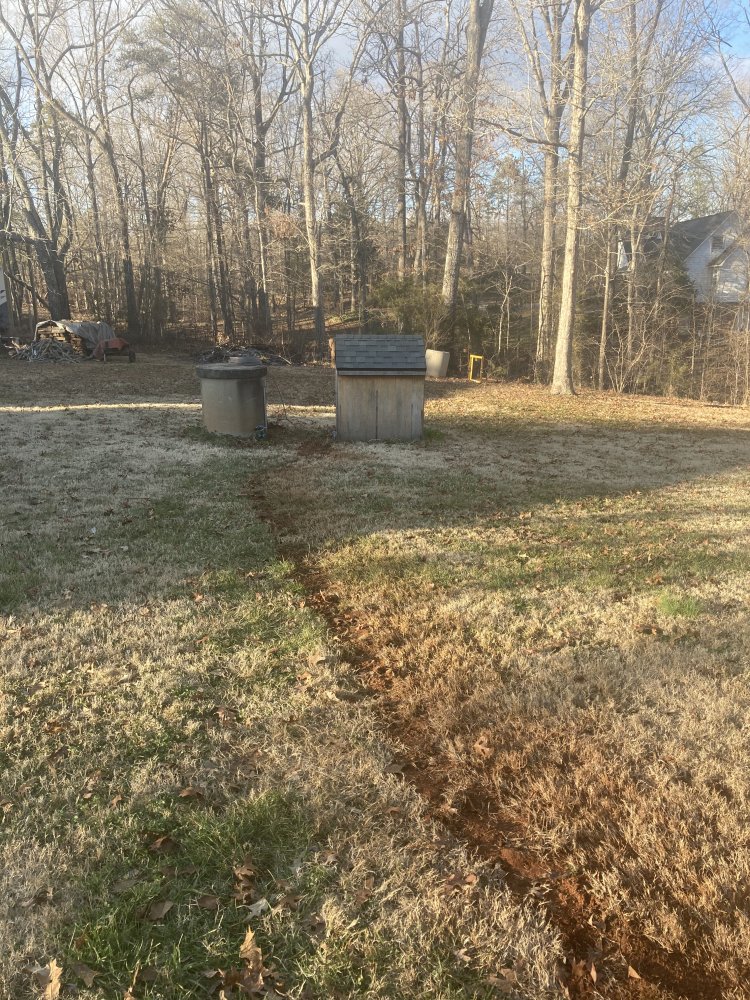

Got it all wrapped up today. New wire from box to well house, new breaker, all good! Have the RV line ran to pump house, still have 100 more feet to shed. Going to rent small trencher next week for that. Shoveling sucks!

Post a pic of your tank/switch setup. If the pressure switch uses a sense line, sometimes they will get half clogged with sand or scale and not let the water pressure off the switch quick enough. Causes a similar issue to yours.
Pic in post #43 above of the set up. Switch in tapped in the main line. I replaced the tank back on 2021, but will check it to make sure it is good. Thanks for the comments!!
I've had new tanks fail in a few years but that just causes short cycling after the bladder is completely full of water. I've seen the foot valve fail but that was a blow thru out the side due to rust. That cause a constant run of course. Stick to everything above ground while you troubleshoot. Check the schrader valve for water on the tank. Watch a few cycles on the pressure switch. If you're getting water then your pump is OK. Wells are are as simple as an air compressor. If and only if everything above ground checks out, pull the pump and check the foot valve. 305' will be a bitch so call a friend or 2.
New pressure switch for the win! Took cover off to see what was happening and when pressure dropped to dropped below 30psi, the contacts would not close for 10 to 12 seconds. Once the closed, it would not open until it was about 85 psi. Ran up town and picked up a 40-60psi switch, installed it, bumped pressure tank up to 38 psi, all good now.Woo hoo! Now to see how time I have left before the pump actually does need replaced.
