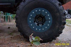

BRUISER silent.. but deadly Moderator Joined Mar 17, 2005 Location Raleigh Apr 24, 2005 #1 well I decided I need to get some beadlocks.. so I made my own Attachments beadlocks 006small.jpg 28.3 KB · Views: 546

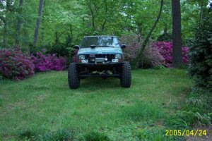

BRUISER silent.. but deadly Moderator Joined Mar 17, 2005 Location Raleigh Apr 24, 2005 #2 pic 2 Attachments beadlocks 009small.jpg 38.9 KB · Views: 558

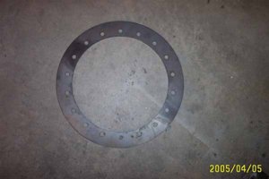

BRUISER silent.. but deadly Moderator Joined Mar 17, 2005 Location Raleigh Apr 24, 2005 #3 Pic 3 Attachments beadlocks 011small.jpg 36.9 KB · Views: 562

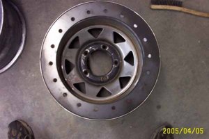

BRUISER silent.. but deadly Moderator Joined Mar 17, 2005 Location Raleigh Apr 24, 2005 #4 pic 4 Attachments beadlocks 014small.jpg 61.6 KB · Views: 551

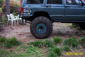

BRUISER silent.. but deadly Moderator Joined Mar 17, 2005 Location Raleigh Apr 24, 2005 #5 pic 5 Attachments beadlocks 016small.jpg 44.4 KB · Views: 565

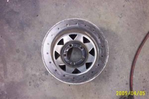

BRUISER silent.. but deadly Moderator Joined Mar 17, 2005 Location Raleigh Apr 24, 2005 #6 pic 6 Attachments beadlocks 018small.jpg 59.6 KB · Views: 531

BRUISER silent.. but deadly Moderator Joined Mar 17, 2005 Location Raleigh Apr 25, 2005 #9 stone4x4 said: where did you get the bead lock kit? how much $$ Click to expand... I made them I took measurements off my rim... input those number into Autocad.. then sent files to LAser cutter and cut them out... oh ya I also welded on the rings

Rich Asshole at large Joined Mar 17, 2005 Location Central PA Apr 25, 2005 #10 Cool! Are the edges on the 'starburst' rounded? looks like you might cut yerself pretty good when you reach in to air down...
BRUISER silent.. but deadly Moderator Joined Mar 17, 2005 Location Raleigh Apr 25, 2005 #11 Rich said: Cool! Are the edges on the 'starburst' rounded? looks like you might cut yerself pretty good when you reach in to air down... Click to expand... Nope nice and sharp hope no one tries to mess with my rims. hehehhehe they might not be very happy when the reach in
Rich Asshole at large Joined Mar 17, 2005 Location Central PA Apr 25, 2005 #12 anti-tampering.. I like it...
