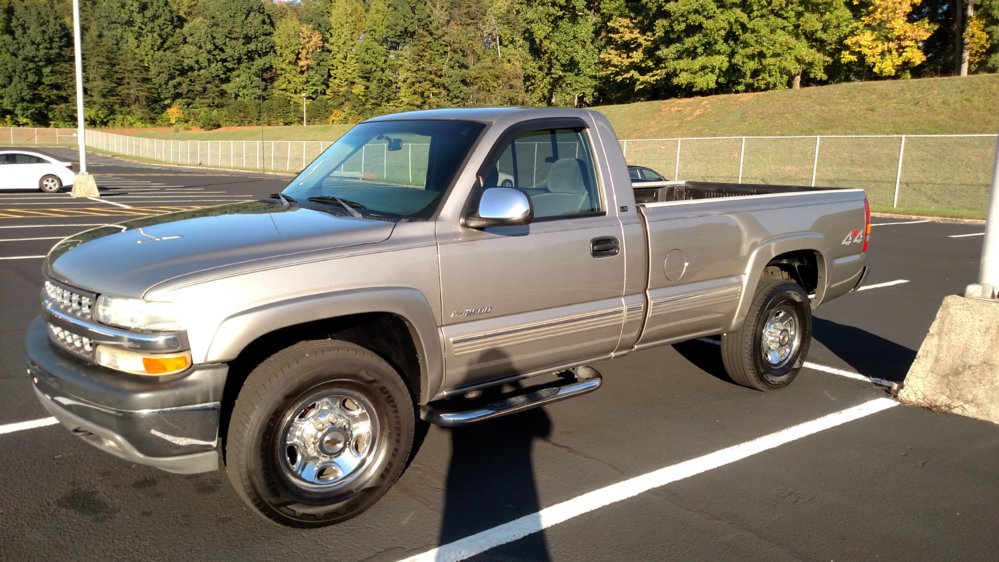

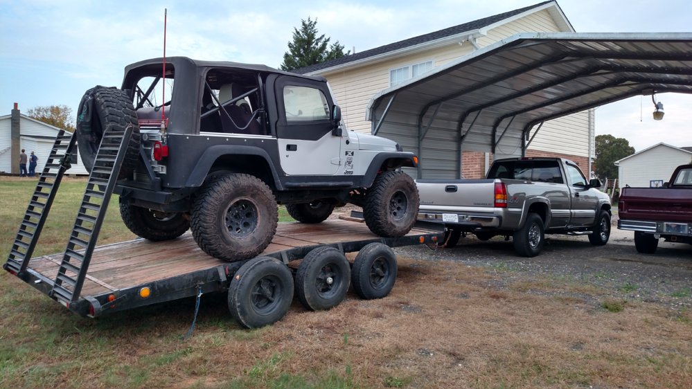

Found my truck over a month ago for just under $10k with 99k miles on it. It's a 2000 siverado 2500 6.0 iron block auto 4x4. There are more decent cheap pickups available just got to look all over for them. I got lucky and the small lot down the road from me had this one and I jumped on it. I towed my jeep to Uwharrie soon after without issue.
