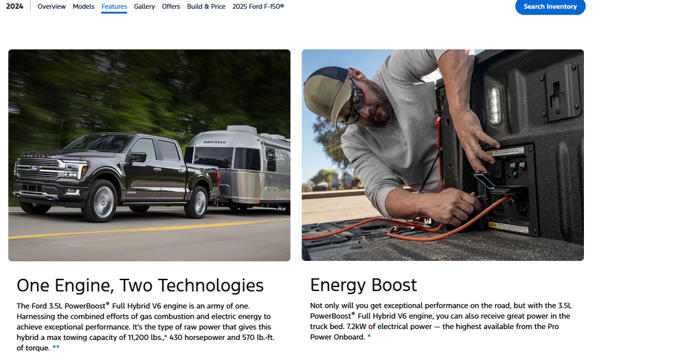

FWIW my bed outlet is rated at 7.2KW...I've charged trolling motor batteries on a fishing trip off it. Pretty sporty.

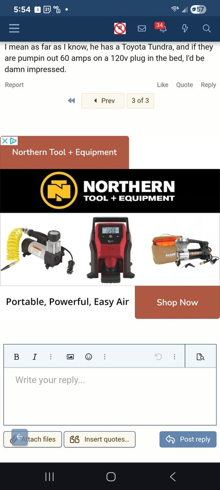

I mean as far as I know, he has a Toyota Tundra, and if they are pumpin out 60 amps on a 120v plug in the bed, I'd be damn impressed.

100 amp alternator (some stock ones are 140+) can charge a 100ah battery in 1 hour.
I highly double he’s got an outlet the strength of 2 or 3 residential circuits in his bed especially if it is factory
Yeah I dont know what a kW is guys...sorry.
4 year degree in electrical engineering, master electrician license plus an electrical contractor license in 7 states.
On top of 25+ years in the power generation and electrical field...I'm not familiar with the term kW.

It’s a hybrid, now it makes sense
