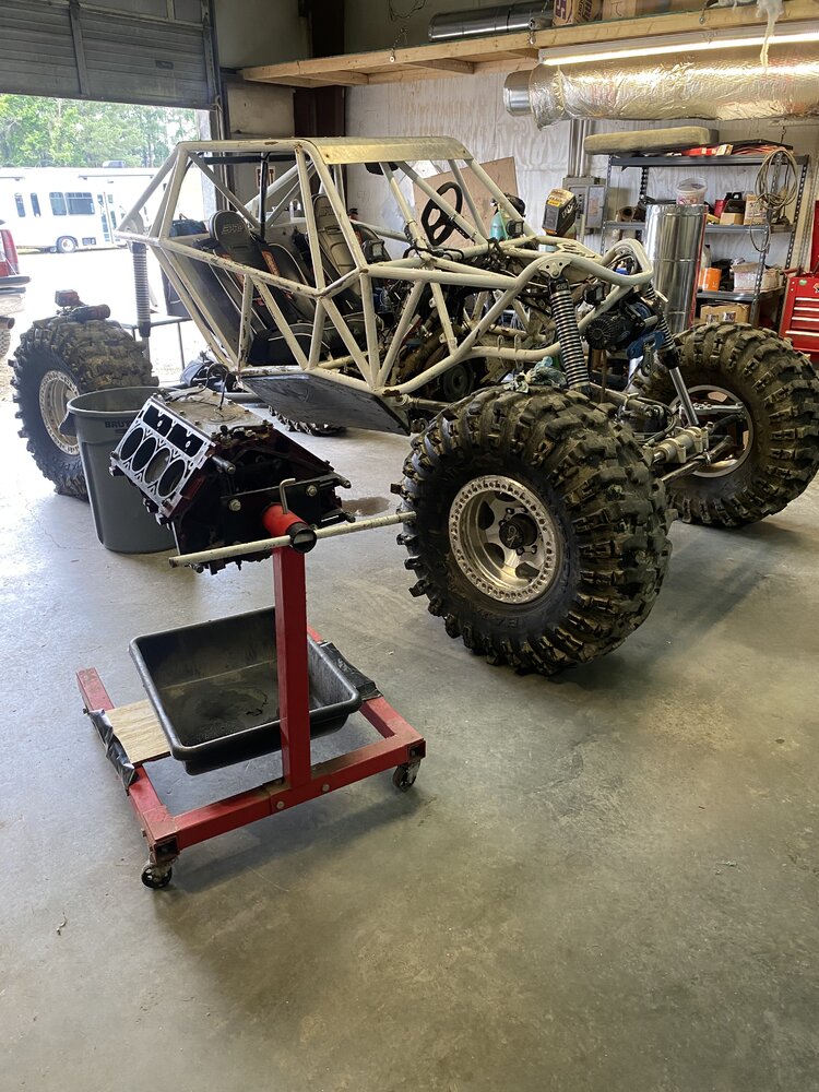

Current status.
Spun 2 rod bearings after oil psi sensor failed and spewed oil out the top of motor in Arkansas. Running low on oil killed the 2 rod bearings.
That fucking sucks. Mine did exactly that on the dyno.
Friend had the same problem at Harlan last year but since my mishap I was carrying an extra sensor and the socket and was able to change it on the trail and save his engine.
It pushed 2+ qts out when it failed on steep Arkansas climbs. Changed the sensor and refilled oil before bear wallow, but finally spun a couple in a bear wallow beat down 🤣.
