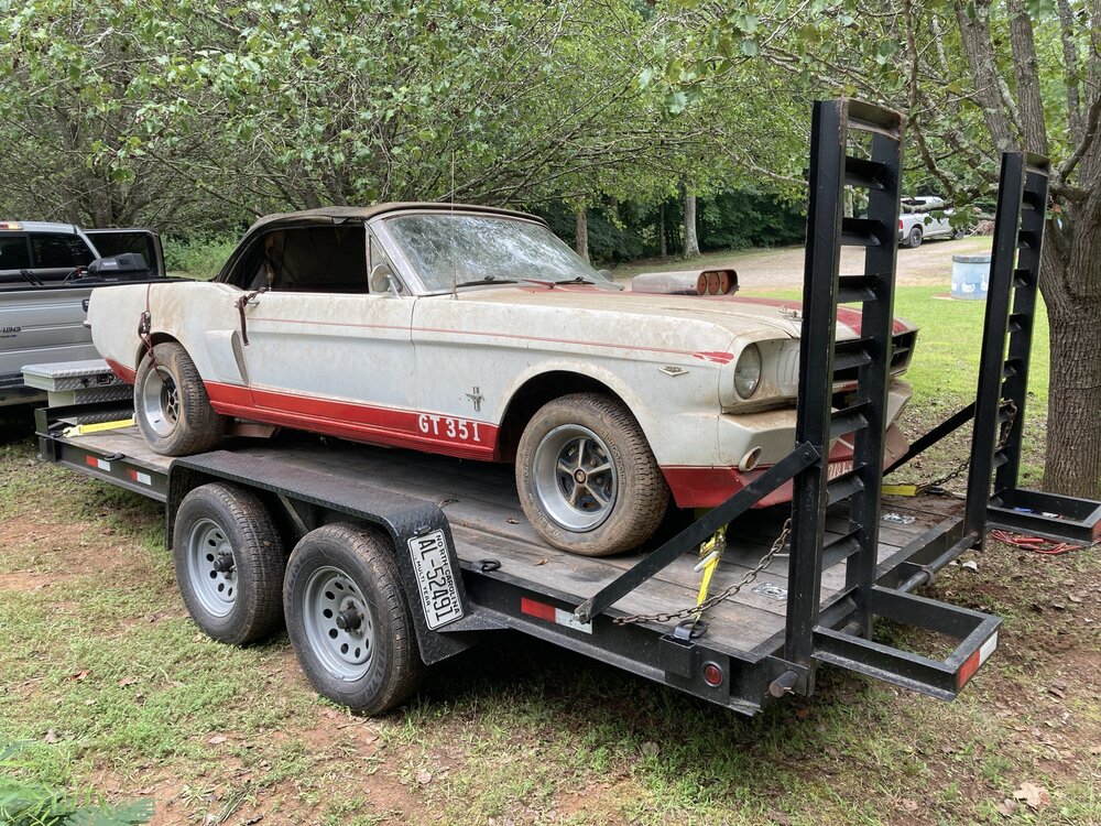

I have a 16’ equipment hauler that I rebuilt stem to stern with paint, new wiring, and white oak. I find it about the right length for my CJ7, possibly a hair short. My 65 mustang fits, but has to be backed onto the trailer to fit/balance the load.

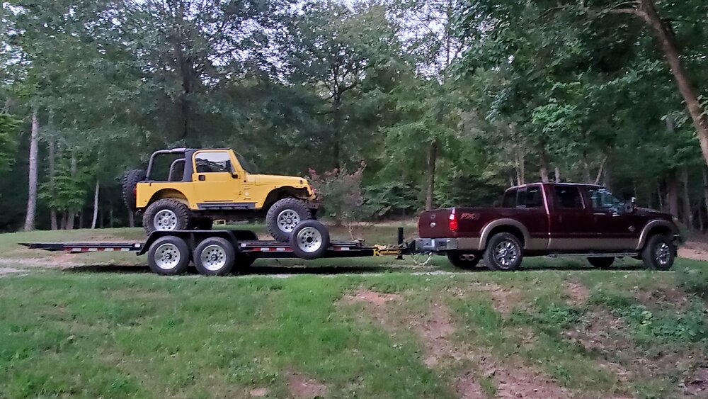

I've got an 18' deck, I like it, fits XJ and CJ5 no problem. Had to put a Silverado 1500 extended cab short bed on it twice it wasn't ideal but I made it work. Depends on what you want to haul. I wish I had 20 or 22 occasionally but 18 works 98% of the time. Also picking up a stick of DOM trailer was a bit short.
I think 20 is perfect for a single. I've generally used 16' my whole life. Bought a 20' aluminum trailer and it's was my favorite, hands down. Problem was low capacity of 6k. Now have an 18' and it's much better than the 16', but would still prefer a 20. You may be limited to an 18' with a 7k though.

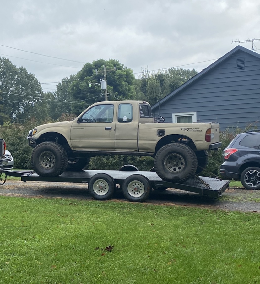

16’ and a CJ7 barely fits??? Here is my 124” wheelbase Tacoma on a 16’, I think it’s just about perfect. A little nose heavy in this pic, but only by a few inches.

Thanks guys…. I think the things that messes me up is the equipment ramps. They’re fold-up and not easily removed. Maybe that should be my first step…. The other feature is the lack of a dovetail. I may make it work since I own it and rebuilt it…

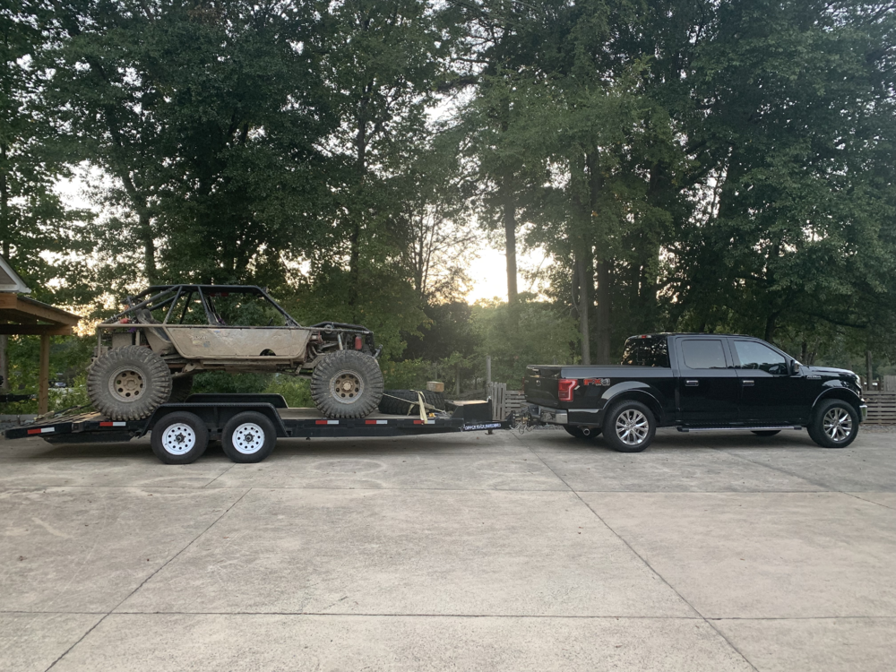

Been using a 20' 10k equipment trailer for a few years. It's a great fit for my buggy and other things I pull. With a truck bed full of gear, tools and spare parts, my 2016 F150 pulls this setup great.
I think it's always better to go up to the next capacity beyond what you think you need. In your case, from a 7k to a 10k. I got my trailer for pulling my buggy, but I end up using it for pulling other stuff around more than my buggy. I've towed my suburban with it and didn't even think twice about it before loading it. Probably would have talked myself out of doing it with a 7k car hauler, or a shorter trailer.

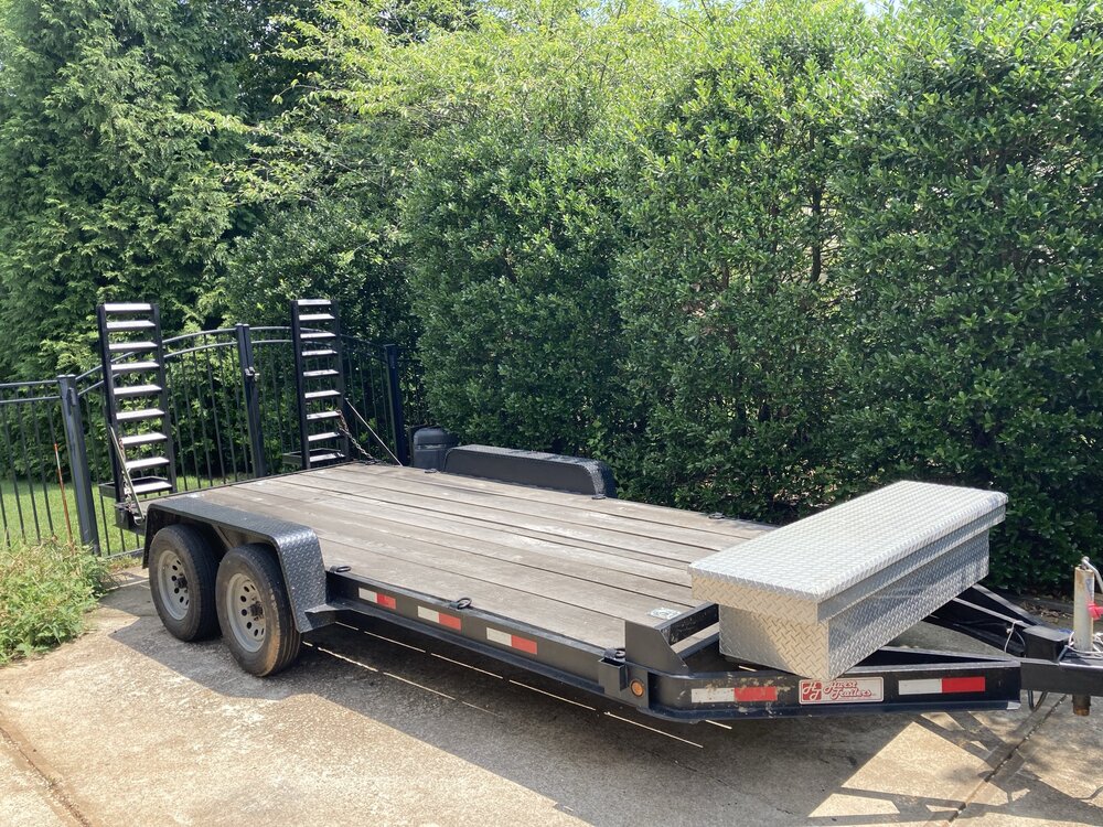

View attachment 358823View attachment 358824
Remove the ramps and add a dove to your current trailer.
Bam you got 3 more ft of usable space and less of an angle.

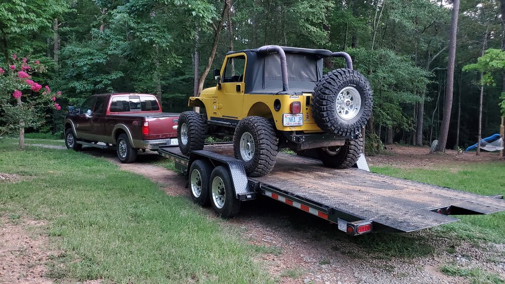

A few yeas ago I ordered my first new trailer, I figured in everything I wanted
Tongue an extra foot longer (same as my old Hudson, because I loved the space and how it handled.
Bed with extended to be as wide as fenders
Space on tongue was used to make a mounting place for my Honda EU3000 IS
Front of trailer has two full width truck tool boxes to hold tools, parts and camping stuff
9K winch on front of trailer
Mount for steps to slide into my receiver
15 gallon fuel cell
Battery box (for winch and electric pump) and space for two large coolers.
Fenders are drive over, but I added 2X's mated to and drilled to mount to inside of fender (2X on 2X12's)
Jeep drives over the top of trailer spare and spare 43SX
Went with 7K axles, (X2 for 14K capacity.
Fold up ramps for ease of use( planned on drilling more holes on my ramp connectors when up and out of use, but yet to need to. (still an option though, that, or weld additional holder studs on ramp.
It's heavy, yes, but the big block handles it just fine.
Over all deck length 20', with Dove, 22"

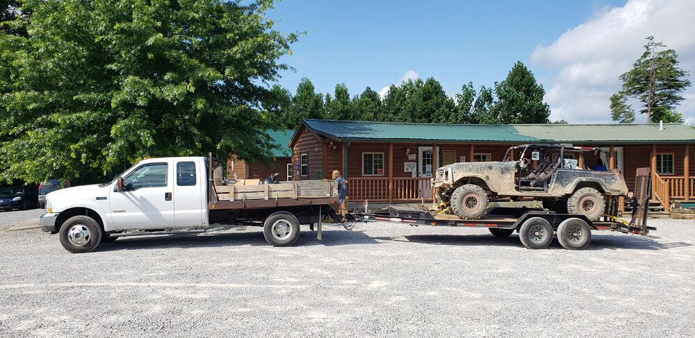

If I were to buy another bumper pull it would be 20ft, full width with drive over fenders, 14k rated. I really like the Diamond C trailers with the large tool box up front and their Max Ramps, and they showcased a hideaway winch option at a recent trailer show that looks awesome.
Duane
@Chris_Keziah has the setup I want (if he'd just come off it).
20ft (18ft flat + 2ft dove), 14k lowboy, drop down spring assisted ramps.
But for most, @Crunchy trailer would be great...basically same trailer at Chris but 10k and slide in ramps (I personally loathe slide in ramps fwiw)
Personally I now think a 20ft is too short, would much rather have a 24ft. If trailers weren't so damn expensive right now I would come off my trailer.
