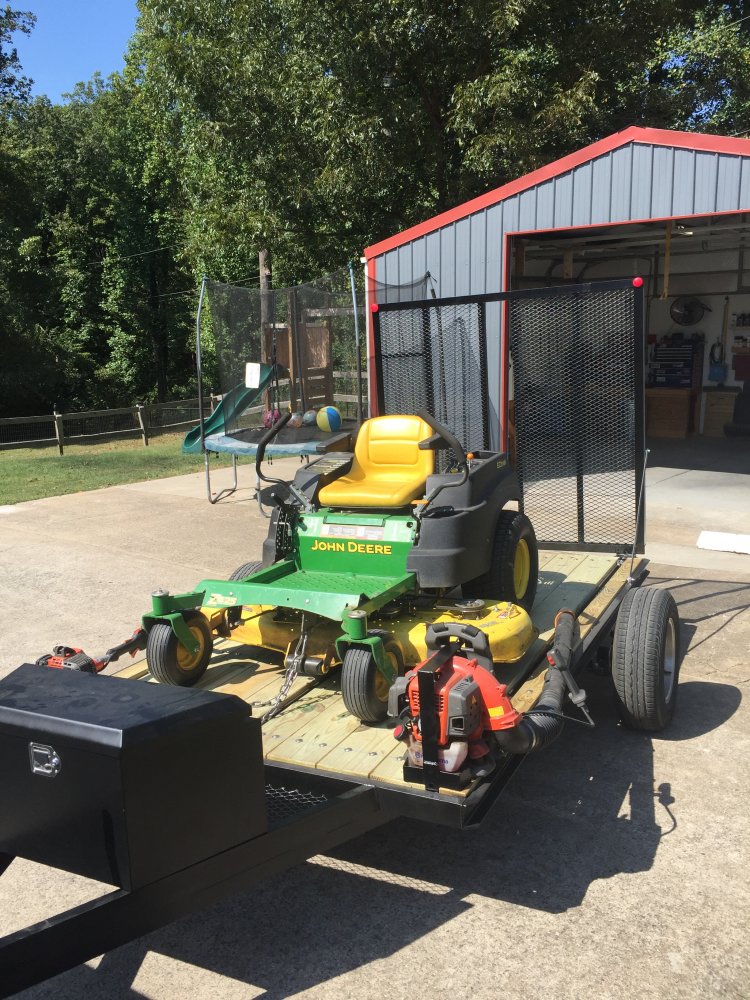

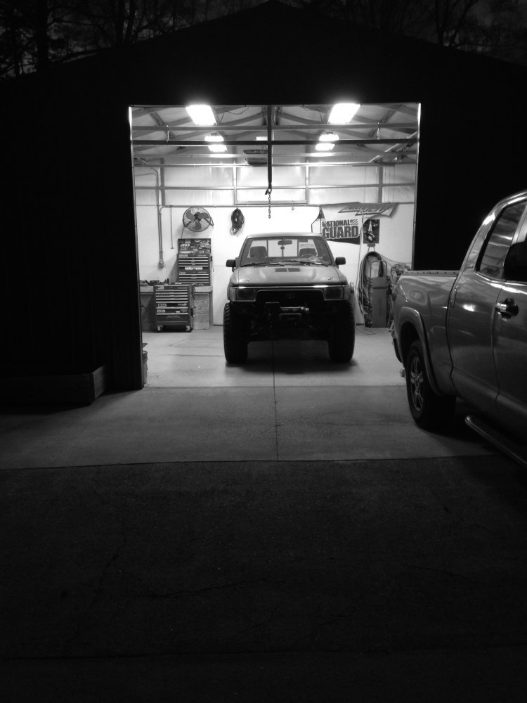

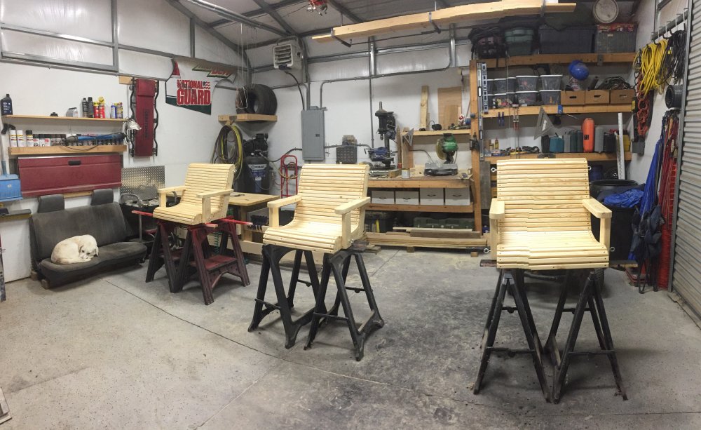

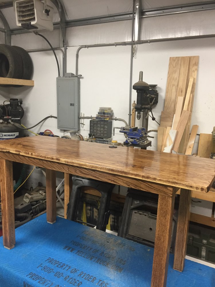

concrete anchors. I ordered mine with the rib spacing 4’ on center. I put 3/4” T&G subfloor on the walls. Predrilled and ran metal screws every 12” direct to the ribs. Zero regrets.
disregard the projects, you can see the shop/construction in the background.
