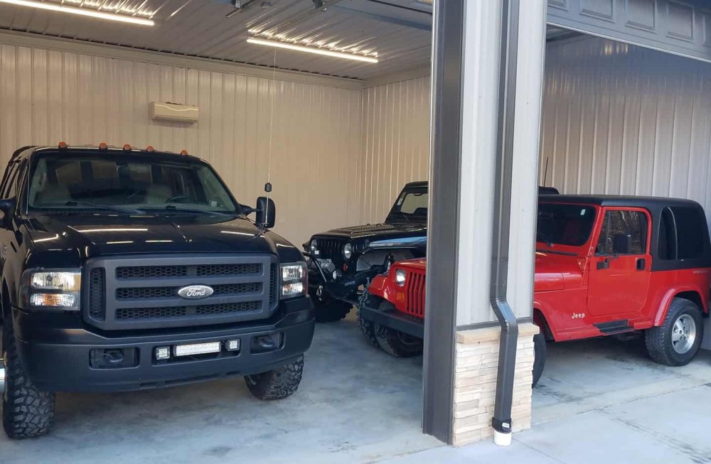

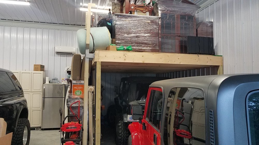

I had to build one for all of our furniture until we build the house
I'm at 30x40. The whole back of my garage is lined with 30" deep "pantry'
12x10 doors, 12ft wide bays and a man door. 14ft ceiling
It's perfect for me

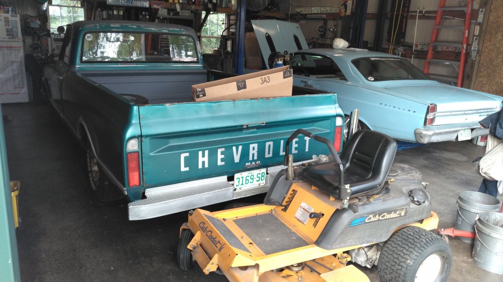

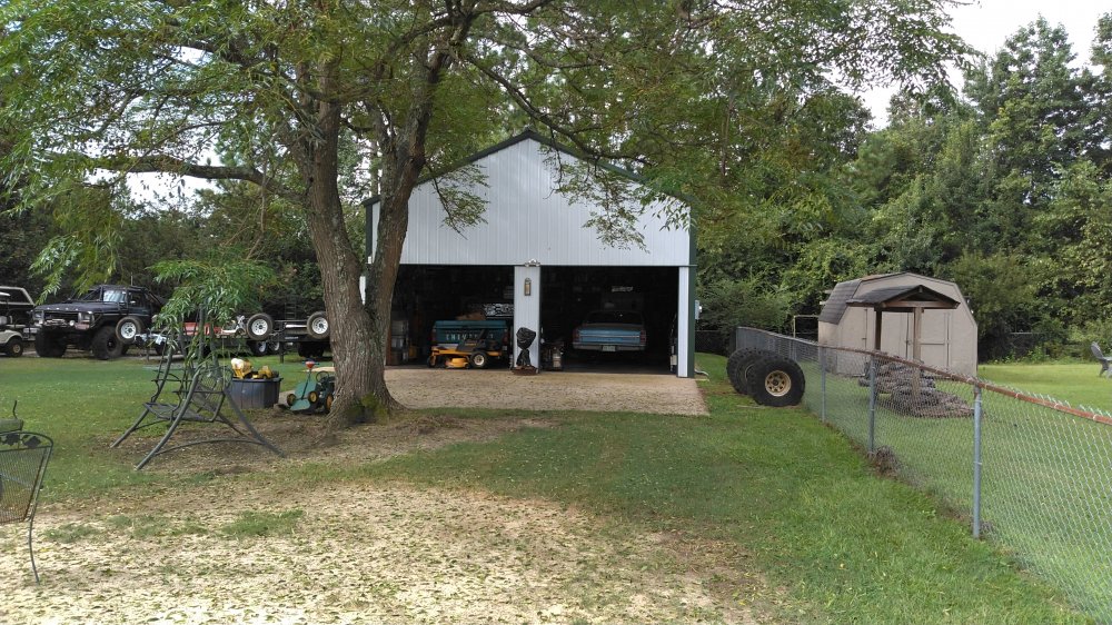

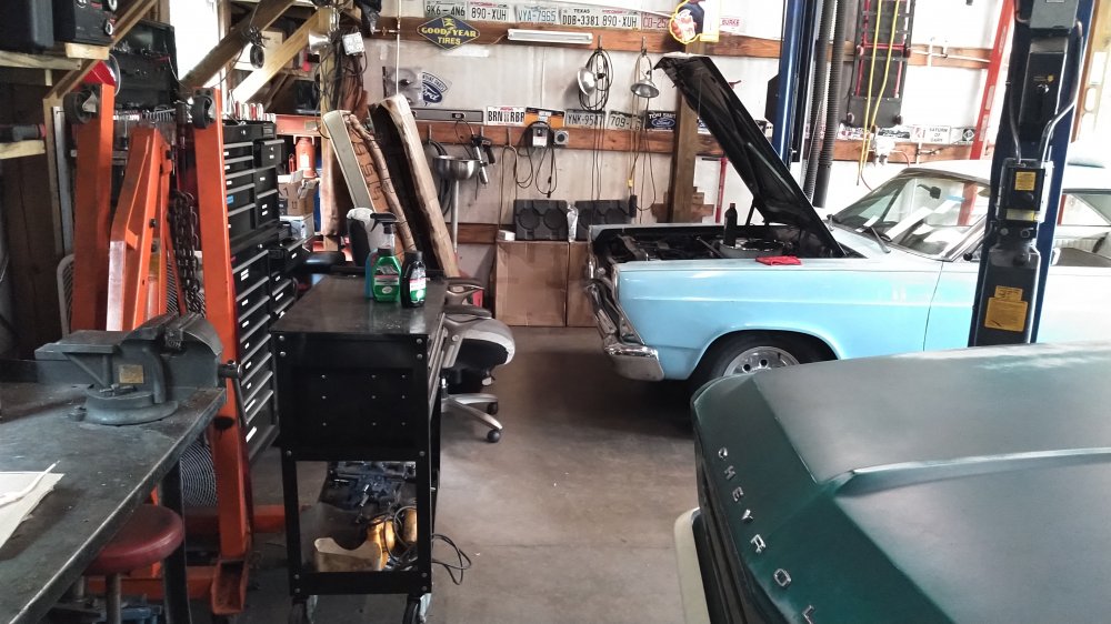

I have a 24x30 2 door. You're gonna want 30 deep at least especially if you are going to work on a long bed truck and have benches or tool boxes along the back wall. I have had an extended cab long bed 2500hd Chevy and F250 on the lift in mine and even pulled the engine on the f250, but we had to kick the lift and roll the truck all the way against the door to do it because of space. A long bed 4 door may fit but it'll be really tight. I honestly wish mine was a 30 x 30 or 32x32 (which is the biggest I can fit by zoning) I could use the extra 6 to 8 foot "half bay" for storage for things like the cherry picker, transmission jack, engine stand, parts washer and press, etc. and still have 2 full size bays to work in. Plus that would give me more room to get around the lift on one side, as it is there's only a foot of room or so between the lift post and the wall, so I have to walk all the way around a car unless its lifted enough to duck under or small enough in width to squeeze my 300lb ass between the lift and the car. That wont happen on a full size truck. You're going to need a full 12 foot to ceiling height to use a regular lift, the low clearance lifts suck and the car wont go high enough to work under if the ceiling height is less than 12'. That means either a flat sloped roof or custom trusses to put the lift in the center bay if you go with a traditional A roof unless the height thing can be waived. I have 12' to the trusses and the trusses are 6 to 8 feet above that. Mine is a pole barn style with metal skin. Ill get some pics later today once I get out there and moving about.

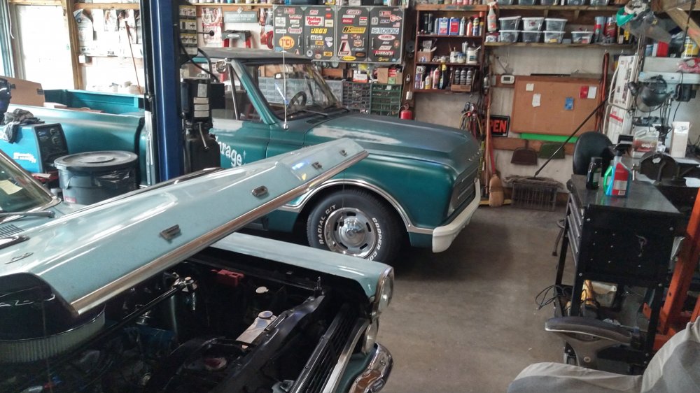

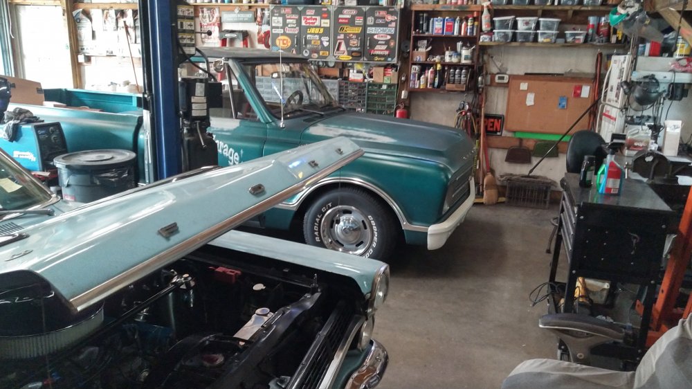

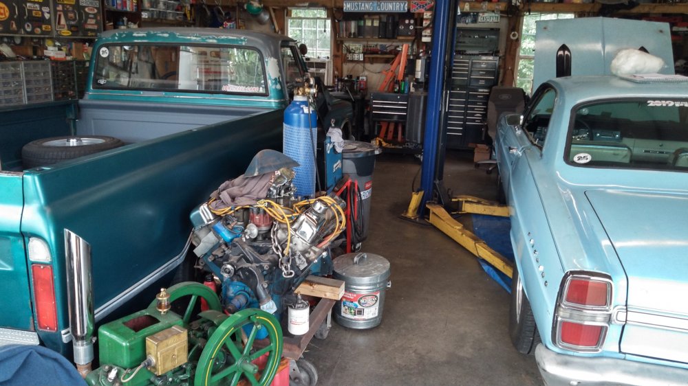

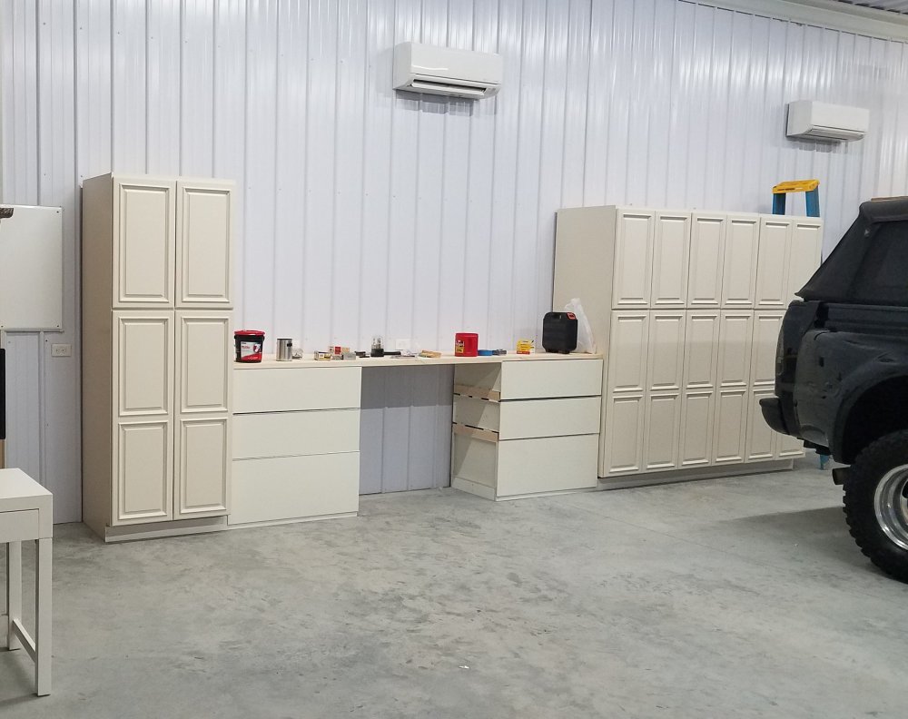

This is 24 wide, 30 deep with 10' wide x 8 foot tall doors. The workbench, toolbox press parts washer and fridge all use roughly 3 feet of the 30. If you can put them along the side wall you can get by with 28 or 27 feet deep. If I had that extra half bay that's where most of that would be here. Along with the spare engine the hit and miss engine, welder and zero turn mower which would leave more space around the vehicles.
Basically build as big as you possibly can, but you're going to want 28 to 30 deep for sure. The shop at work is 30 feet deep too.

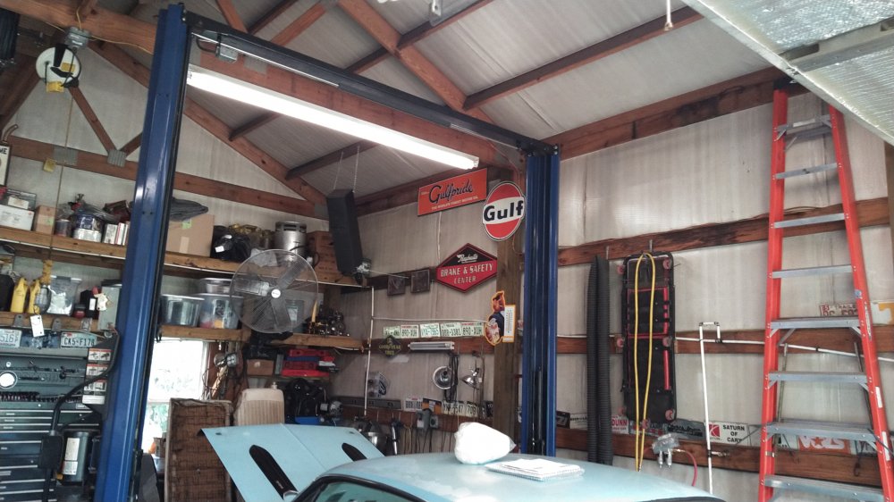

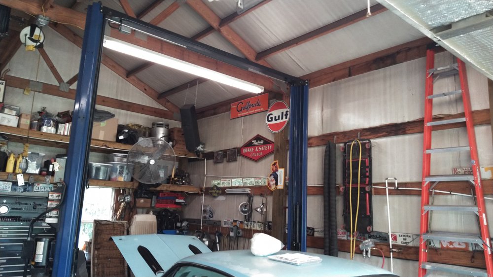

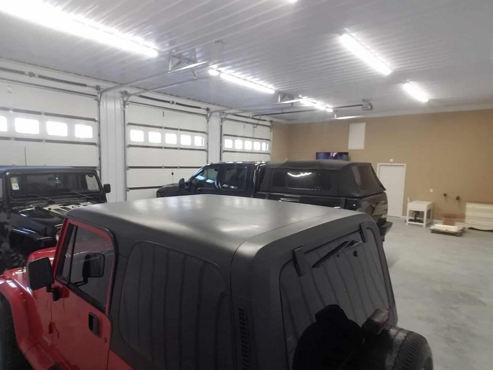

My lifts cross bar is in-between the trusses as you say, even though mine are spaced further apart. The lift would tuck inside the trusses if they were the usual 2 feet apart or so. I meant by my comment that if your total height was limited to 14 feet or so you may need a custom truss literally shaped like an A where the lift would have a higher ceiling for clearance.

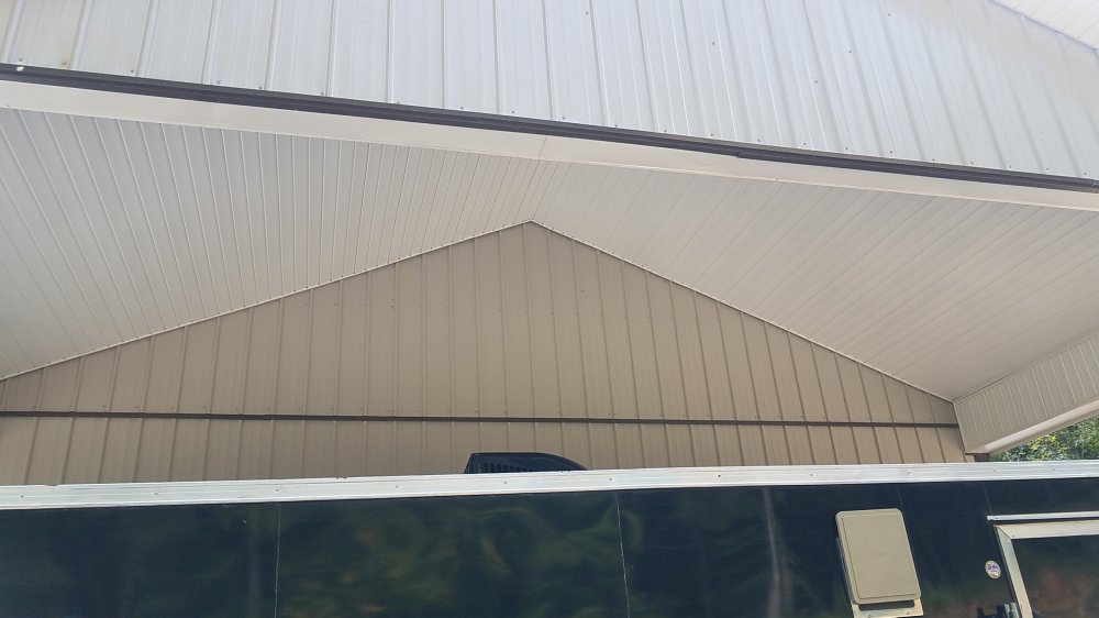

Code allows 14ft between trusses. That's what I have outside because I wasnt sure if I would put a lift out there or not. I have 21ft in the center
The thought was also to replicate this on the middle bay, but the ceiling would have cost quite a but more so I chose to just make it flat

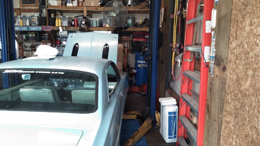

Mine is 24X40 w 40 being the depth and a 12 foot ceiling.Its just two door but that was limited by where I had the space to build.Given a better location I would have put my doors on the 40 foot side of the garage.

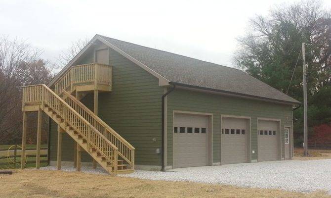

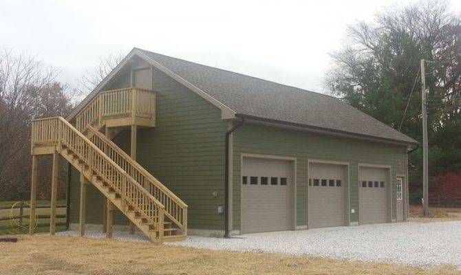

Thanks. At this moment I'm leaning towards that 27.75*36 in this kind of style, I'd love to add the stairs if it can be squeezed in. I'm sure I'll have a much lower pitch roof, 4/12 or even 3/12. Gotta measure the yard and find out what the real limit is.
