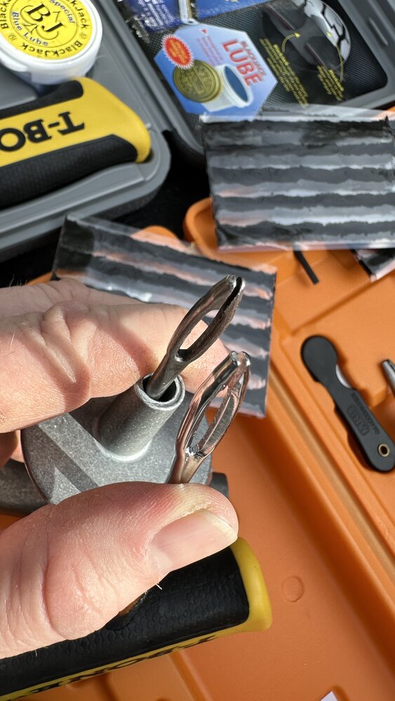

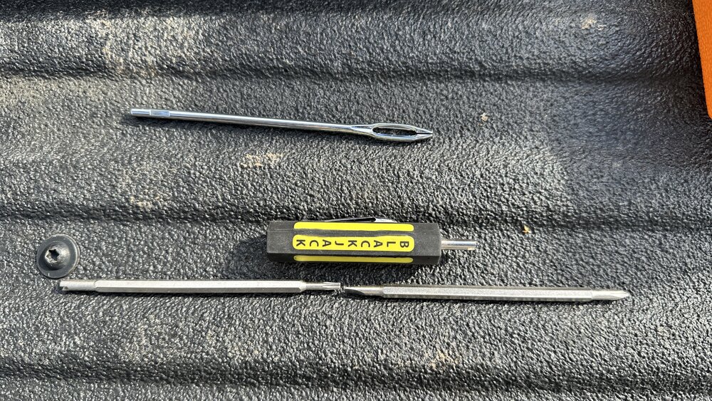

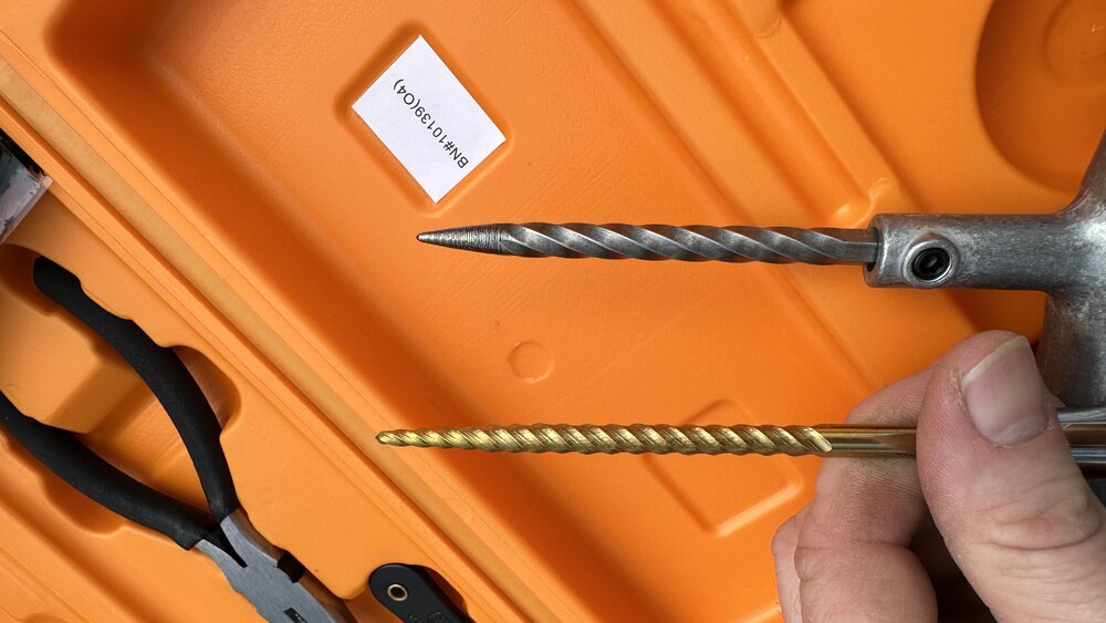

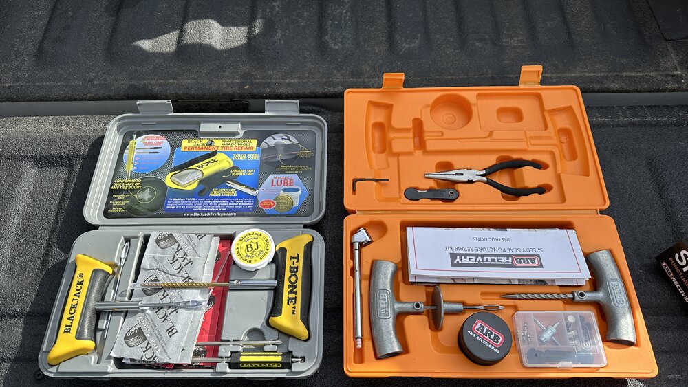

This is really the problem I am chasing. A recent puncture in my 16ply trailer tire brought this need back to the forefront. Since I was at the shop, I just hawg'd it out with a battery drill, but that's not always a realistic option, and I don't want to carry a battery drill everywhere, haha. And of course that is why I carry a spare, so I just swapped the spare and got back home without issue, but sometimes 2 tires get killed, so I'd like to have a backup.I have the same kit and love it. I run the 14 ply "g" rated tires though and have to bring a drill and drill bit. No matter what brand I cannot get through the tire with the reamer. Great kit though.

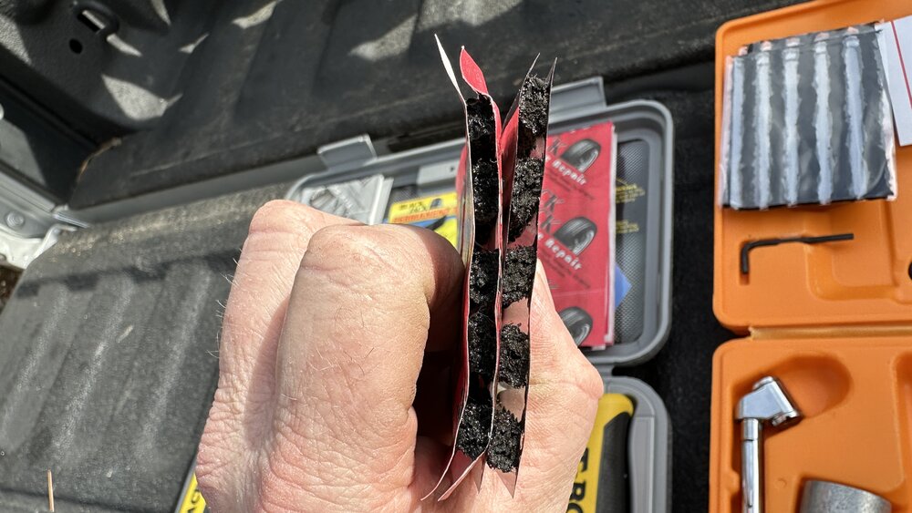

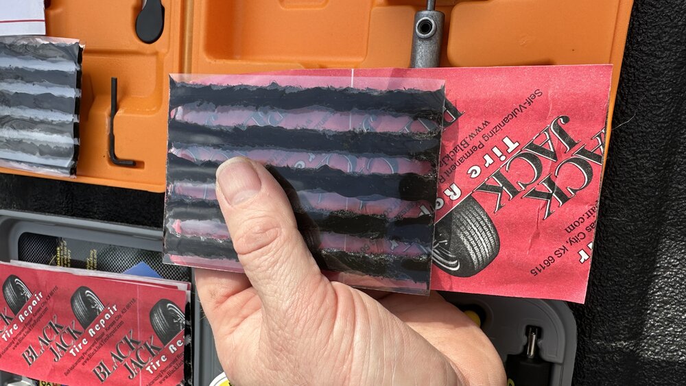

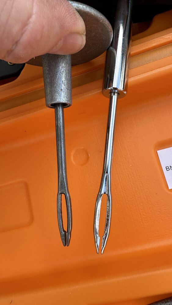

Had to bust it out again today. Kid ran over something that poked a nice clean hole.That looks like the one that I've had for the past.... 20 or so years. Gifted from 44 Magnum Offroad. Bent the needle one time. I like that they are replaceable and come with a replacement. couldn't begin to guess how many tires I've plugged with this kit.
Thats probably the best part of these kits ergo handles and lube. Going in dry with a cheapo model will wear you out on a 10+ ply tire.Inserting the plug was honestly the easiest one I have ever done. I’ve never had lube for it before, so I’m sure that helped.
Opens up the smallest of holes and lets the plug slide right in.
Bought one of these many years ago at a yard sale .... only 1 plug missing. Its still going strong!![]()
