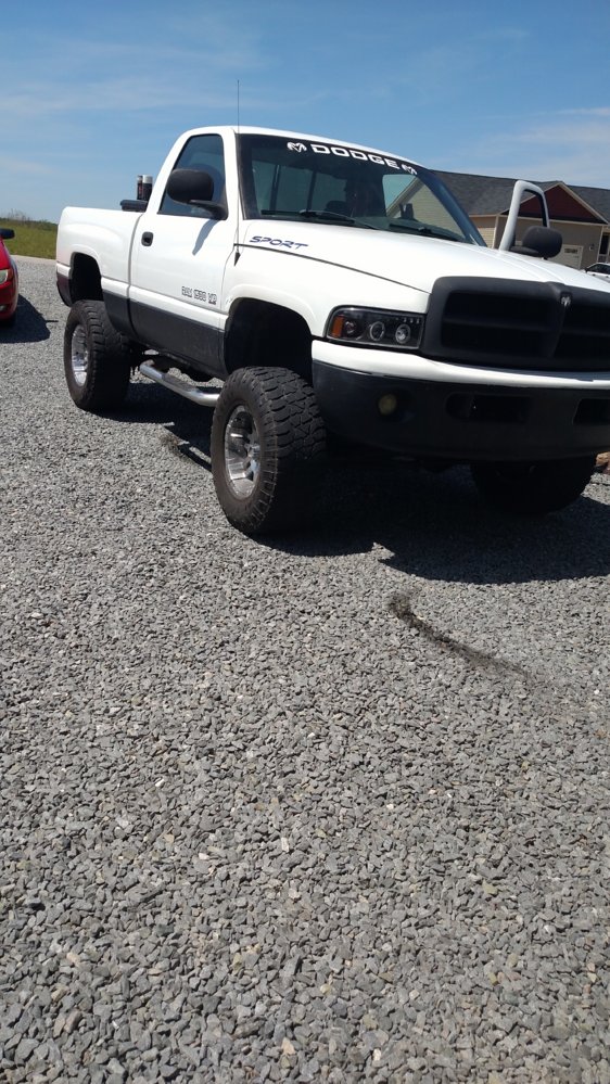

I recently bought this very neglected pile from a very young, not so bright 19 year old. I got it for a what would normally be a steal,.......if it wasn't in such bad need of attention. It's a 2001 RAM 1500. 5.9 auto.
Unfortunately he had decided that the grill needed to be spray painted flat black and the rockers and bumpers should be covered in cheap rattle can bed liner. He had also decided that "upgrading" the headlights and "paint" were far more important than fixing any of the many mechanical issues.

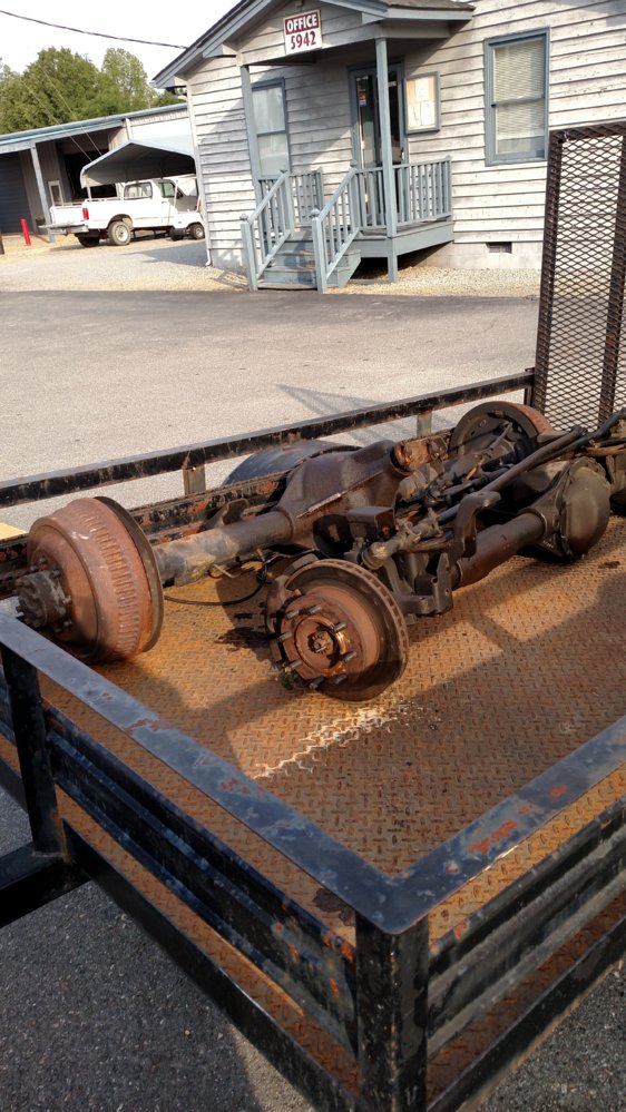

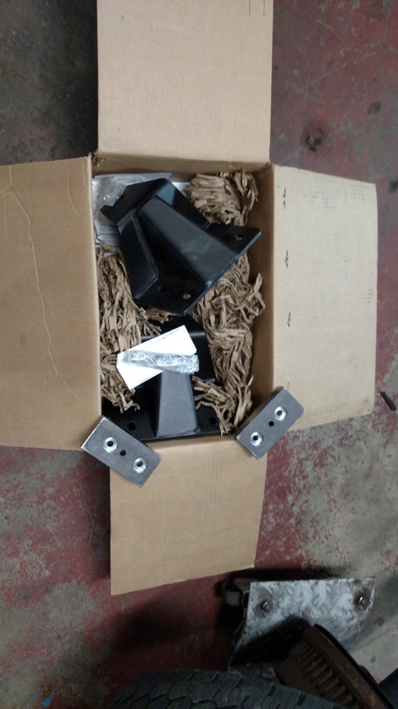

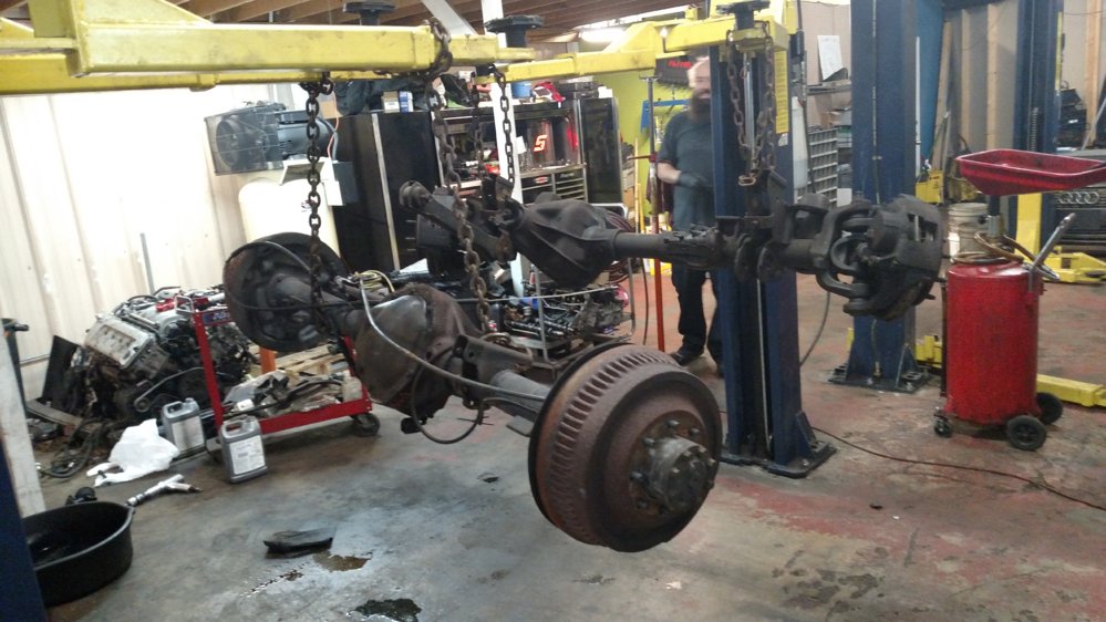

So I did what any person should on this situation..... I bought a Dana 60 for the front and a 70 for the rear. Got a great package deal on a set from a blown motor 2500 truck!
I ordered a rear shackle flip, and u bolt flip kit, some zero rates.

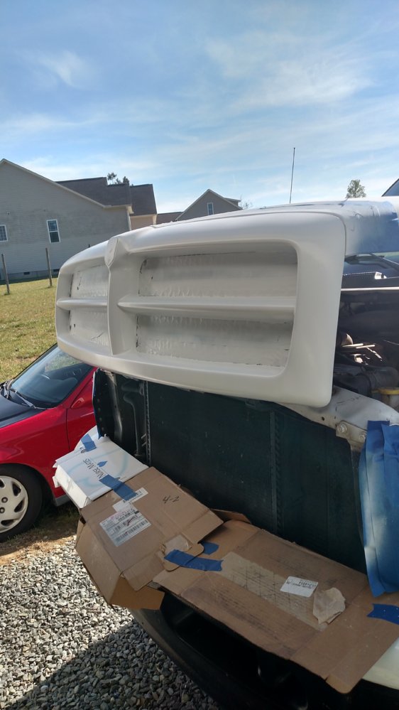

I repainted the grill!!!!!

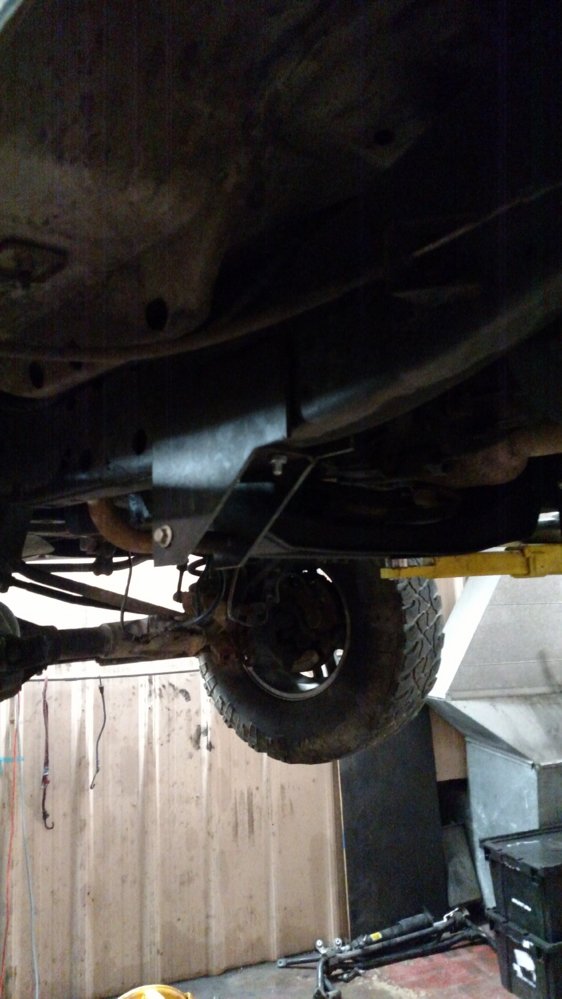

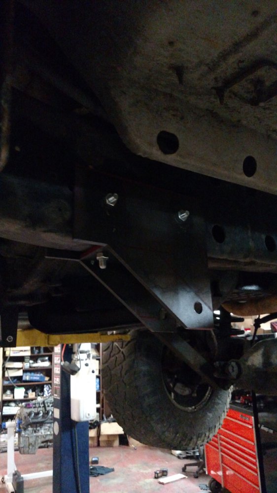

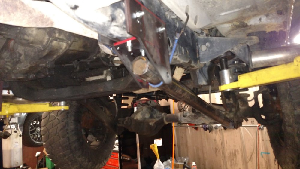

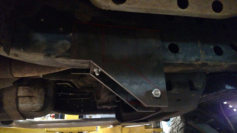

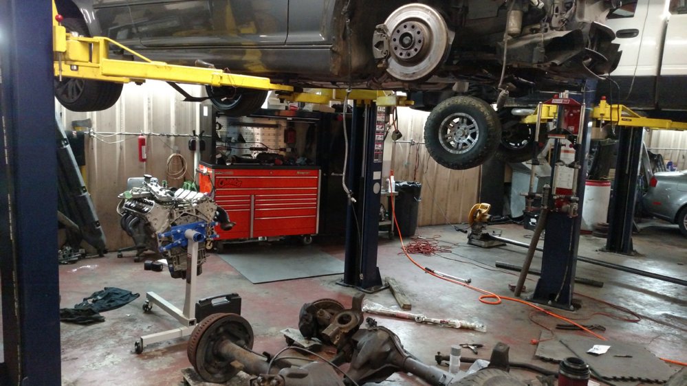

I did decide to build my own long arm setup, I took some measurements and had my buddy with a Cad plasma cutting table blast some frame brackets for me..... It's all about who you know! Lol

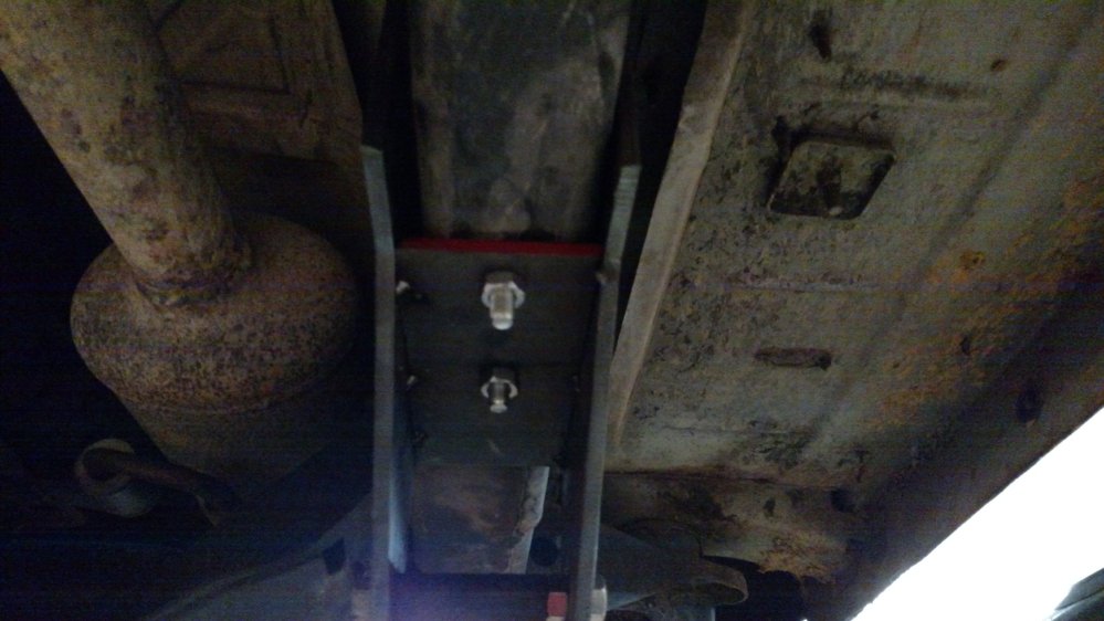

I used some existing holes to line things up. Gonna box in the frame hopefully tomorrow.
Here's what I got so far.
The truck already has a set of aftermarket upper and lower control arms on it. I'm going to take the bushings out of the short arms and use them in the long arms I fab up. ( because I'm a cheap bastard)
I've never done this before, let's see how bad I can F this up.

More pics from today. Got a few free minutes in.
