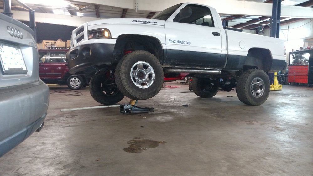

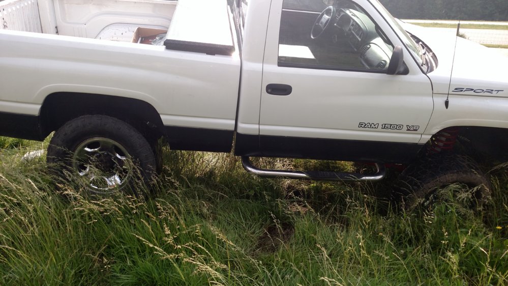

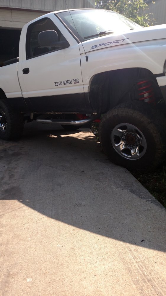

have you cycled the suspension? I cant tell from the picture but I believe there needs to be a bushing at one of the axle mounts to keep it from binding too much?
Jacked up each corner with my floor jack as far as it would go up, everything moved smoothly.
If you are talking about where the lower control arm bolts to the axle then yes there is a urethane bushing on that end and the Johnny joint at the rear.
Once. Get the breaks blead I will pull it onto the arm of the lift and try to make it flex more.
if there is a bushing at the axle end of the lower, I think you will be fine. As the suspension flexes, it is trying to twist the axle. You must have something in there that allows some flexibility to reduce the stress on the mounts/arms.

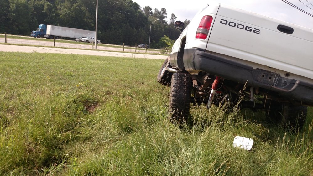

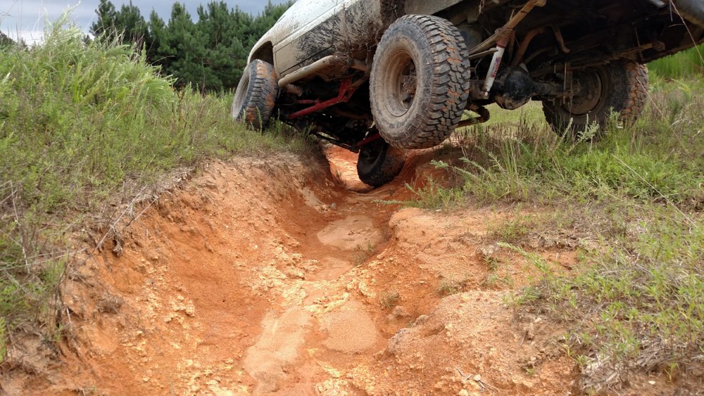

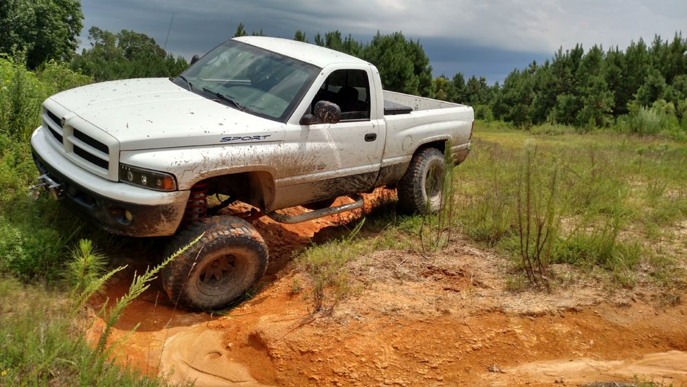

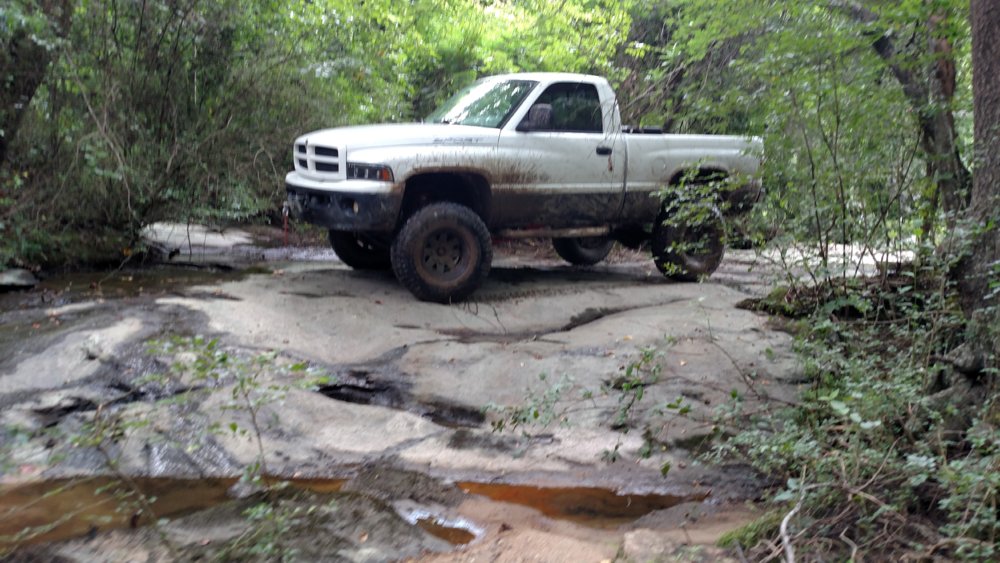

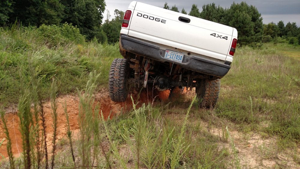

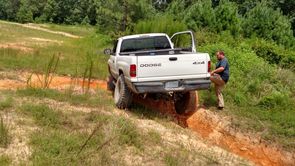

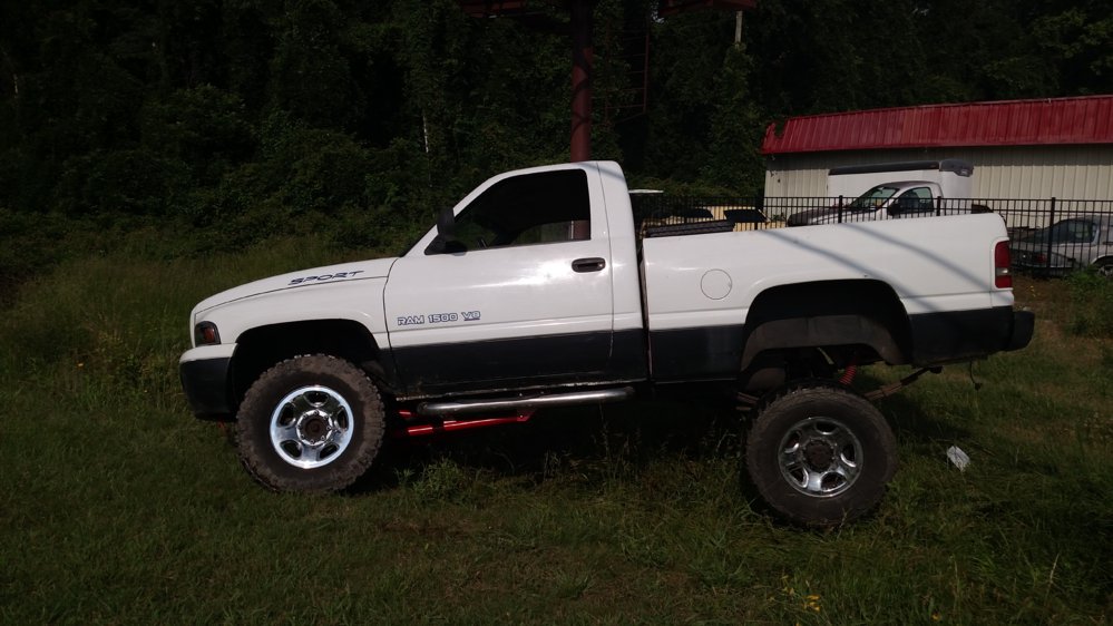

I took it out of the shop today and put it in the ditch out front of the shop. It flexed out pretty well. Still have some work to do on the steering linkage, sway bar disco's, and bigger tires.
I think my brother got some pics of me in the deep ditch, I will try to post them tomorrow.
