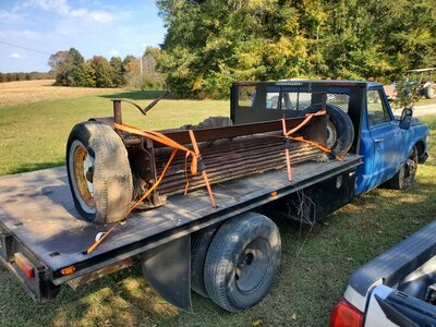

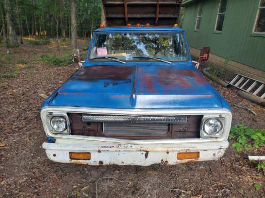

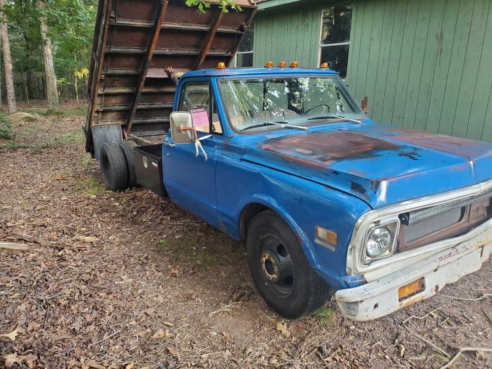

Big John: 1972 C30 2WD dually w/ 11' dump bed

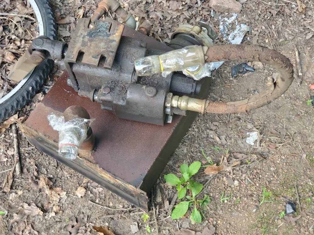

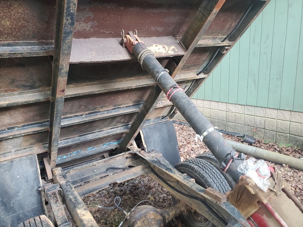

I made a hydraulic safety lock and removed the reservoir to coat the inside/paint the outside, the pump to get it sealed and I'm going to get a new line made.
Yes those are bungees and hose clamps securing it temporarily; I'm waiting on hinges & flanges...no buses full of nuns in this neck of the woods!

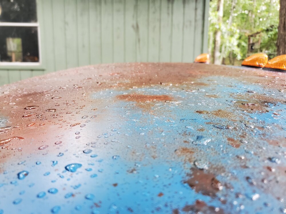

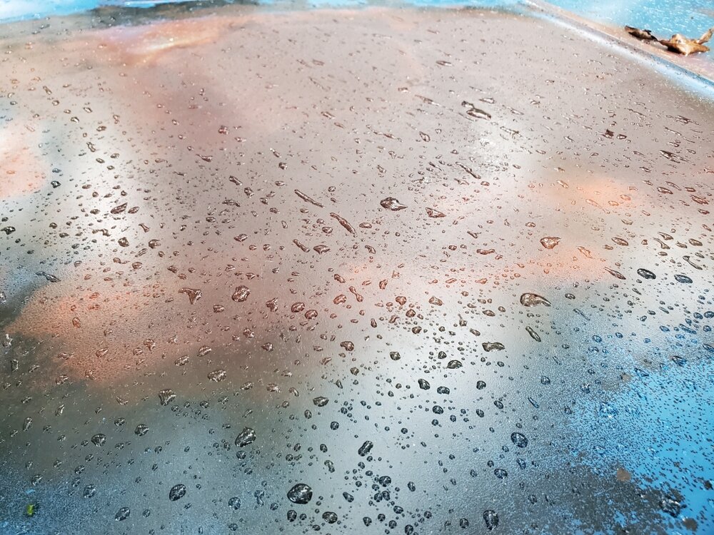

Washed it and wiped on VGG's shine juice...hopefully it looks as good in 3 months as it did after 3 hours!
First time water has bead up on this thing in probably 30+ years! And on rusty metal too!

After 12 weeks I finally lowered the bed back down on this thing! The guy I dropped the pump off with didn't do anything after 7 weeks so I picked it up and took it apart. The pump can be serviced by the original company in Kings Mountain, but without a commercial account I was SOL for a rebuild or parts. So I found a manual online and ordered new seals, O-rings and an adjustable restrictor valve (thanks to @braxton357 for confirming how to plumb that in!). I sealed the tank with POR15 since the Red Kote I had left over from sealing the fuel tank had cured in the can & primed/painted the outside. Got a new hose made, added a street 45* to keep the hose from kinking, put in breathers on the tank & ram and put in a clear hose from the tank to the pump as a cheap sight glass. Put it all back together with some padding between the tank & frame, filled it up with hydraulic oil and cycled it a few times yesterday and again today...happy to report no leaks as of yet and I don't feel like the frame will buckle when the bed lowers! Key word there is 'lowers' & not 'drops'!

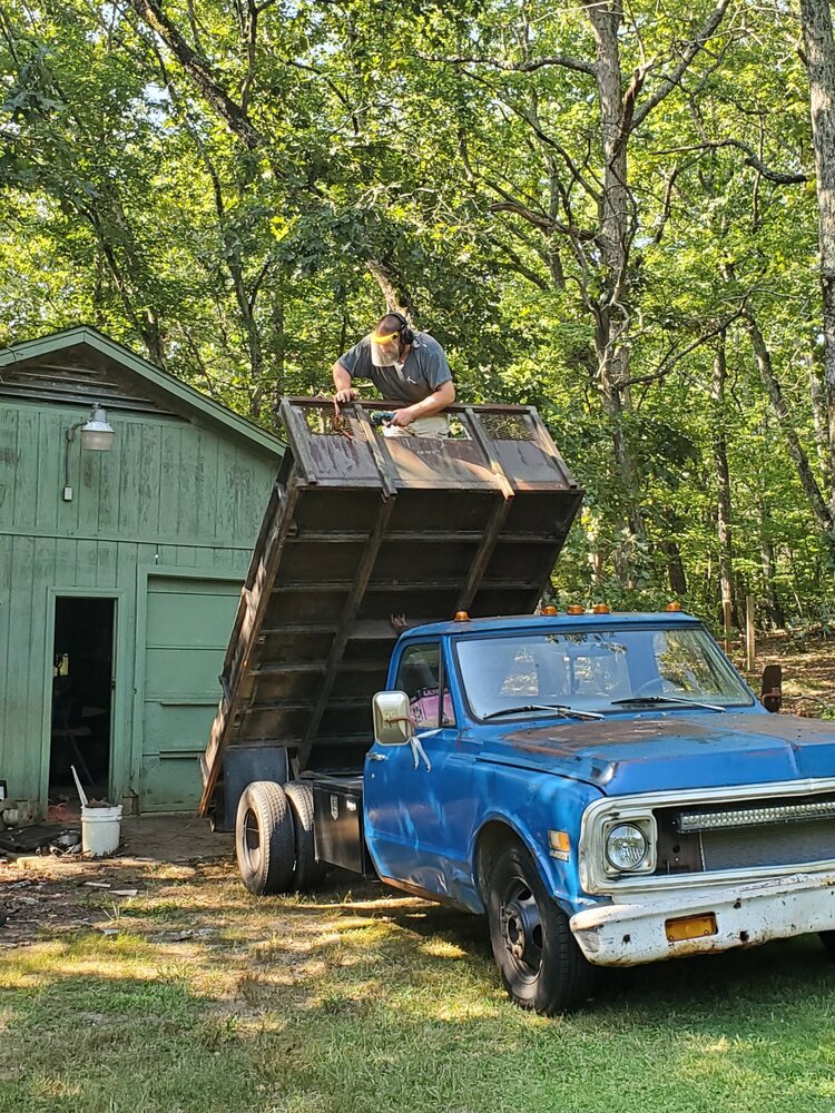

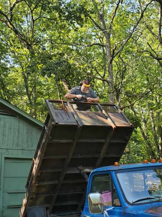

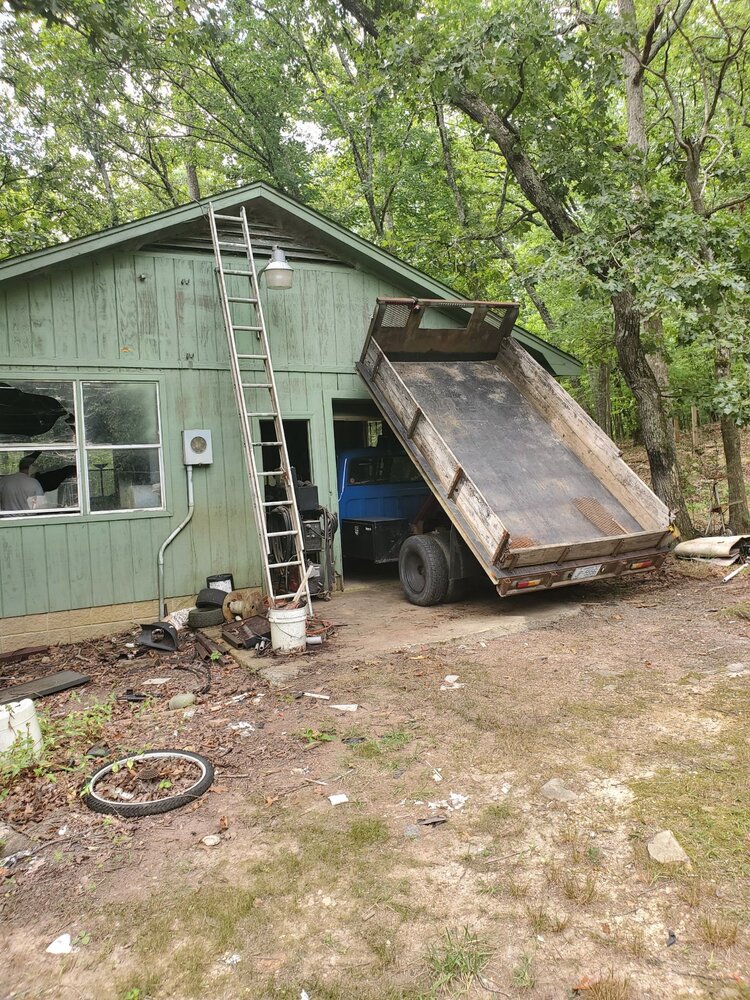

Safety PSA - if you're ever determined enough to cut a hole in the headboard while the bed is raised so the rearview mirror is actually useful...chock the step ladder! The first time it slipped 3" and I didn't do anything...10 minutes later it slipped 2' and I'm just glad I had my elbow over the frame to catch myself!
When welding in new expanded metal & braces to the freshly cut hole you get as close to the welder as possible.

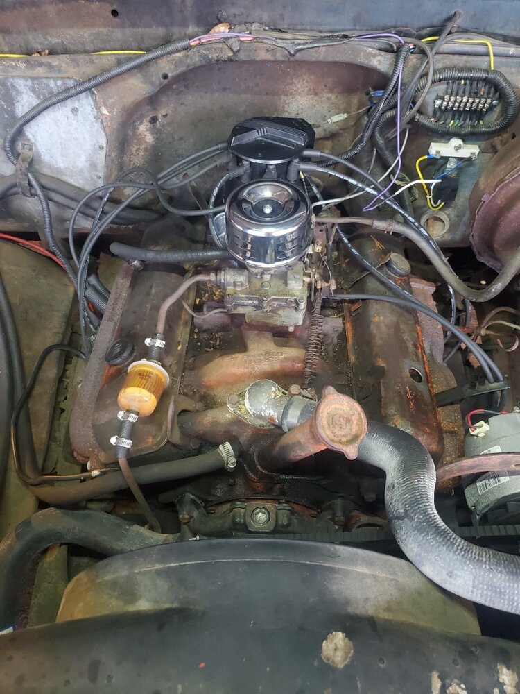

Well I still don't understand why the points set-up wasn't working, but I installed the HEI dizzy & plug wires and got spark immediately! It still didn't fire, but that was because someone :)shaking:) wired the plugs 180* out. Got that fixed and quickly got the timing to ~14* BTDC and shut it down again. Down side is the old air cleaner will not fit with the new dizzy and I think the oil has a lot of fuel in it from cranking it without spark for the last 2 months while troubleshooting. Going to change the oil, verify the timing, wire in the tach and then get a new air cleaner for it.
On the bright side, I've got a bad points style distributor, ballast resistor & bypass relay and 2 sets of points, condensers & coils to misplace in case I ever work on another sbc!
Oil changed and set the initial timing at 15*BTDC and it sounds better & cranks faster than ever now!
Dad's supposed to take the load of scrap metal that he loaded up 2+ months ago off this week, I told him if it breaks down on him again he's either outlawed from going there or just not allowed to borrow the C30 ever again!
The only air cleaner I could find for the 2bbl reminds me of the whopper jr hands commercial. I've either got to paint the cover so it doesn't stand out as bad or buy/fab an offset one. The only plus side is you can get to the choke & throttle linkages a lot easier!

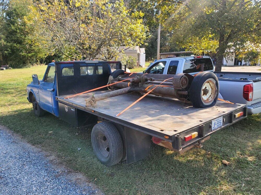

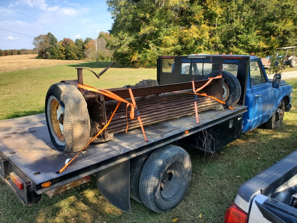

This rig has made several more trips hauling off metal & tires and I need to start bringing in some logs next year to get more use out of the water stove. Went to an estate sale over the weekend and was interested in a few grain drills and packers for food plots, but they all went for more than I was willing to go. Did win the bid on a hay crimper, so I called on the C30 to earn its keep as a farm truck again. If I can't get the crimper working it will either be yard art or loaded back on the C30 and hauled off for scrap.
