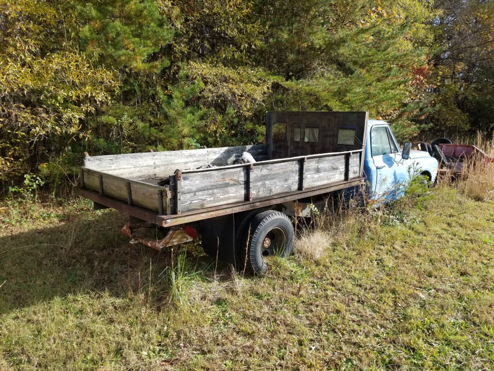

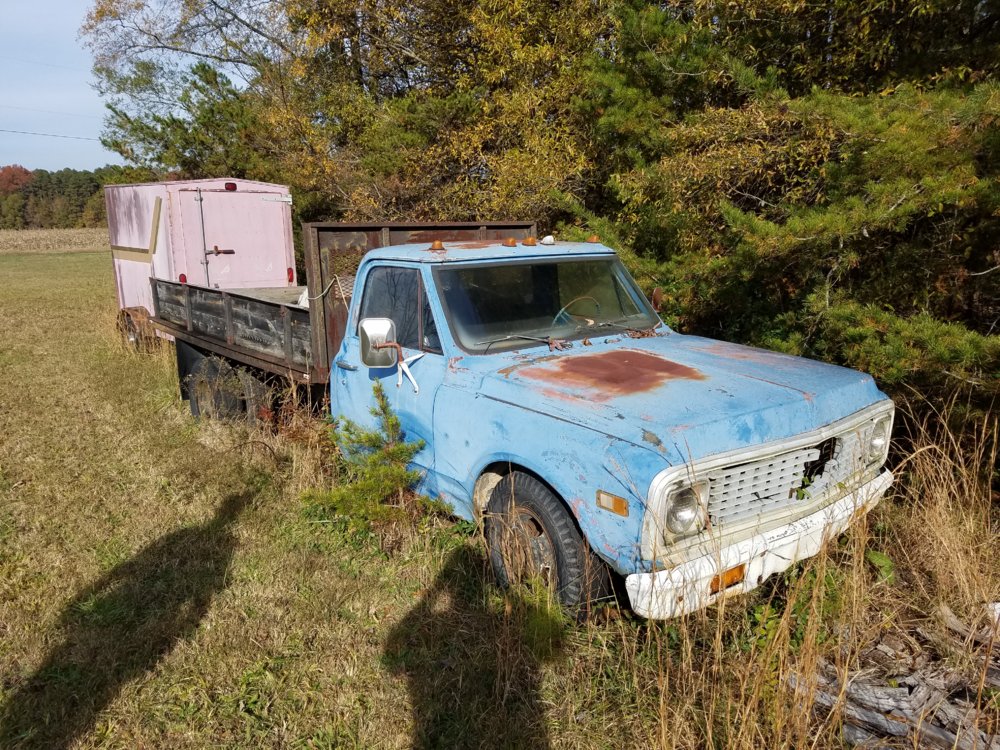

This project is named for my grandpa John, but people call him 'Big John' like the Jimmy Dean song. This will not be a restoration, but more of a freshening up to use as a farm/hunting truck.
The weekend before Thanksgiving 2018 I talked my grandpa into "selling" me his '71 C30 and I wanted somewhere to document getting it running again since it will be a slow & cheap build and I'm hoping this keeps me from forgetting things. I put "selling" in quotes because I still haven't seen the title or the keys & every time I bring it up he tells me I don't have the time, I don't know what I'm getting into & I'm making a mistake. I "bought" it for a few reasons:
*been in the family for ~30 years & only "cost" me $300
*has hydraulics that I'm hoping can raise/lower an ag drill
*give me the inspiration/motivation to work on my crawler again
Determined to be just as stubborn about it as my grandpa is, I'm going to start working on it with the hopes he caves & signs over the title. If he doesn't, at least he'll be able to use it around his place. I'd like to get it safe & reliable before getting the title & putting it on the road; after that I'll worry about doubling the fuel mileage (currently 7mpg), getting all the gauges working & updating things.

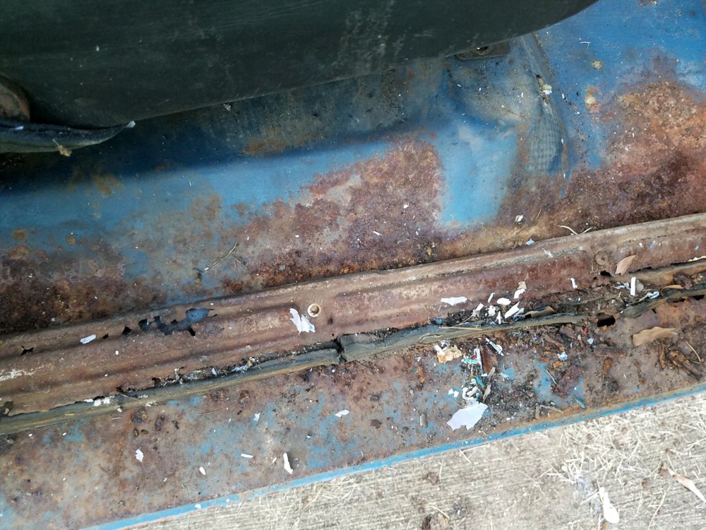

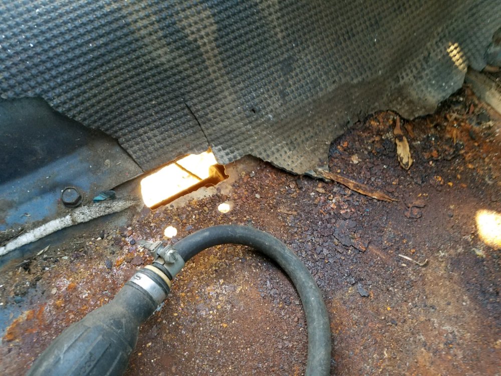

Plan is to build this thing in phases. Phase 1 is clean, disassemble & inspect. I'm not too sure on its history, but I've got to start somewhere! I've been told its got a rebuilt 4 bolt main 350 V8 with a mild cam, but the last time it ran (~9 years ago?) it didn't sound mild to me. The starter was rebuilt the last time it ran & I remember the brake lights didn't work, but when you pushed the brake pedal all 4 turn signals lit up. Its got a 4 speed manual transmission (sm465 or sm420?) that seems to go in each gear with a PTO driven hydraulic pump that operates the bed. I've also been told the rear axle is geared 5.XX:1. I know it doesn't have a battery, the stock fuel tank leaked and was replaced with a removable boat fuel tank & it looks like its been used as a trash can while my grandpa is mowing. I moved it from where its been sitting for almost a decade to tinker on it a bit during weekends since I go home to hunt anyway. First thing will be to power wash it so I can inspect everything. All the cab corners feel solid, but the rocker panels have some rust at the pinch seam, the front of the fenders are rusted & I found a small hole in the floor board. I plan on cutting out all the cancer & priming at a minimum to stop it from getting worse, but I'll be leaving the patina. All the fluids will need to be changed and the brakes rebuilt; as well as new plugs, wires, hoses & belts.
Phase 2 will be to drive it around & use it on grandpa's property until I can get the title. Phase 3 will be to change out the transmission for one with overdrive (as long as I can find one with the same PTO), add rear wet lines for ag drill connection, reupholster the seat, new weather stripping to seal up the cab/windows, change the bed up a bit, upgrade the lights, change out rear axle (better gear ratio, limited slip/lunchbox locker & disc brakes).

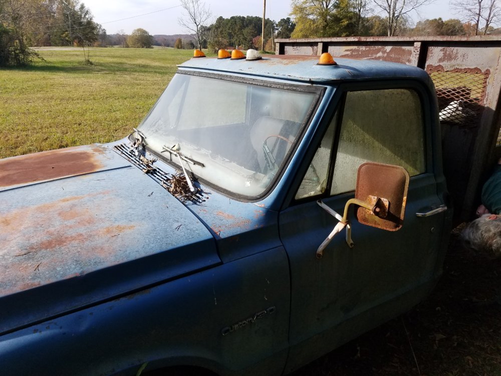

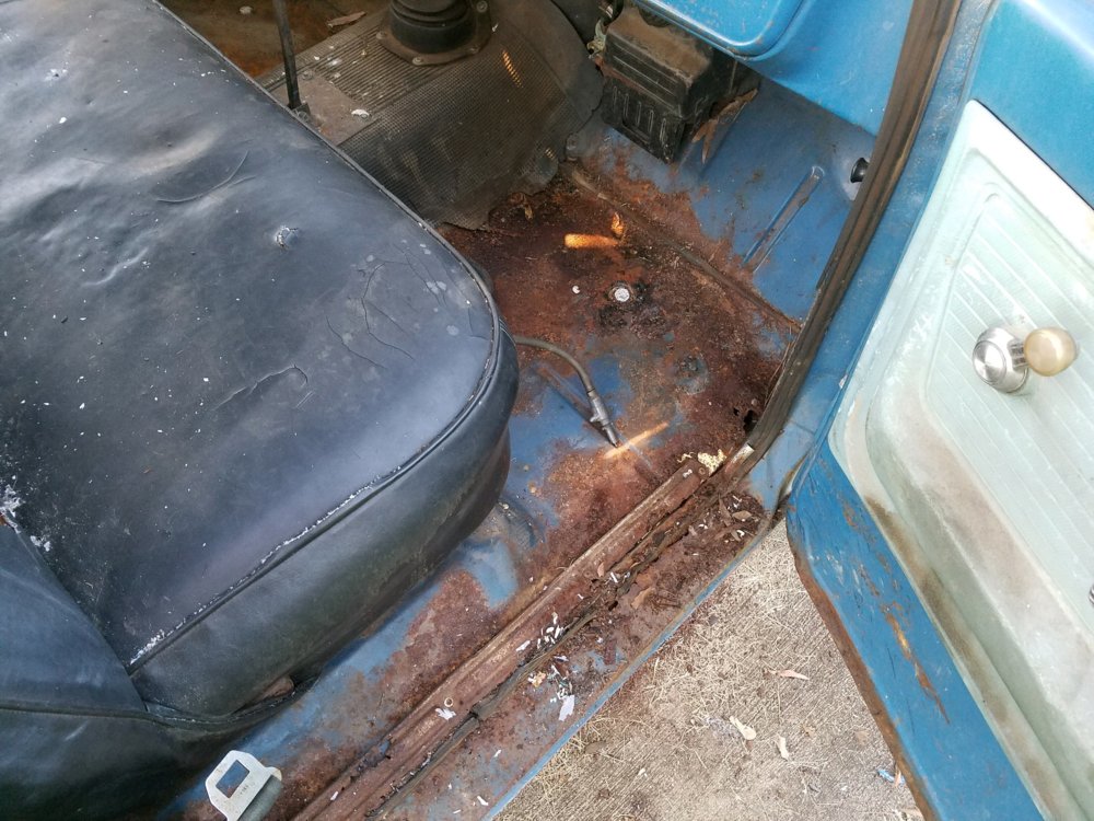

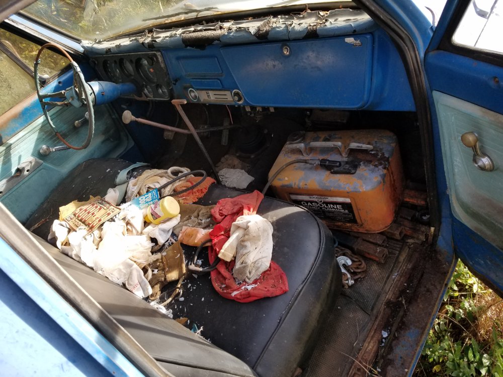

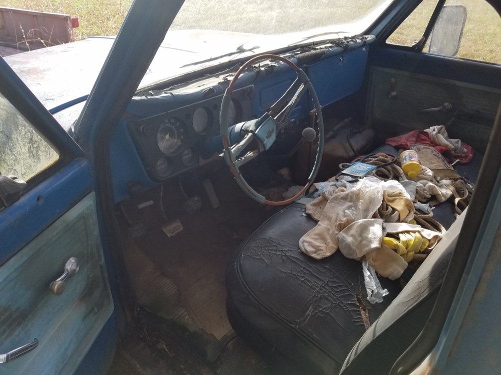

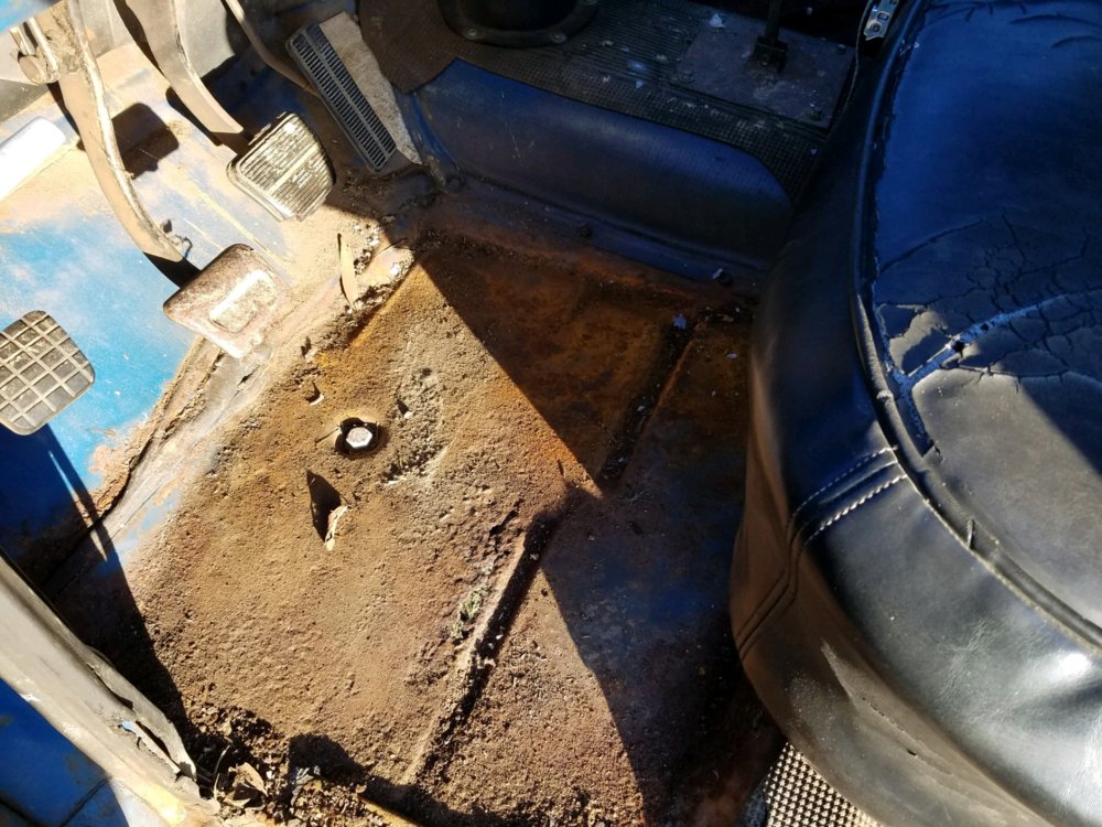

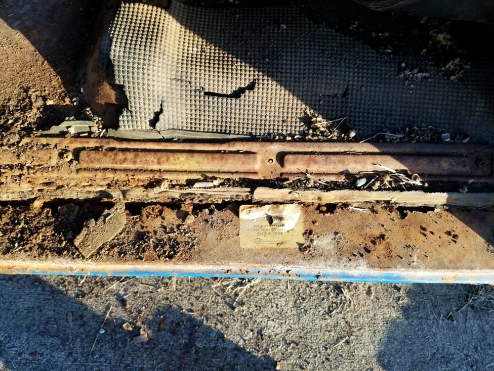

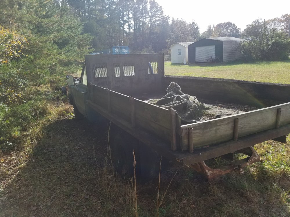

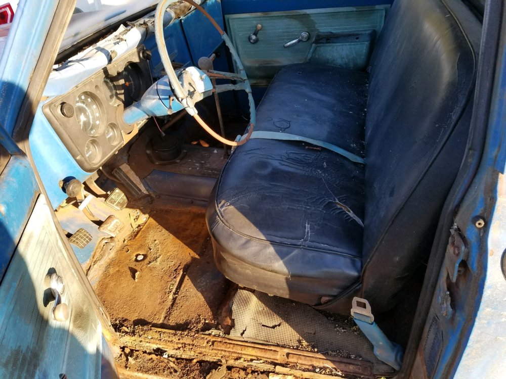

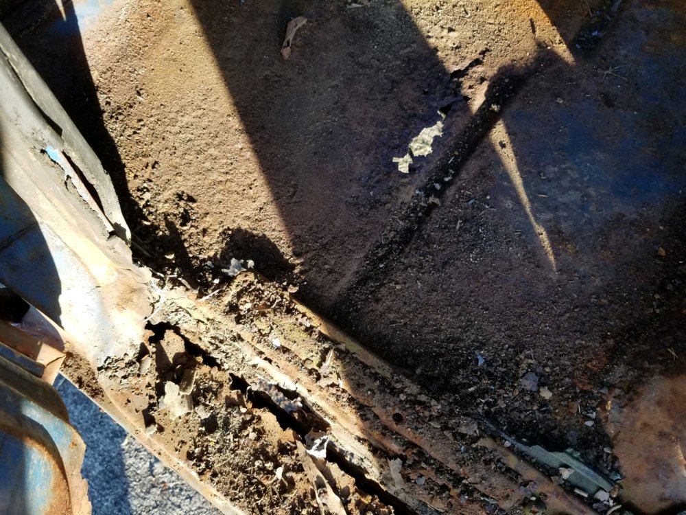

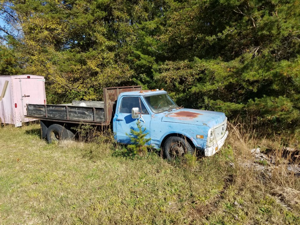

How it sat before I moved it this weekend:
20181125_141637.jpg 20181118_134513.jpg 20181125_141701.jpg 20181125_141717.jpg 20181125_141743.jpg 20181125_141806.jpg 20181125_141922.jpg 20181125_142136.jpg

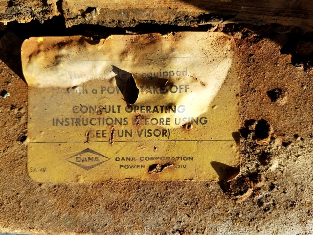

An NV4500 is about your only option for a 5 speed with OD and a PTO. Might as well do a Cummins swap too :D

Don't the NV5600/G56/ZF5/ZF6 all have PTO options too? I know the new autos do. PTO is a pretty common option, even with todays fancy trucks.
I'm not going to do anything about the transmission until I get the title, but I'll definitely look into options for when that time comes (going to keep it manual).
Yup. Dunno for sure about the ZF6, but the rest do.
Sure they do...but which one of those bolts up to or even came behind a GM motor?
Edit: There was a GM ZF6 that came behind the Duramax, but good luck finding, affording, or getting parts for one. Kinda like an NV5600.

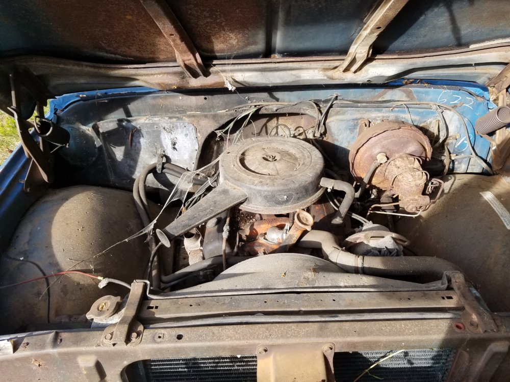

Spent some time during weekends cleaning it up & looking for the key(s)/title. Found out from prior registrations that the truck is actually a '72 model & has a camper chassis (no idea what that actually means). Also has locking ring wheels which I want to replace with a modern 8x6.5 wheel; I was hoping H1 wheels with military takeoffs would fit, but they're too tall. The chipboard glove box has been destroyed by mice/bugs, but I found 4 railroad flares from 1980 in it which I admittedly thought was dynamite at first. Flares were no good (even tossed them in a bonfire for good measure) & I haven't spent too much time on it since I bought a house in February. Also found out the fuel line burst at one point which sprayed fuel on the exhaust manifold and then caught on fire. That explains the paint damage on the passenger side of the hood & the bad wiring.
Most recent development...apparently one of my grandpa's friend's grandsons (8-10 years old?) saw the dump truck and asked about it. That prompted a phone call from my grandpa asking if I really wanted the truck. Most of which was him trying to convince me I don't need it (true) and I don't know what I'm getting into (partly true), but I finally got the point across that I want it & I think it'd be cool to own a ~50 year old truck that my grandpa got in the 80s. So I paid a visit to him this weekend, finally found the key & he signed the title over to me! Convenient thing is Brothers Trucks is having their Spring Savings sale so I put a list together of stuff to order.
Plan now is as follows:
Buy stuff on sale...30% savings FTW!
Pull the plugs, put a little oil in the cylinders & rotate by hand
~redneck compression test while the plugs are out
Hook up to a battery & turn over with starter
Check/Change fluids in the trans & rear end
~check gear ratio
Troubleshoot/repair anything that prevents it from cranking, running, driving and/or stopping
Put on new plugs, wires, belts & hoses

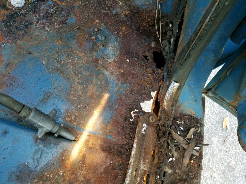

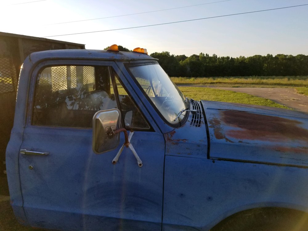

Didn't get a lot done over the weekend or Tuesday afternoon when I was in the area, but some progress was made:
A guy I know in Shelby is restoring a '67 C10 and ordered a stock replacement fuel tank before deciding to put it under the bed & ordered one of those. He's been moving the stock tank around his garage for a while & its in his way so its earmarked for me. He said he'd trade me even for grandpa's old tank that was rusted out just for the filler neck so his would look factory. Spent about 1 full day going through the hanger, barn and storage sheds before coming up empty handed. Grandpa thinks he scraped it years ago, but I thought there was a chance he hoarded it away. Also, apparently there is a different tank if you have a '67-'70 (no smog) vs a '70-'72 (w/ smog)...but for the budget friendly price of free, I'll take my chances! My buddy tried talking me into getting an under bed tank, but since this is a dump bed, there is a hydraulic cylinder in the way up front & with the way it pivots plus where the rear axle is, I think it may get crushed. I do like the idea of getting it out of the cab for venting...may coat the thing inside & out to prevent fumes.
Cleaned the windows & mirrors since that's really critical in getting the thing running, broke the plugs loose, and pulled most of the floor mat. Windows cleaned up well since you can actually see through the cab now...grandpa joked that I'd just rolled the windows down! Plugs came loose with little effort since grandpa is a firm believer in lithium grease. I couldn't unbolt the rear seat brackets without banging up my knuckles & cussing up a storm, so I'll have to go back with ratchet wrenches.
20190514_193736.jpg 20190514_193000.jpg 20190514_192958.jpg 20190514_192953.jpg 20190514_192947.jpg20190514_193024.jpg 20190514_193021.jpg 20190514_193027.jpg 20190514_193017.jpg
Also got some more info on it...he did paint it years ago with Ford Blue tractor paint when he painted his 2810, the motor rebuild consisted of a "pulling" or "power" cam (kept switching between the two), bored the cylinders (he can't remember how much) and undersized rods?, and got a lesson in operating the PTO/hydraulics. Two rules he made clear are don't get under the bed when its up without a brace (on the list to build) & don't lower it at once, but bump it since the pressure relief valve drops the bed instead of a controlled lowering. And the PTO cable is made by dana/spicer.
I told him my plans for keeping the patina & he said "I'd knock the loose rust off, prime it & paint it with tractor paint. But it's yours now so do whatever you want." So I'll be correcting any major rust spots this way & leave the patina/surface rust. Also told him I'll eventually trailer it to my house to work on it more & got "Best thing you could do is stop at a junkyard on the way and sell the damn thing!"

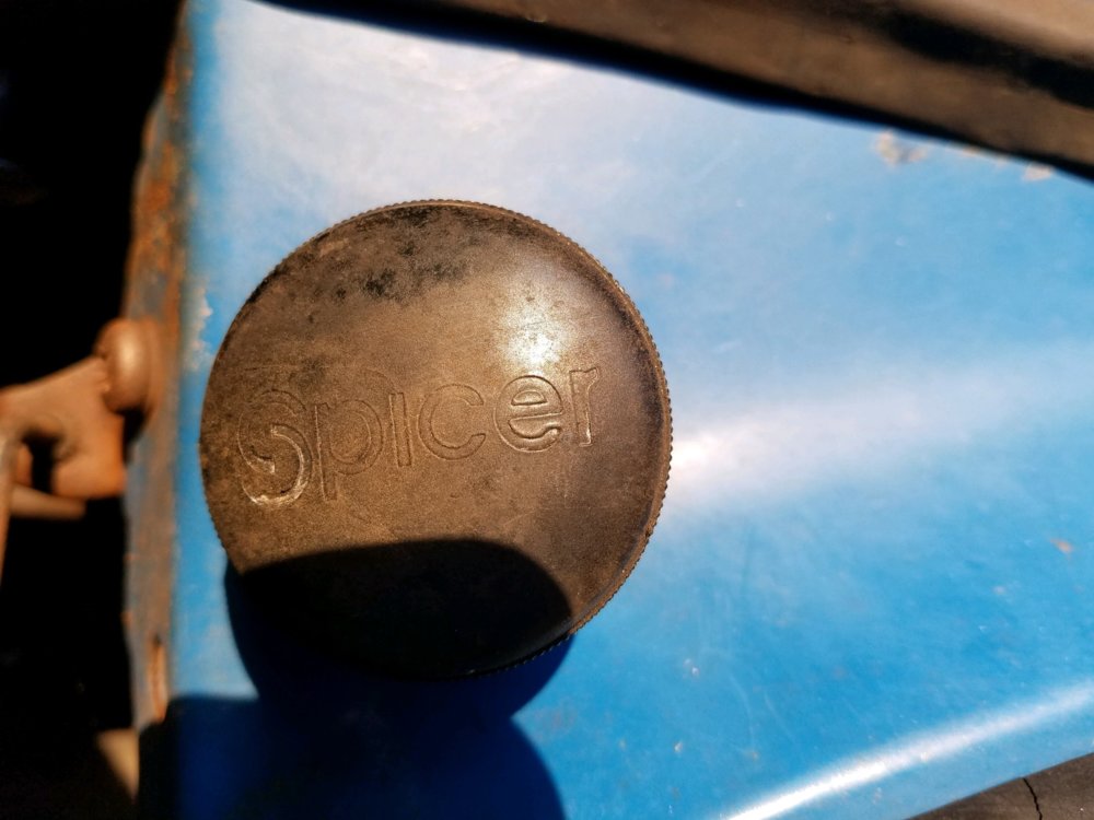

I think the rear axle is the HO72...I keep meaning to take pictures & measurements but never think about it when I'm working on it.

As said above 67-72chevytrucks.com will be your friend, although I believe I have seen an HO72/52 for sale here once or twice.
The third member / hogs head from a 3/4t (HO52) and a 1t+ (HO72) will both fit in your axle. HO72 is suppose to have a load bolt on the drivers side of the hogs head to put load against the ring gear.
