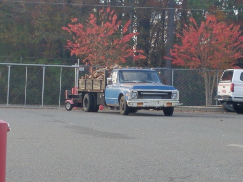

Earning the farm truck title with a bed full of split wood!

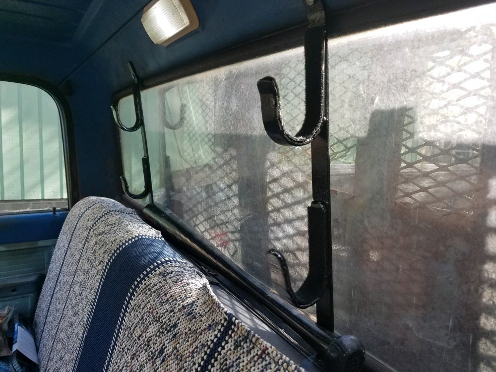

I did swap out the 2x4 for a youth baseball bat...serves triple duty as clutch de-sticker, dually tire checker & tennis ball launcher for the dogs. Also fabbed up a gun rack since I hope to be chasing longbeards next weekend!C30 gun rack.jpg

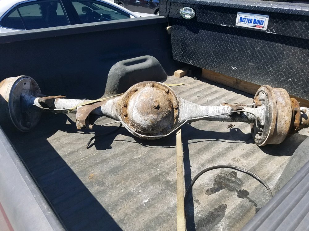

Picked up the axle @shelby27604 sent me and took it apart for the 4.10 gear, now I've just got to try and get a locker on the cheap without breaking out the welder!

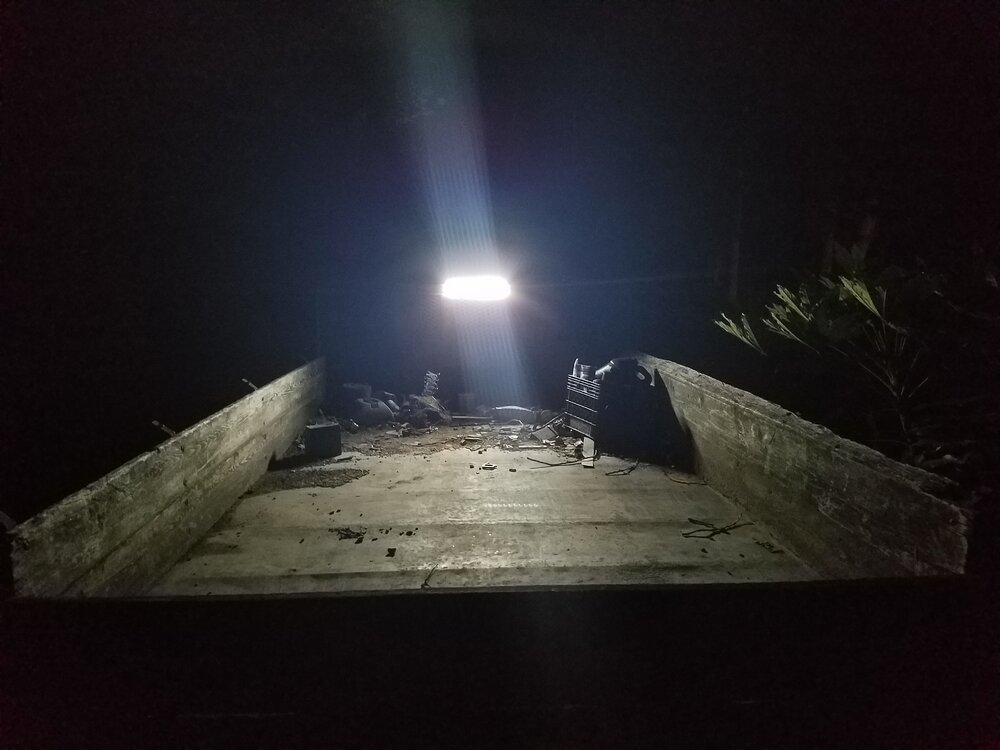

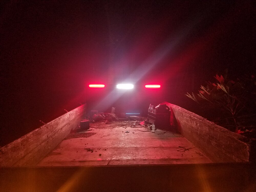

Also got the headache rack finished up...middle is cargo/courtesy light & outside are brake/turn signals. Disregard the junk in the bed...apparently nobody cleans the bed out after they borrow it!

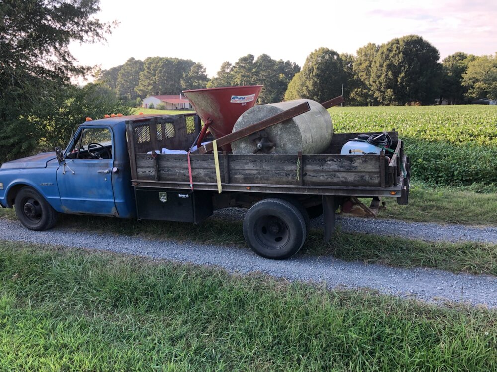

Got my F250 out of the shop....pressure plate gave up the ghost & exploded! New clutch needs to be broken in before any towing so the C30 had to step up for food plot duty to keep the farm/hunt truck status. Was able to borrow the land owner's tractor in Concord, just had to haul my spreader, roller & sprayer...first time its been out of Stanly County in 15+ years!

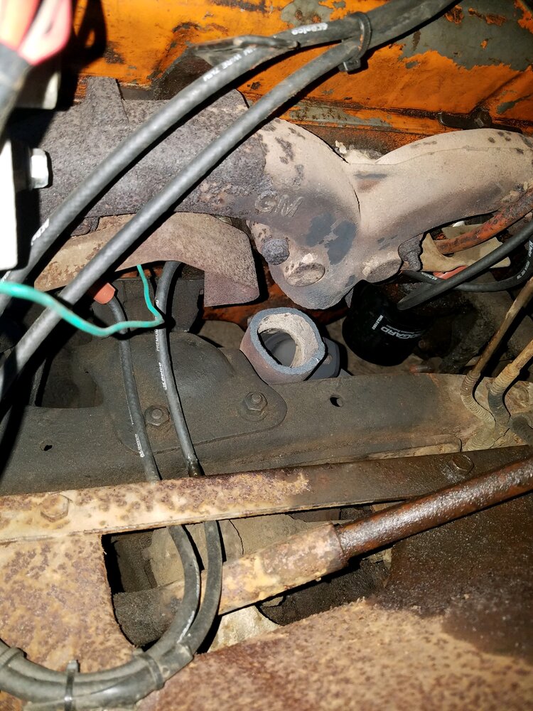

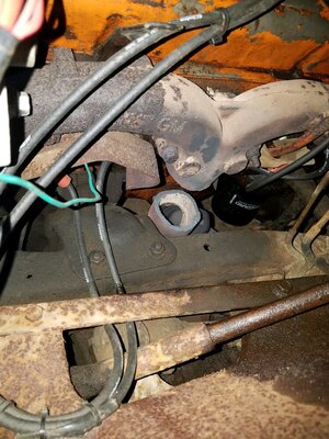

Got everything back to Albemarle and went to unload when the exhaust got much louder....dammit Bobby!
Luckily Rams horns arent that expensive these days
