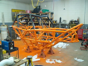

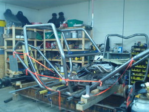

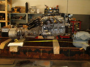

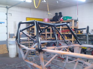

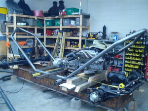

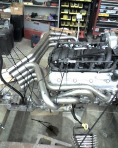

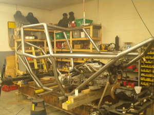

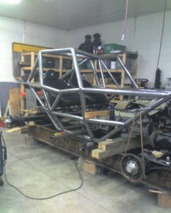

00bowtie Member Joined Feb 27, 2006 Location Taylorsville Mar 27, 2010 #1 LS1, 180 headers TH-350, Artcarr reverse manual vavle body Altas 3.8 Sreering rocks front & rear Ouverson 47 spline shafts ORI's MudPro brackets and Tophats 3.0x0.120 DOM, mandrel bent by KDS

greg slade The Moderated Joined Mar 21, 2005 Location timberlake Mar 27, 2010 #10 dayummmmm. nice work. rockin the 54s
1stgenxxx Well-Known Member Joined Dec 19, 2005 Location Hudson Mar 27, 2010 #11 Mna....That thing is Rowdy

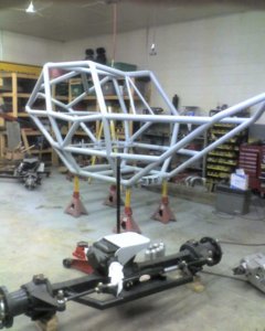

jackedHB Member Joined Apr 3, 2005 Location Boiling Springs Mar 27, 2010 #12 Thats just insane, what size tube is that? Subscribed!!
UNBREAKABLE Well-Known Member Joined May 19, 2005 Location Granite Falls Mar 27, 2010 #13 3" wow that MotherFucker is big

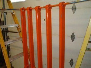

91oneton Well-Known Member Joined Sep 10, 2005 Location conover nc Mar 27, 2010 #16 jackedHB said: Thats just insane, what size tube is that? Subscribed!! Click to expand... for comparsion the upper links are 2" .250 wall

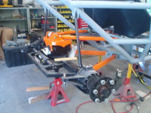

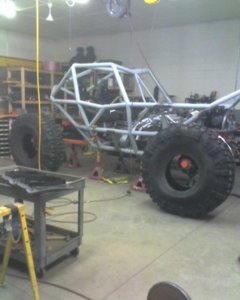

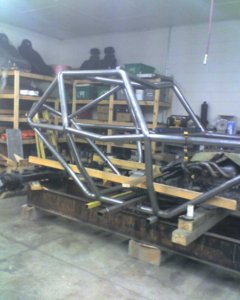

00bowtie Member Joined Feb 27, 2006 Location Taylorsville Mar 27, 2010 #20 This build started has a single seat, mid engine Honda motor/trans-axle with Dana 44's, 1.5x0.083 tubing on 38x11's. After alot of Bud light and Jim Beam here is how it is ending.
