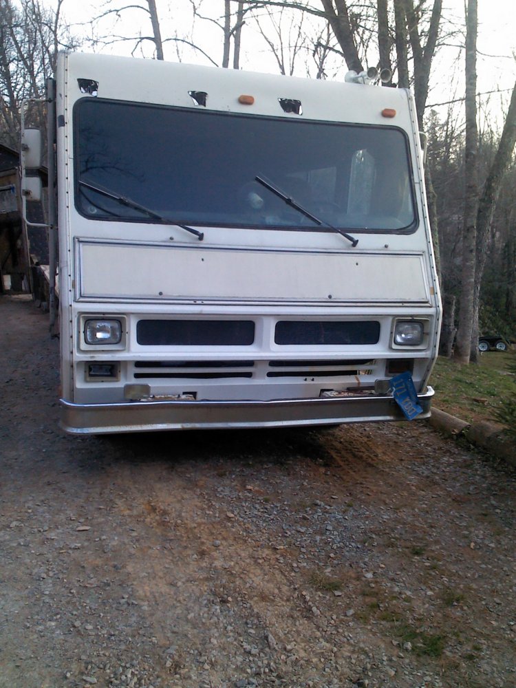

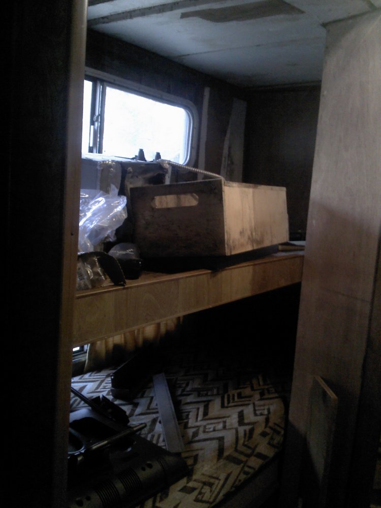

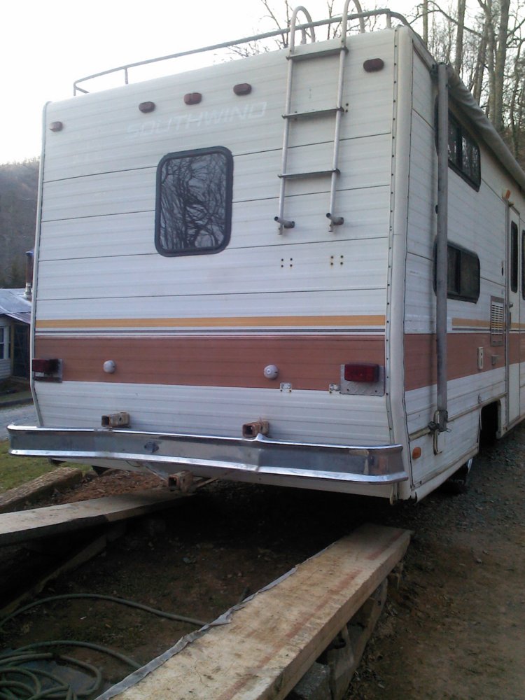

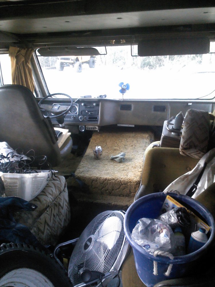

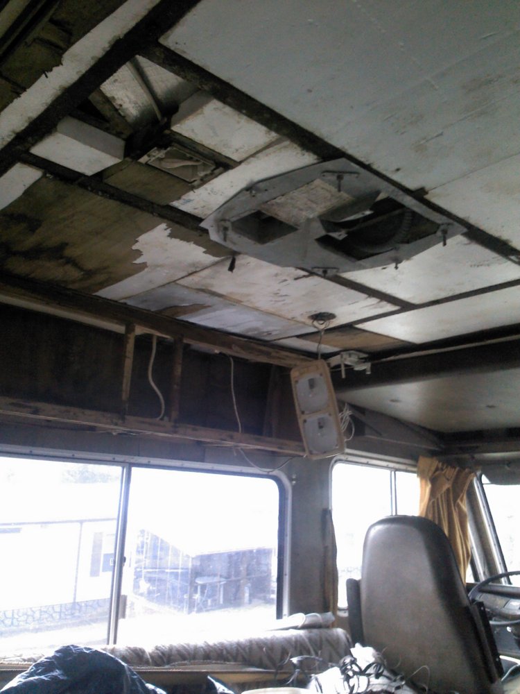

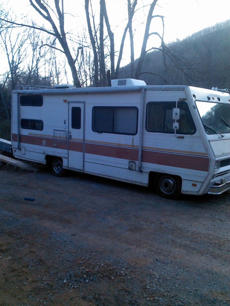

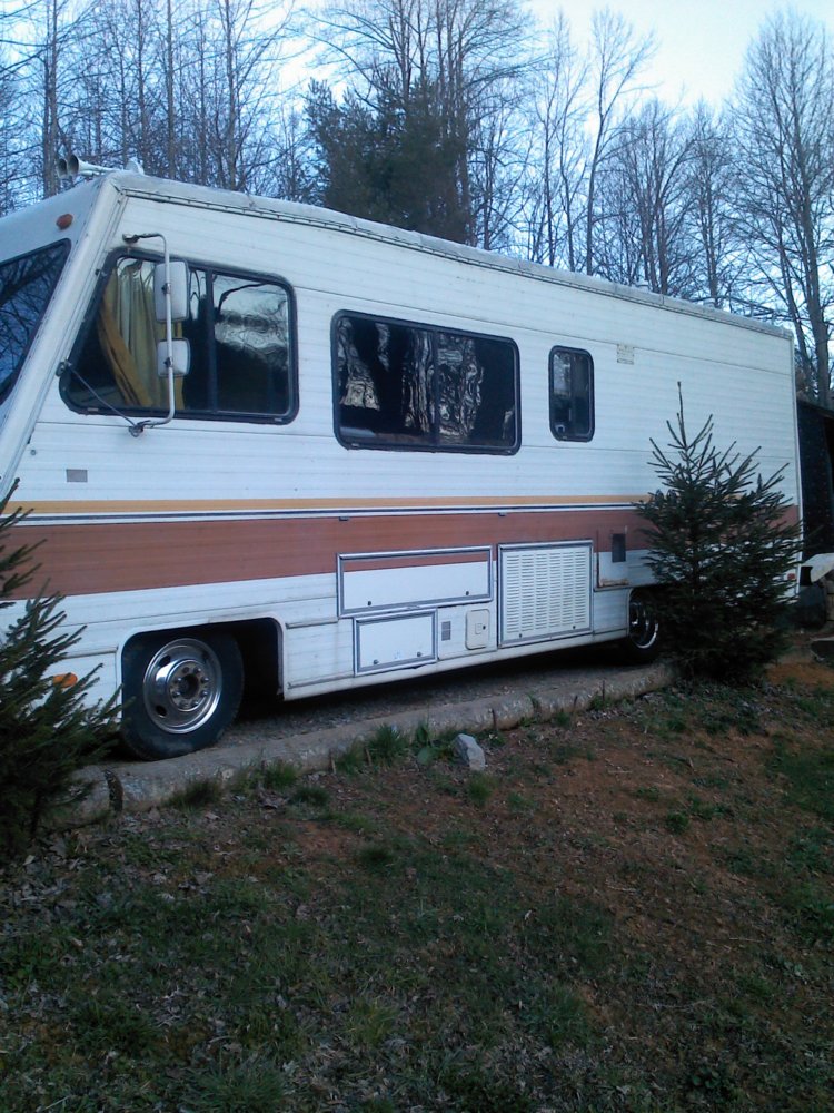

Ok ladies and gentlemen, here we go. I got blessed with a free 1979 Fleetwood Southwind 26ft Motorhome/RV 454ci 49K miles 3spd Auto from a good friend and it's going to be restored as complete as I can and be the family vacation home and toy hauler as well. Probably going to be way longer than any project I've ever done (unless finances really boost) but over time, will be mechanically and cosmetically restored and sound!

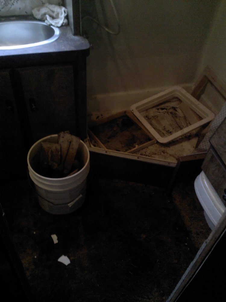

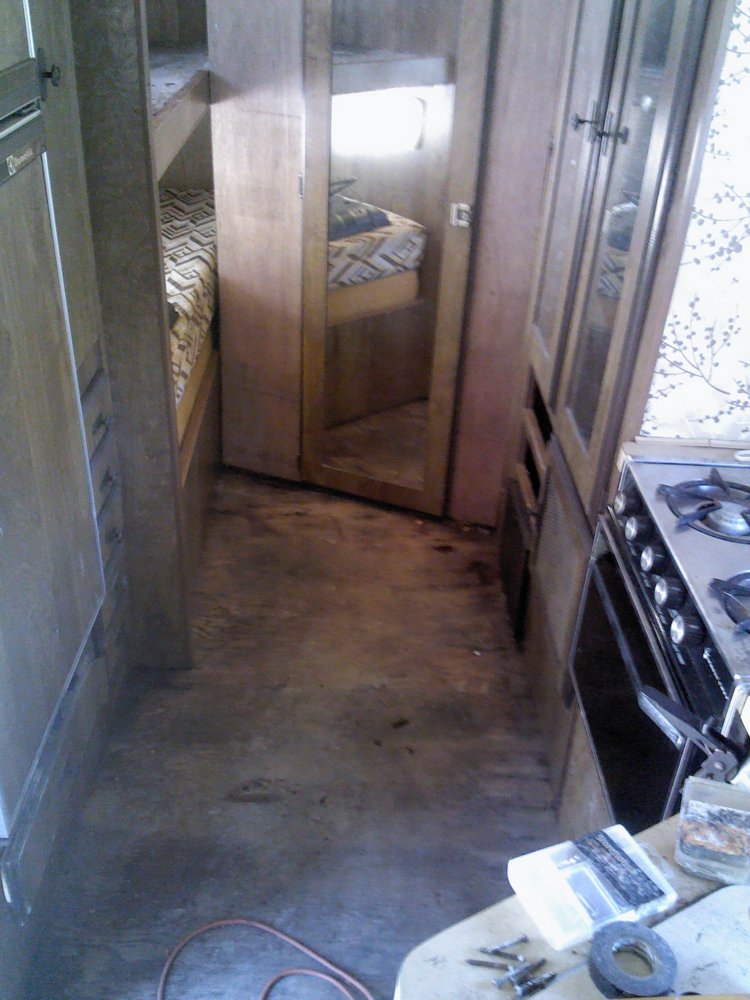

Plans for Interior: GUT IT ALL OUT completely, start from scratch is my thought so far. Been decade since I've done carpentry/trim work so I'm really exited to get back into that. Will have more details of interior as I start on it but for now its all Demo work and such.
Plans for Drive-train: all new breaks front and rear with hardware, calipers the works, new suspension parts where are most prone to weakness whatever I asses in this, needs entire new driveshafts, might upgrade from hydraulic brakes to power brake booster maybe??

Transmission: will stay as it shifted like new on the drive home, change fluid/filter/pan service,done.
Engine: Pull heads to replace head gaskets, valve seals, lifters, gasket match intake and heads, port the intake some, replace water pump/thermostat, leave copper radiator as it looks good shape and cools better. Will remove factory a/c compressor and belt, condenser, and air pump. Keep clutch fan but add secondary electric fans for the "climbs"
Exhaust is true dual and good shape so have 2 Flowmaster super 44s to go on it. No cats from factory
Tires: has almost new 8.5x?x16.5 on it, 10 ply Load Range E look really good, no dry rot or cracking so I believe they will stay for now. 2 out of 3 batteries need replacing, already had one for main engine battery and redo some of the wiring.
This thing was fully loaded, self sustaining RV back in the day. Heat, A/C, Fridge, freezer, oven, stove, Air Ride suspension that works (holds air in the bags good front and rear), 4way self leveling system works (amazing little electric jacks I must say), built in inverter, built in generator runs on aux gas tank. Miraculously ALL interior lights work, the gauges work, all accesories work except needs new thermostat for furnace, even the gauge that tells all the batteries/tanks/propane/generator/gas reads properly for each one, amazing. ok, enough chatter for now, here it is.

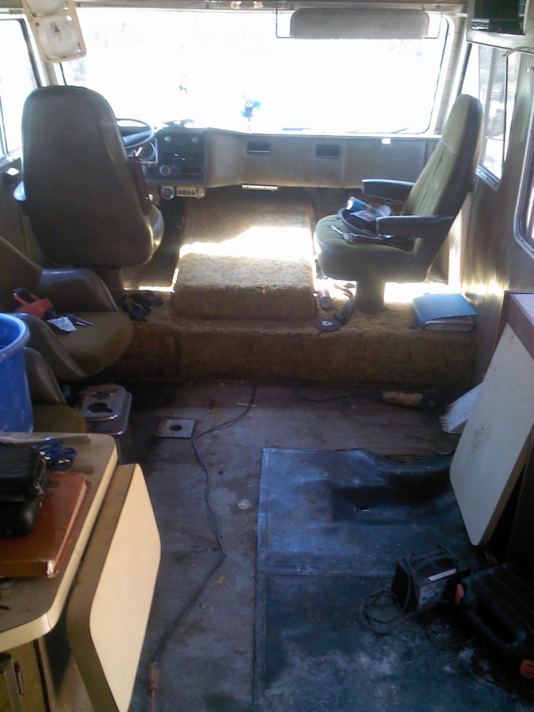

all that junk is what it looked like when i got it LOL...then last picture is after me and wife and daughter spent time throwing out what was trash, what was tools, and pulled up carpet and tons of paneling to see what we have to work with...it was a HOT MESS as you can see from the pictures at first. Gained bunch of tools though, nice drill, another full socket set lol, god knows how many pliers and masonry tools, gas cans, nice big commercial grade fan, nice vacuum, other misc tools and houshold cleaning stuff and car stuff....bout 7/8 cans of that foam filler stuff so someone was planning to do something to it.

Why Gut It?? cause the cabinetry is too far gone for my liking and I'm going to redesign it my own way. Plan is to remove the bunk beds and bathroom, put in full size bed, keep toilet area moved forward, don't care for shower so that space will be my "shop stuff"...he gave me brand new 12gal compressor for it so I will have onboard compressor with full tools to use when on the road, camping and at the Off Road Parks. Kitchen cabinets/counter is rotted...pretty much everything is kinda "soft" rotted type stuff so I'd rather start fresh.

I'm sure you are checking for mold as you strip it. Be sure you do. Don't want your family getting sick on the first long trip

well that's the whole reason for gutting it completely is to start fresh, fresh fresh lol, and that way I know 100% what's going in it and what's behind everything. Plus for us, it will also make it feel new and newer and not have any of the old feeling to it. looks like a slow day at work tomorrow so far so once i fix some of the outside leaks around the windows, hope to get in and start gutting it.
