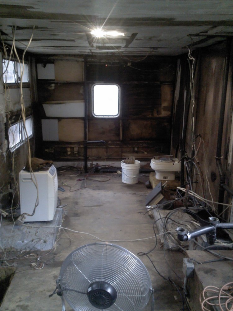

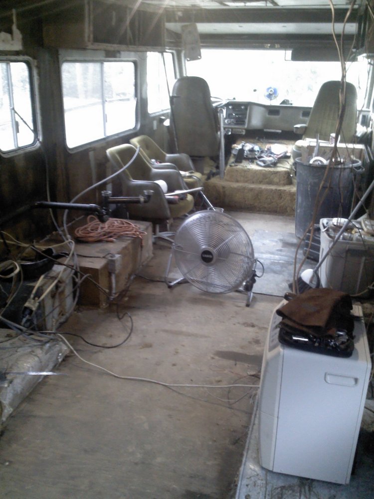

alright guys had whole day to work on this today and here's what I got...almost done with clearing out interior...now i know where the roof leaks are...EVERYWHERE LOL...that's gonna suck to do, but made good progress. i guess the good news is it's only leaking on the edges (makes sense) where the roof meets the siding, i've been reading that's very common place for most all leaks.

Slow down, take your time
aww no pulling all nighters to finish it in few weeks! LOL, nah I wish, money is my issue with this project not time. so I will be able to take more time since it will take me time to get the funds together. thanks man!
