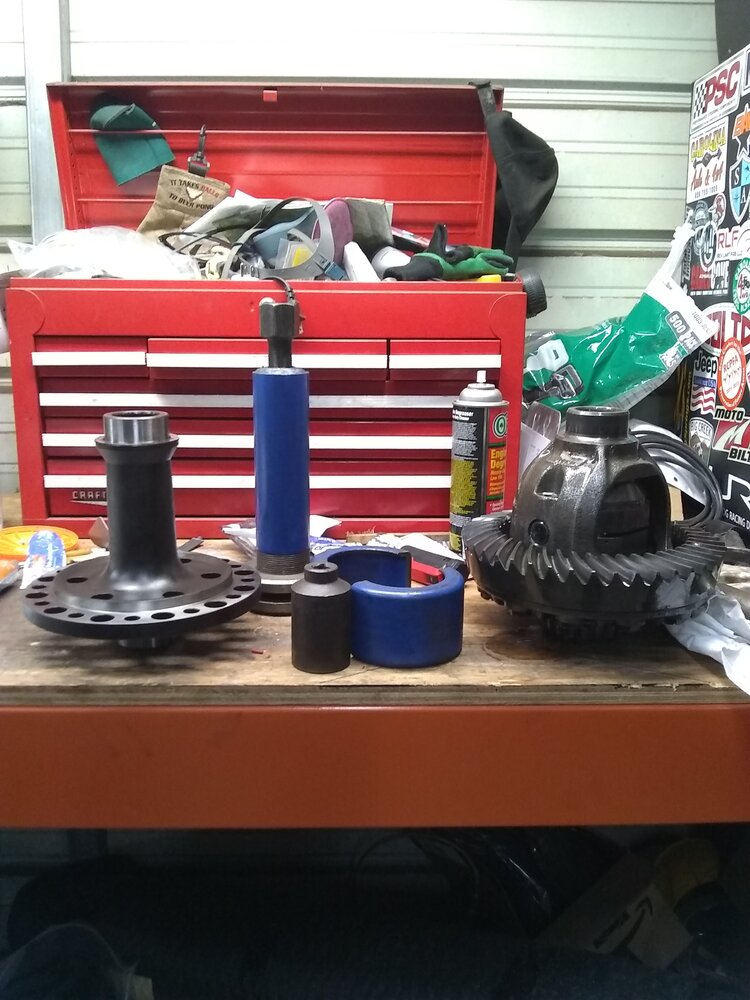

Couple of weeks ago I dropped off Bob at Chris's shop. I was starting to have issues with the spartan in the 60 coming unlocked at the worst times, when I needed it most. Usually on uphill climbs. So I decided to swap it out for a Yukon spool. And while I was at it I also bought a Detroit for the 14b off of Chris and we installed them both in an afternoon. He also fab'd up a big power steering resi to help with flow into the psc pump. Then this past weekend a group of us misfitz went down to gulches to have some fun. Ole Bob did well and had no issues keeping both front tires spinning.

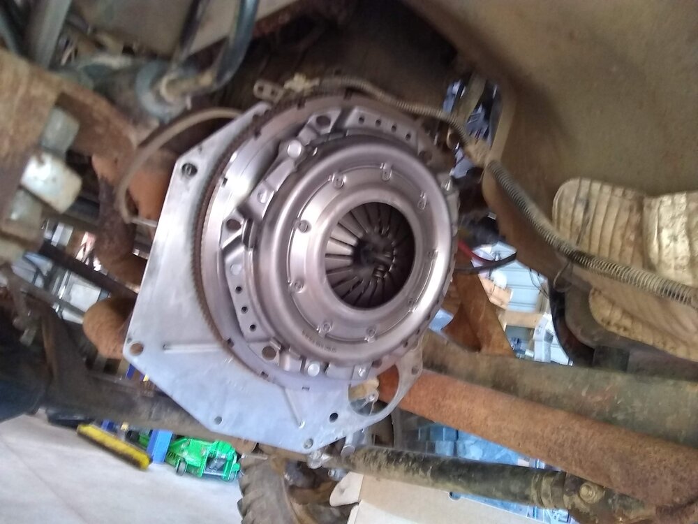

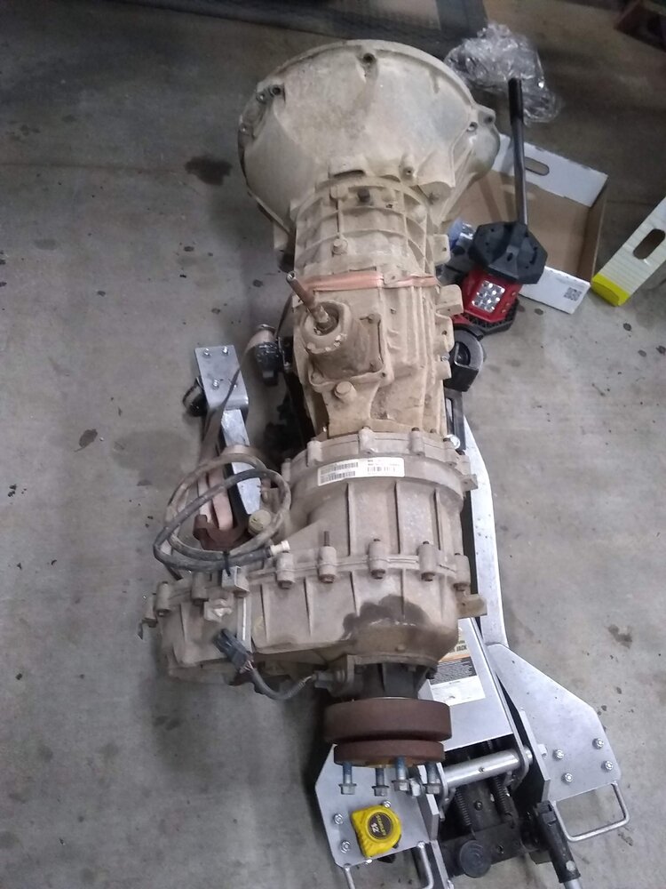

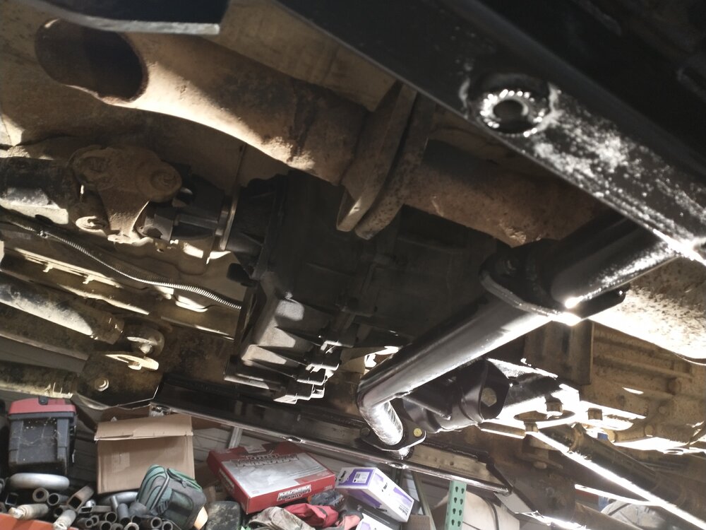

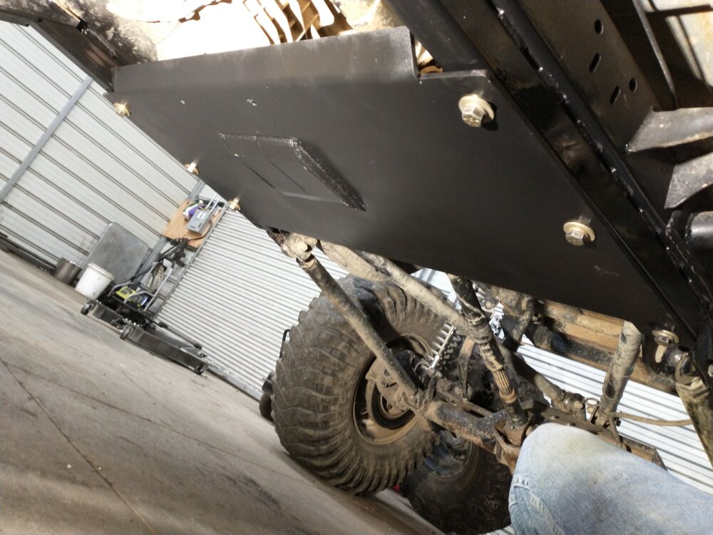

Haven't updated this in a while. Last year at the get together I lost my clutch riding around in the field. Have no idea how that happened :shaking:. Anyway I figured while I was in there replacing it, that would be a great time to put in a lower gear transfer case. Found a rubi case up in West Virginia for a decent deal and slapped it in. Had to get @Chris_Keziah to fab up a new cross member and belly skid.

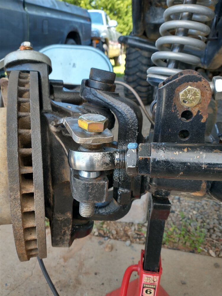

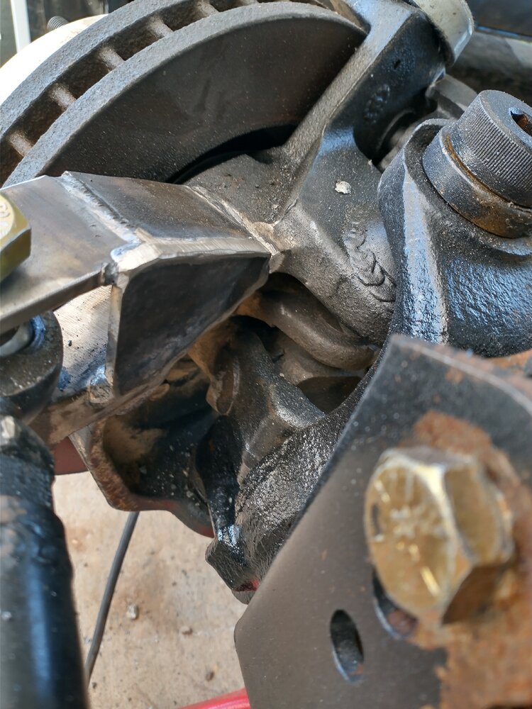

Next I figured since the bolts for the heims at the knuckle kept wanting to back out, I'd try my hand at fabbing up some double shear mounts. So far they have held up great and seems to have solved the issue.

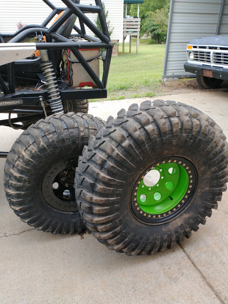

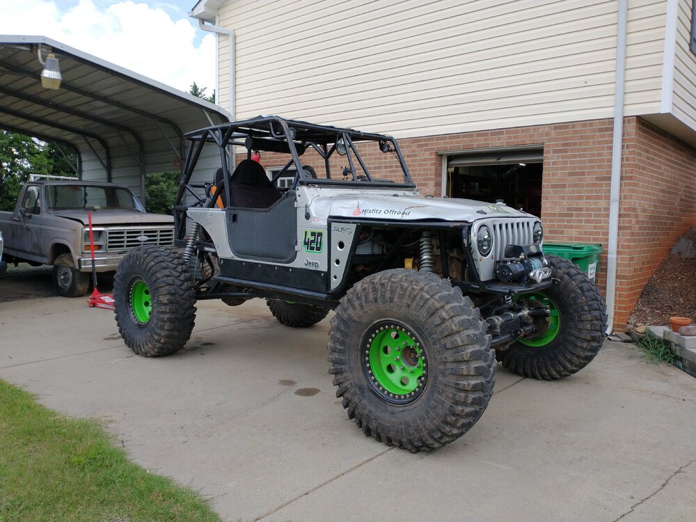

Now after getting a few other things sorted out I decided to throw some 42s on it to see how much more stuff I can break. :smokin:
