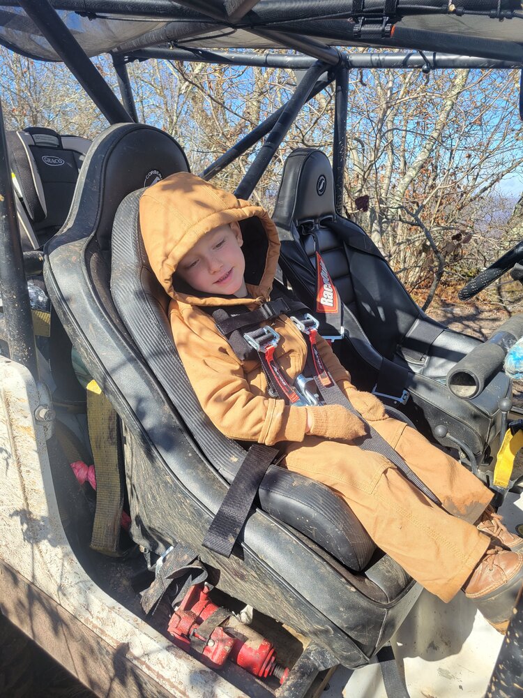

I recently picked up a kids SXS seat insert with 5 point harness, it fits snuggly into my corbeau seat, and now my son can ride up front with me on trials. He loves riding up front now, but I may need to look at installing a door bar or a window net for harder trails.

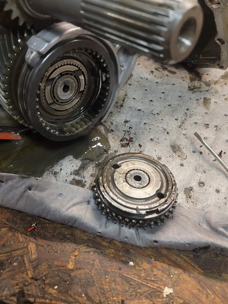

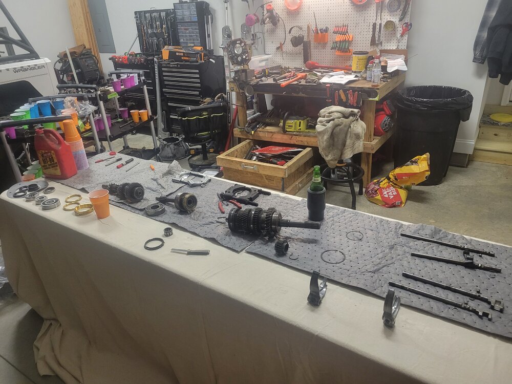

I've been busy with life. We moved from Raleigh to Joco and now finally getting around to working on the YJ. Pulled the AX15 and the throwout bearing was laying in pieces on the bottom of the bellhousing. Once I pulled the adapter housing, fifth gear fell to the floor. Turns out I broke the cluster gear shaft right were it splines down for fifth gear. Bought a new clutch kit, AX15 rebuild kit (which turns out isn't the most complete), and a parts transmission from an early XJ. Currently in the middle of rebuilding the transmission.

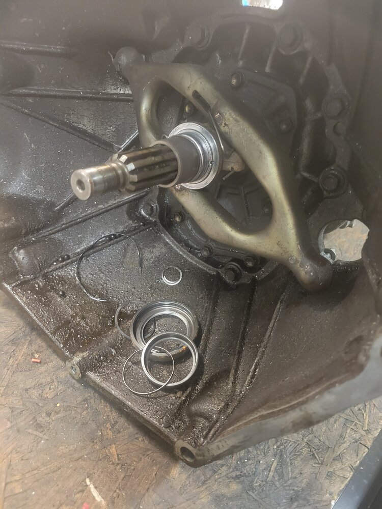

Small update, no pictures. Got the jeep back together the day before the CNC4x4's spring fling at Uwharrie. Hit Daniel the first afternoon, and realized I was leaking oil when I got back to camp. My son and I spent time hiking the rest of the weekend instead of wheeling, and still had a great time. Turns out when I replaced the chewed up front bearing retainer on the transmission, I forgot that there was supposed to be a seal on the inside of the retainer. So the week following the trip, I pulled the transmission once again and installed the front bearing seal. Now the jeep is back to normal and shifting good. Next trip is GER in June.
