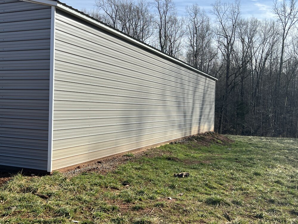

Picture of the long eve side

I know its a metal bldg but more roof overhang would help. Also the soil line is so close to the bottom of the siding. It's code in my county that soil line has to be 6" below siding. I wonder of pulling the bottom siding and installing flashing is possible or feasible?

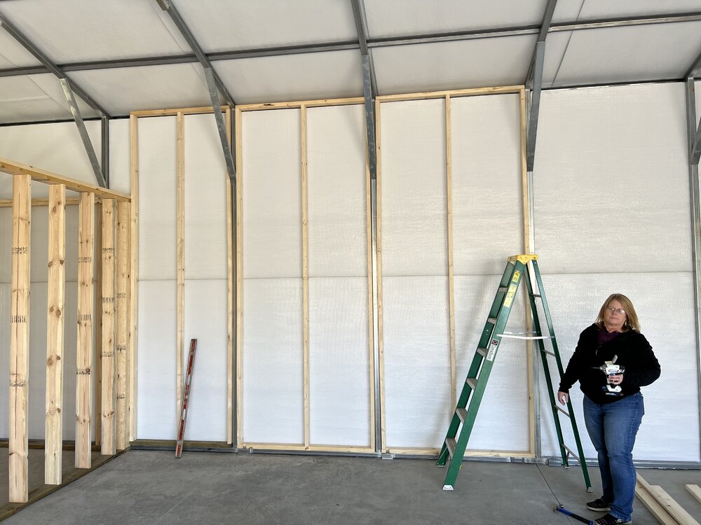

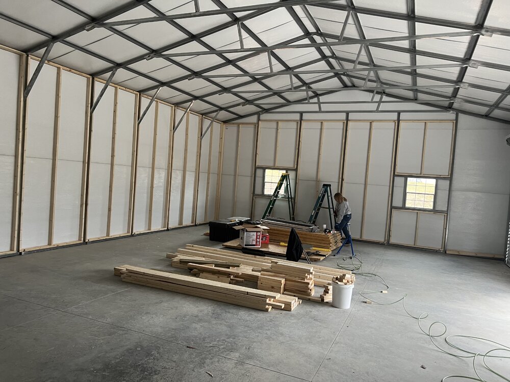

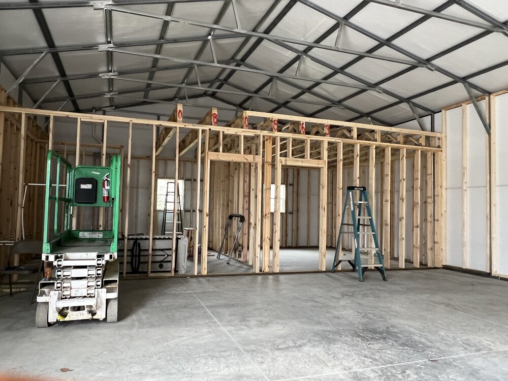

The wife and I started installing panels in the shop side. Hope to wrap that up this week. Get my trusses next week and hope to start wiring in the next couple weeks

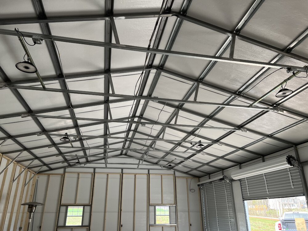

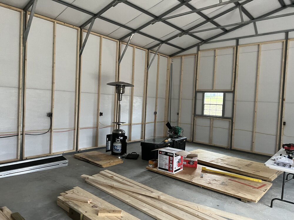

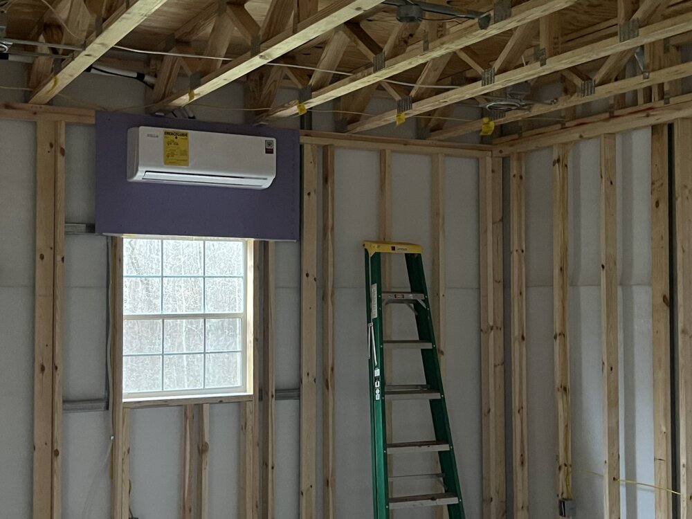

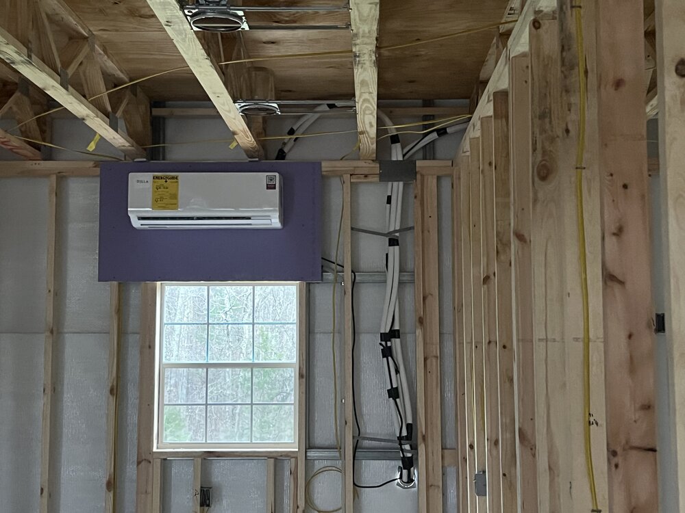

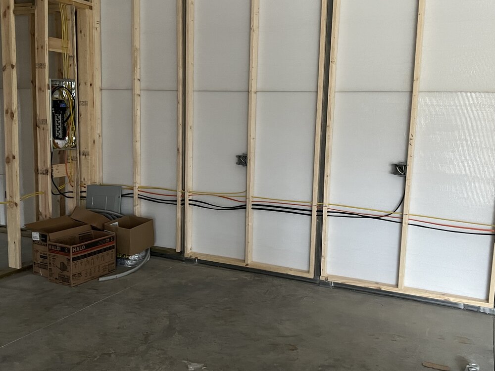

The electrical crew descend up on my shop today in full force. Looks like the only thing they have left is the runs to the lights in the shop. I am very pleased with their work!

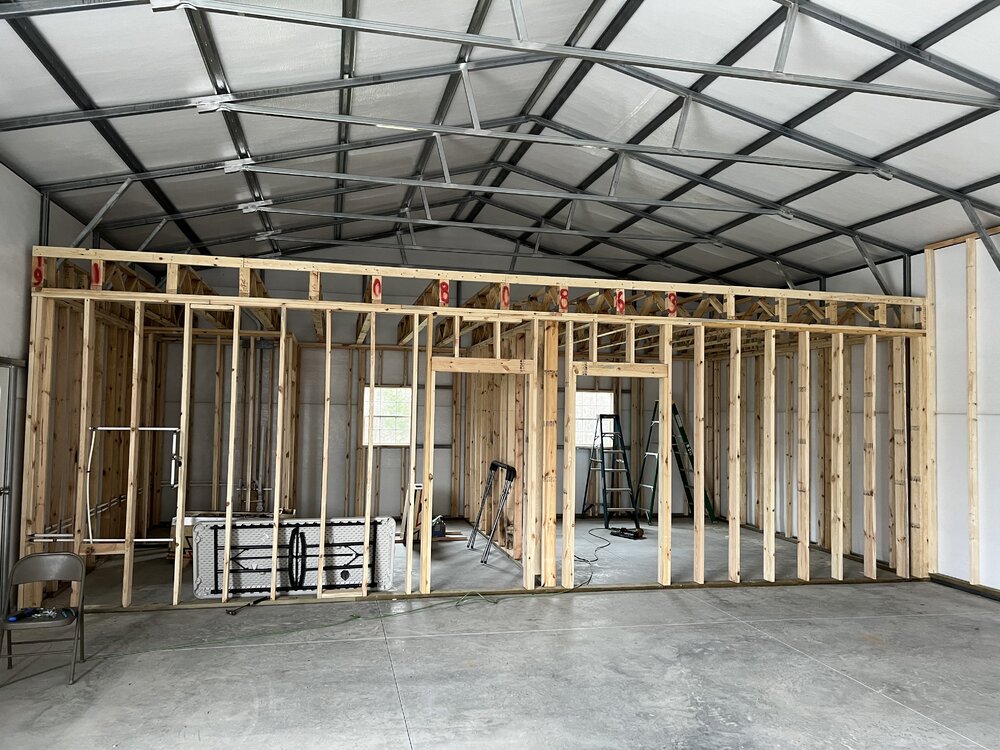

I see you have the framing on top of the floor piece. Is it attached? If so how and is there any loss in strength? Is that 2x2 tube for the building? I've never seen how people do this and definitely want to learn.
The building is 2x2 construction. The wood inserts are sitting on the bottom rail. It is attached to the metal beam using wood to metal self tapping screws 2 3/4” long. I got them at Lowe’s. I think I adds some strength to the building. As you can see in the pictures the electricians could drill and run the wires like in a regular stick frame house. This saves $$ since they didn’t have to run the metal conduit wires. You are welcome to come check things out in person anytime!

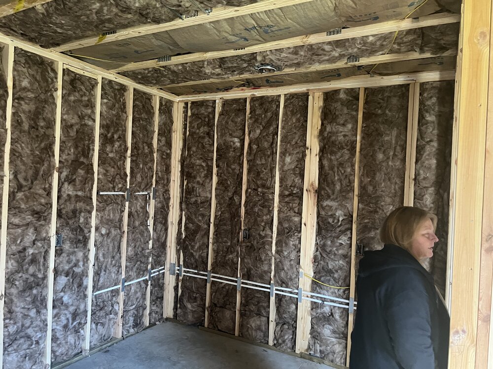

All inspections have passed. Called the insulation company yesterday to get on their schedule. Getting a quote for drywall next week. Electrician installed the led lights yesterday. Have plugs in the ceiling for pull down drop cords. Getting close!

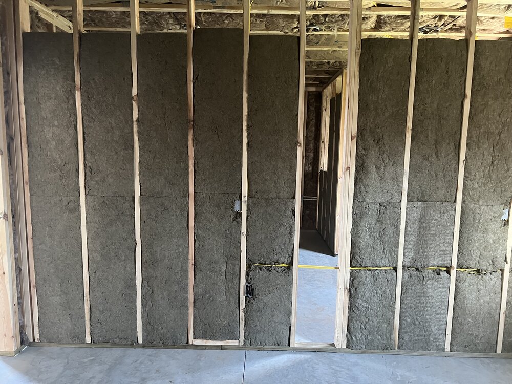

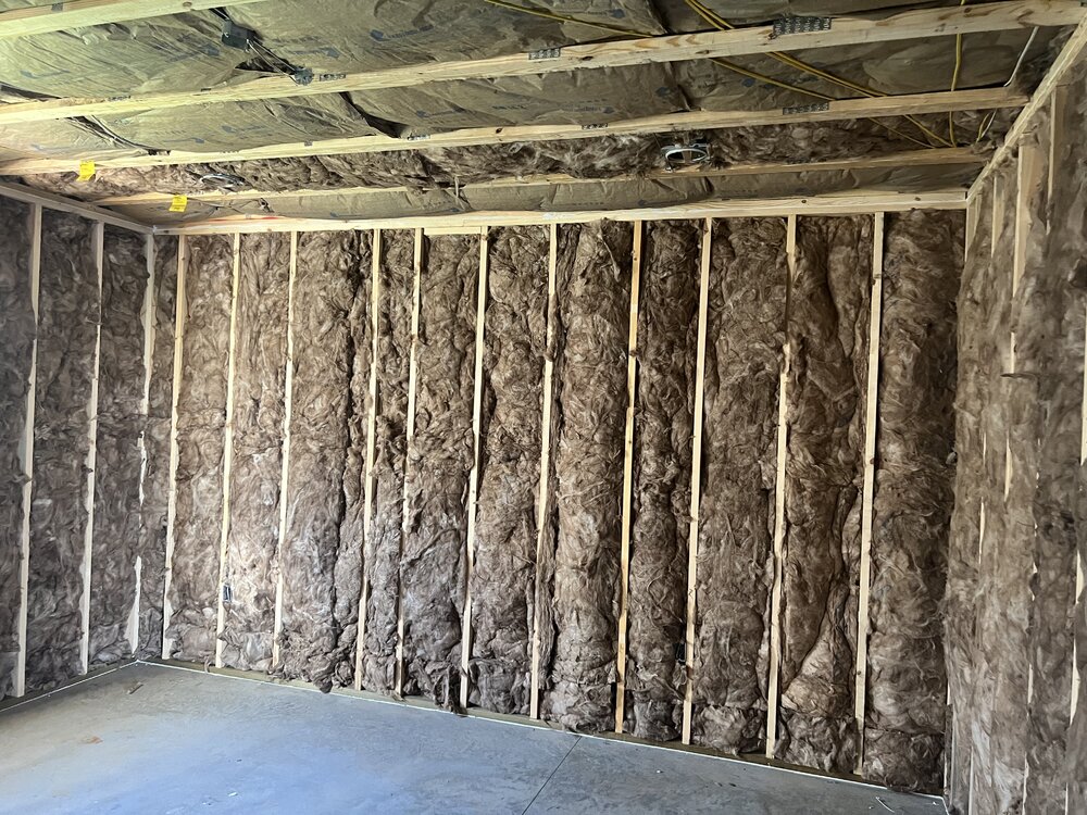

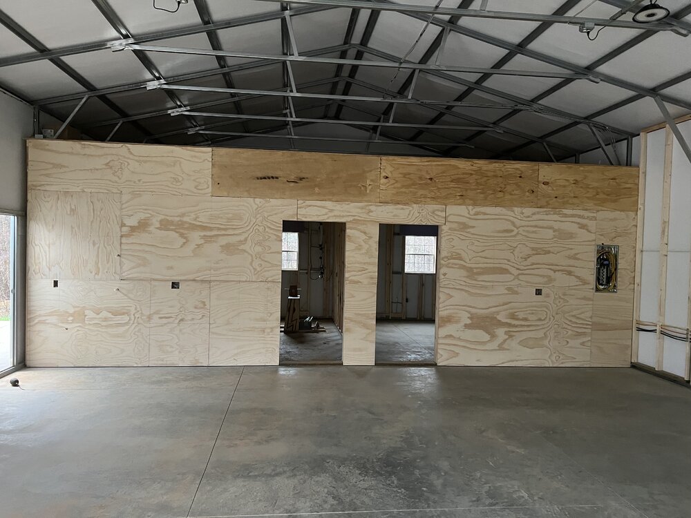

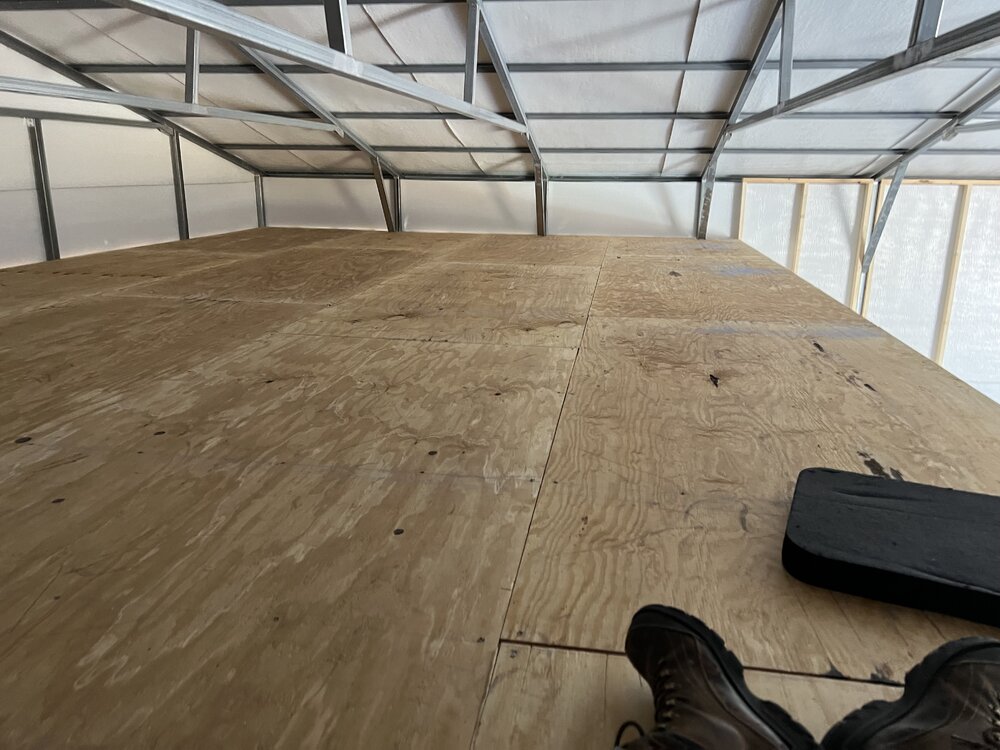

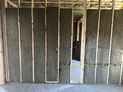

We’ve made some more progress on the shop. The wife and I hung 3/4 plywood on the shop side wall. Insulation was installed today on all the exterior and shop walls. We are installing Rockwool in the wall between the rooms and around the bathroom.

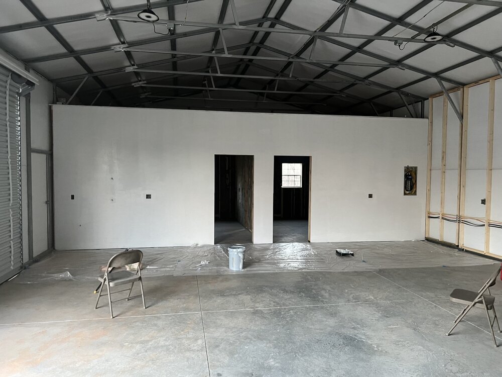

The plywood was rather thirsty. Took 3 coats of primer before we were satisfied with the coverage.
Looks good. Did you fill the seams with anything, or do they just not show up in the picture.
