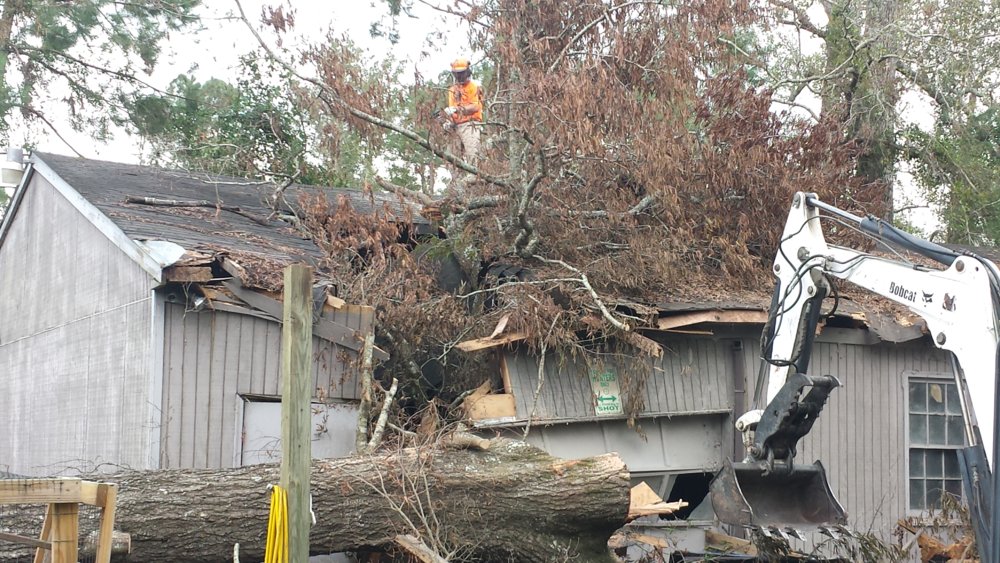

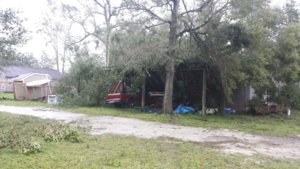

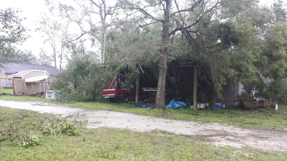

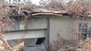

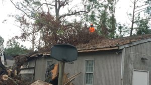

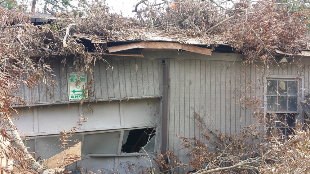

I'm looking in to building a shop of my own sooner than later....thanks Florence. Damn whore-icane.
While it may not be a great time to get in to doing this, I don't have much of a choice. The shop at my dad's is old and would require a good bit of work to repair, but the biggest issue is that it's not at my house.
