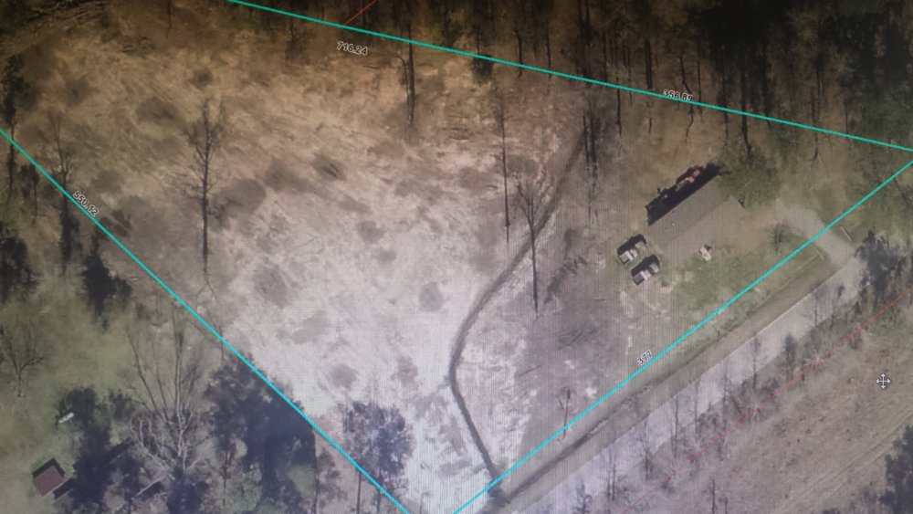

Also, here's a shot of my property. I was standing in the yard yesterday and staring at the back. I never realized that no matter what, the shop won't be behind the house at all. Oh well, not a huge deal.

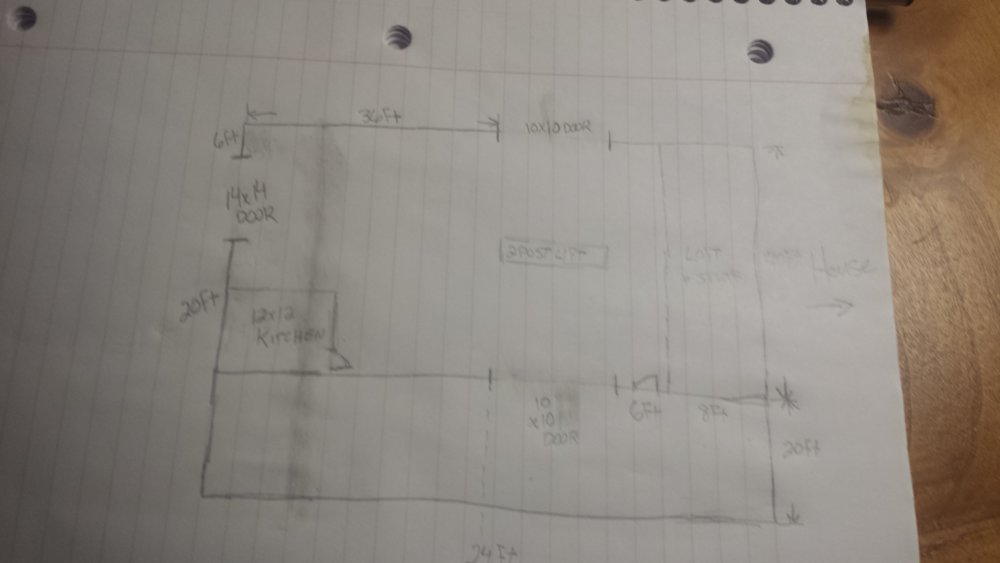

It just kinda popped in to my head this afternoon. I pretty much know right where I'm going to put it and mostly how I want it laid out. I made a rough sketch. I need to do it on my computer, but haven't yet. If you can see it, let me know what you think.
It's a 1:12 roof pitch, the 16 foot is the eave height....so over the 20 foot shelter, it'll drop down to just over 14 feet at the end. The peak should be 17' 8" if I figured everything right.
